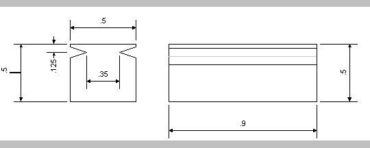

There is little blocks glued to the top of the barrel (the blocks have grooves in them), then you clamp the scope clamps to that.
I had this delima not to long ago and I don't think anyone makes them. I found a set over at the RPF that's on my blaster now. You could try and carve them out of some wood or plastic. Here is a diagram that was posted some time ago.
