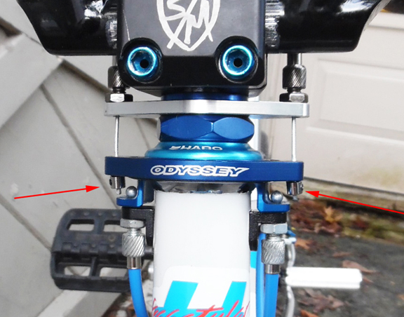

how did i miss this? this is genius! excellent idea! I will be using this idea for future builds. Also as a side note, the pinlocks or "pinsavers" with the set screw hold very strong. A small washer could help prevent them from pulling through as well. But yea, i have used them on my BMX bikes to make an "end" on a brake cable. even with the constant pulling, they never slipped. You can see them here...
Awesome! This is exactly what I was looking for...someone who has tried the backs with the set screw first hand. So far I have tried the originals (don't recommend to anyone as they will pop off guaranteed) and the improved clutch backs I noted earlier and posted a link for, which so far not one has popped off. I am also using washers in between but it really is not needed with the improved clutch backs since they already have a wide base. My only concern with these, and the main reason I have not tried it yet, is they look kind of bulky. I've been holding off purchasing them and waiting for a first hand experience before I made the investment. What are your thoughts on their bulk factor under the vest? Notable or nothing to worry about?
