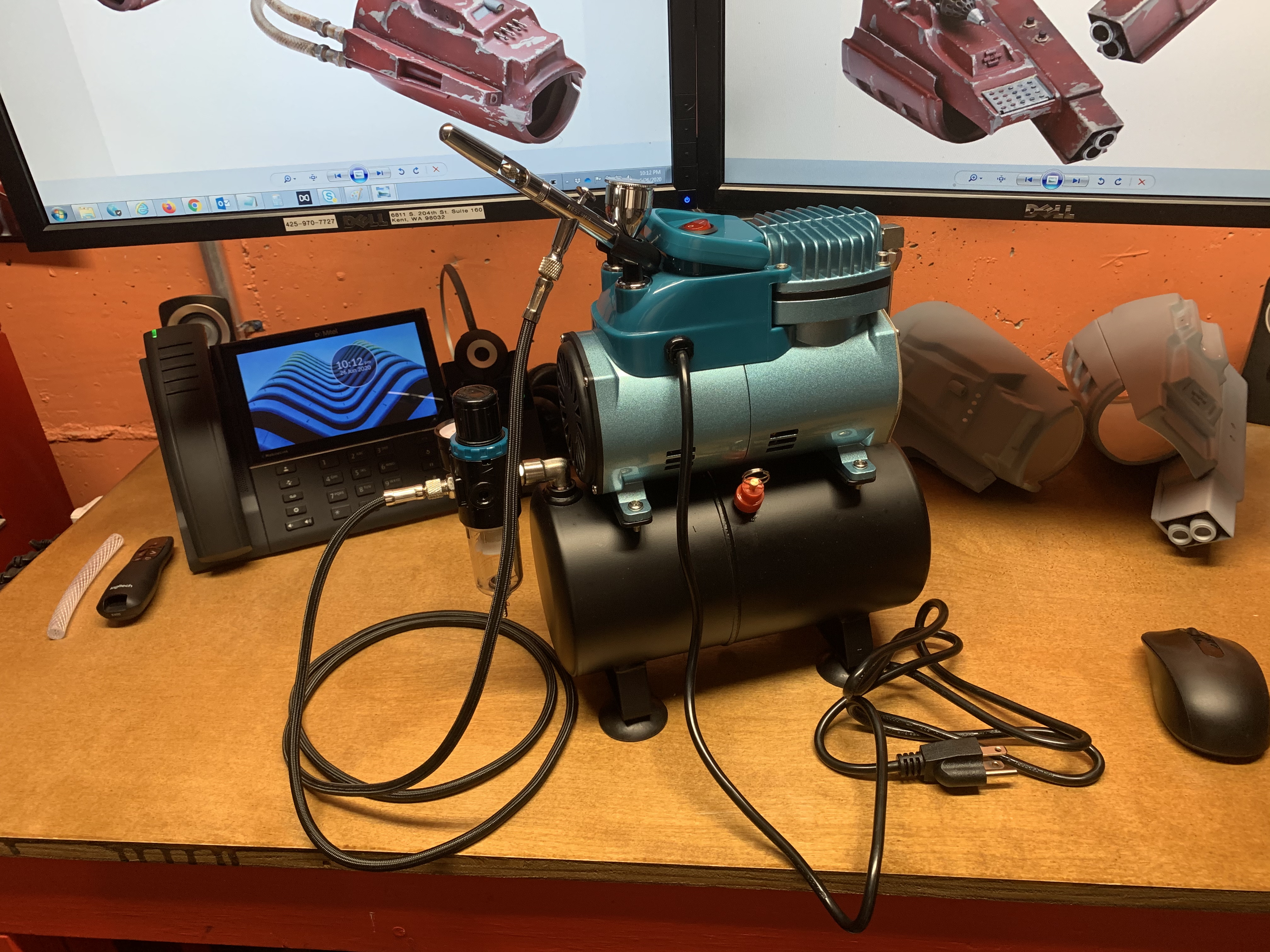

Ha! We got the same airbrush! I totally love my iWata HP-CS. I would say that 90% of my ROTJ Fett was painted using that airbrush. For 2020 Fathers Day my Wife and Daughter presented me with an airbrush set I've had my eye on for a while. The set consisted of the iWata HP-CS Airbrush and a Master Airbrush TC-40T Compressor.
They got it as a kit from Amazon at the time. I think the entire kit at the time ran them about $289.99 (USD).
I know you can buy JUST the compressor though, that link is:
Looks like it is $149.99 (USD)
It is a great compressor and you'll find it has gotten many positive reviews too!

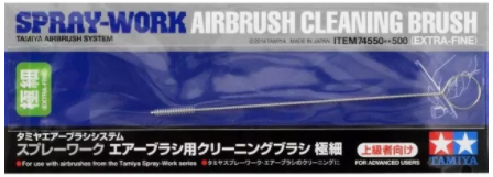

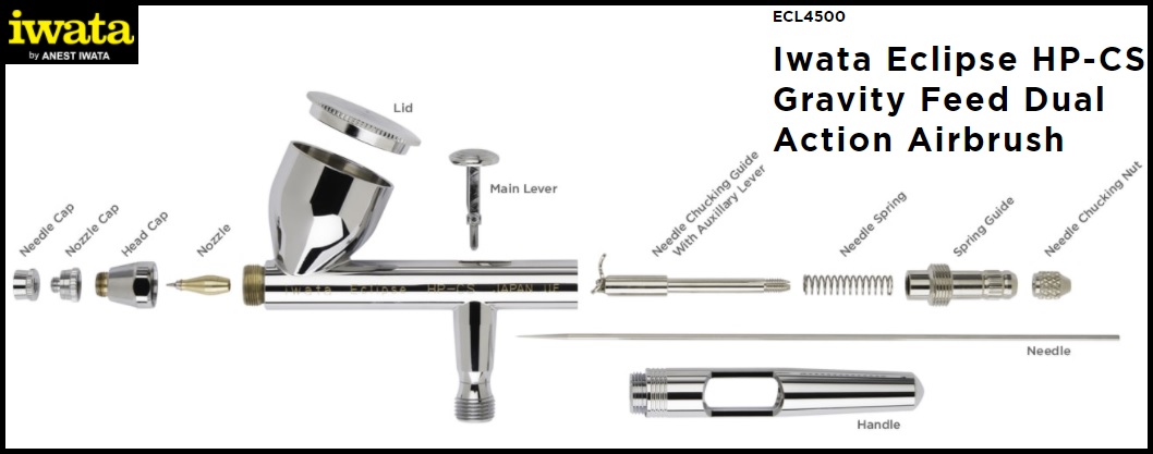

That's super cool that you got a compressor. You'll enjoy your HP-CS, it really it a nice airbrush! Do you know what kind of paints you're gonna run through it? For my ROTJ Fett I ran primarily Tamiya Paints. But I also used Vallejo and Humbrol. I wasn't a huge fan of the Humbrol, as I found it very difficult to shoot the stuff is just super thick (Even after being thinned down greatly), but I'm now thinking it had to do with the fact that the Humbrol was an enamel based paint too. Oh and cleaning them humbrol paints off my airbrush was an absolute nightmare. Concerning cleaning and get yourself a good set of Dental Picks too. They make cleaning an airbrush much easier, something like this is what I use....
It makes for cleaning the "Nozzle" a lot easier....

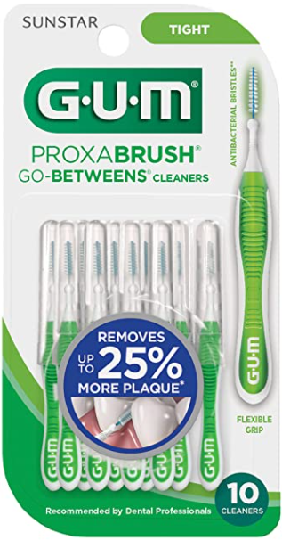

And also keep one of these handy too!
Makes it easy to clean the "Needle Chucking Guide with Auxiliary Level" a breeze too!

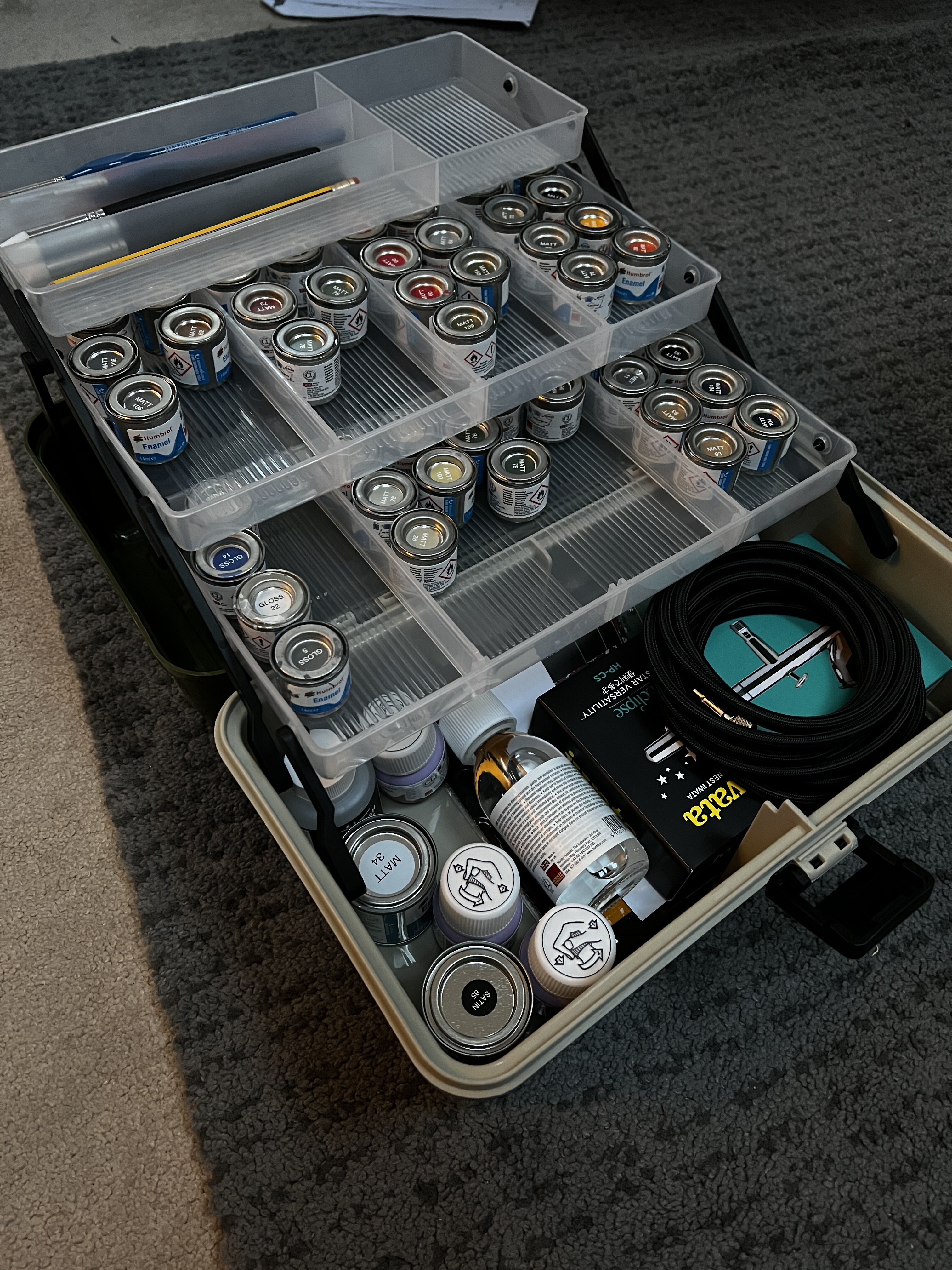

It’s funny you said about not liking the humbrols as that’s exactly what I’ve gone for (doh!) just over £140 ($200) of them to be exact! This was based on BaidenProps’ YouTube videos for painting an ESB Fett helmet and a ‘mind map’ diagram (I forget who posted it originally) that detailed the required colours for an ESB lid. I cross referenced that with a number of build threads and created a big shopping list. Just ordered everything direct through Humbrol. The BaidenProps video came highly recommended and the paints he mentions using are Humbrol. Also they just seem to be easier to get over here.
Thanks for the tips re: cleaning, will definitely get some dental picks and the cleaning brush. I’m excited to use the airbrush, I’ve used rattle cans a lot, recently on a few blaster builds and between the fumes and the overspray they can be a real pain. I know there’ll still be overspray with an airbrush but I’m guessing not as much? Same thing the fumes?

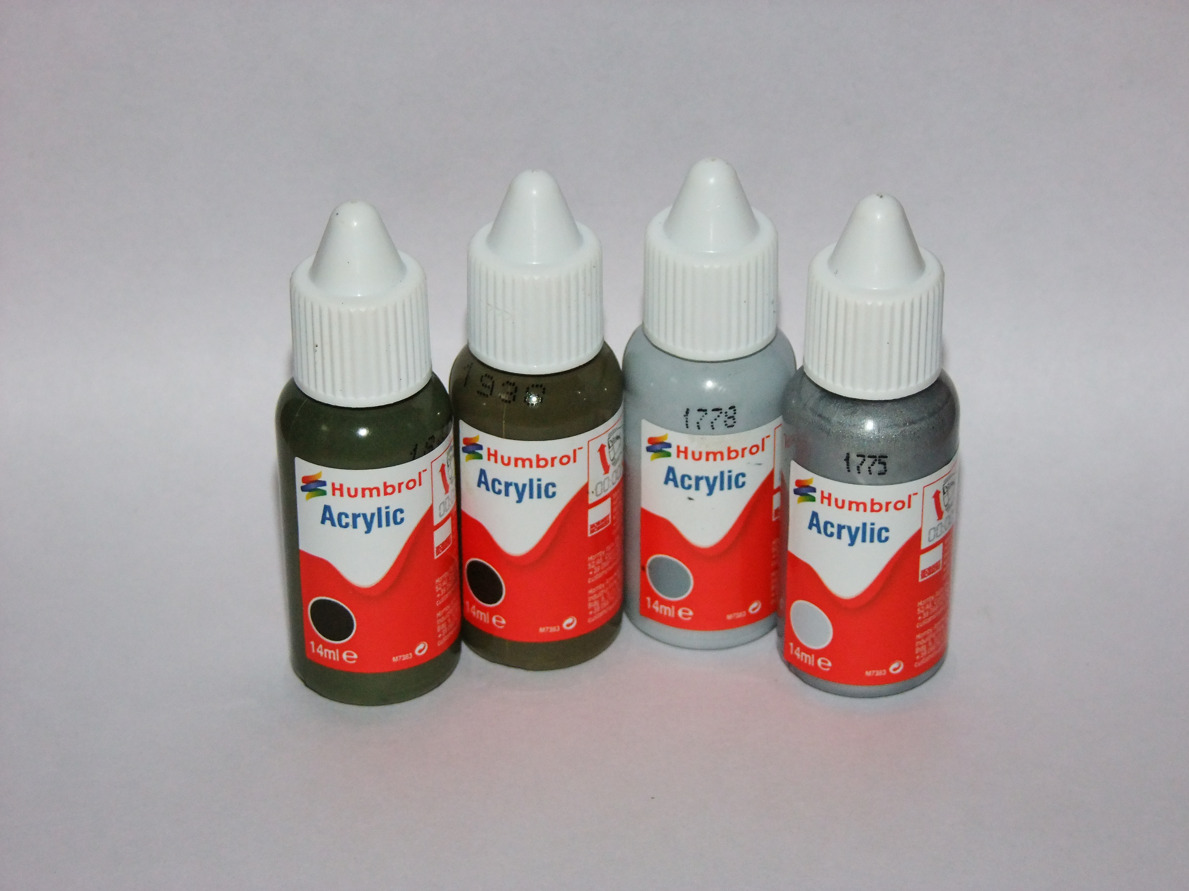

As far as I know, all of the Humbrol paints that come in those little metal 'tinlets' are enamel. They make acrylic too but they come in these little bottles:
At least now anyway, they may have been available in the metal tins at some point. I'll need to practice with all of this before the helmet arrives anyway so I'll experiment with thinner ratios, psi e.t.c. I may even see if I can contact Lewis (BlaidonProps) and pick his brain. I imagine acrylic vs enamel is a question that gets asked a lot, from what I've Seen it seems to be mainly down to geographic and what's easier to come by. Humbrol is definitely the more prominent brand over here, then again, they do have the above pictured acrylics which are as easy to pick up as the enamels so ??? Anyone my side of the pond seems to recommend enamel anyway.

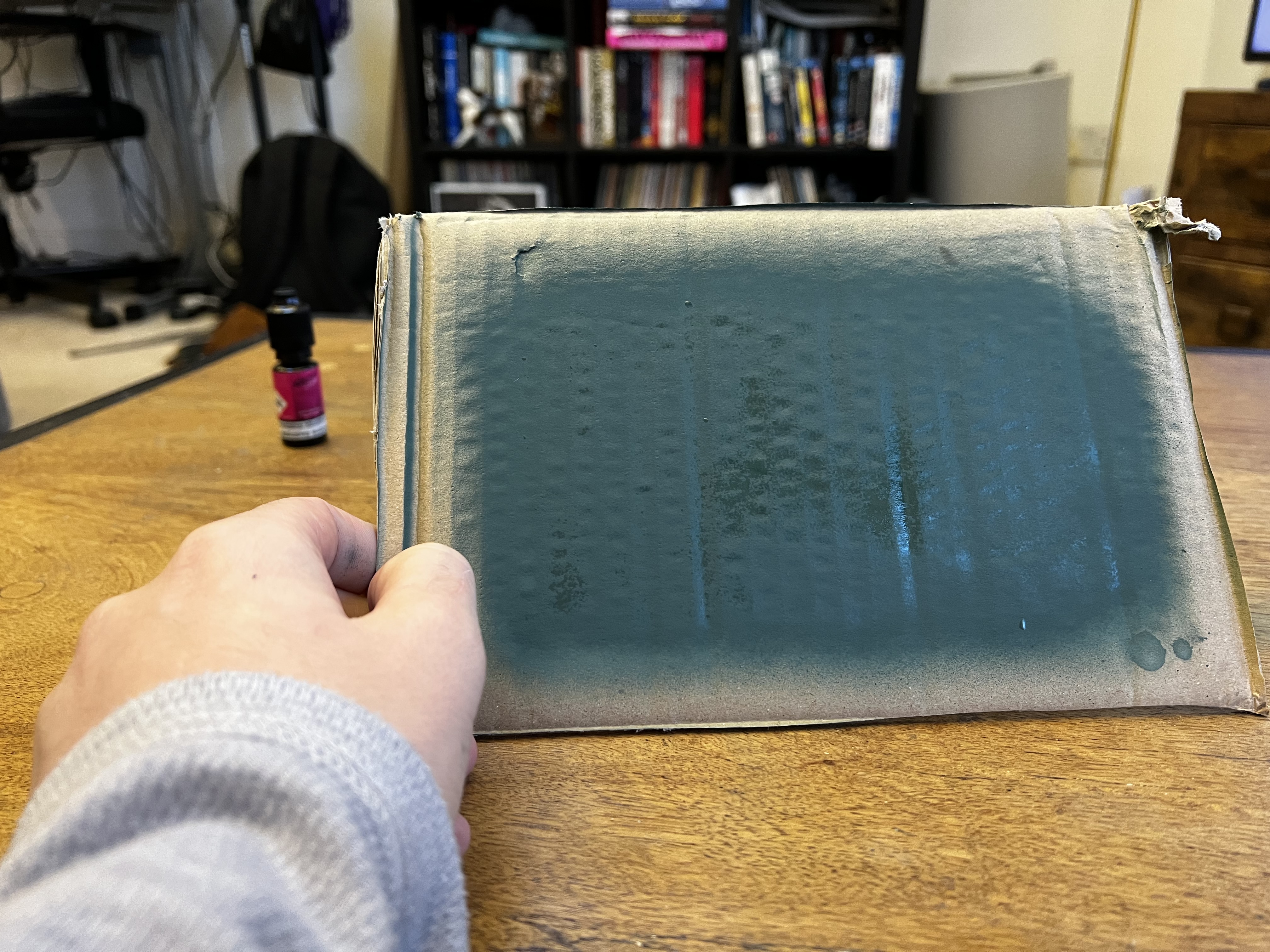

Thanks mate, had a little practice with it this afternoon. This was green #76 and blue #96, mixed 1:1 (1.5ml of each) and 1.5ml of thinner.
This is the green/blue for the back panels of the helmet.
