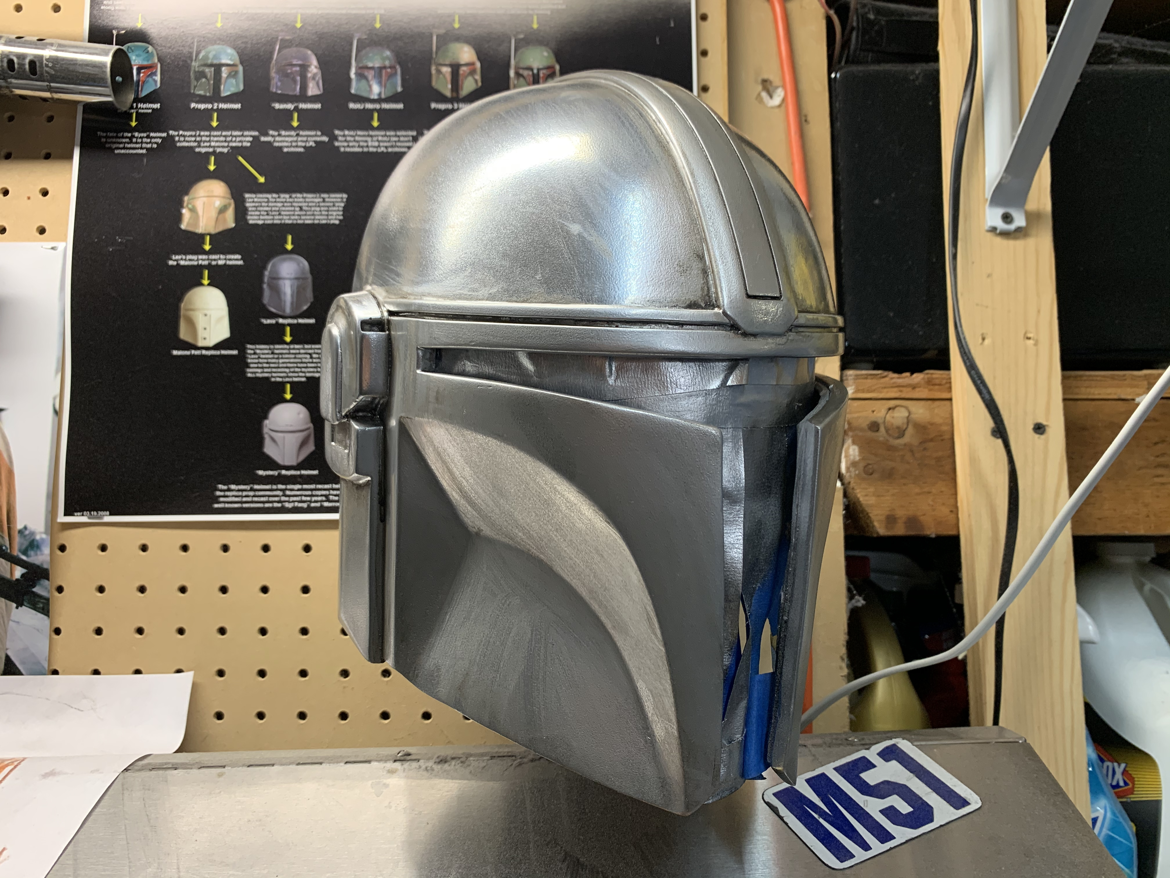

Hi everyone,
I have spent hours over the past year looking through ESB paint up threads from various painters (ranging from the pre-2010's to current) and the Boba Fett Helmet Consolidated Paint Up Threads in order to try to decide what techniques I should use to paint my helmet. Honestly, sorting through all the photos and styles is overwhelming and so there it sits primered on my workbench begging me to start.
I recently painted a The Mandalorian helmet with rattle cans for my son and will be painting my The Mandalorian helmet with my airbrush to get better at using it before advancing onto my ESB.
I will be painting with acrylic air brush paints, mostly Humbrol, some Tamiya and a couple random paints from other brands where I couldn't find the specific acrylic colors with Humbrol or Tamiya.
My question for you all is this, in the interest of simplifying my first ESB paint job and reducing how overwhelming it is... which technique should I go with in order to simplify this process where I can, without compromising on an entry level 501st helmet?

With airbrushing, you'll probably want to do most or all of it layered. Very easy to just liquid mask what you want chipped, then airbrush coat it all over. Also the original prop was layered, so that's a bonus for that method too.
The one thing people generally combo though is the metallic. Most all metallic rattlecans can be kinda problematic to topcoat, very dusty and poor adhesion, takes a lot of steel wooling and washing to get it them to work well. So commonly people just apply the metallic topically after the layers are done. This can also be advantageous in that you can put it in after the cloarcoat, which dulls metallics some. But definitely don't feel like you have to, for a fully layered approach just use an airbrushable enamel metallic, which takes topcoats much better.
Also it's helpful to apply the little micro detail chips via topical brushing too, especially on that big metallic island on the back panel which has a ton of tiny little paint chip inside of it. You'll find that sorta stuff as you do it, things that seem too small/impossible to stencil that you know will be easier to just do with a brush.
But really what matters most is just carefully made stencils, and a slow patient approach. Also, it's always just a quick sanding away from resetting it, so don't worry too much.
