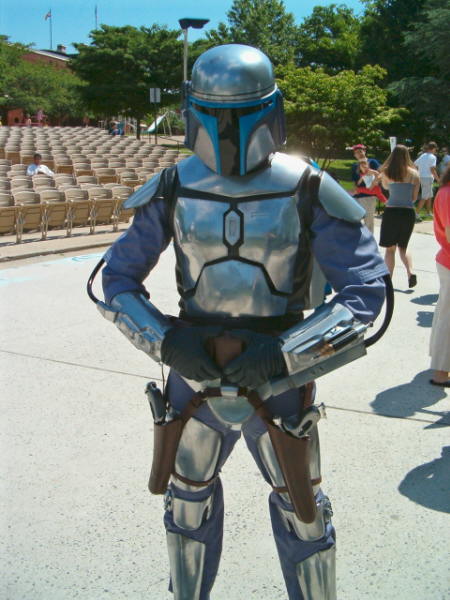

Below is my suit.
OMG!!! O_O is the shinnest armor I´ve ever seen. Dont you think this is too much shinny?
By the way, you said this is a JD armor. Is also the bottom chest piece from the JD armor, or did you change it? because it´s different of any bottom JD´s chest piece i´ve ever seen.

Thx,
That was a shot in direct sunlight; it looks much ore weathered than that in person. I modified all of my JD armor,except the thighs, quite a bit.

Thx,
I see. Can I ask how? Specially the bottom Chest armor. Is the only part Of JD armor I dont like...
