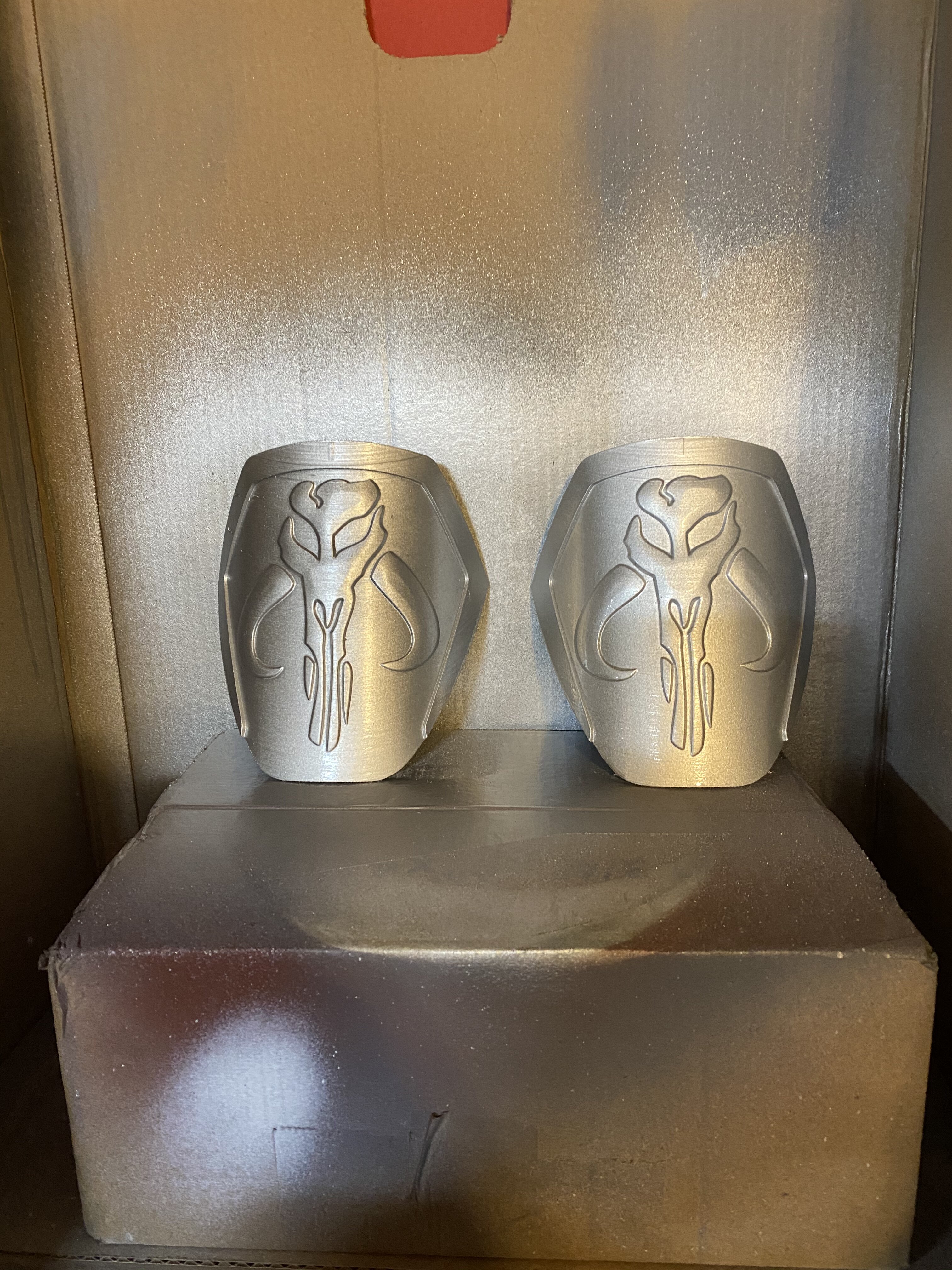

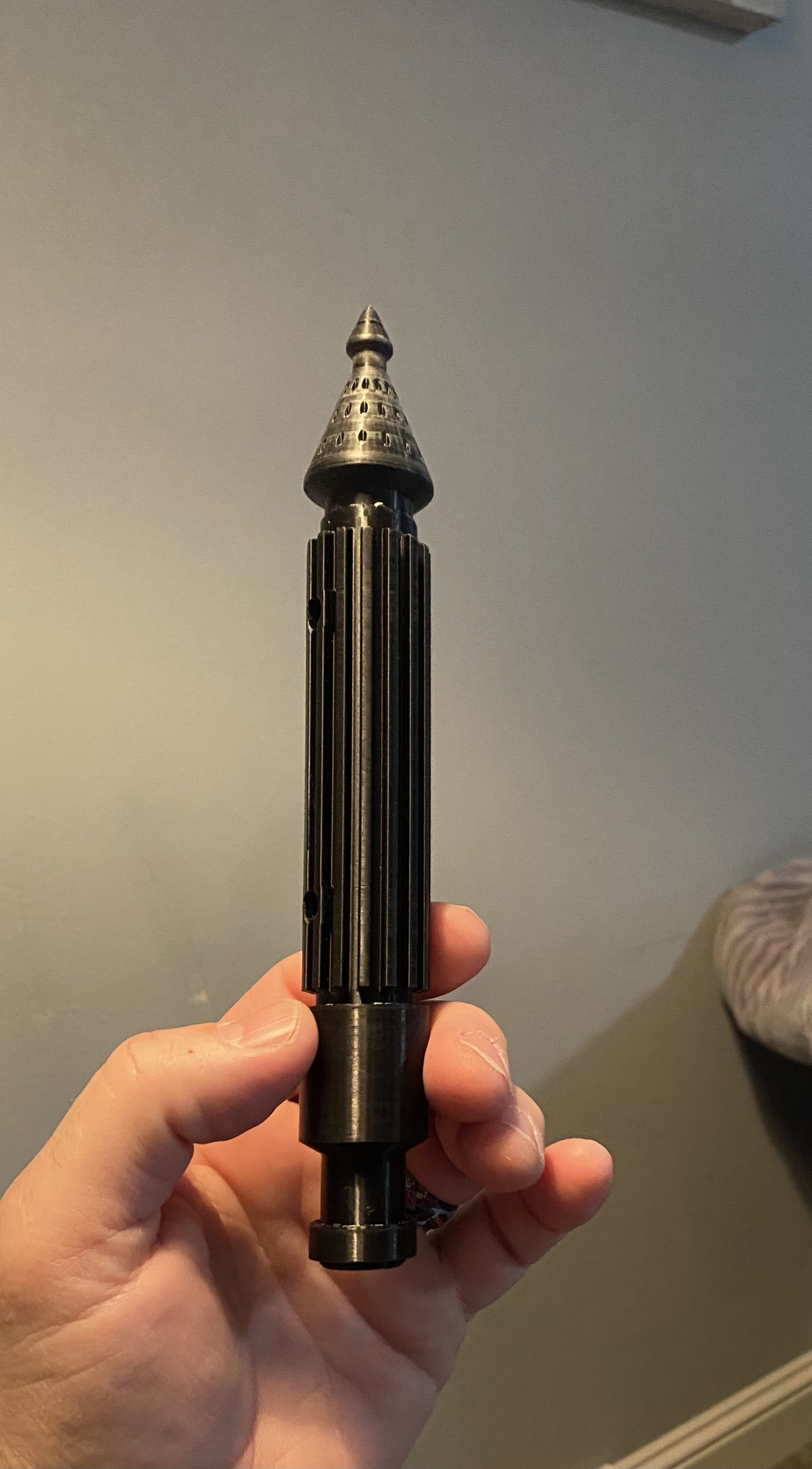

Not an expert here by any means , but I've been dipping my toes into the 3D printing world , for small parts I have a flash forge adventure 3 lite , and just ordered a creality cr10

Interesting, the parts look good and it seemed to handle the small details well from what I can tell. Im sure I'll have a ways to go once I get ahold of a printer on learning the process.
