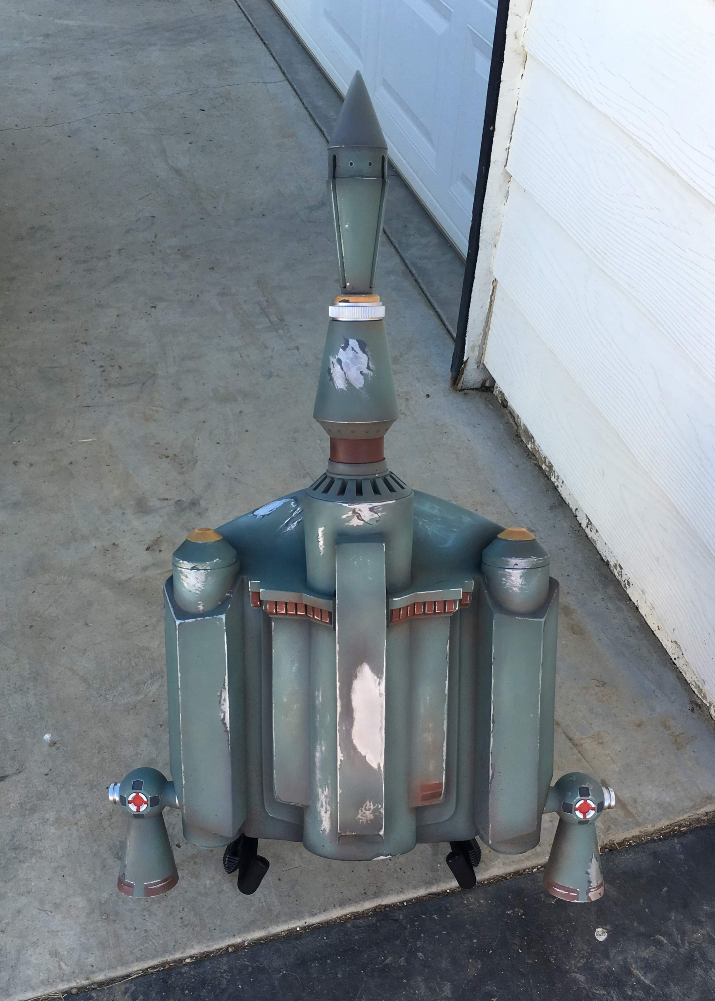

@skaalaluke, I had a similar problem with my MOW jetpack, and I think it was due to insufficient sanding in preparation. I found the surfaces I really worked over held the paint fine (I used the same kind Fettastic mentions), but on some I thought smooth enough I had a real problem with peeling. After sanding further, the paint then stuck fine to those areas.
Thanks, and good call Dv8r! If you don't sand before applying the primer it won't have much to cling to especially on these MOW jetpacks. They are super smooth. I washed mine thoroughly, sanded and wire wooled before I added the primer. I also Wire Wool in between each coat of paint.
Thanks everyone for the great advice, I am working in a climate that can be a beautiful 70 degrees one day and then 95 with 100% humidity the next (midwest). I definitely didn't do enough prep work to what I'm painting but in between the final layers here I'm going to do more wire wooling(not sure that's a word). Thanks for everyone's advice!

Try not to paint when it is super humid, or super dry. If it's too dry the paint can evaporate almost immediately trying to create a balanced atmosphere and leave uneven paint strokes. When it's too humid the paint won't dry and cure correctly. I think the ideal humidity is 40% but obviously nobody is going to wait around for that perfect level...Unless you can paint in a pretty controlled environment like a garage with a humidifier but then again you don't want to be painting in a really enclosed environment. It's a science. And I'm no expert but I believe in this field, he who preps the most is king. Don't rush, take your time and enjoy the project.
