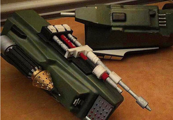

Gauntlets are 90% done. Got braided hose from Home Depot, will attach that with E6. Just need to decide if I'm going to glue or magnet the flamethrower at this point.

As for the flamer...i screw mine on. DONT use magnets. It gets caught on things every now and then and if your going to troop it alot, you will rip it off 1 too many time using magnets. I say use screws if you can, or worse case, glue it with E-6000.
Ended up going with E6000 on it. I may reinforce with screws later, but it seems pretty solid. I think the slight flexibility of the E6 will help if it gets snagged. Hopefully. :)

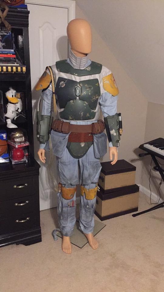

Looking pretty sweet! The only thing I might change is perhaps tone down the flight suit color with some bleach, it seems still a little too blue... Also, the collar seems a little high? Otherwise looking quite excellent. :cheers
Thanks. The collar is down as far as it can go and still leave enough overlap on the backplate where the collar studs attach. I'm planning on moving the chest pieces up about half an inch, so that may change the perspective.
His you collar looks like it is right on the neck line so it cannot go up any higher on the vest, the mannequin is throwing it off and letting it come down forward making it look low. You push the back ends of the collar back like they should be when attached to the back armor and it will be right where it needs to be. The armor does need to go up a bit though.

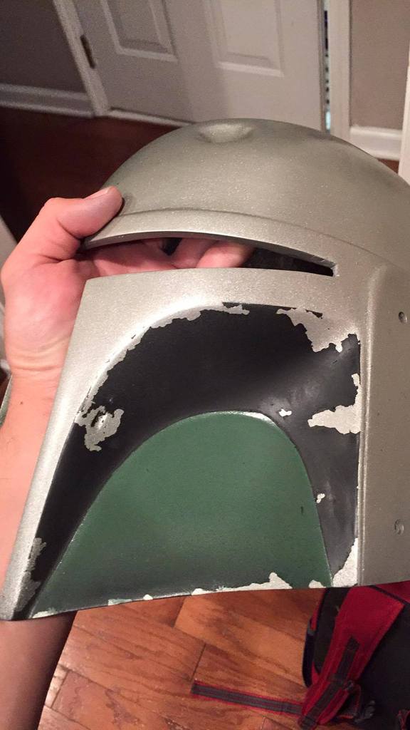

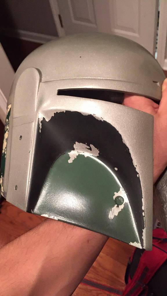

Back panels using Rafal's stencils (http://www.thedentedhelmet.com/f23/boba-fett-esb-helmet-stencils-41899/) and AFFO$'s rattle can list (http://www.thedentedhelmet.com/f23/affo-s-paint-list-airbrush-challenged-11819/)
Masked off all three colors (silver, gray, and concrete/khaki). I went with blue mist over hunter green. After pulling up the masking, I noticed that the stencils must have moved a bit while I was tracing (doh). I've repainted this bucket three times now, so I'm sticking with it.
Next, I sprayed the colors onto a paper plate. I used these paints for the next "layers" and touched them in based on the stencils with a fine brush. It's not perfectly accurate, but quite close enough for my taste. Finished off with a little bit of green/gray "weathering" in the hunter green area. I'm guessing my final application of Dullcote will take that sheen right off.
Once I've weathered it with a light blackwash, I think it'll look great. Next up is cheeks, then the dome, and finally the red all the way around.
Oh forgot to post up about my stencil woes. I had used Valspar Silver Metallic as my base coat. The carbon would NOT stick to this paint, no matter how hard I pressed or how much I sanded it down. I ended up stripping the bucket. Again.
Took back the Valspar paints, and luckily Lowes refunded me for every can. I got Rustoleum Paint & Primer Nickel as the base coat. All paints that will be used now are Rustoleum and Krylon, except the Tamiya for the killstripes. Testors Dullcote will serve as the clear coat.
Flight suit weathering notes: I used RIT powder dyes. One teaspoon of Pearl Grey and a half teaspoon of Denim Blue in about a quart of water. I hung up the flight suit and sprayed the majority of it with this mixture to darken the suit all over, then went over it again to make it darker in the elbows, knees, and ankles. Had to wear gloves and open up all the pouches and rotate the suit to get in the crotch and areas that folded over.
After that dried, I misted with a light gray primer rattlecan. Then went over that with a darker gray, hitting the pouches and ankles heavier. Finished off with a mist of black primer in key areas.

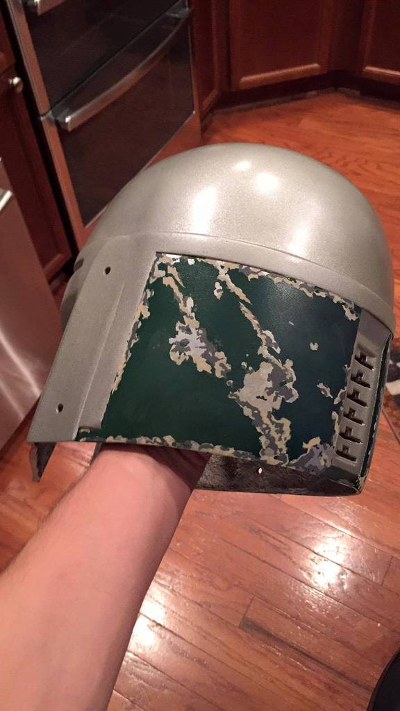

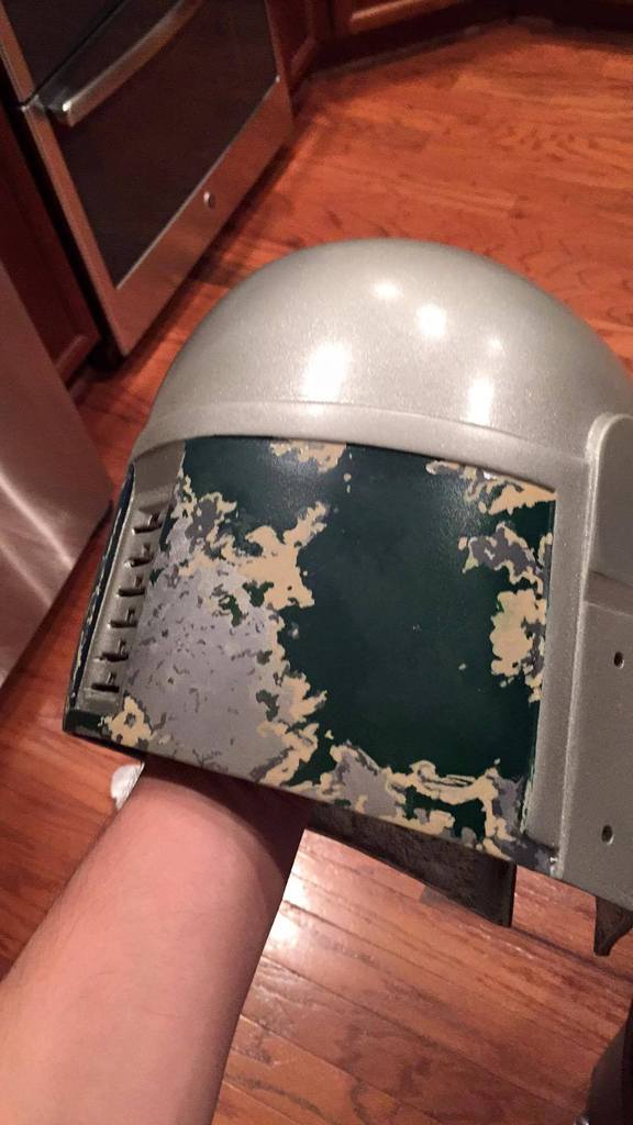

Cheeks base colors are down, will touch in the additional colors after I shoot the mandibles.

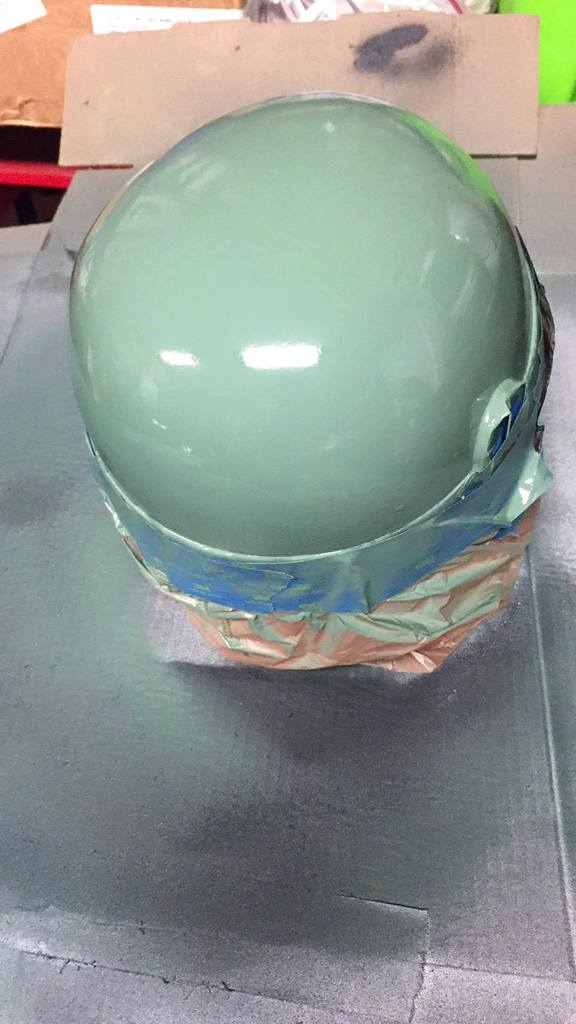

Dome was masked off and shot with Spruce Green. Can't wait to peel it off tomorrow!
Got an issue with AFFO$'s paint list. The Tamiya Mustard yellow strips off the Rustoleum Spruce Green. Not good. Starting the dome over.
