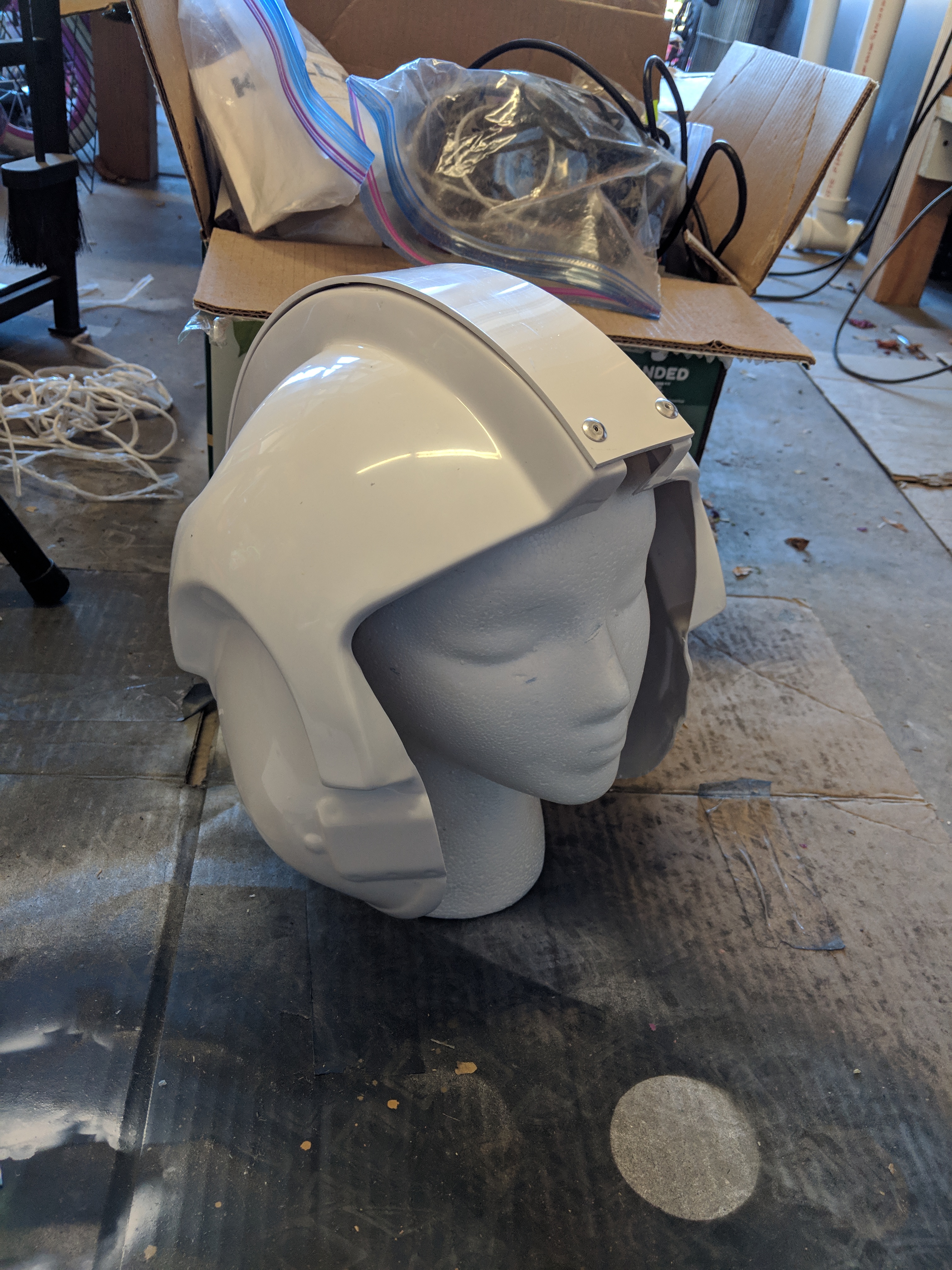

I bought a small helmet kit from Darth Hair (DHP/FX) on Etsy

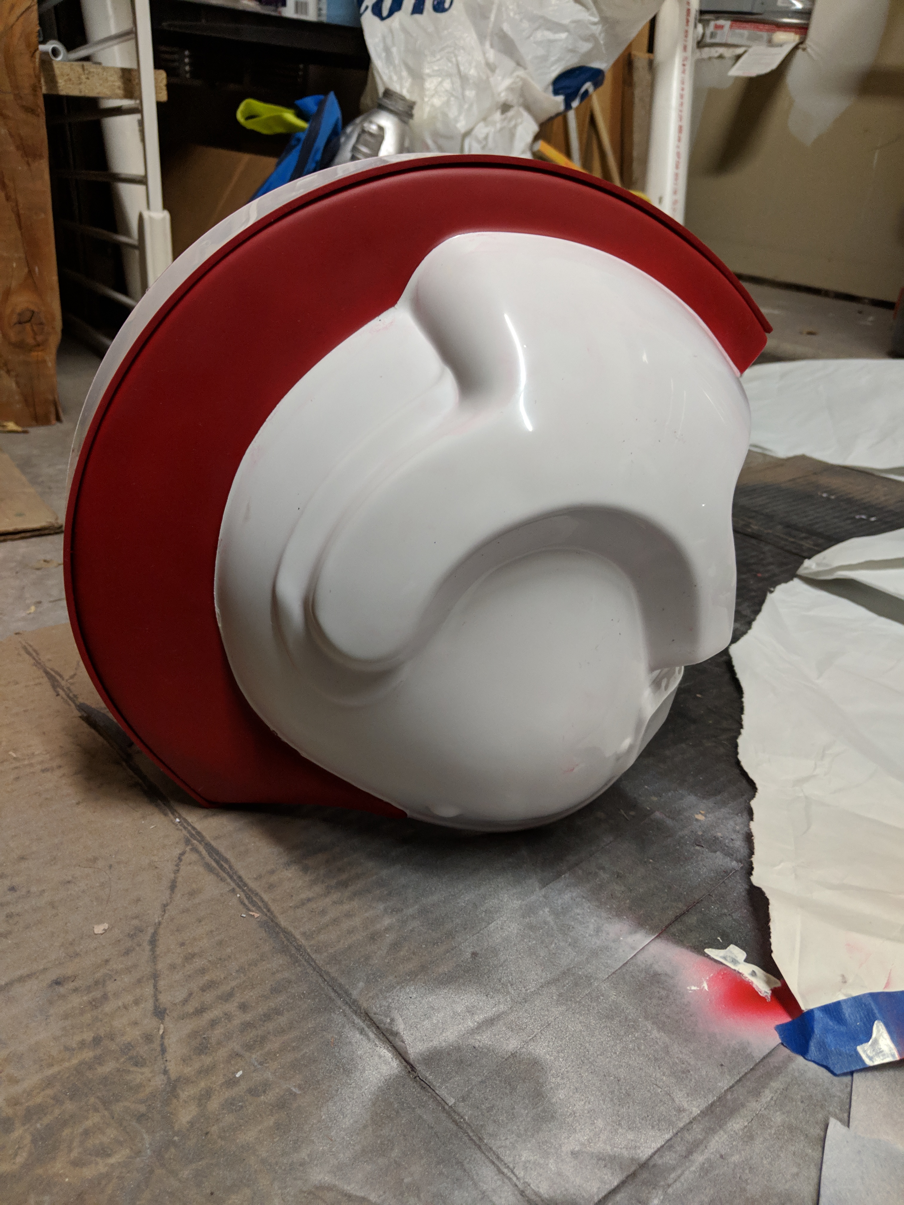

Put the two halves together and did the mohawk strip

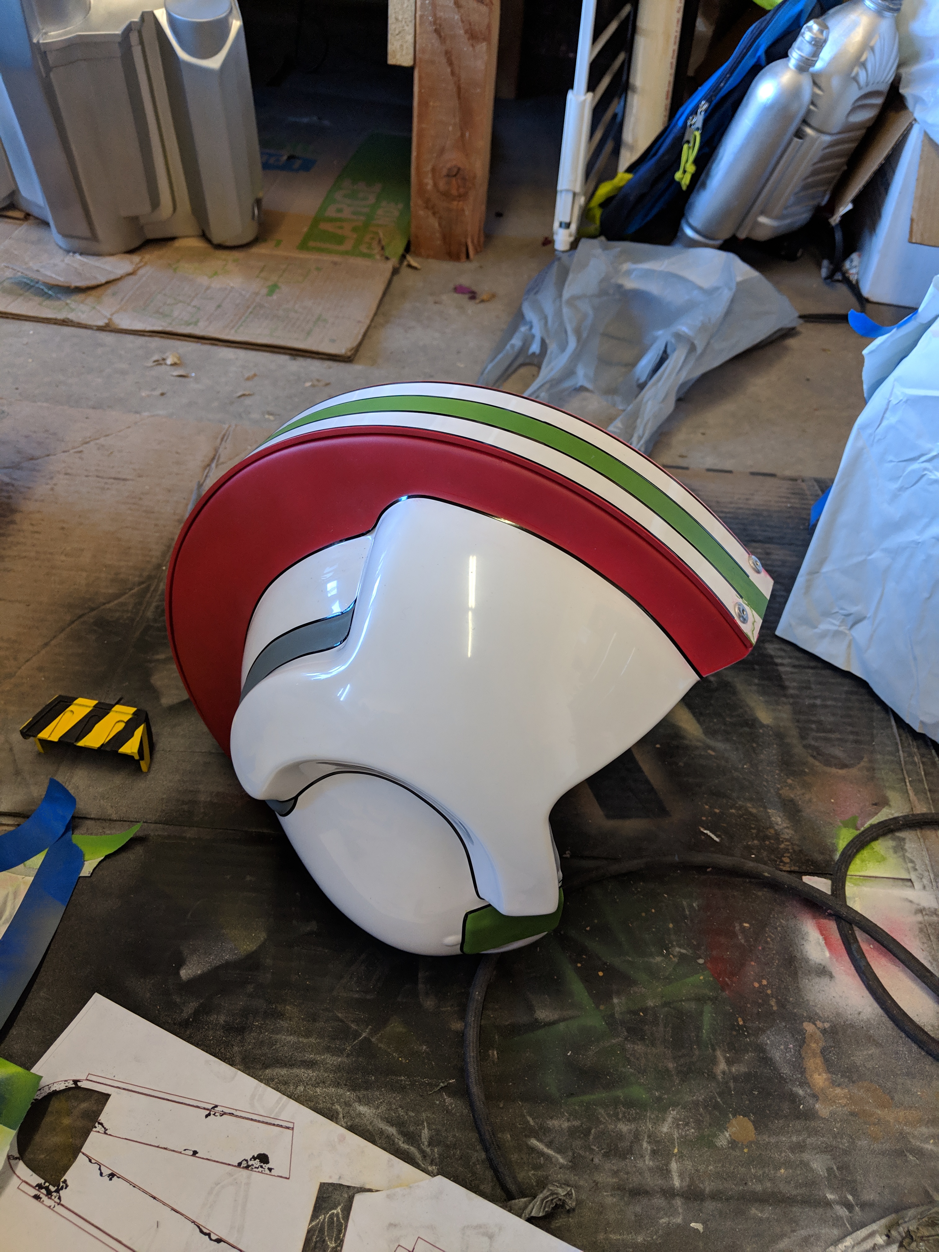

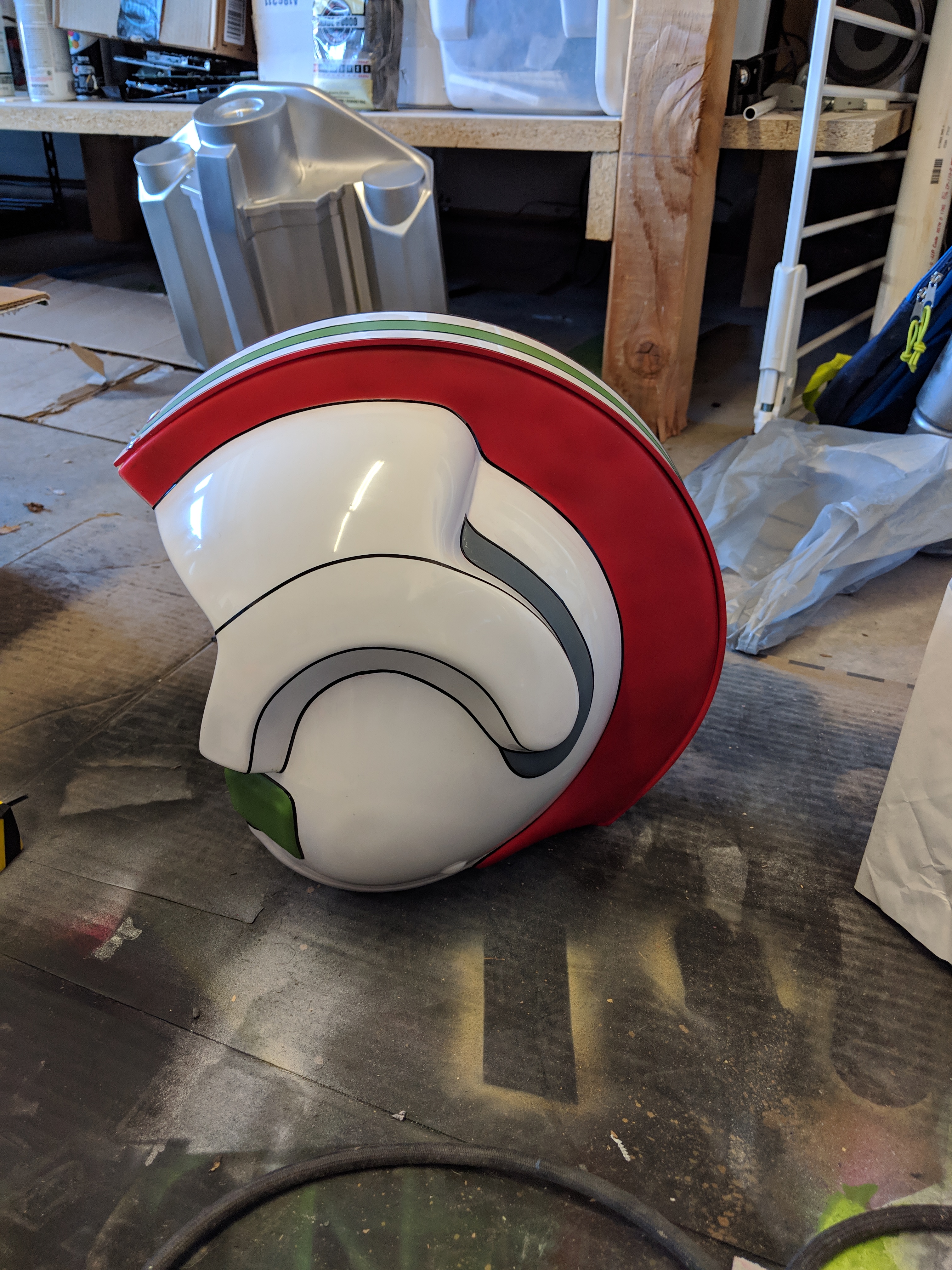

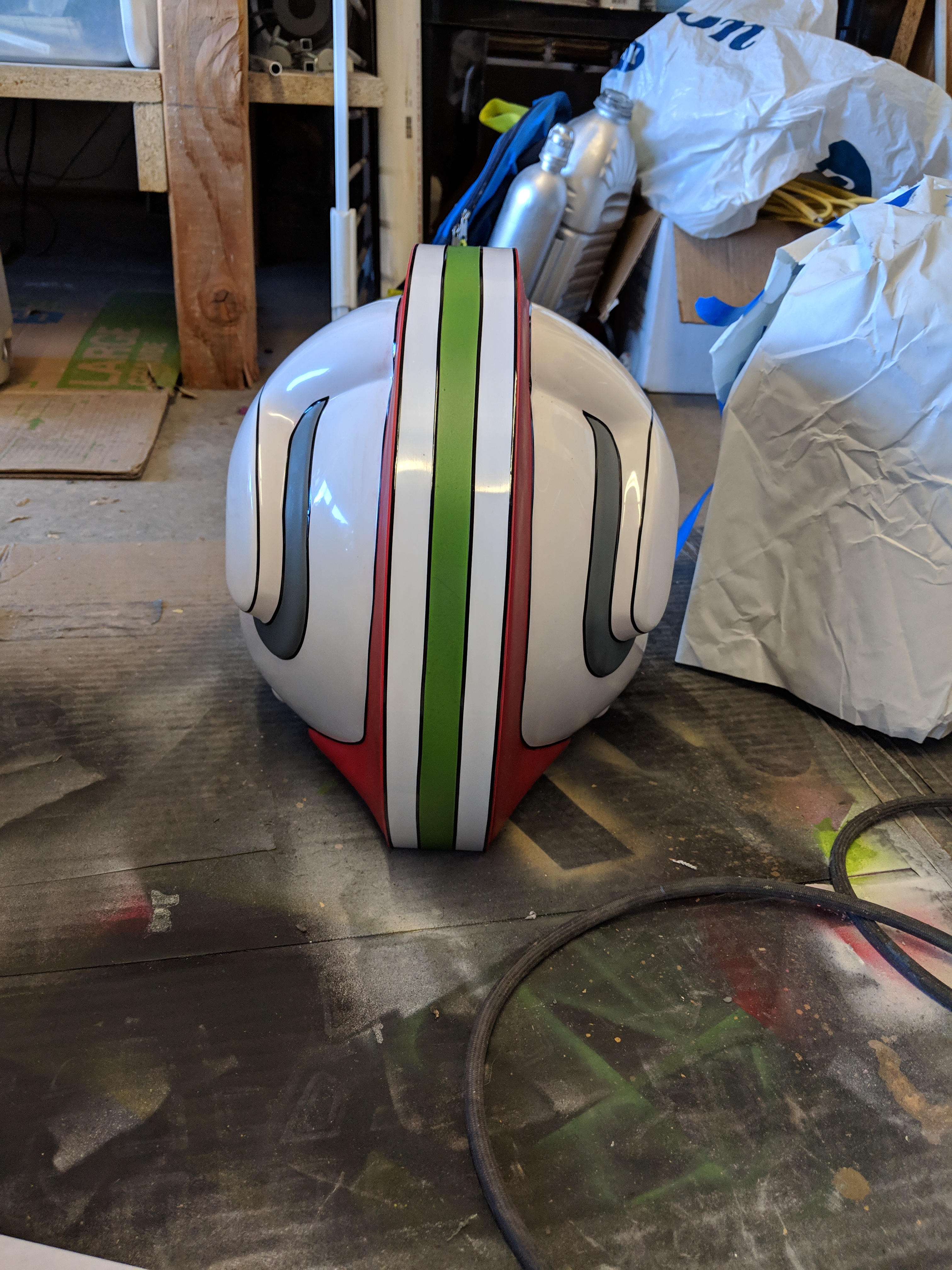

Next I painted the mohawk Insignia Red, which I'm using in the Boba build and have on hand
I added a green zinc chromate stripe down the middle of the mohawk:
I painted behind the "ears" a gray color:

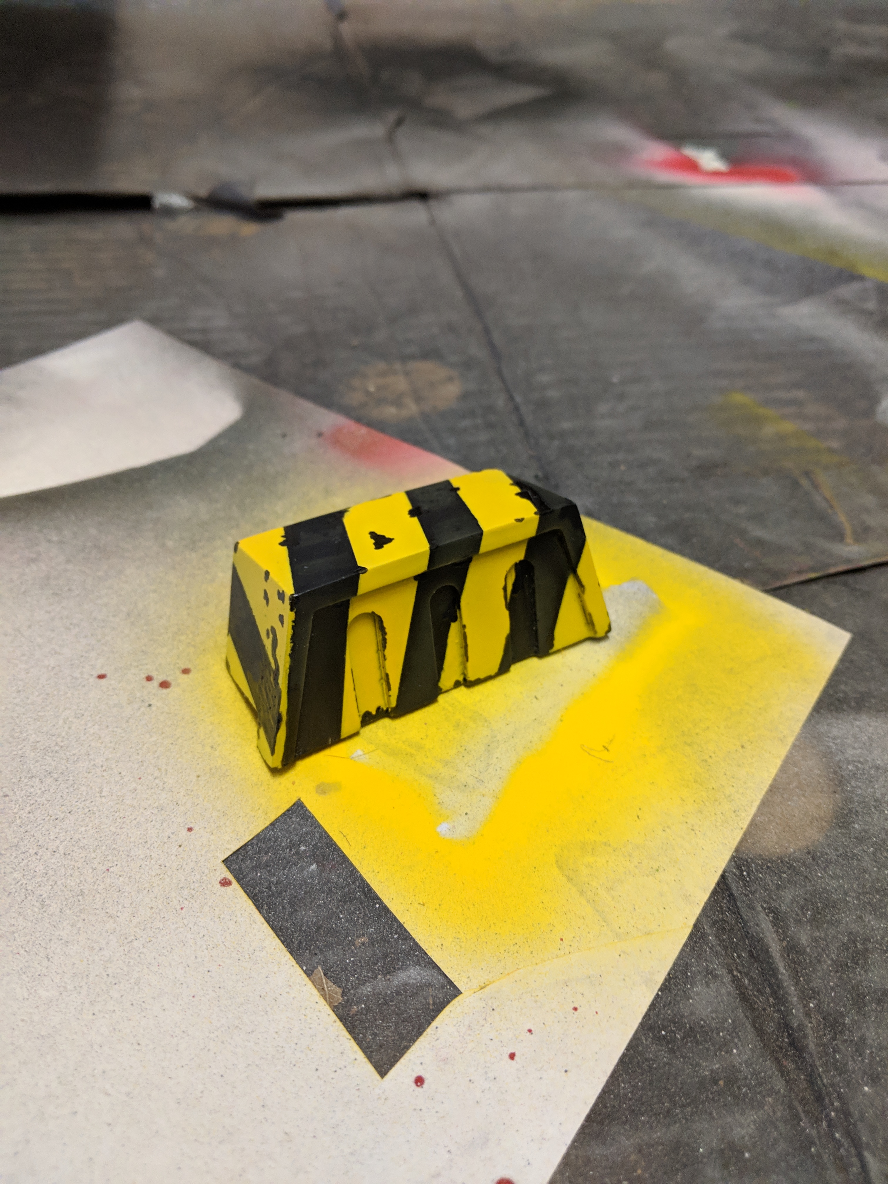

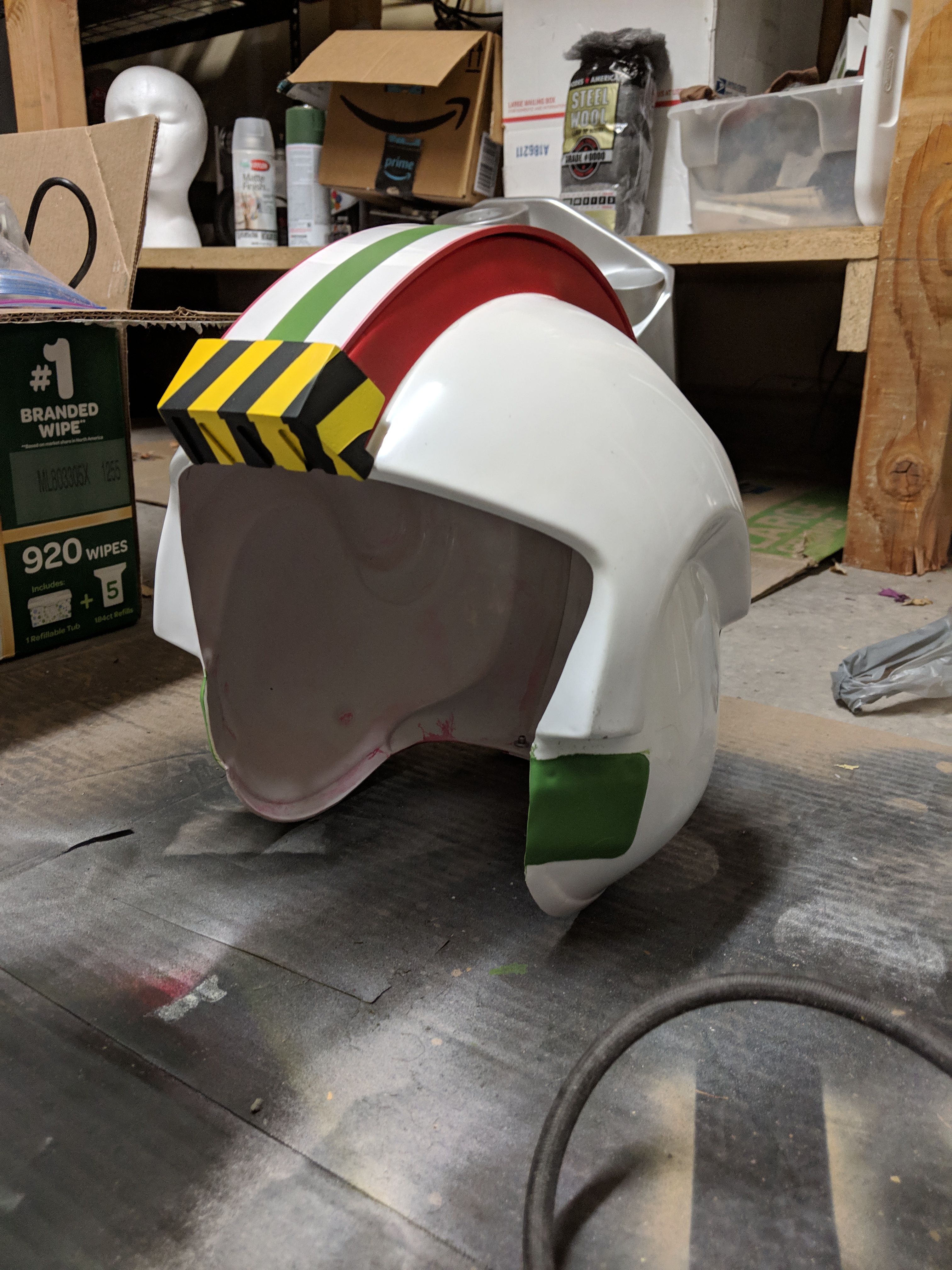

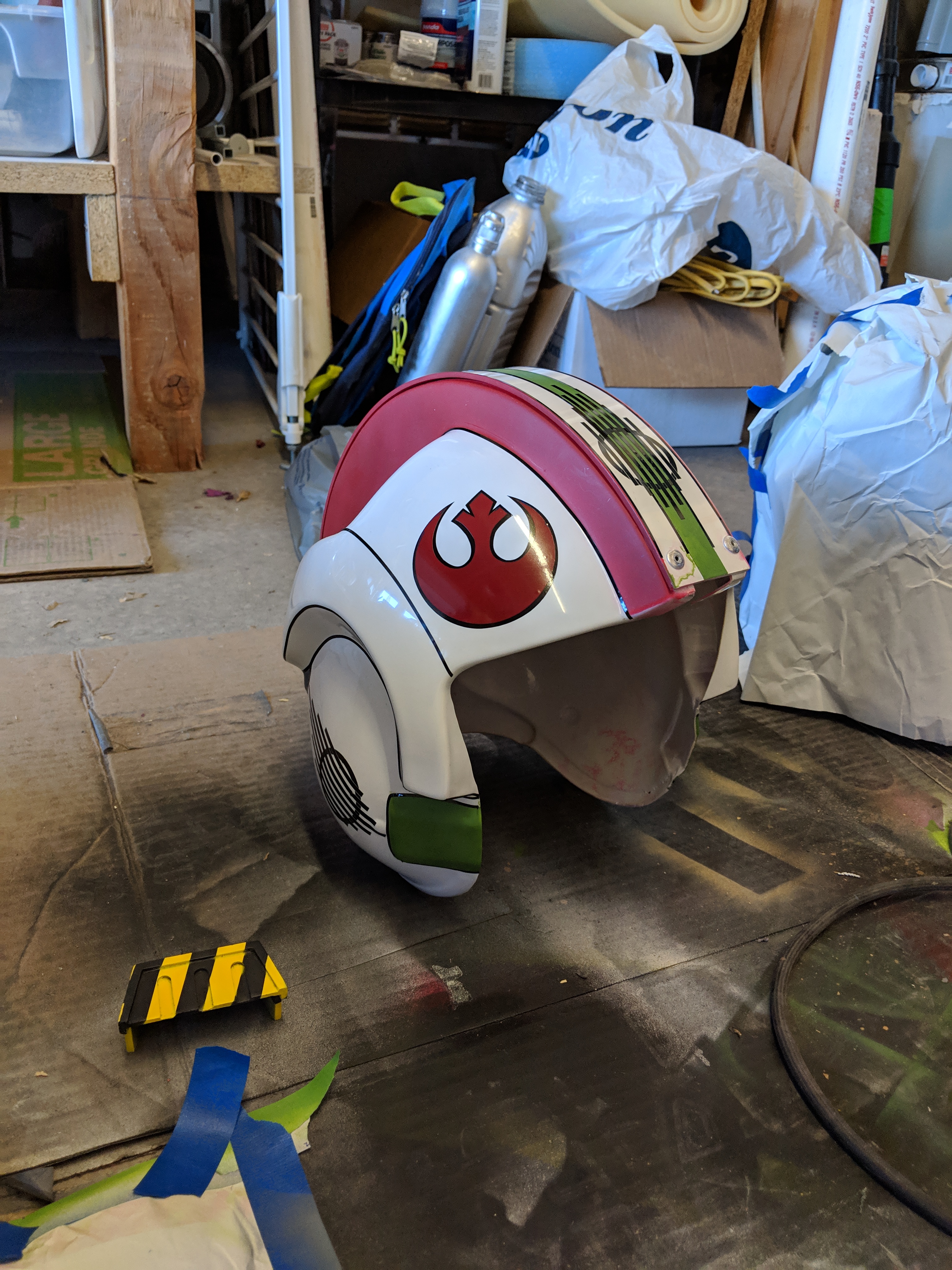

The mohawk tip is painted a hazard style, but had to be redone after this picture: Note: do weathering with black ACRYLIC paint so the thinner does not eat your paint job and you have to start over!
So I stuck that piece on the mohawk to see how it would all look together. I also painted by the mouth the same green as the stripe:

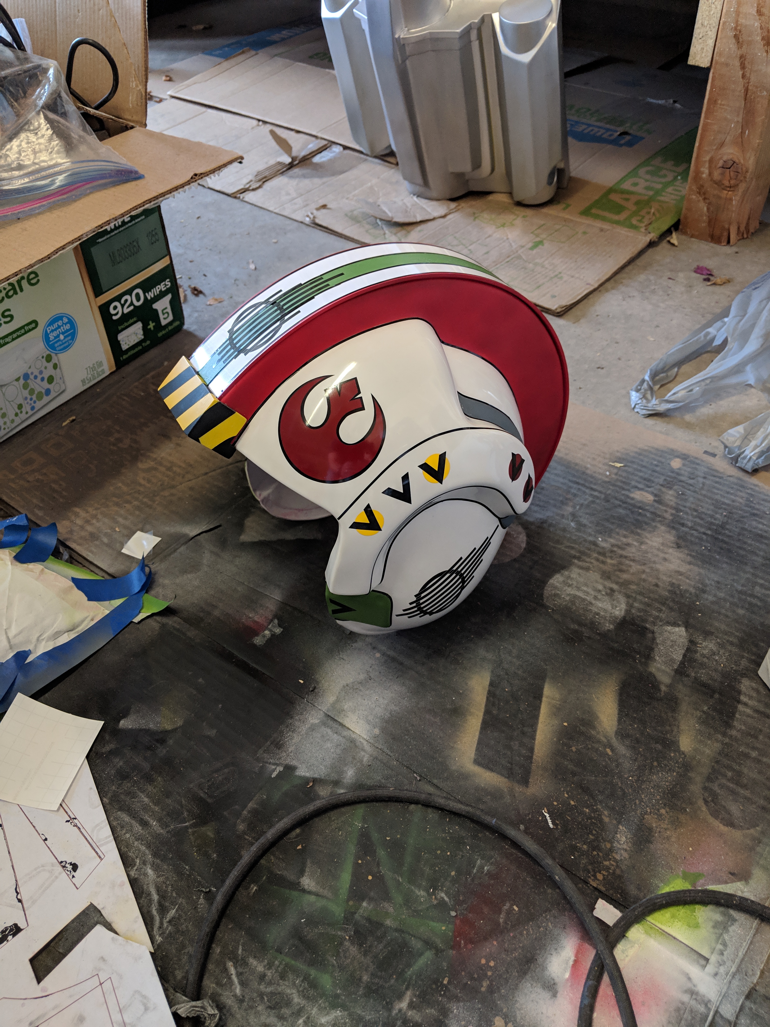

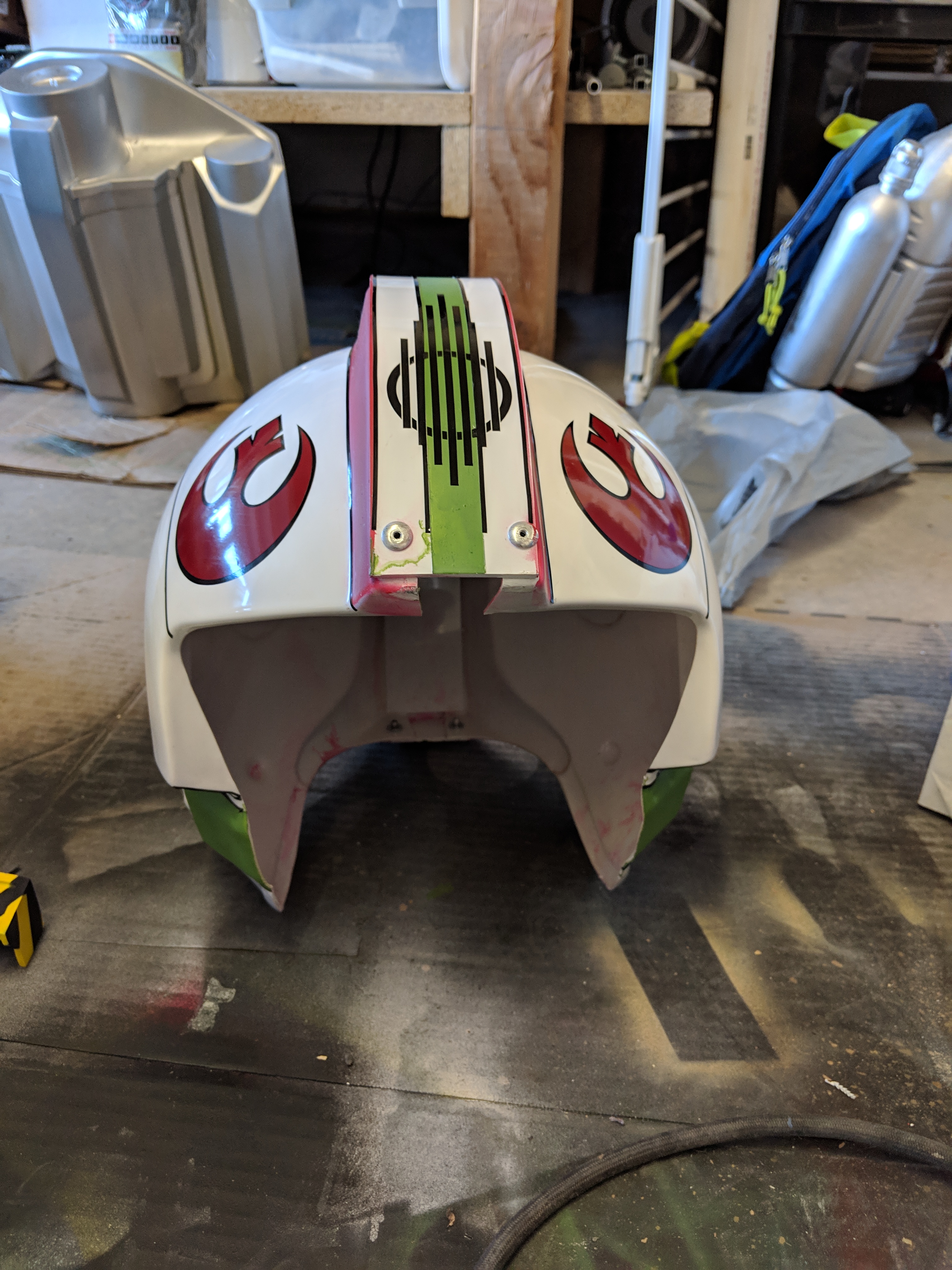

I was please with the color combinations, so after cleanup I applied the pin striping supplied by Darth Hair. He gives quite a lot and I'm really pleased with this kit!
I had more pin striping than I thought, so I added more!

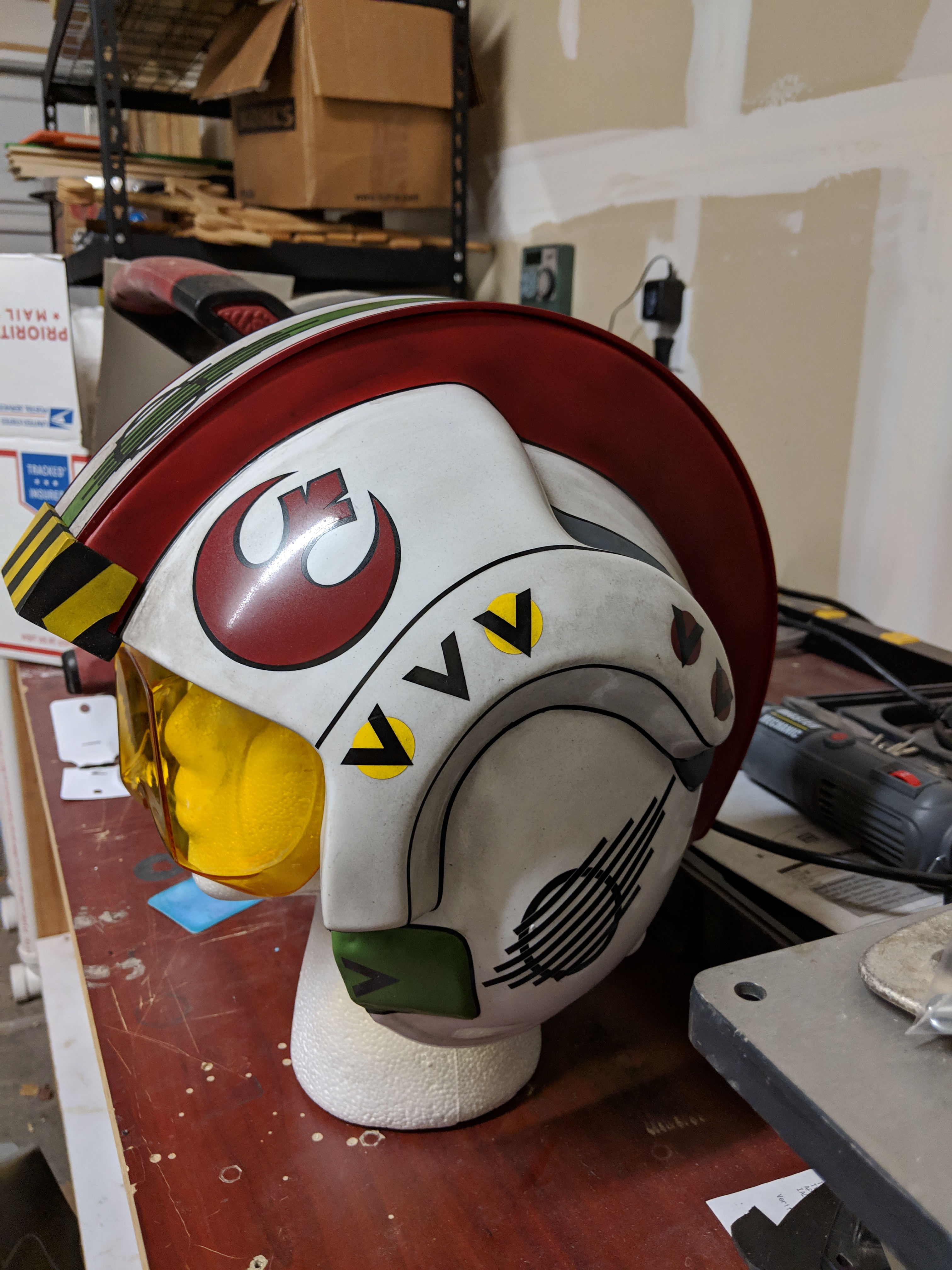

Now time for the decals! (Which are also provided)

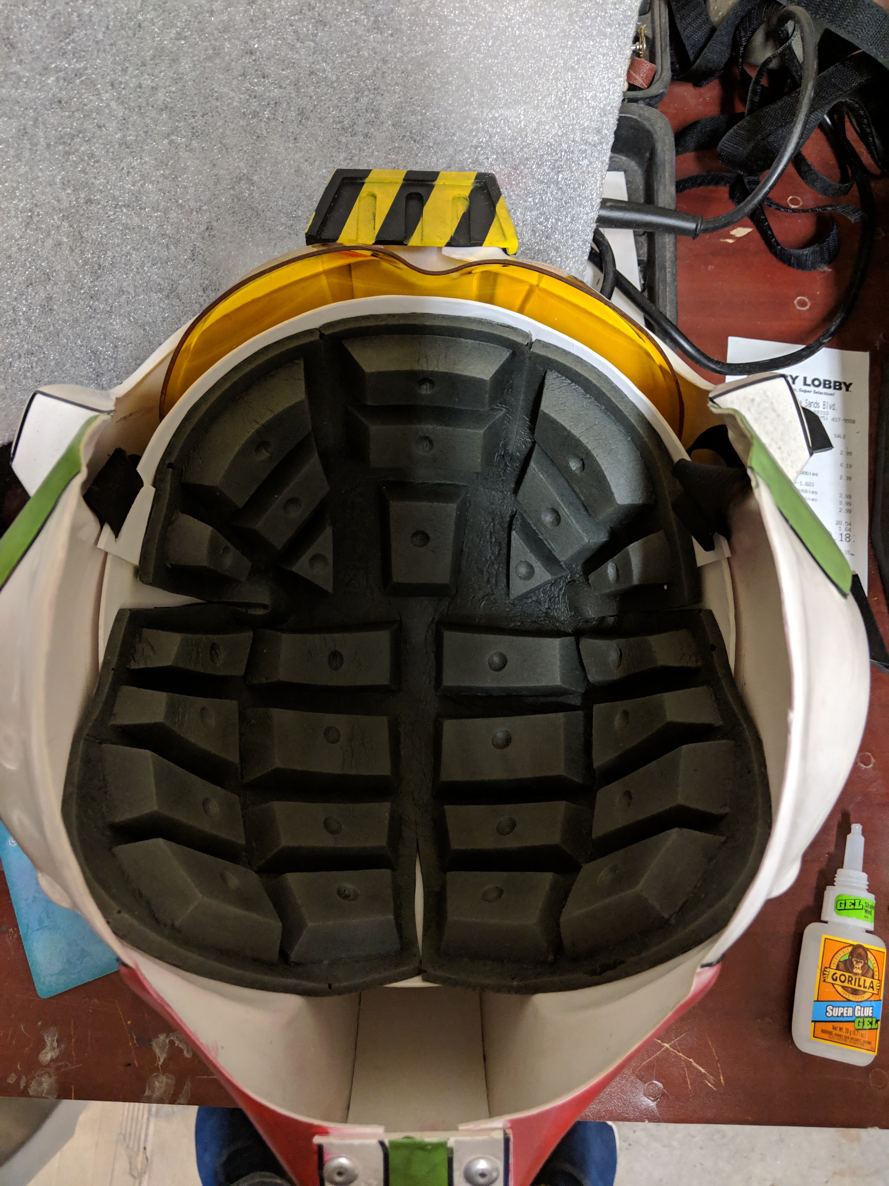

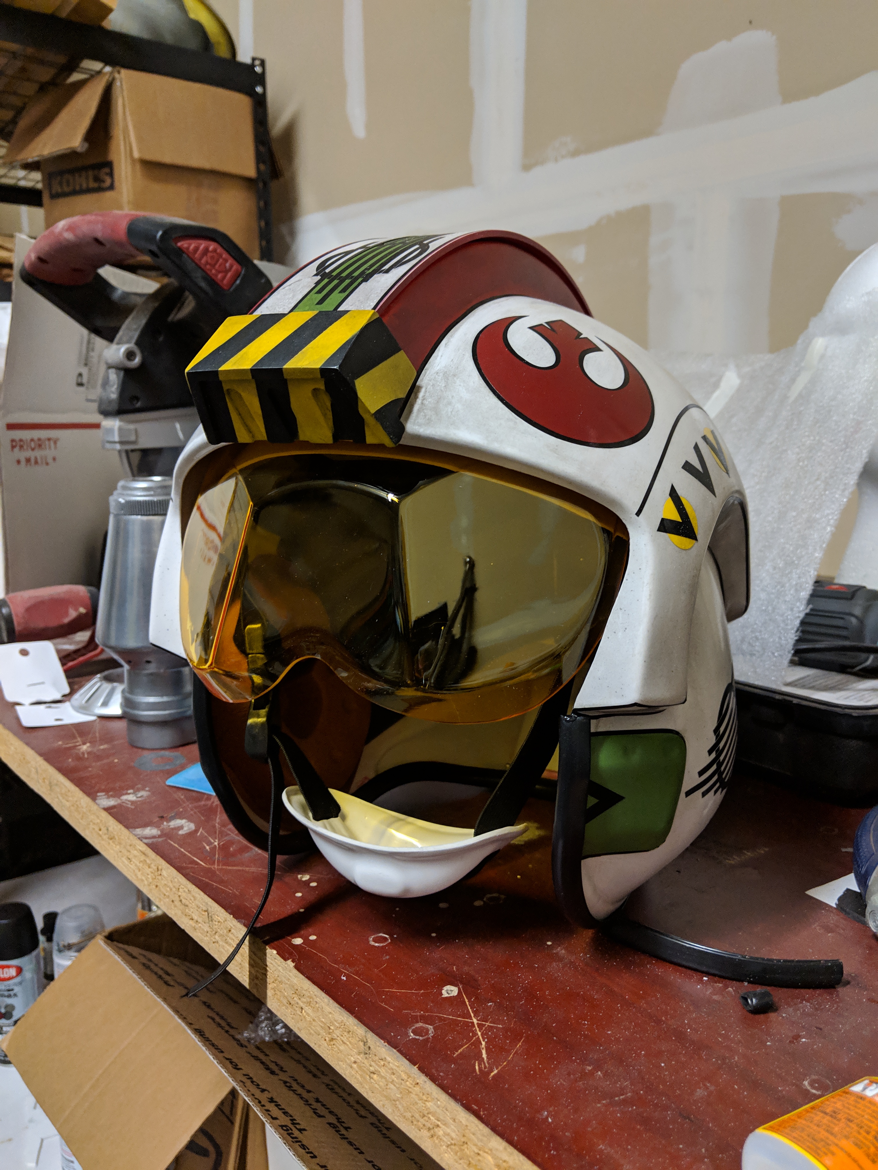

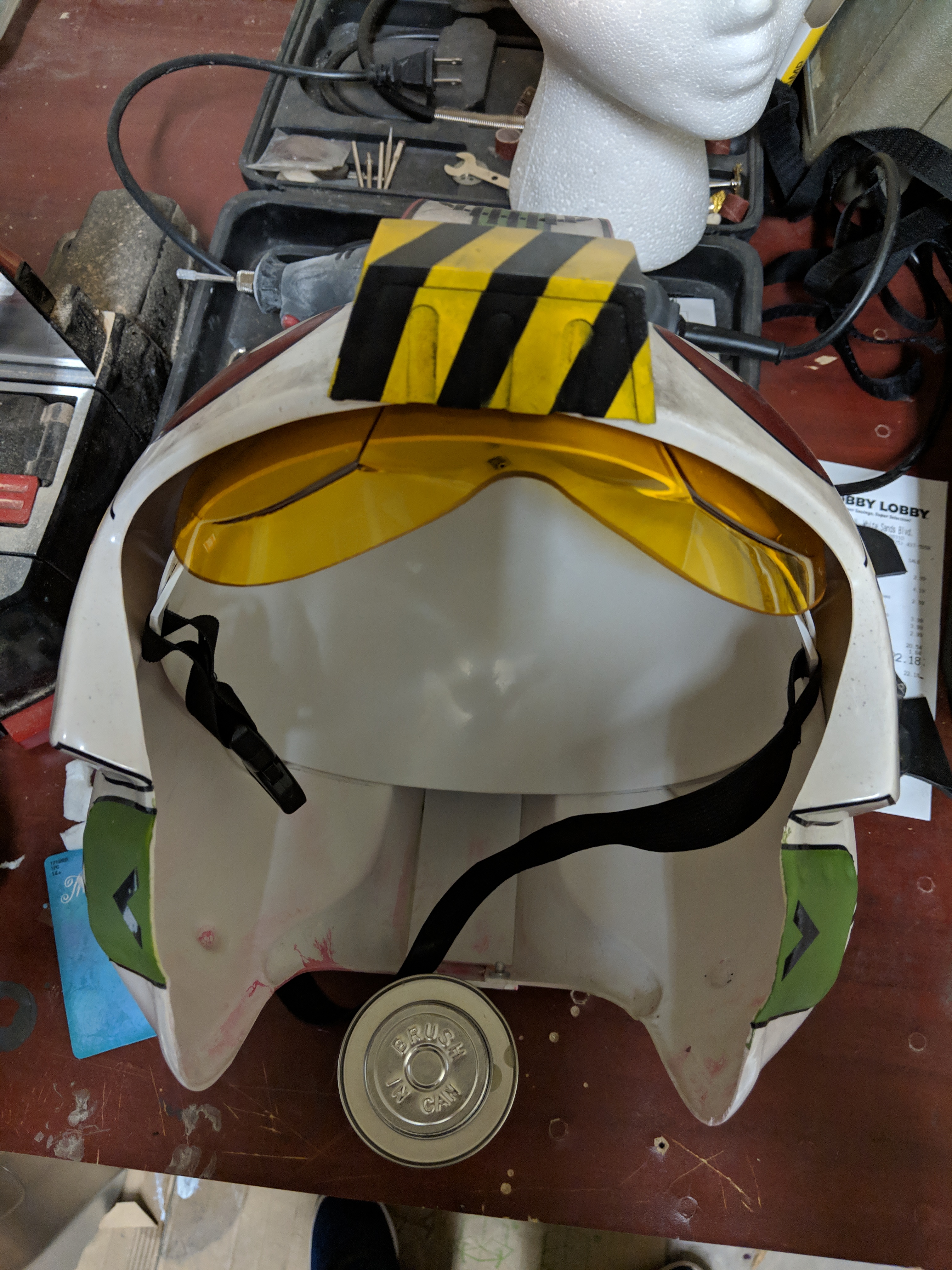

Then finally, the weathering and visor install:

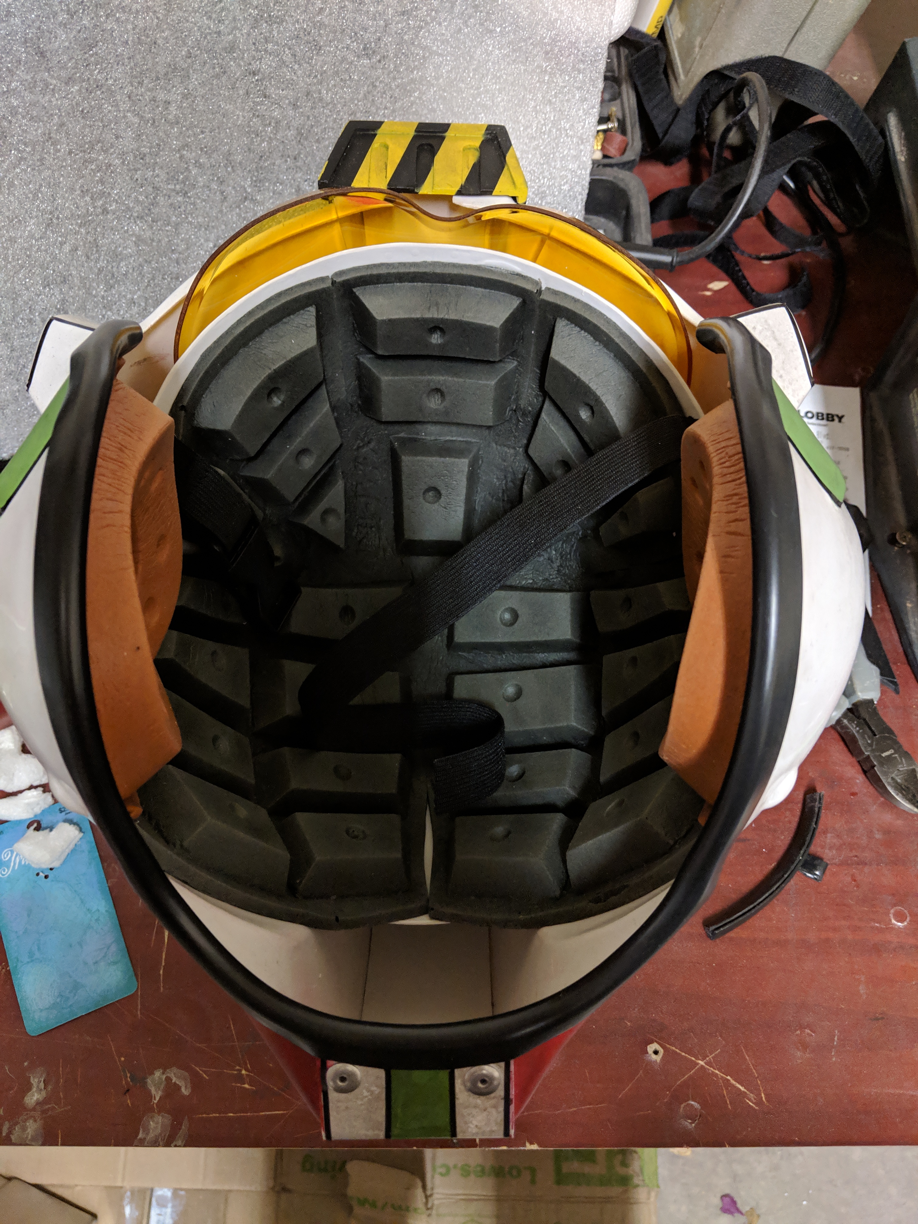

This has been a really fun and really good kit to work with so far. I still need to add the chin straps and the interior padding and the rubber seal around the edge and I'll be done. I'm not putting in the mic tip, because my toddler will break it off.
