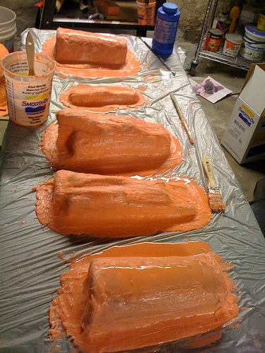

webchief came over and laid down some silicone on the infamous right gauntlet. nearly a year after assembly was complete, i'm almost ready to actually have a wearable right gauntlet!!!

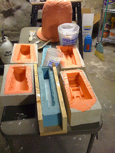

While I was molding the right arm, I also made a new mold of my revised left arm. I fixed a couple of things that I didn't like in it, and this seemed like a great time to do it. I did NOT remold the flamethrower, since that was fine. No reason to replace perfectly good rubber! Note that the gauntlets aren't all wavy as the molds might make it appear... There is a lip over the top of the gauntlet, and that lip isn't trimmed straight.
I used plaster of paris for the mold jackets since it's cheap and dries fast. i'm painting in the resin anyway, so it's not like I have to slosh around heavy blocks. It's actually nice having a base with some weight to it... Makes it stay nice and still!

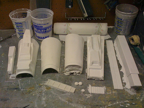

And here's the first pull of the right gaunt!
And a back shot:
They are only roughly trimmed here... I have to cut the openings properly before assembling.
I also need to make up the greeblies. I'm not bothering to make resin casts of plumbing items that can be easily purchased. That just seems silly.
Same with the little bar under the whipcord housing. Why make a cast of a dowel when I can just use a dowel?
