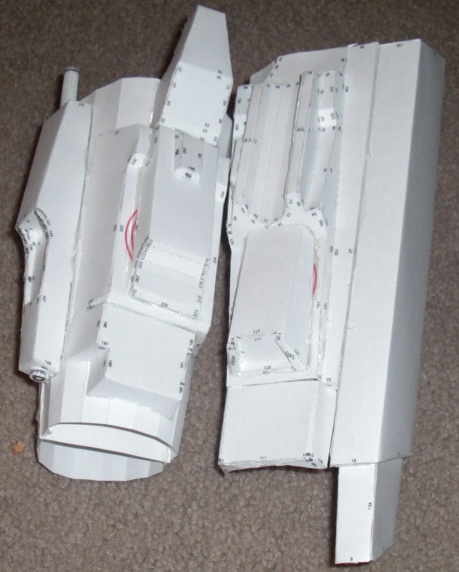

These look great stormtrooperguy! Just started working on a pair of these myself using Skip's pepakura files, just about to go and put the first coat of resin on them, hope they turn out half as good as yours did! lol :D Here are mine so far: http://joesprops.blogspot.com/2009/04/boba-fett-gauntlets.html If anyone has any suggestions please by all means let me know. :D
