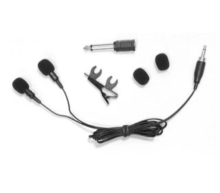

I'm doing a dual lavalier mic mounted in helmet, facing out through small hidden holes I drilled. They are spliced together (refer to pic)
That connects to an audio amplifier (rechargeable). Has volume control. That feeds to headphones thank have mounted inside the bucket.
I spliced in a Bluetooth Tx/Rx so that I can send music and other audio from my phone into the headphones.
I don't have any higher aspirations than simply hearing outside the helmet, so I'm not looking into integrating it into my phone or music player.
