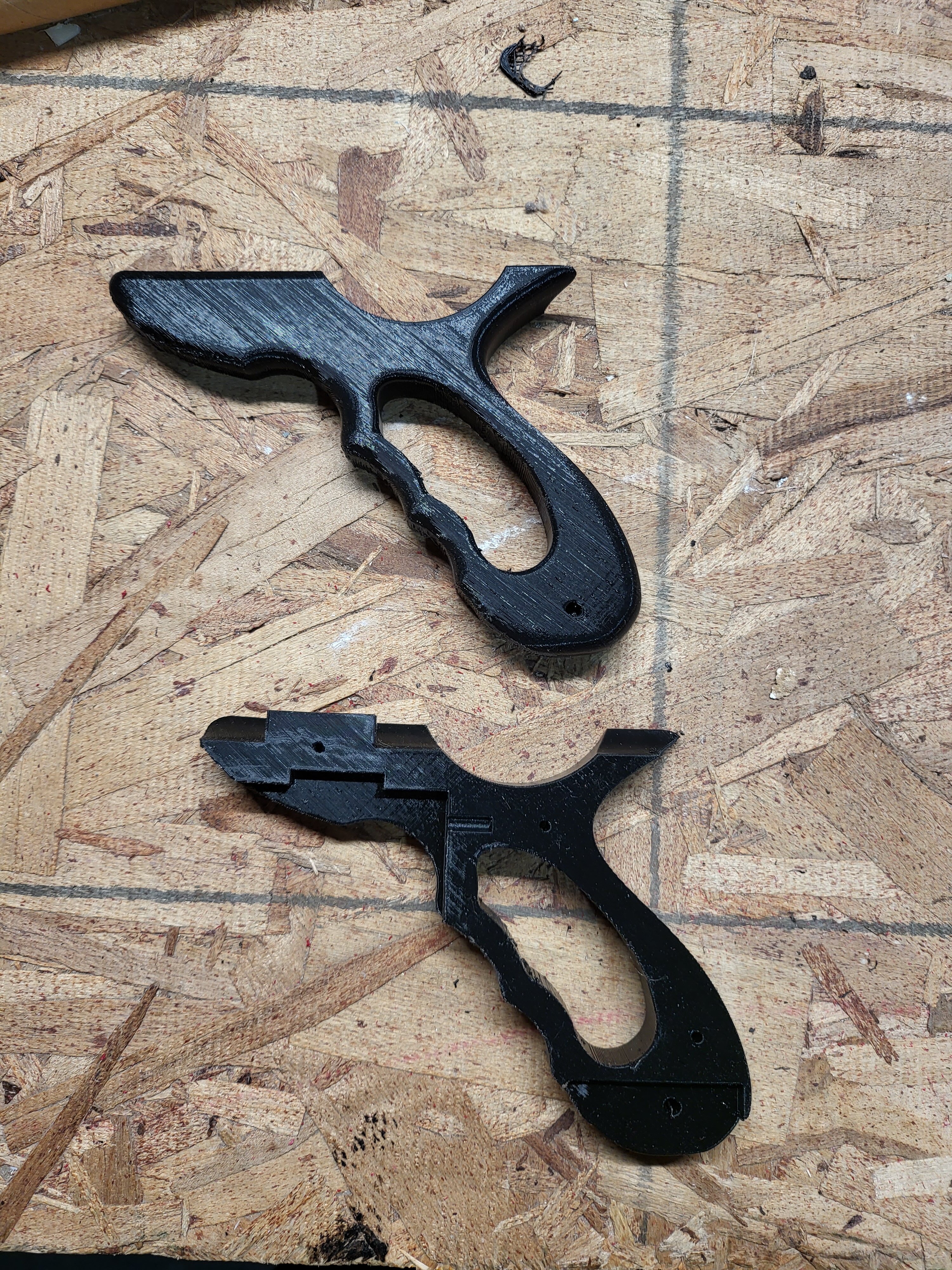

Anyways, I grabbed an STL off Thingiverse and got started with the print. The entire thing is printed in PETG with 20% infill.
The print lines on this piece weren't so great, but it was a starting point. One of my biggest regrets in this build was not spending enough time sanding! Honestly, a proper sand job makes all the difference in the world, and I quickly figured this out on my very first build!
The pieces, once sanded, were sprayed with a coat or two of Rustoleum Sandable Filler, which is absolutely amazing stuff. I will always be keeping this on hand. After I had a desired shape and smoothness, I hit it with some bondo in the rough looking patches, waited for it to dry, and hit it again with more sand paper.
If there is one thing I am going to regret, it's going to be not spending enough time with the handle. Oh well, lesson learned I guess!

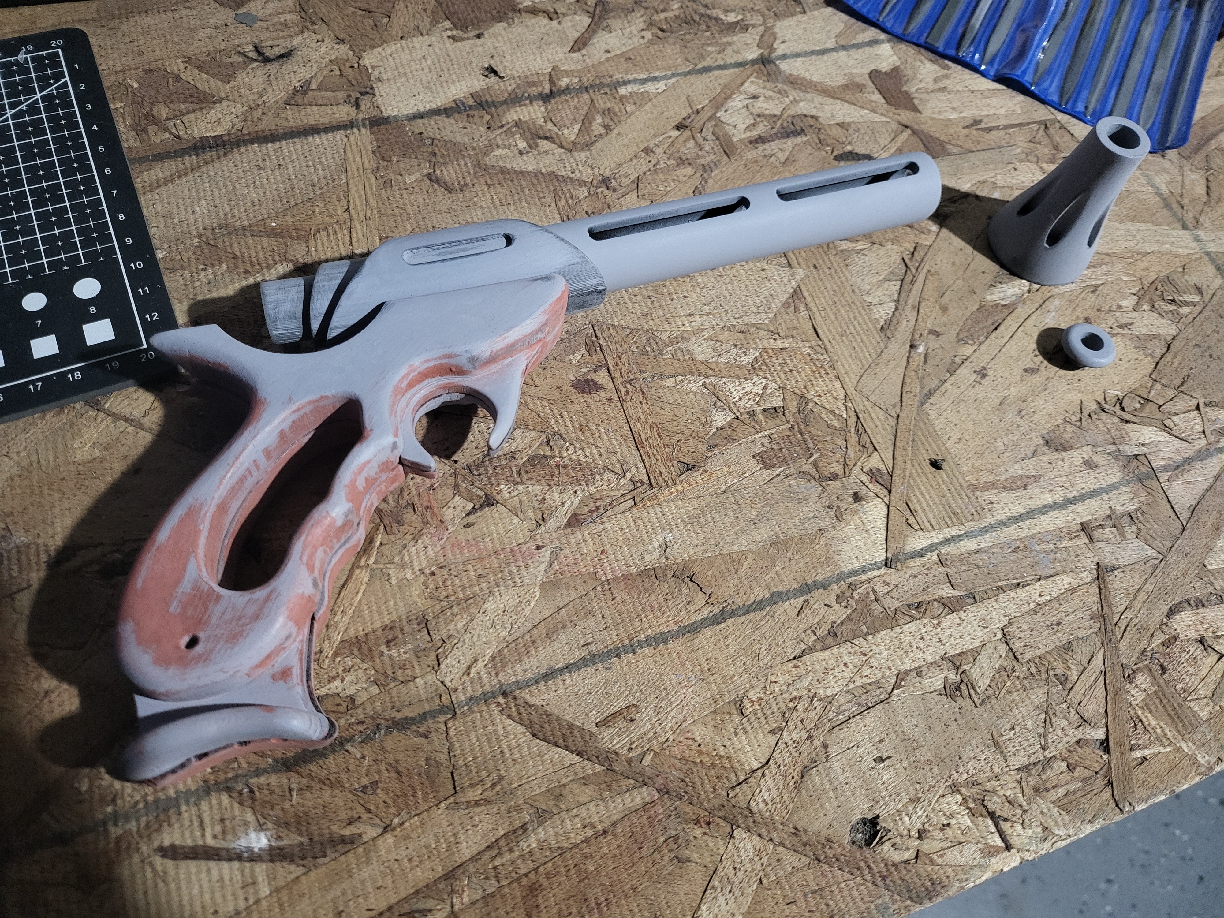

Few days after, I FINALLY got this barrel to print properly. Oh my god, was this my biggest pain point. I had spent forever and a half trying to print it on its side, and it always failed. I think this is attempt #4, and I was so happy I could have cried.
This picture is missing some pieces yet, but I absolutely had to dry fit the main components together just so I could have a sense of the finished product. I gotta say, this was my favorite part so far! Putting all these little pieces together into a (almost) finished product was the greatest experience. I'm in love with this new hobby of mine!
I took my learned lesson from the handle and sanded the barrel down as best as I possibly could. I even wet sanded it, which is a very satisfying way to do it. So far, so good!
