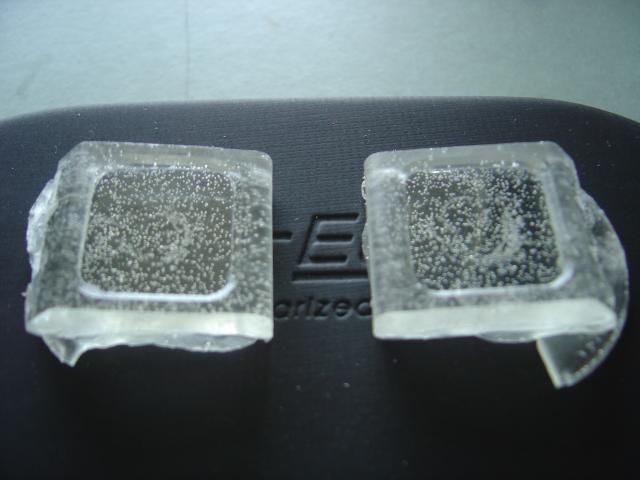

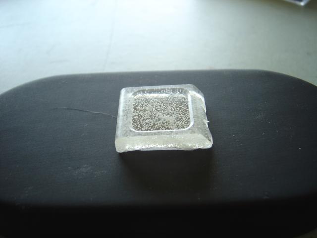

I have found a way to make it not have the large bubble in the back. Seeing that the back will just be glued to the clear part, I do not need the back of the lens. I still have the little bubbles. Those will be until I build a degassing chamber, which is not going to happen soon.

Good idea but it will not work. The resin sets in about 2 min. The best way is to be careful when mixing or put in a degassing chamber. Or cheat! Go to ebay or a flea market and look for a Polaroid SX-70 and get the lens from it. That is what I did.

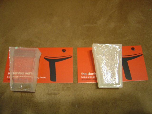

I found a different way to mix the resin and get a better result. I also have one kit ready if anybody would like it.

Have you tried a pressure pot? with a pressure gauge.
The kind that you use a air compressor with,not the stove top kind. I use one everyday at the Dental Lab where i work. The water can be room temp.
We use it to take out the bubbles in the dental acrylic when making small dentures or partials.
It may eliminate your bubbles completely.
