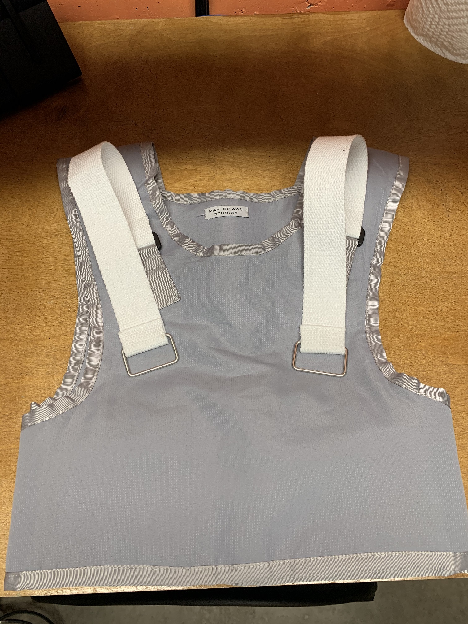

My new flak vest from Arkady arrived today can’t wait to attach the armour to it, getting close to the finish line.

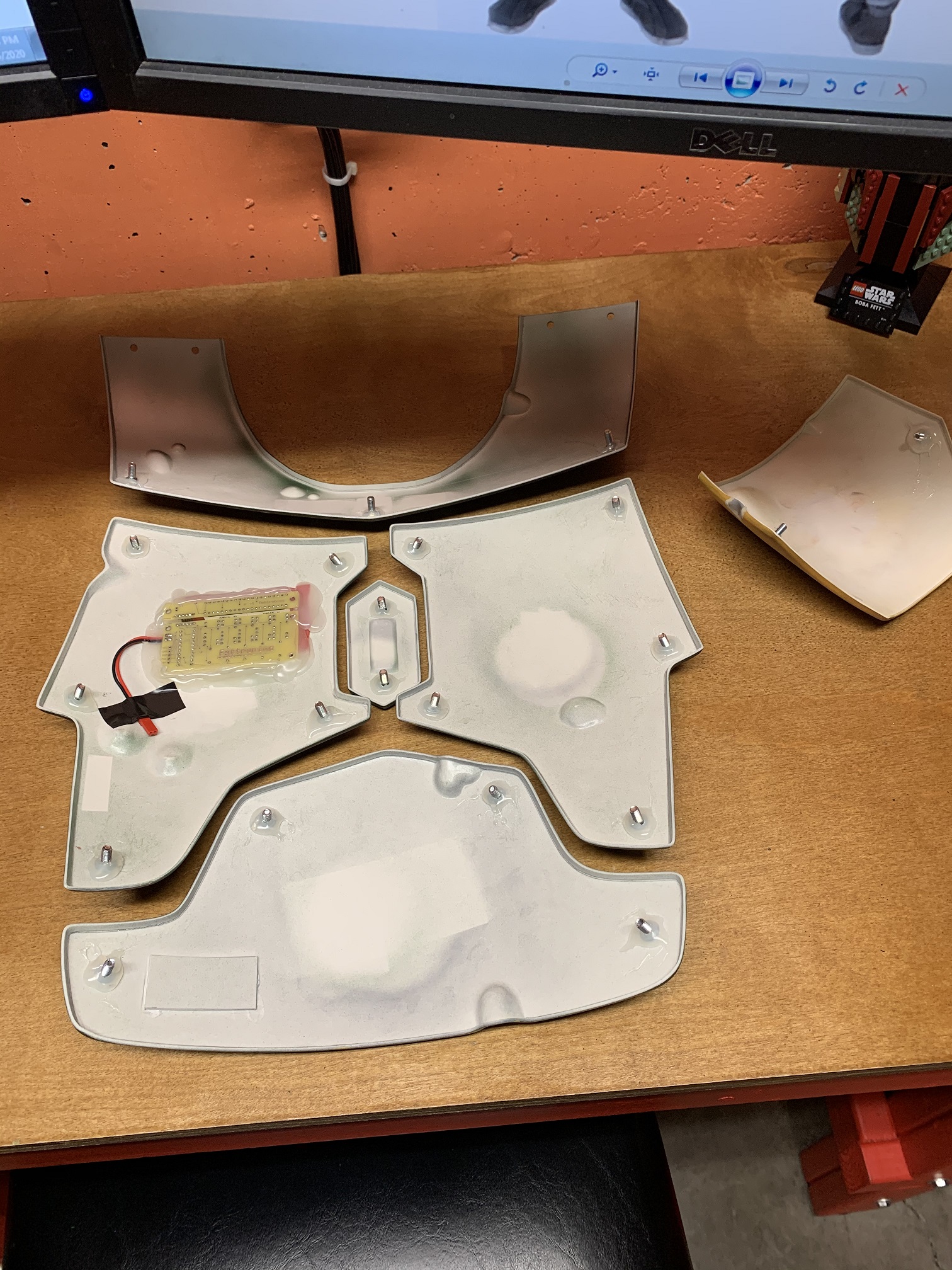

To start, I initially used hot glued for the the Stainless Steel bolts (#10-32 1/2 inch) onto the armor - which held ok for a few troops, but then one by one they started to break free from the armor. I have since replaced the Hot Glue with Epoxy (JB Weld's Plastic Bonder) and is it hasn't broke free at all....
And you'll want to be sure you DO NOT put them right at the edges of the armor - and this is because you DO NOT want any of the grommets peeking out from underneath the armor. And one last pro tip is to use a single drop of super glue to hold the bolt to the armor, then apply your epoxy.

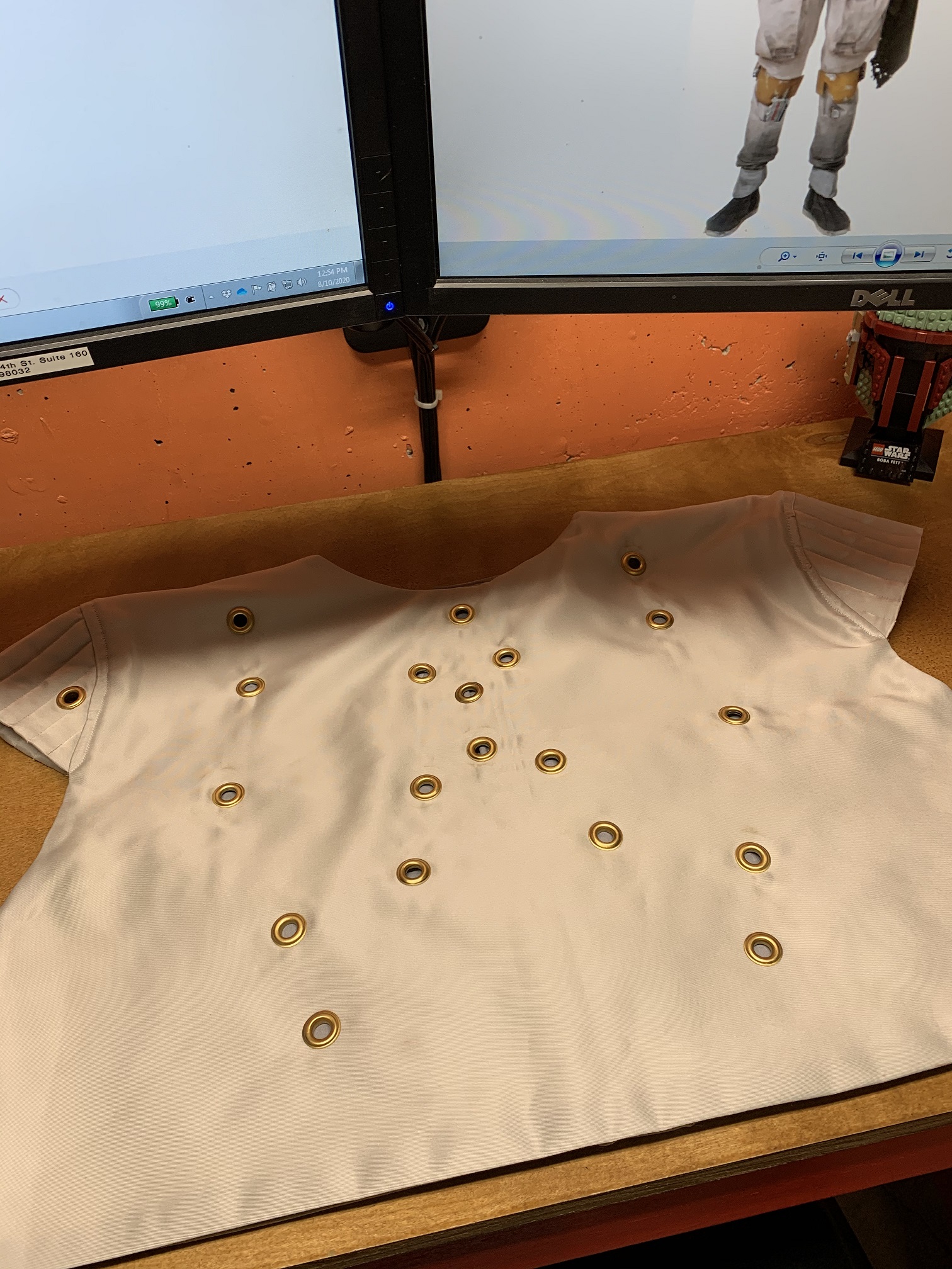

But once that is done, you'll want place your armor on your vest and then mark it out so you'll know where to put in the grommets, to do so refer to the steps and picture below...
Step 1: Place your armor with flat grommet pieces under it, and adjust where needed to get the armor looking right.
Step 2: Using something long and skinny (I used a long scissors) maneuver the grommets in a way that they'll seat the screw just right. Also go under the fabric and gently lift it to see if the screw will land correctly in the grommet.
Step 3: Do Step 2, for all other grommets.
Step 4: Very gently lift the armor leaving the flat grommets in place and then with a sharpie, put a dot in the center of the grommets.

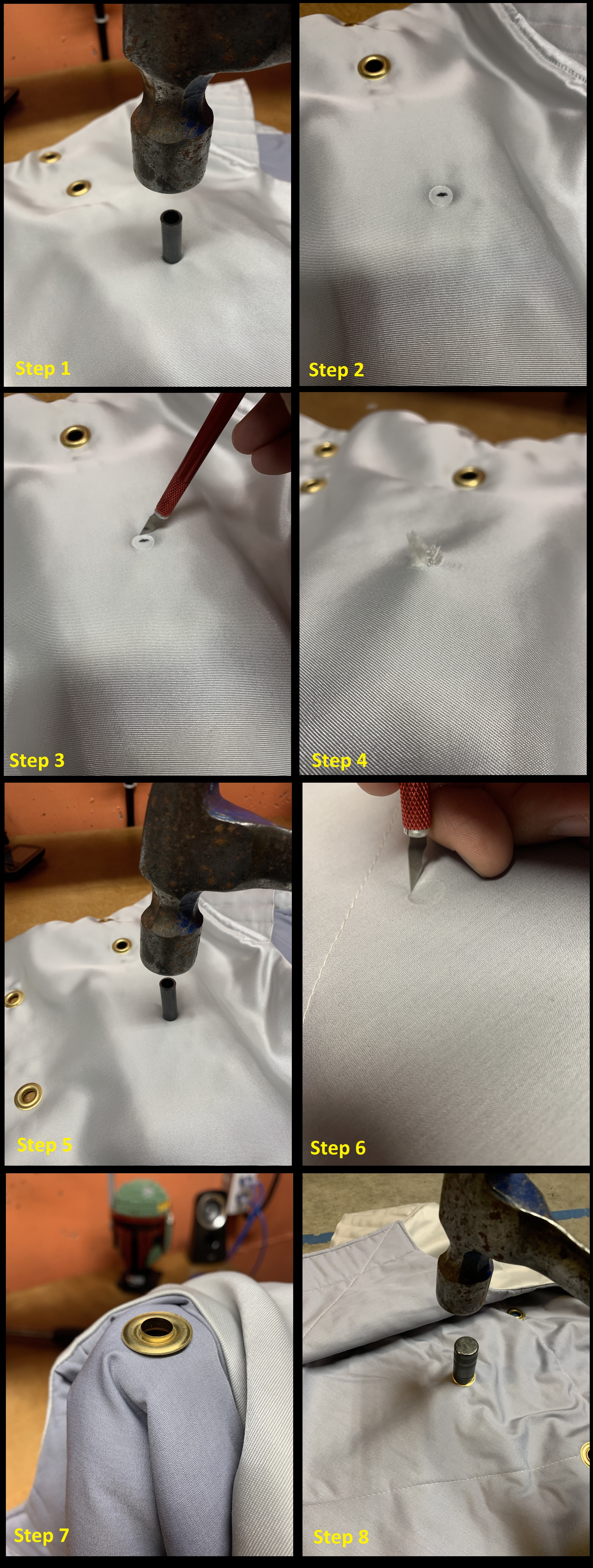

And then for the Grommet installation (I used 3/8 inch Grommets) it was quite simple but it took forever to install them. But here is how I did that...
Step 1: Hammer on the grommet cutting tool, which doesn't cut Arkady's material by the way.
Step 2: You can see the circle indent it makes.
Step 3: Using a hobby knife, cut out the hole.
Step 4: You'll also have some padding to deal with underneath, so make sure to clean that out.
Step 5: Using the Grommet Cutting Tool Hammer the hole again. (This is for the reverse side)
Step 6: Flip the Vest over and you should see the indent, Using a hobby knife, cut that piece out.
Step 7: Put on the Grommet.
Step 8: Pound on the Grommet.

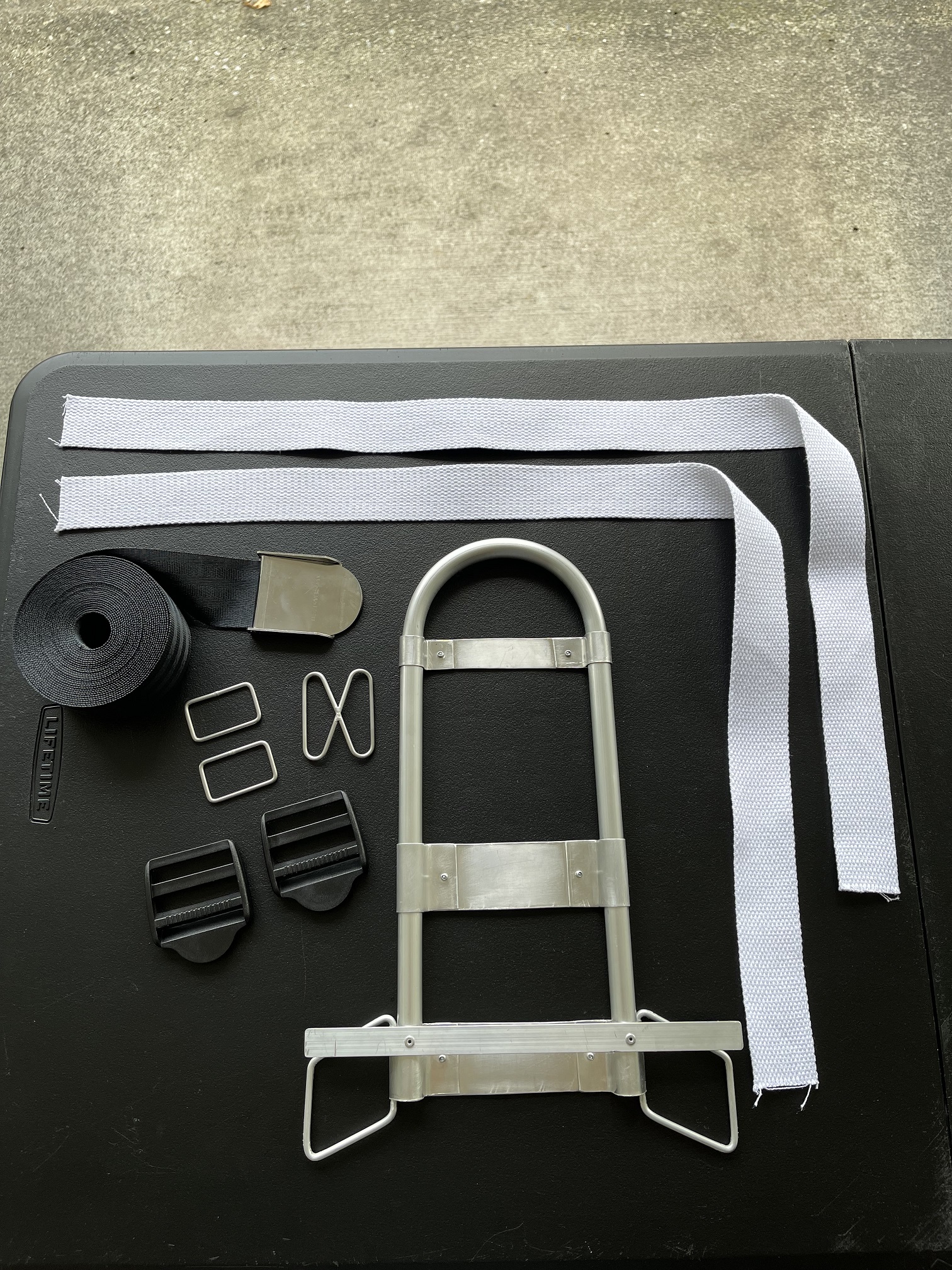

Jet pack harness arrived today, just have to attach divers buckle. I’ll do some final adjustments to my costume this weekend and when my wife’s off next week I’ll get her to help me suit up and takes some pics.

Right now, I have a MoW Jetpack Harness and it does well.
I like the fact it is super low profile, but every now and again the neck line does creep up and strangle me a little. Just enough to be annoying. All I do to remedy the issue is use my finger tips to reach under the vest grab the harness and pull down - problem solved. Gonna be nice to not be choked, plus I like the added benefit of having the bar at the bottom to help hold the JP up.
Concerning that bar on yours, mine was also squared off and pretty sharp. I'd recommend to round off the edges with a Dremel tool (With a grinding bit). Didn't take long and it made it so I wouldn't have to worry about it drawing blood on either me or a handler.
