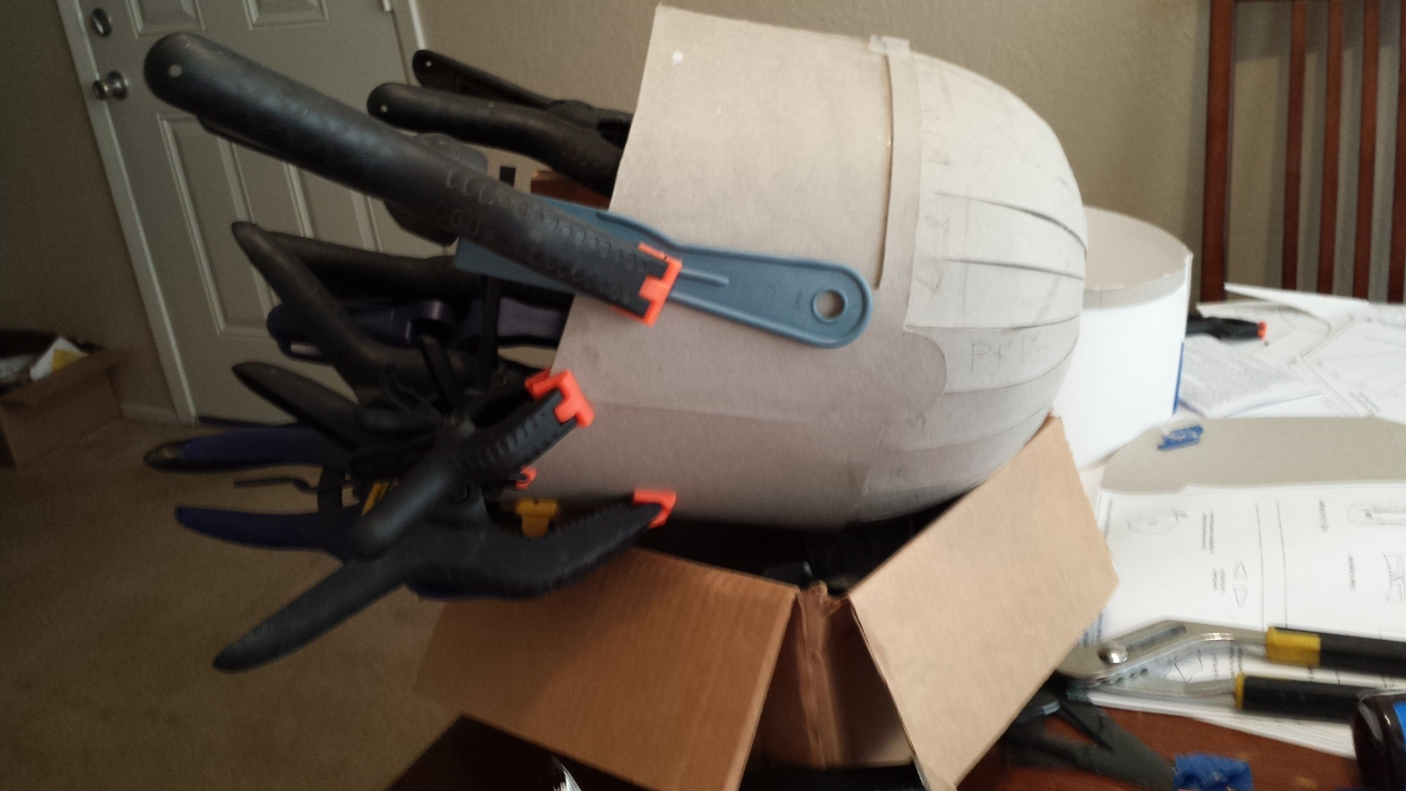

So after prototyping with posterboard, it was off to Hobby Lobby to get some 2mm cardboard for the real thing. I decided to use it for both the inner and outer parts of the bucket for extra strength.

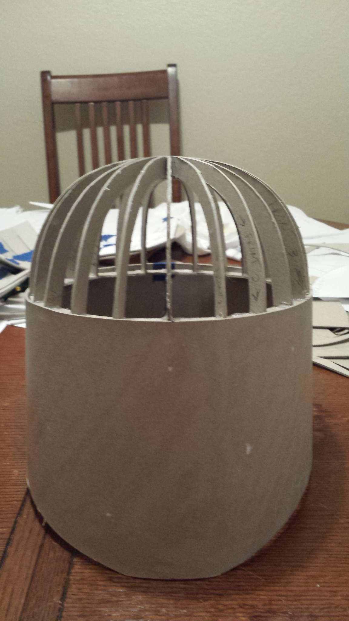

The dome on the RF templates is a little more involved, but the extra supports really help with getting a good shape.

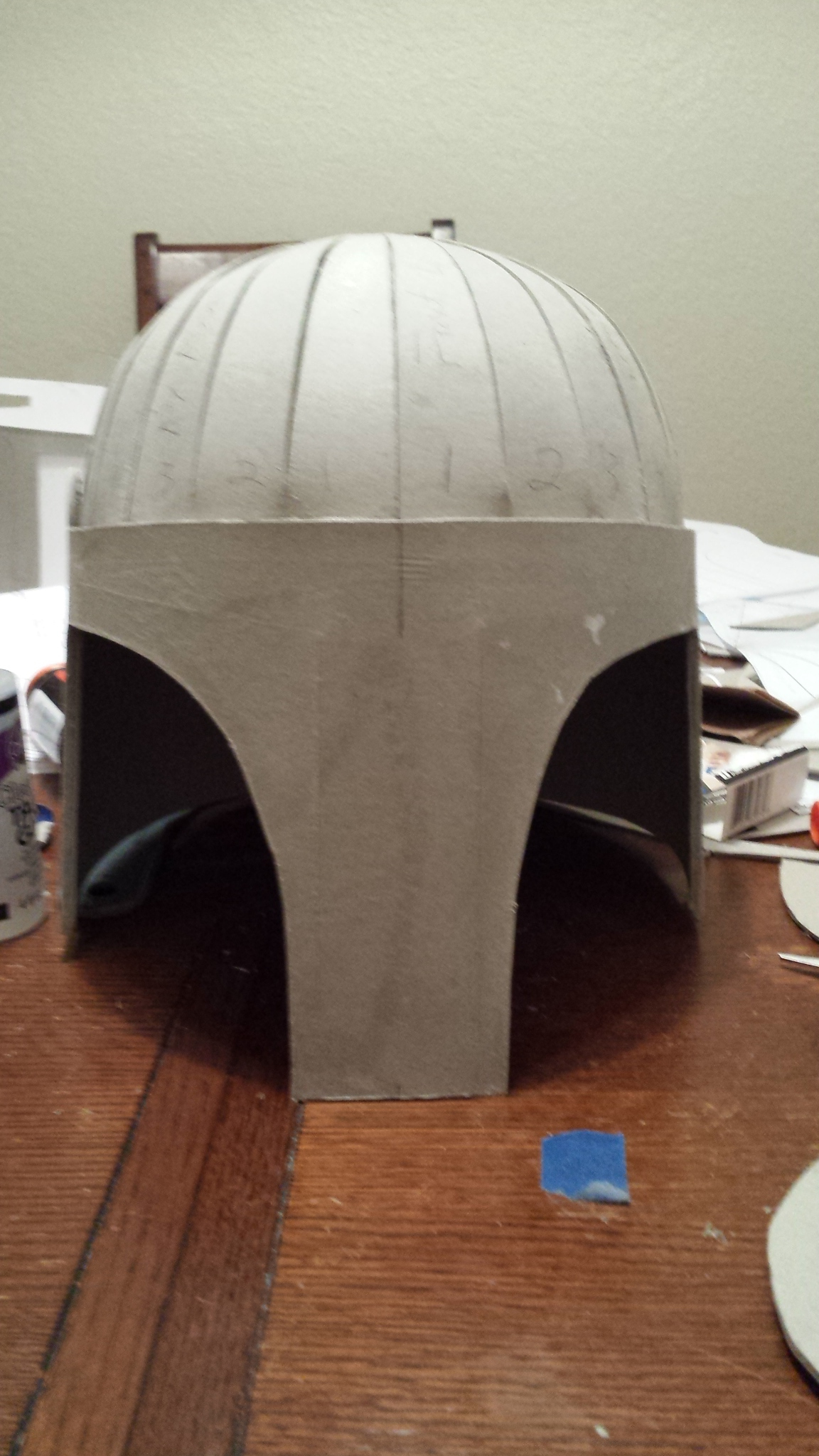

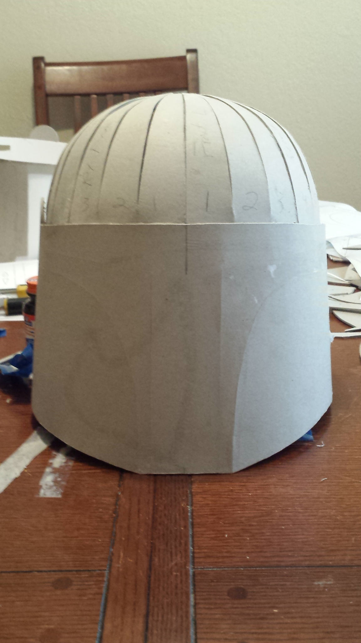

Next I attached the outer part of the mask...in other posts I've see where almost the complete bottom half was done before attaching the dome, but again, I wanted to make sure it was all going to fit and being my first build I was figuring out how everything went together.
Below is the mask attached with light surface cuts for the visor and cheeks. I later took a pencil and traced them to have more distinct lines for cutting. Even thought I was using a spray bottle to help soften the cardboard for shaping, I had to use a lot of clamps to make sure the outer part of the mask was glued really well.
Lesson #2: YOU CAN NEVER HAVE TOO MANY CLAMPS

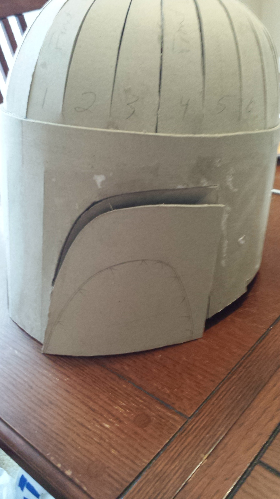

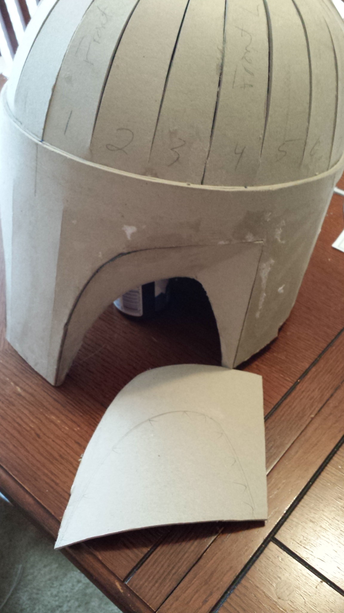

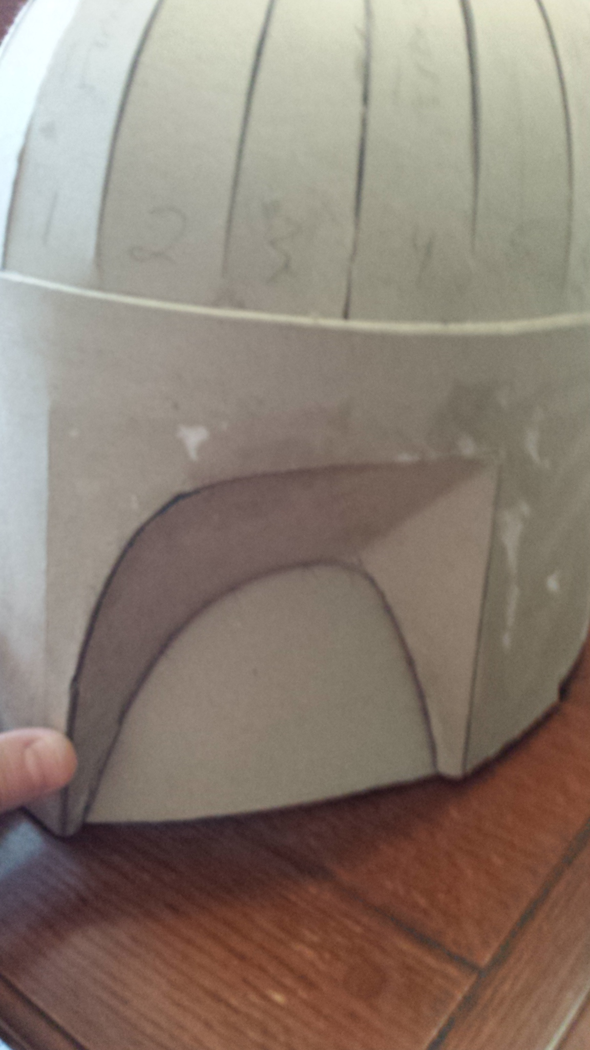

Next it was time to cut out the cheeks. My research showed that this could be tricky to get the right fit. I cut a 45 degree angle on the upper cheek parts like I saw from RafalFett's v2 build (or was it Antman?) Anyway, YES do that
They fit much better. I had trouble getting the lower cheeks to fit well, and then I noticed that the parts I had cut out from the cheeks had the same curve as the mask so I put the cutout part behind the upper cheeks and traced the curve and VIOLA! They fit perfectly. They are not as straight as you see on other buckets, but I liked the way they kind of flared out.

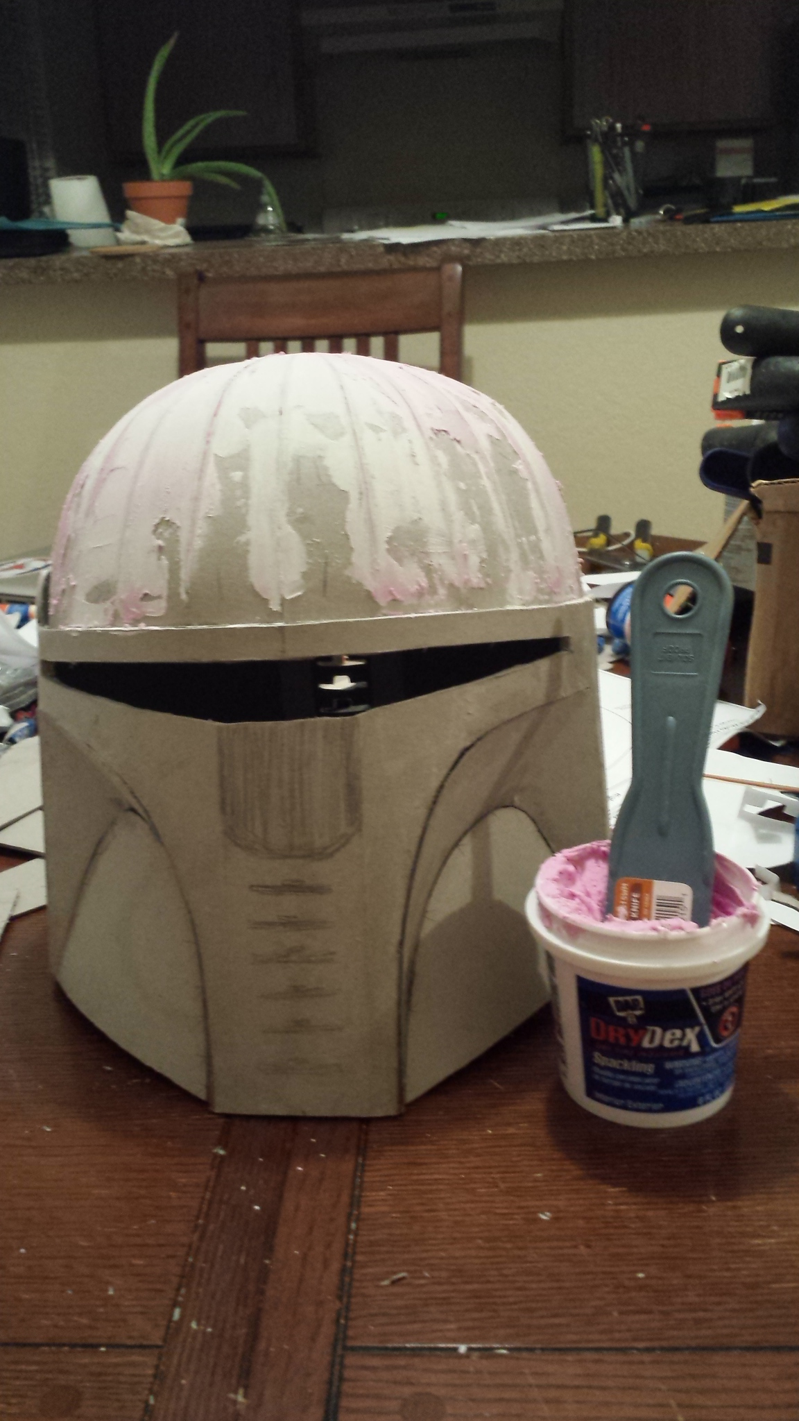

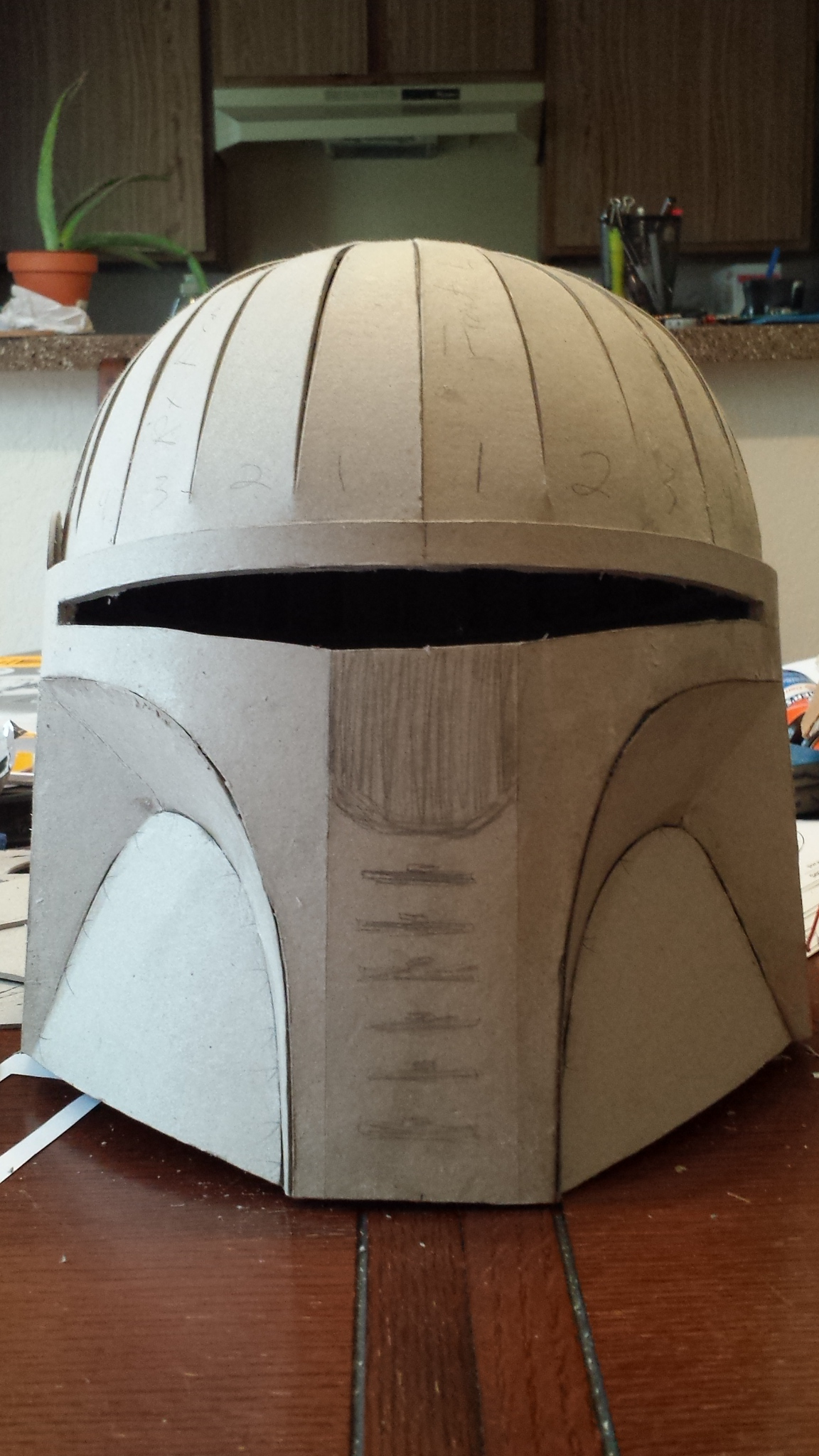

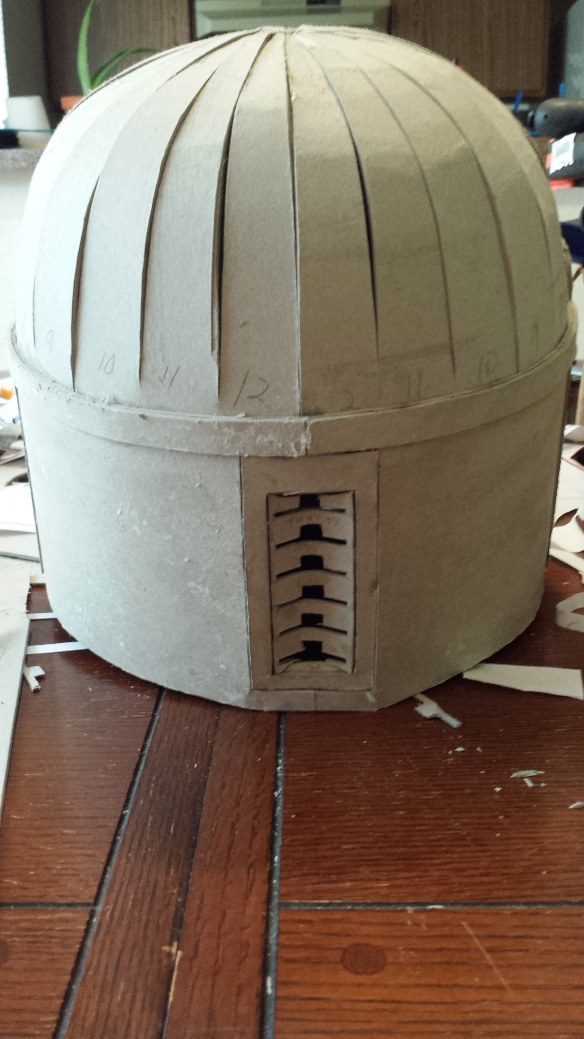

So yes I had been test fitting the helmet as I went to make sure I would have enough room inside to add fans and other things later, but now it's time to cut out the visor just enough to see what it looks like when it's on. I also added the keyhole in the back. Not 'too' happy with it, but giving myself a break as it is my first bucket, and I think I can 'fix it in post,' as they say
I'm not a 100% sure how I want to do the visor. I don't think I want to do a standard T-visor, so I have been searching the interwebs for ideas. Trying to be a little original here. I penciled one of my ideas on the mask

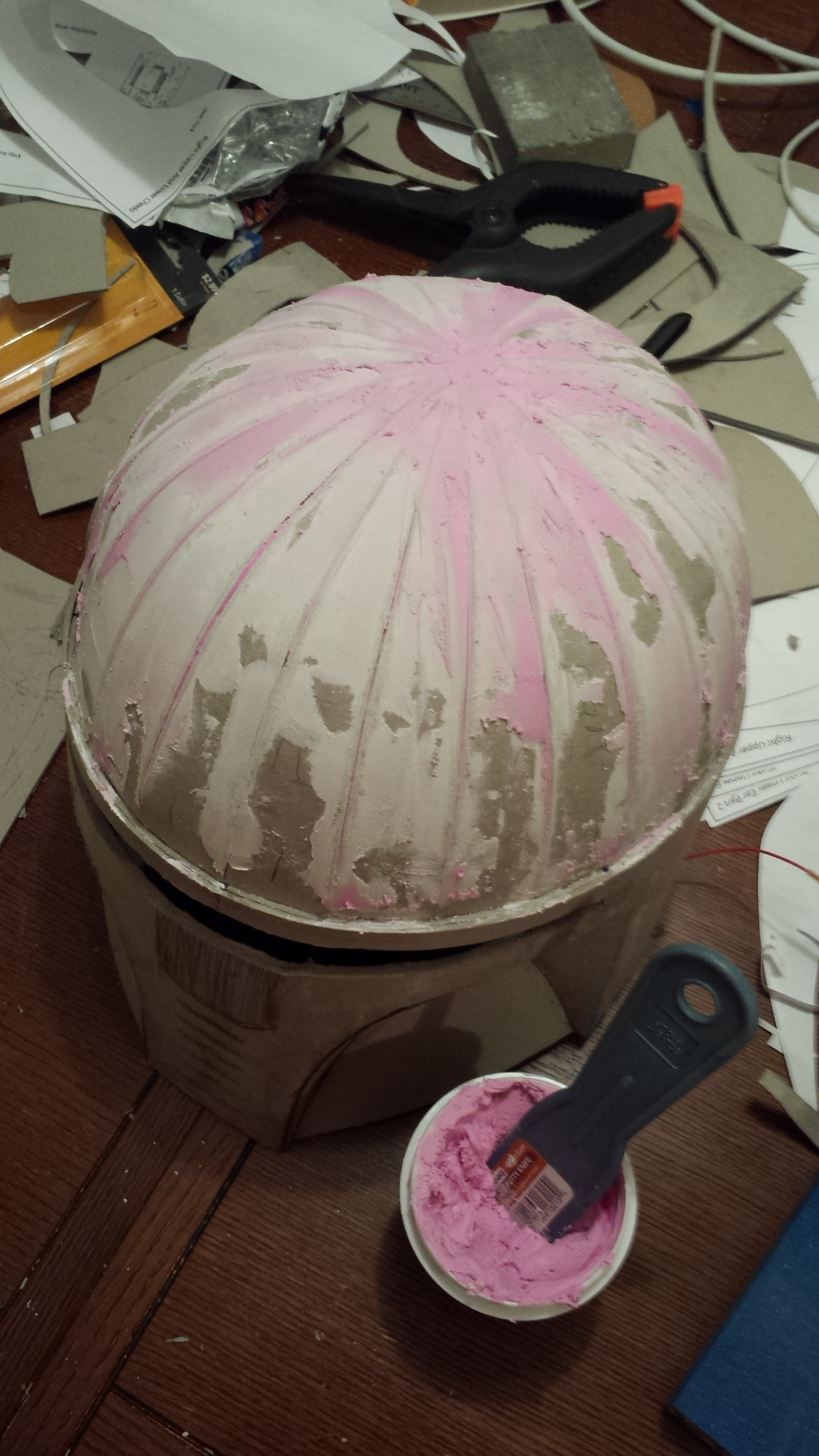

Finally, it's time to close up the seams and prep for fiberglassing. I took standard caulk to the cheek parts (but forgot to take a picture) and used spackle on the dome to fill in the gaps and start to shape it.

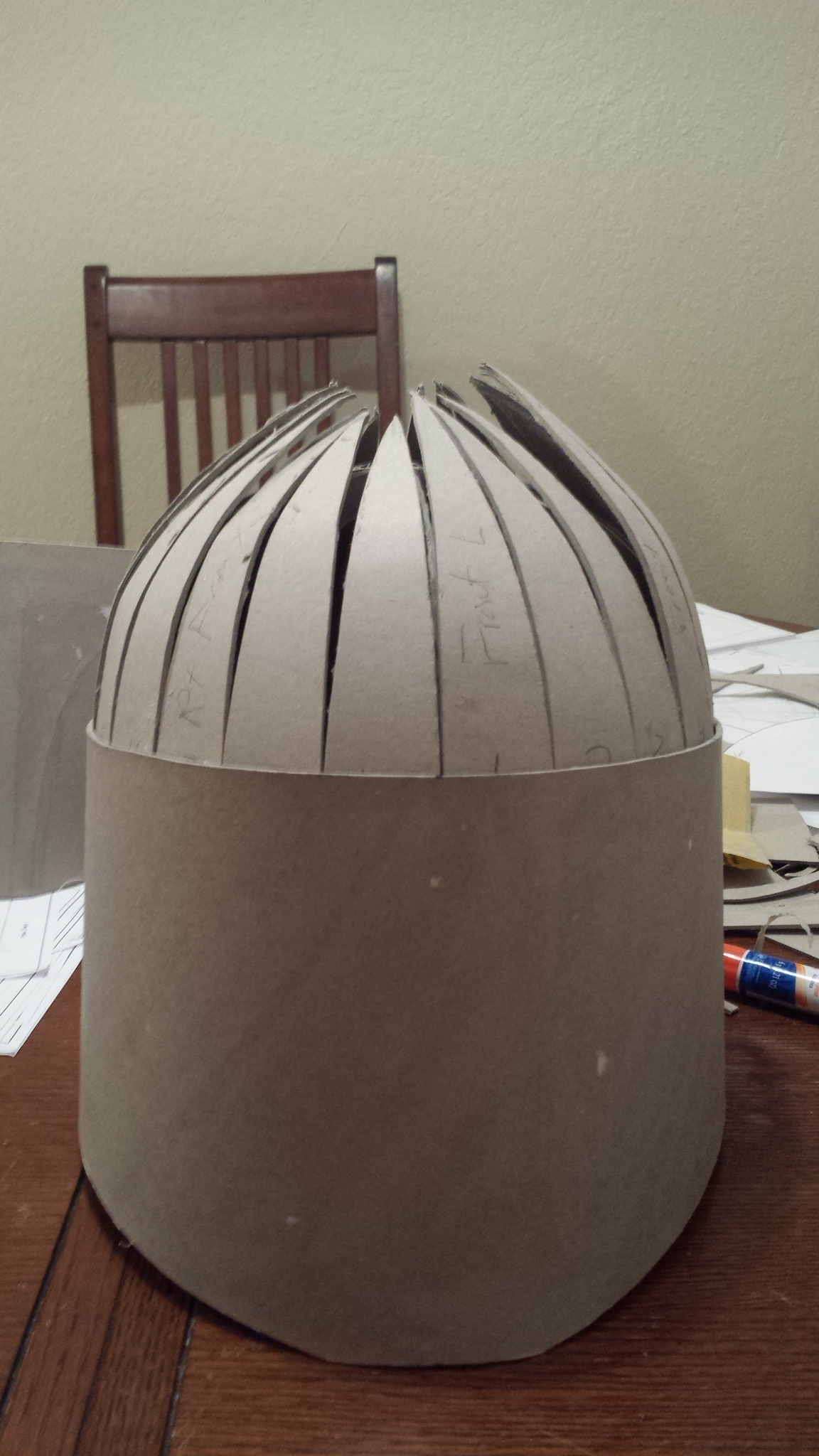

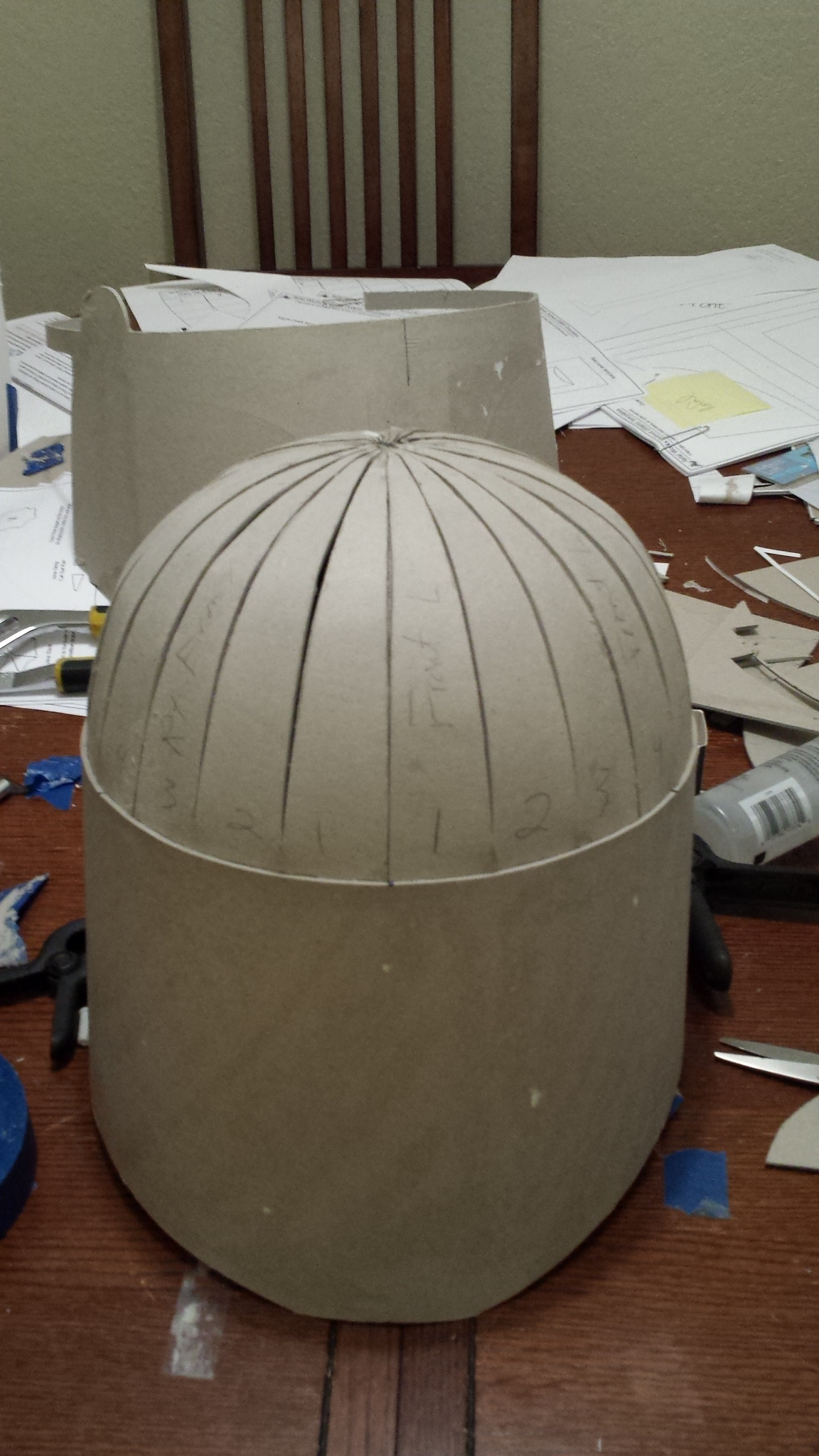

So, after starting over, I made sure to completely build the mask and dome using RF templates out of posterboard for sizing purposes and to make sure the bucket was going to fit. Thank goodness, because I ended up having to resize the PDF's a bit to get the right fit. I had read to do this in other posts, but was too anxious to get started and skipped it.
Lesson #1: BE PATIENT

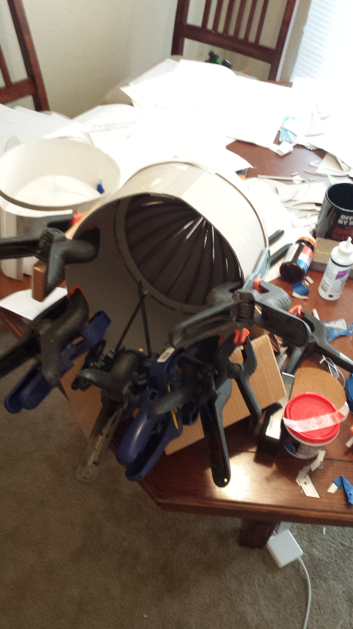

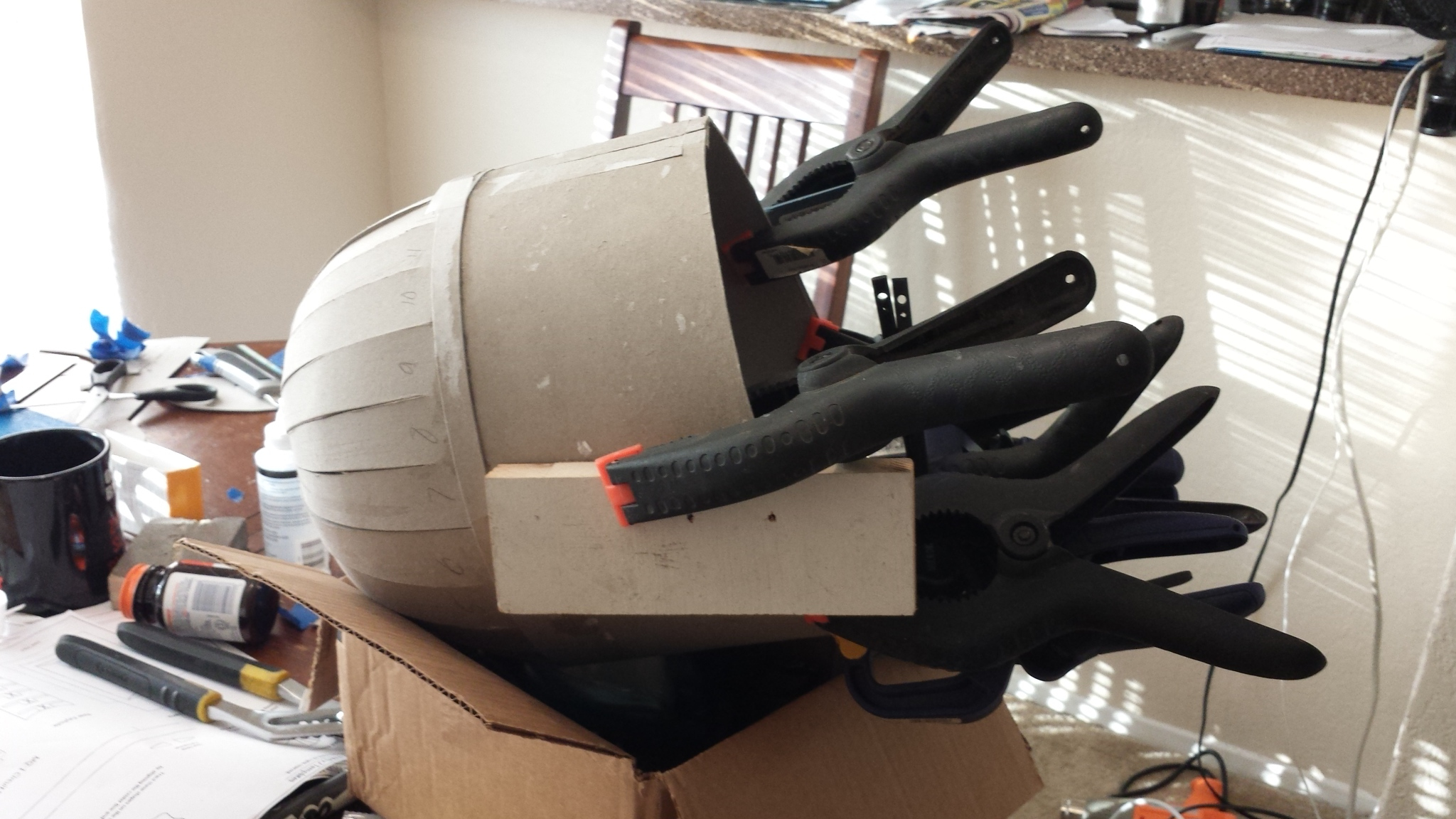

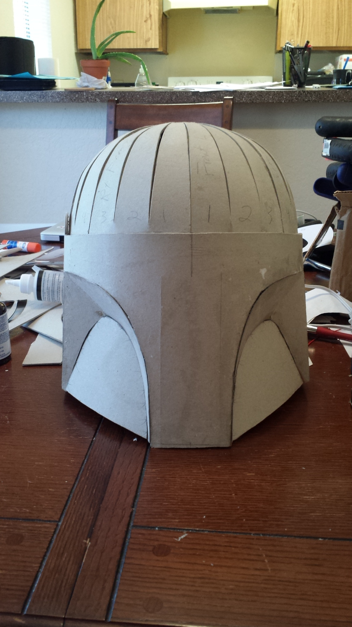

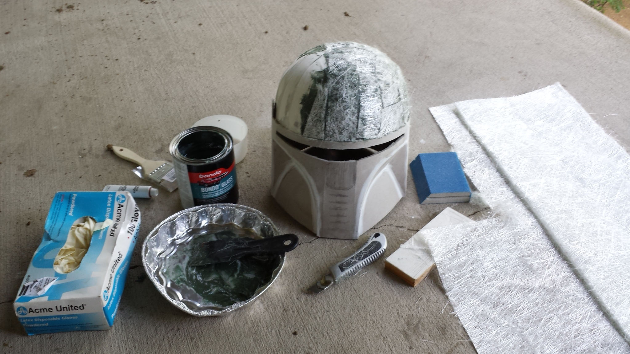

Next post I'll tackle the fiberglassing.
