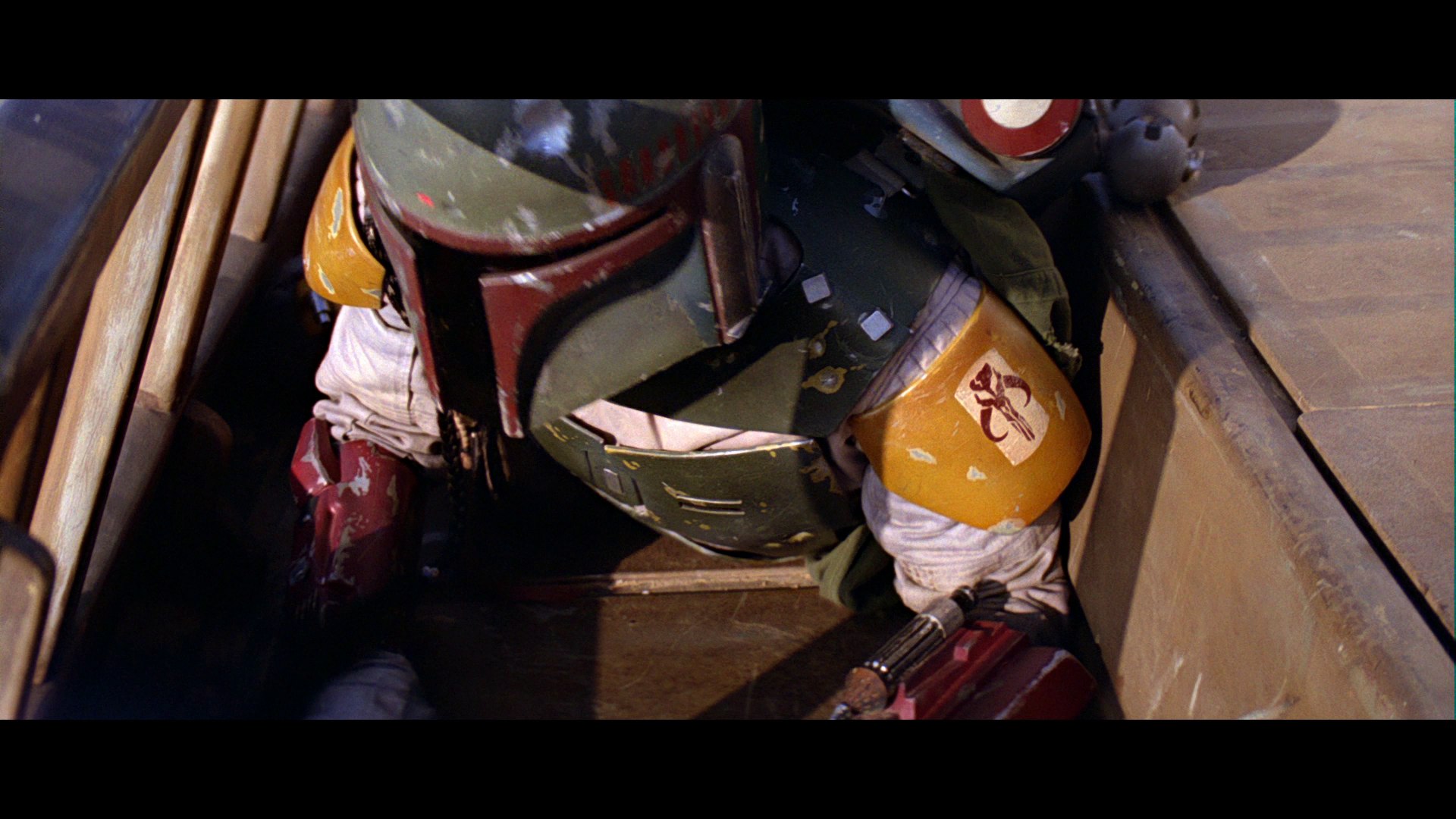

I looked at a bunch of different pictures and it seems the cape is positioned in a few different places. Currently I stuck mine on the inner stud of the back armor to neck plate but I am thinking that is wrong.
In one of the good ROTJ screen captures you can see it attached under both studs. Then later you can't even see that it is attached at all. When he is face down on the skiff it isn't attached to the shoulders it is draped between his backplate and jet pack.

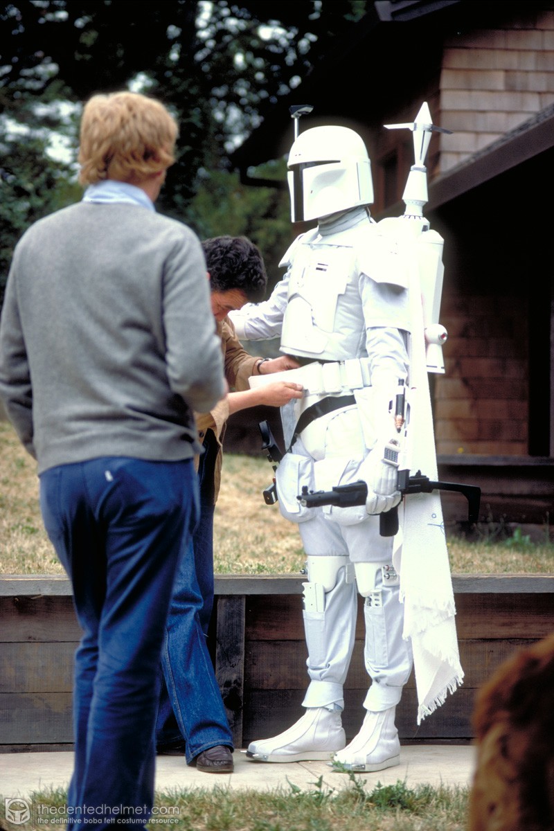

After they decided to transform the Supertrooper suit into Boba Fett, they also added the cape, the wookie braids and the girth belt (and of course the color scheme and the weathering). The white prototype suit had the cape attached to the left jetpack hook (barely visible):

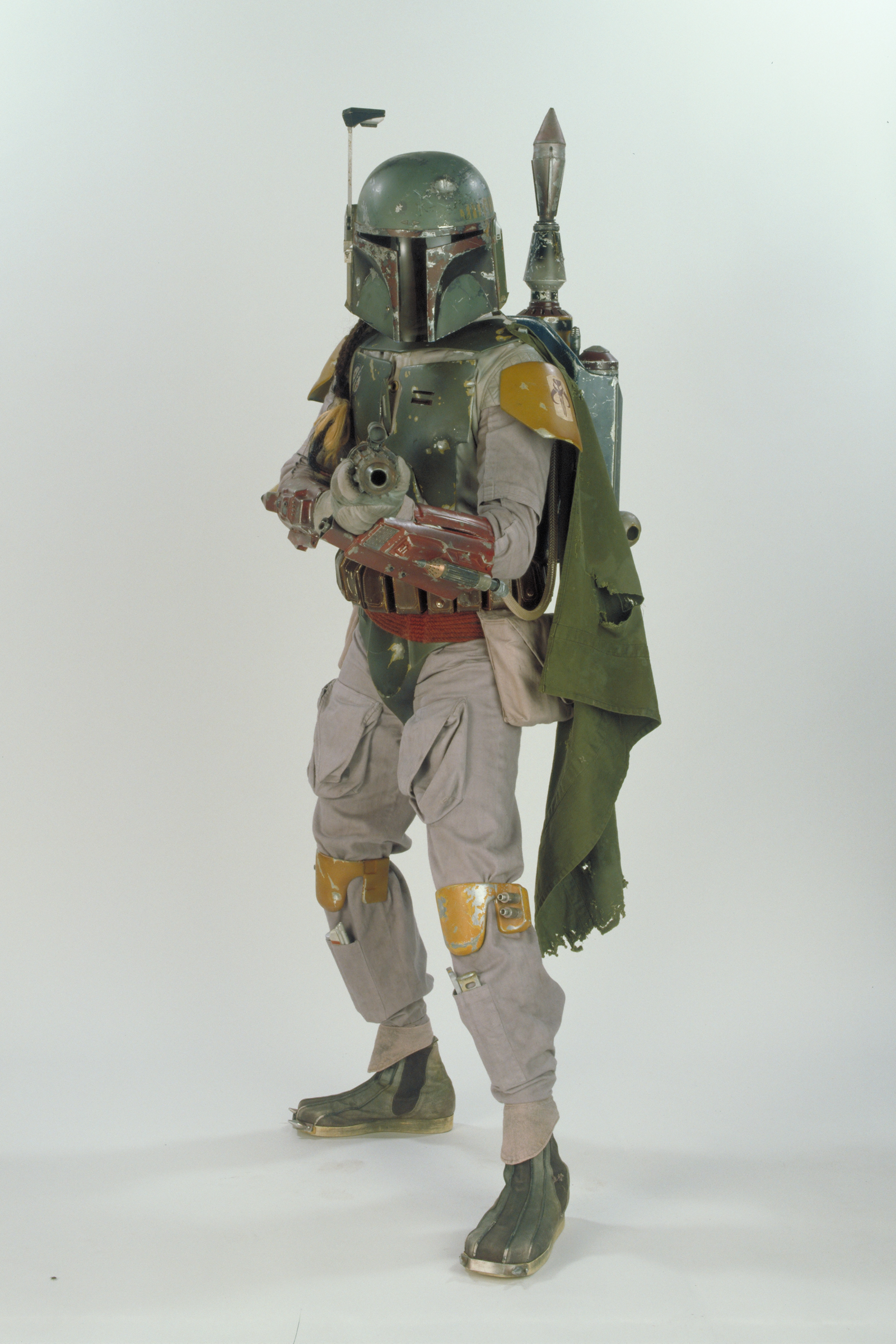

The ESB Hero cape was attached to the outer left shoulder stud and the nearest end stuffed/attached somewhere to the left jetpack hook:
Boba-Fett-Costume-Empire-Strikes-Back-08.jpg View attachment Boba-Fett-Costume-Empire-Strikes-Back-03.jpg

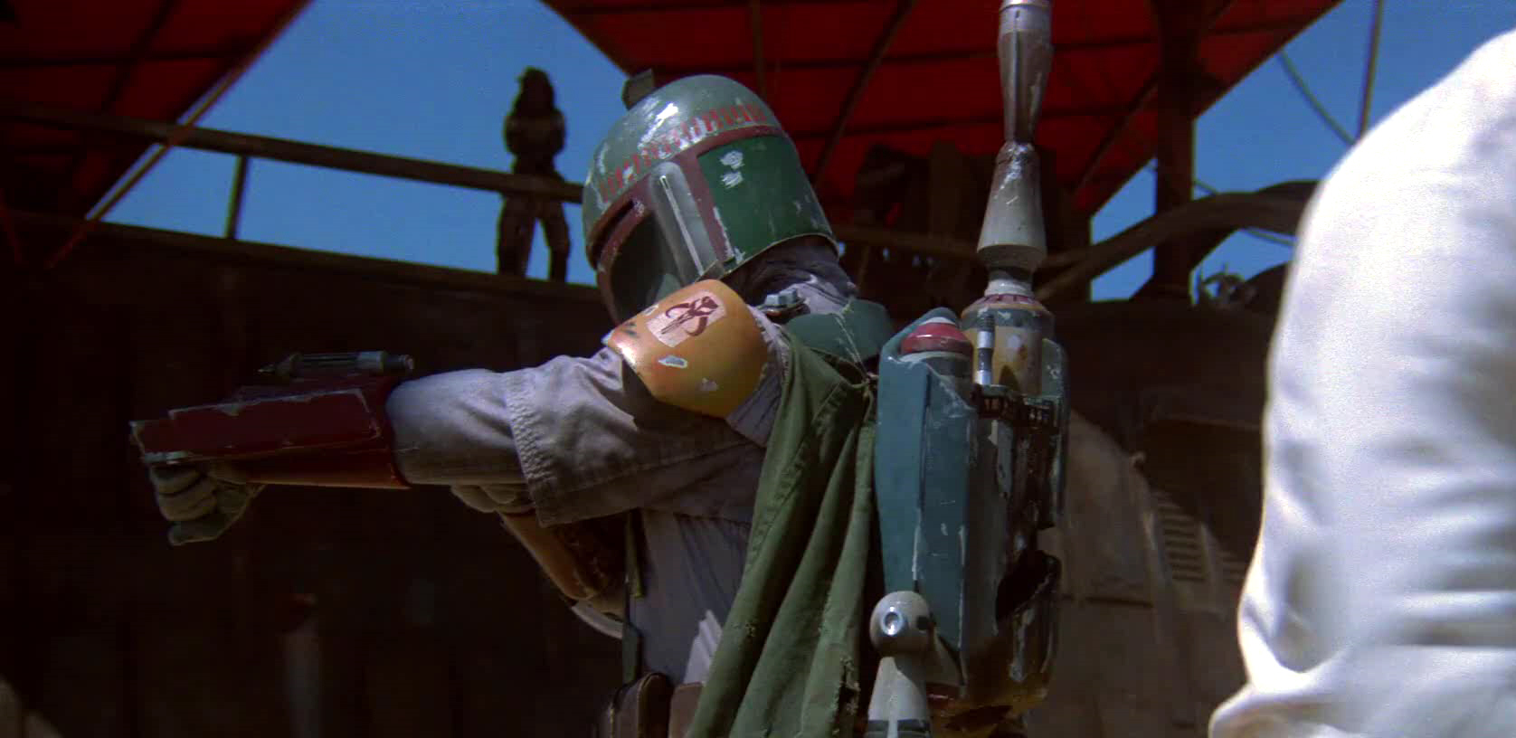

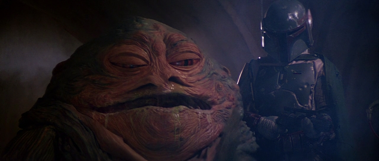

The ROTJ Hero had the cape attached to the outer left shoulder stud in the Jabba's palace scenes, while in most of the stunt scenes the cape was attached randomly, more exactly stuck under the back plate or attached to the left jetpack hook:
Boba-Fett-Costume-Return-of-the-Jedi-02a.jpg Boba-Fett-Costume-Empire-Strikes-Back-BRD-060.jpg Boba ROTJ 056.jpg Snapshot-2011-10-12 at 10_30_49 PM-1219871998.jpg 70228aa6bcd34747b86bd3b92ab2d5fb.jpg

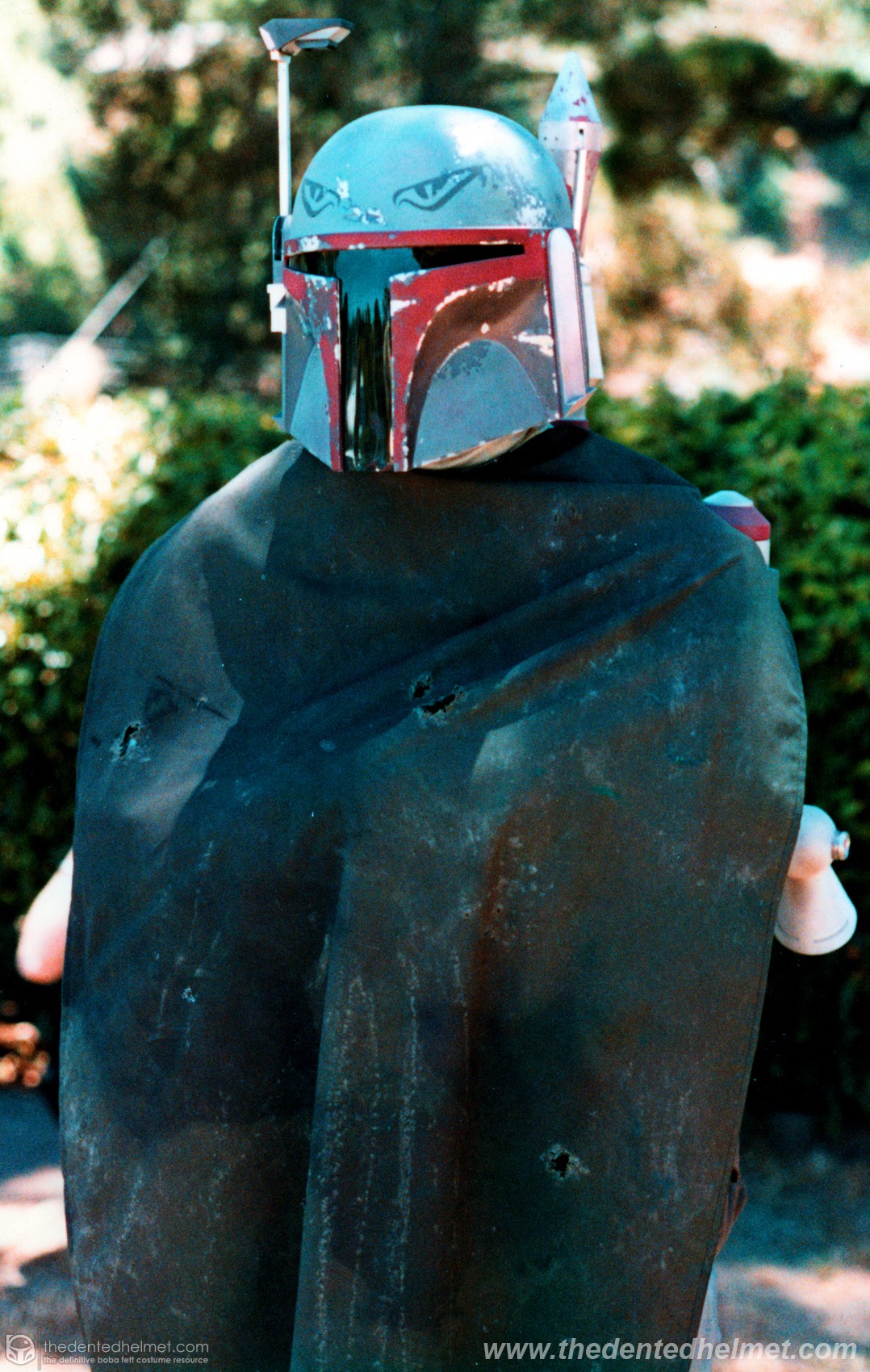

Thanks for the kind comments. Regarding the Supertrooper cape I based my suppositions on these images:
You can clearly see that the cape comes from behind the left shoulder bell and not from the collar plate. For a strong proof I did the following to this image (in the unaltered image you can barely see the cape's end):
Just saw that the left outer shoulder stud's top part is painted in red (not sure about the others)... Yes, we all learn things every day.
