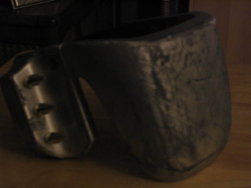

well I started my first kit. Just some knee armor nothing to terribly complicated and I have one almost done its all glued together all I have to do is sand it and add the spikes since Its for my custom, but I wanted to get your guys opinion is there anything I can do to approve upon what I have done before I get started on the other knee?? so here are a couple of pics...Also one other quick question what the best way to add the back straps I am affriad they will just pop off if I use glue/apoxy.

For your problem, as long as you lightly sanded the area where you bonded the pieces together, and you don't use a REALLY tight strap, you should be alright.
I epoxied the strap on then hot glued the inner and underside of it. I wore them around the house for 2 hours straight, did some squatting and such with no problems.

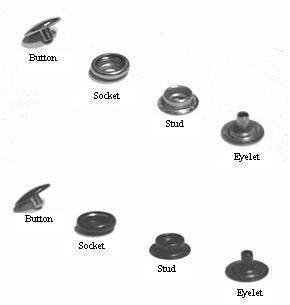

Get a box of snaps from walmart that are like this:
in that little square of plastic, drill a hole so you can fit one of the eyelets through, then hammer one of the snap studs on that...and then use Plastiweld from walmart. Its in a blister pack in a tube that looks just like this:

Then take some elastic and put the socket on the elastic, and now you have a snapable strap for your knees.
