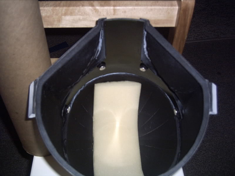

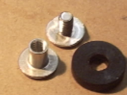

I use a variation on Spideyfetts method, but I use chicago or boston screws with plastic, kitchen faucet washers.
are you epoxying the female portion onto the inner portion of the helm?
i made mine pepakua style so i have a ledge just inside that goes all the way to the face of the helm. its not flush to the inner portion of the visor like yours is

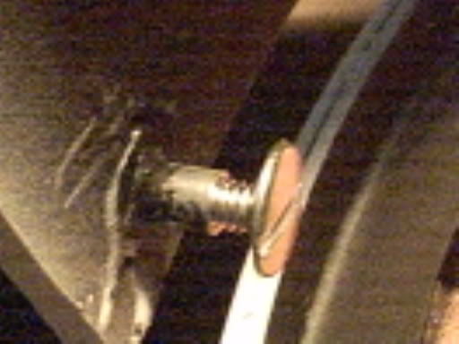

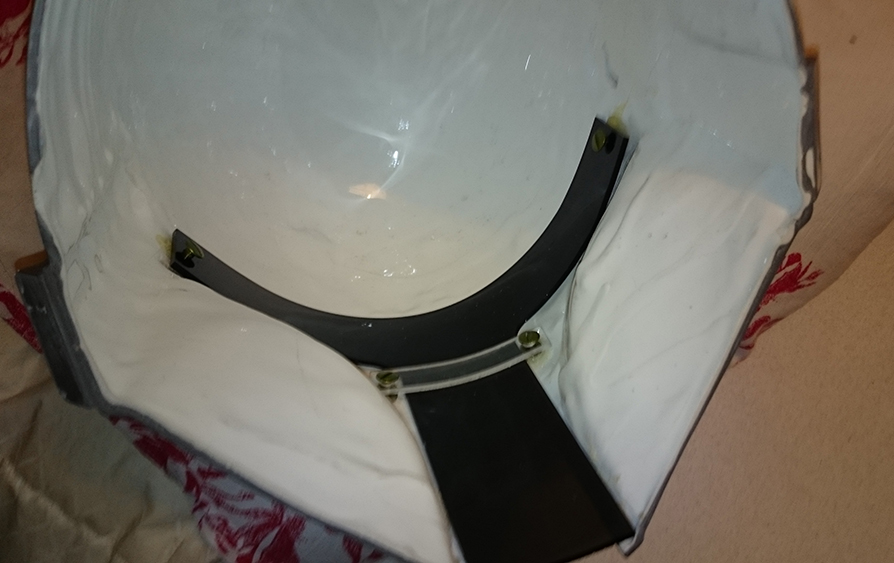

This is how i did mine .
I glued in some Chicago screws with some hot glue.
I also took a small piece of acrylic glass and bended it slightly with some hot air.
This keeps my helmets cheeks together and its transparent enough to go unnoticed from the outside.
Edit : I just might add some rubber washers later and try to find a way to hold the visor in place at the bottom.
