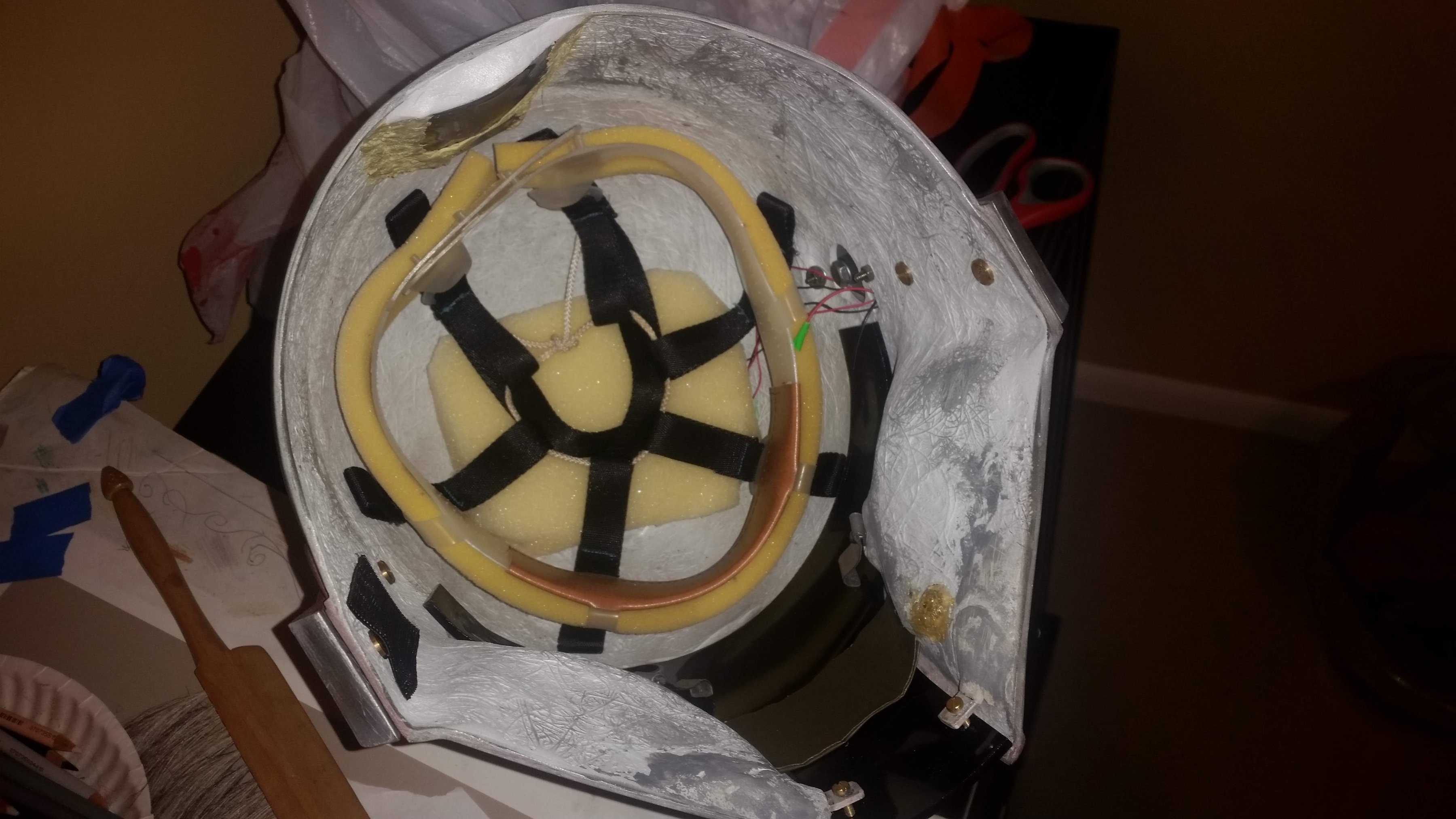

I just did mine a little while ago and did the Hot Glue method because I wanted the ability to replace it at a later date. It worked quite well.

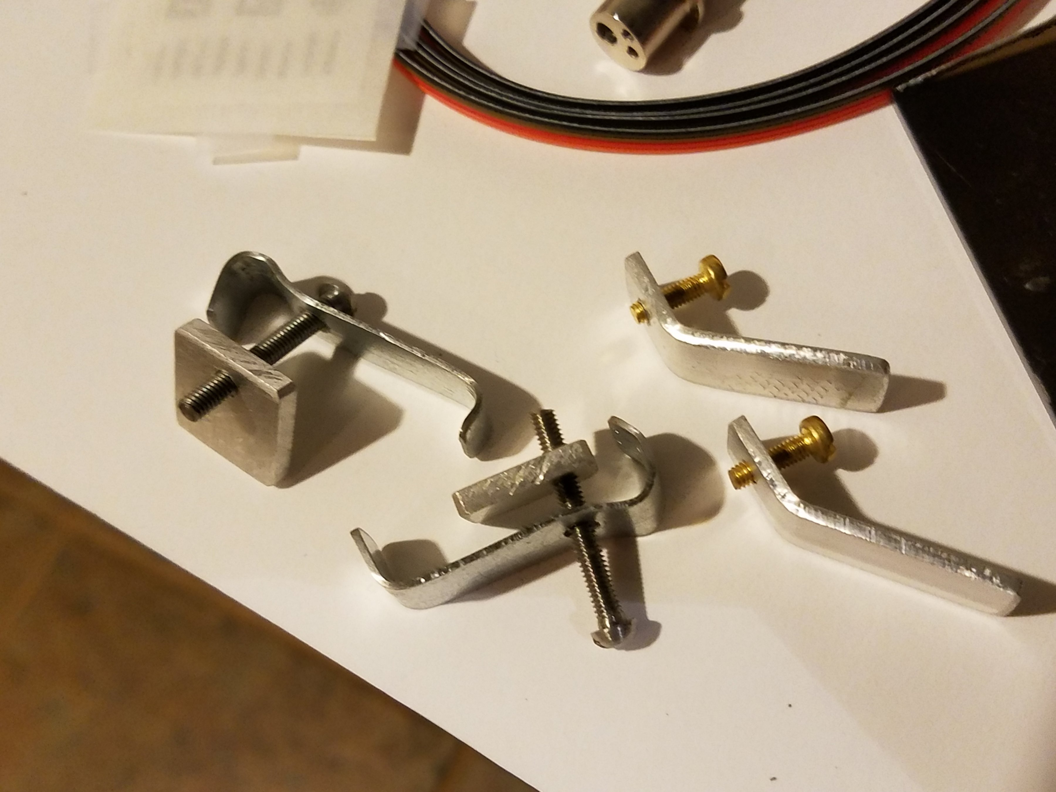

Nice Job Richard! I will be making my spring-clip-thingies, from Thin PVC i believe that way if i don’t like the shape (tension, etc) I can just simply reheat, reshape and voila! What are yours made from?

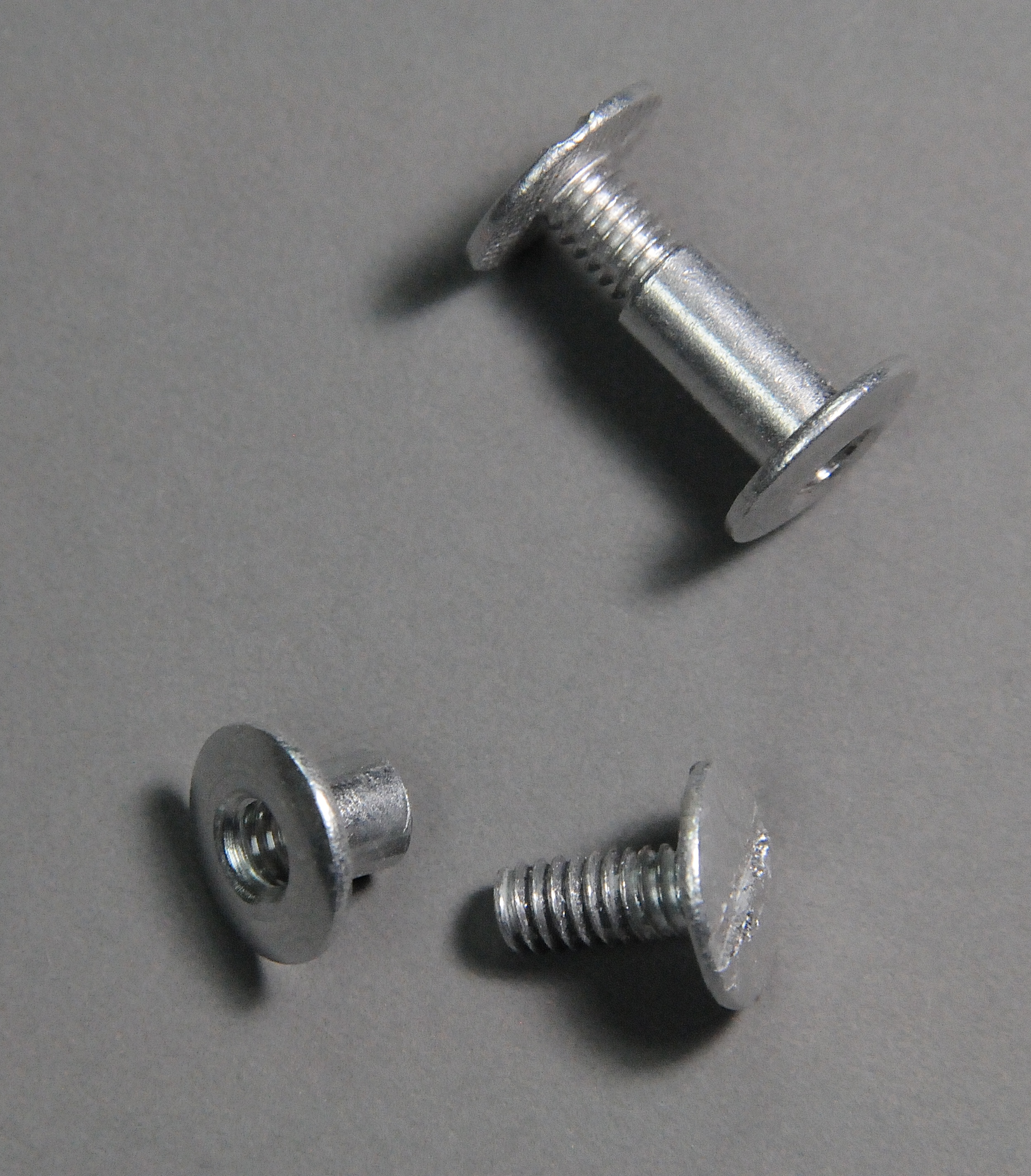

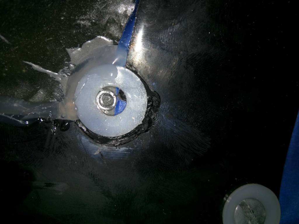

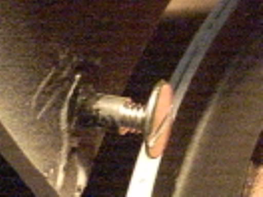

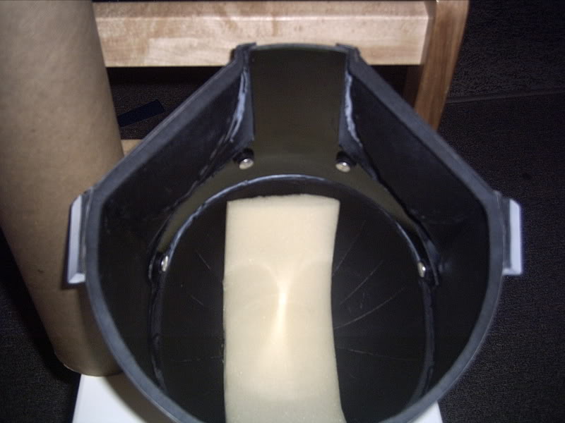

I just epoxied the female half of this type of screw (any good hardware has them) into the helmet. They come in different lengths. Then with the addition of a nylon washer the visor holds nicely. Low cost and doesn't take up much room either.

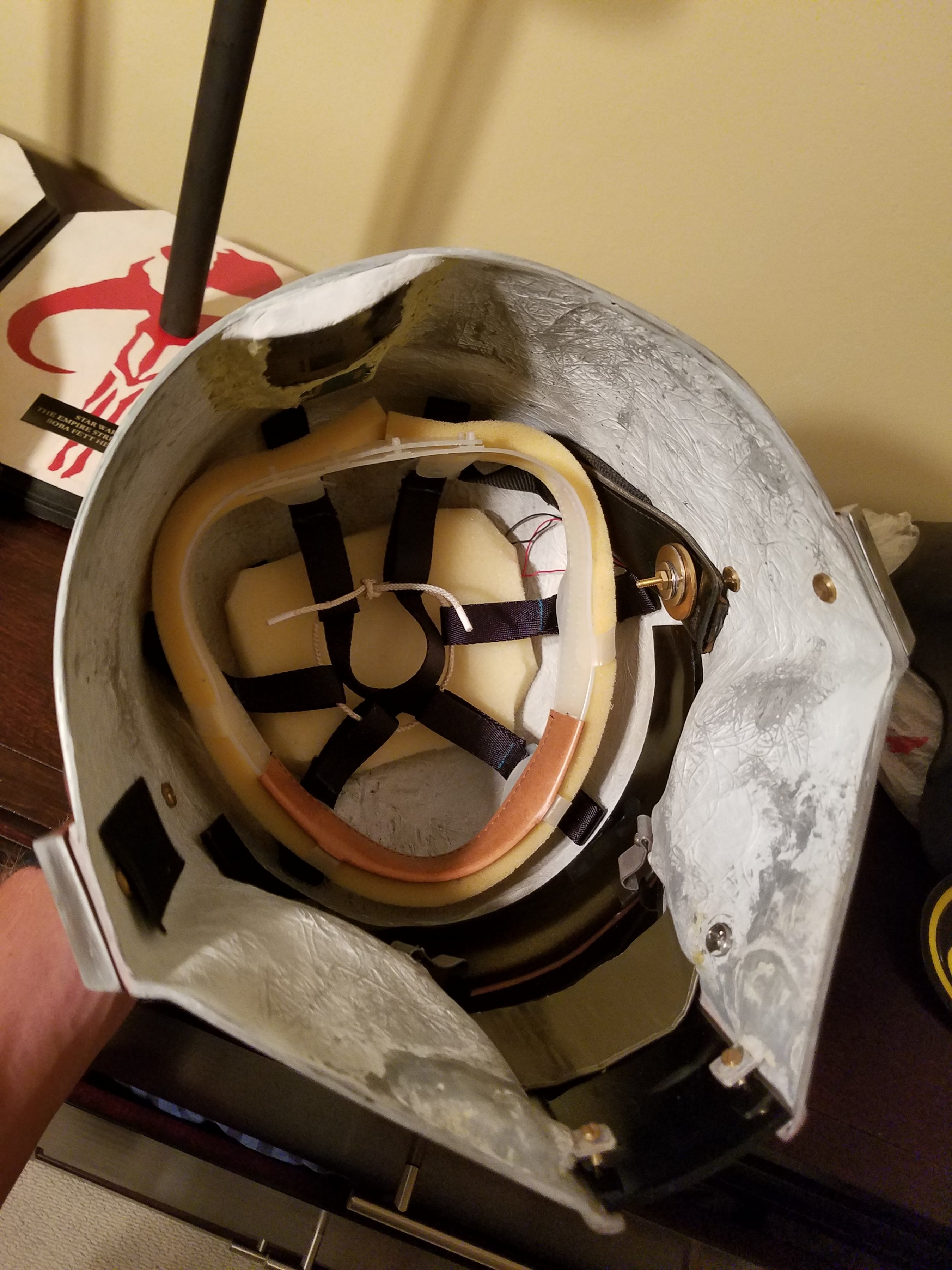

Here's the result...

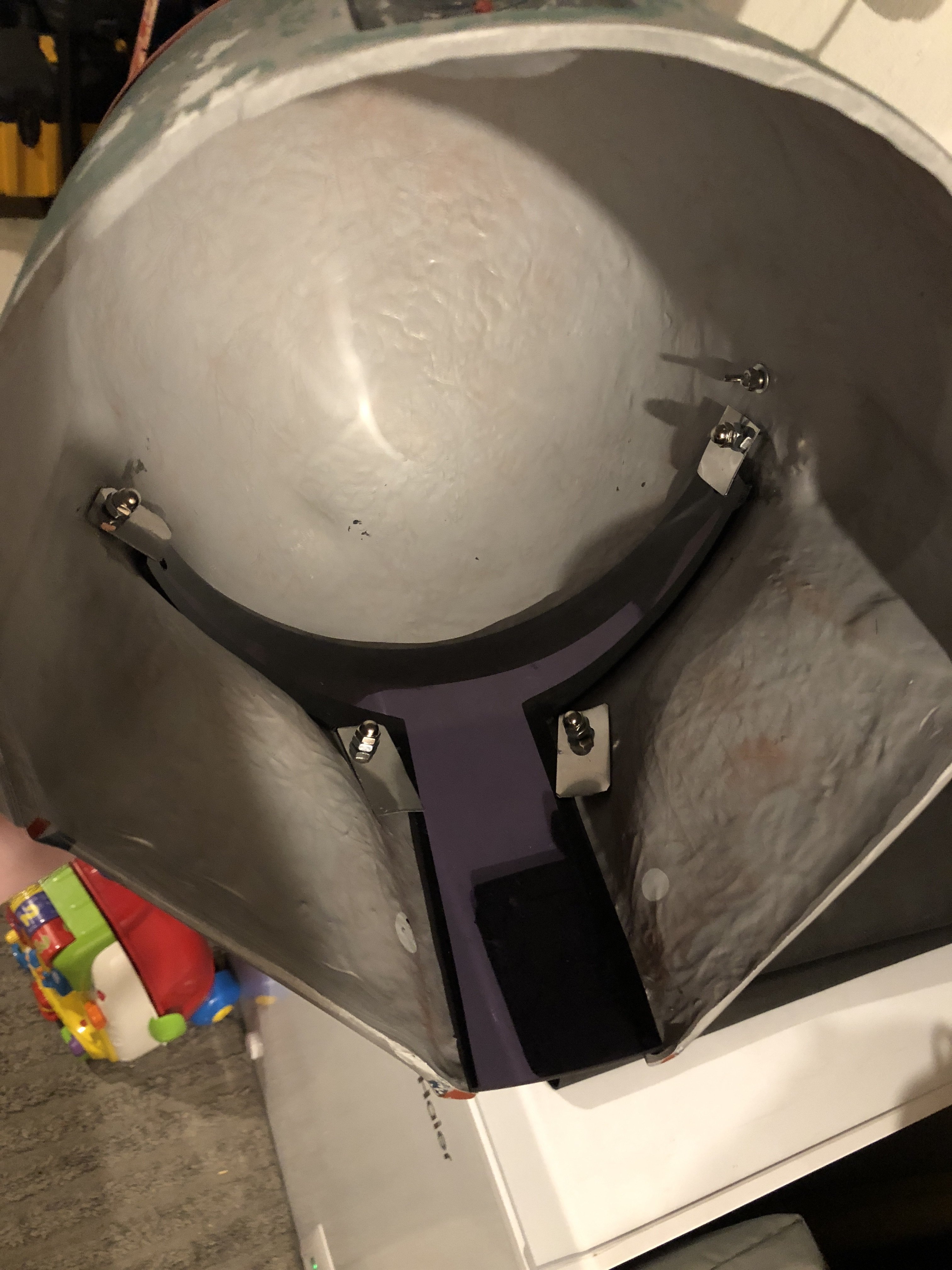

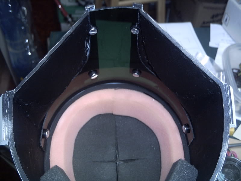

image.jpg I just used JB Weld with four small flat head screws and glued them to the inside of the helmet. Once those dried, I cut four little pieces of stainless steal off a strip and bolted them down. It’s holding it in nice and snug. I could also change it out in about 30 seconds.
