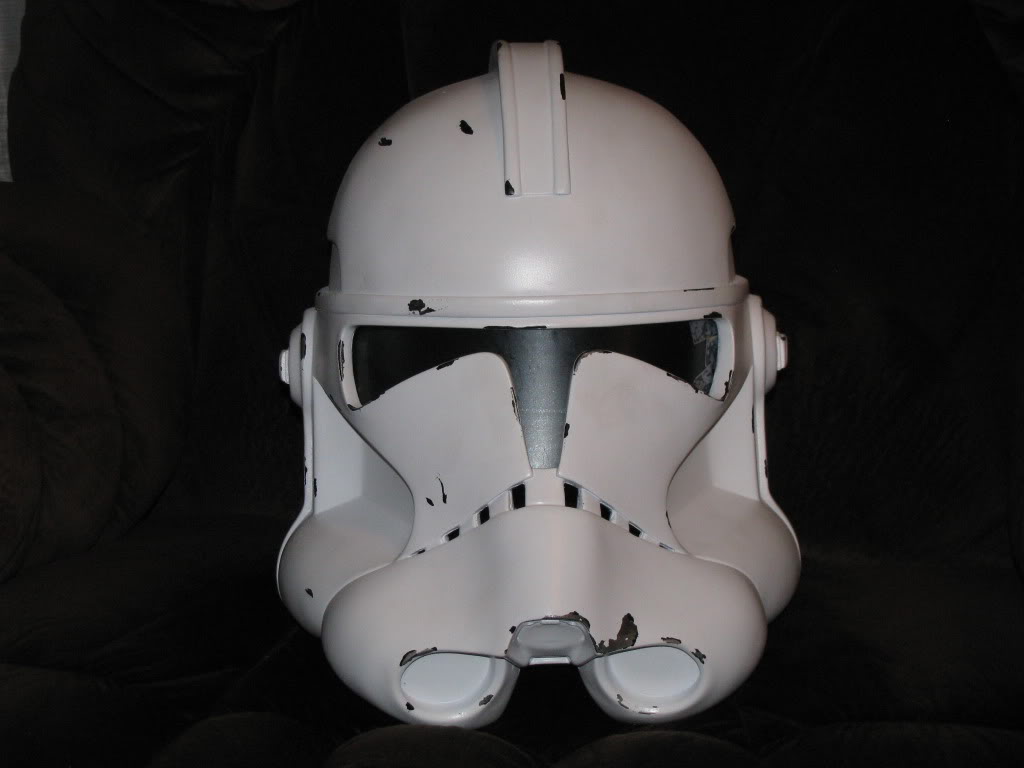

This isn't a Mando bucket, but I found this thread while I was looking for a way to install the visor in my Phase II Episode III bucket and thought I would adapt it a little for that.

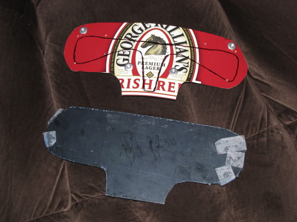

Dark green visor with some visor templates taped on. My wife made these by eye and did a pretty good job keeping the template symmetrical.

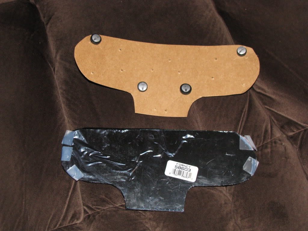

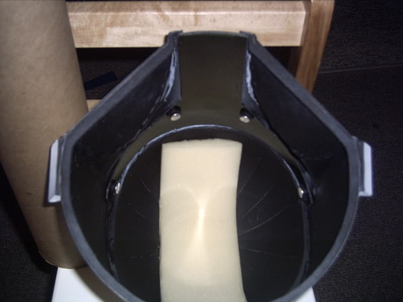

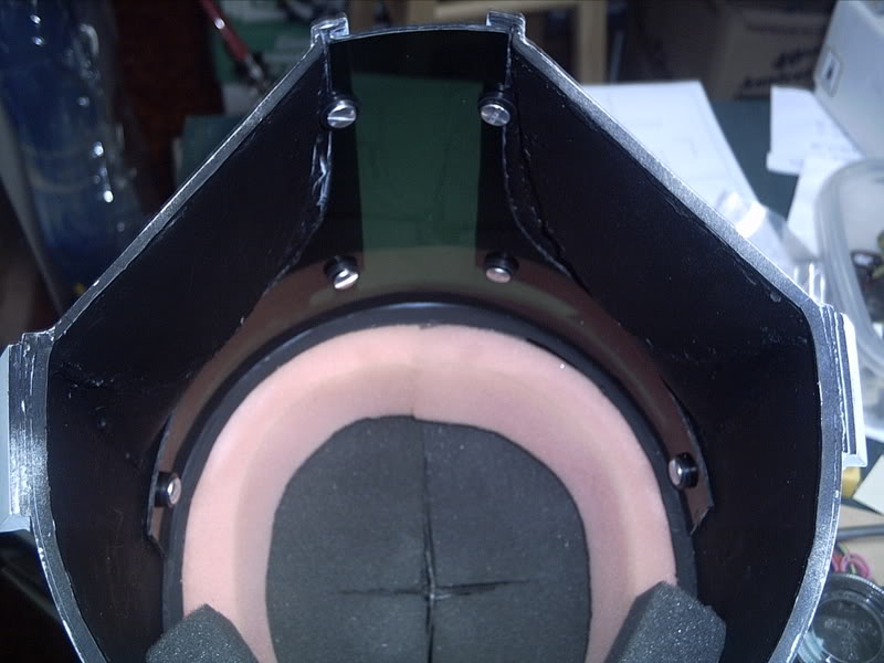

Then Thorn puts his beer goggles (visor) on ... I made a cardboard visor template to help with the placement of the chicago screws on the inside of the helmet.

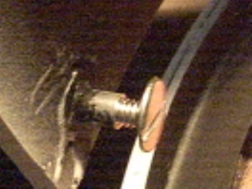

I put the screws in the cardboard template and dabbed a little paint on the backside of the screws to mark the inside of the helmet. Then I used my dremel to scuff up the inside of the helmet in preparation for epoxy putty.

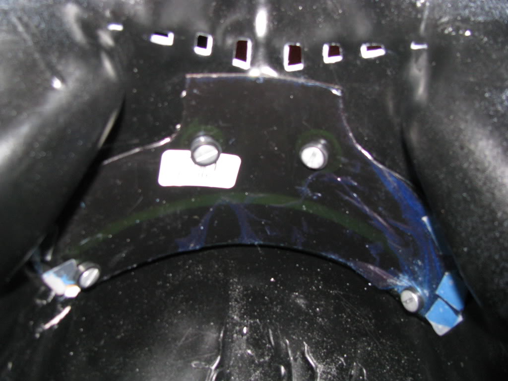

After this, I applied the 5 minute epoxy putty directly to the chicago screws and pressed them and the cardboard template onto the inner surface of the helmet.
Boom, baby! Visor installed. I left the protective film on the plastic for now because I plan to have it in and out a few more times while I do some more painting.

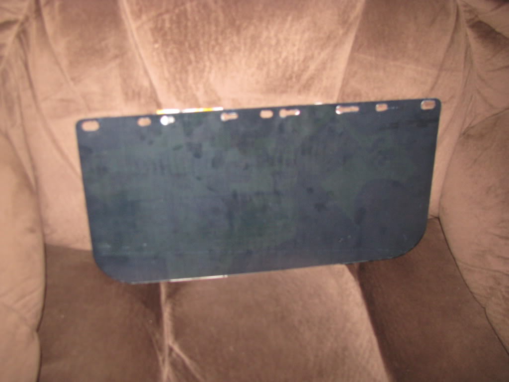

You can either go to t-visor.com or you can pickup a welders shield at a hardware store and custom cut one for yourself.

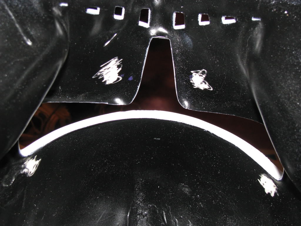

i have a 95' don post helmet coming in the mail...from the helmet history on the sticky, am i correct to assume that this helmet will fit the large sized visor? i mean since the mystery helmet and the don post helmet were casted from the same lava helmet right? also, from the pics i saw of my helmet (i didnt get it yet) i see that the lower part of the visor is part of the mold and not a whole "T" shaped eye piece...do i use a dremel to cut away at that part to modify it to have a correct "T" shaped visor?

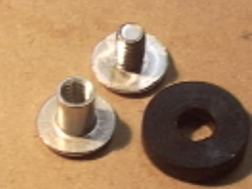

Is 1/4" a pretty common or good length of Chicago Screw to use?
If 1/4" is the shortest length chicago screw you can find, then yes. You'll have extra length, in relation to the thickness of the visor... which is why I used the plastic kitchen faucet washers. :D

You'll actually find that the Don Post '95 helmet is on the small side, definitely smaller than the Mystery helmet. You are correct about the T-visor section, the lower section of the t-visor area is indeed attached and will need to be removed.
Word of caution... if the helmet that you're getting is a real Don Post '95, and not a cast of one, then you'll want to cut out and fit the visor ( but not install just yet ) before cutting away the bottom connecting section of the t-visor. The Don Post is a soft vinyl material, unlike the more commonly used resin of other slush-cast helmets. Removing that bridge piece before you are ready to install the visor may cause the Don Post to deform/warp. You would be wise to search for tutorials on how to install a "craft ring" to help the Don Post maintain it's shape. :thumbsup:
