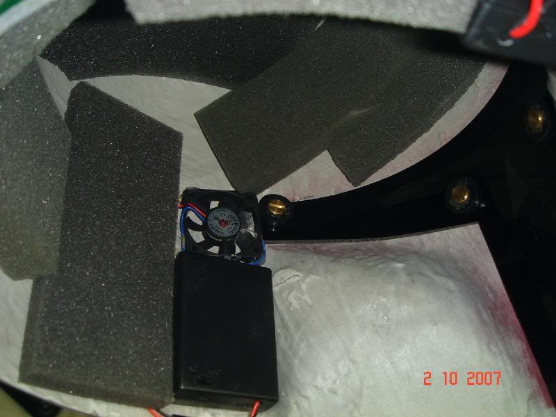

Since were talking about the visor, What do you guys do about the visor fogging up. Am I just a heavy breather or what. It doesn't effect my vision unliss I have to look down. There was this spray I used when I would scuba dive but I never knew the name and it was something that was around and never looked at the name. Most guys just spit on there lense. Not for me. I saw a fan in the pix and thought that was a good idea. What do the veterans have to say on this? Thank you.
I have the Novus Plastic polish for my TK costume. Bottle #1 is a cleaner and works well as a defogger in my TK helmet and my snowmobile helmet.
FANS!!! You want to keep the air temp on the inside as close to the air temp on the outside, and the moisture out. I haven't installed fans in my Boba bucket yet, but I may go with two squirrel cage fans for circulation. One to blow air down and out, the other to bring it in. Plus the fresh air blowing in keeps you from feeling enclosed.
On my TK I noticed that the lenses don't touch the helmet 100%, there are a few little gaps, allowing air to move. I may do the same with my Boba, leave a little gap, as long as it goes unseen.
Good luck !
Thanks Timmer. Squirrel cage fans are what, The computer fans? How about a power supply. I'm getting a hollow stalk and RF and if I put two fans in along with the LEDs, what is going to power all that up. As I mentioned before, The helmet in past threads has a cool set up. I will PM him to find out. Thanks for the help.
Squirrel cage fans look like a hair dryer without the handle. The computer fans are generally flat, but I guess both are found inside various computers.
20 dBA is a not too loud, but a friend recommended keep below 45 dBA, it might be pretty loud in your helmet.
How exactly do the fans work ? do they extract to somewhere or pick up and pull fresh air through a vent ?

Halo_1;297451]Quick question, which helmet do you own, and did you get the correct 'sized' visor? I know 'R' offers 3 versions so as to NOT have this problem.
My set up...
Stay safe,
Tim.[/QUOTE]
I believe that the squirrel cage fans pick up air at the center of the circular part, then obviously blow it out the straight part. The computer fans as shown above look like they circulate whatever air is in the helmet, unless they are vented from behind somehow. Any air circulation is a plus. My local Vader has zero fans, I can't figure out how he survives ! That's a really nice, cleanly designed bucket interior you have Slinger !!
Another option, which I haven't really seen anyone do, is to mount a fan over the keyslots in the back of the helmet. On one hand, you give up accuracy by losing the calculator piece normally placed there, on the other, it's a sweet spot to ventilate ( provided your hair doesn't get caught ! ).
I also thought about getting speaker grill cloth or some other thin material to cover the keyslots. You could paint it or silkscreen it to look like the calc. part, but have a fan there to blow air out, or draw it in.
