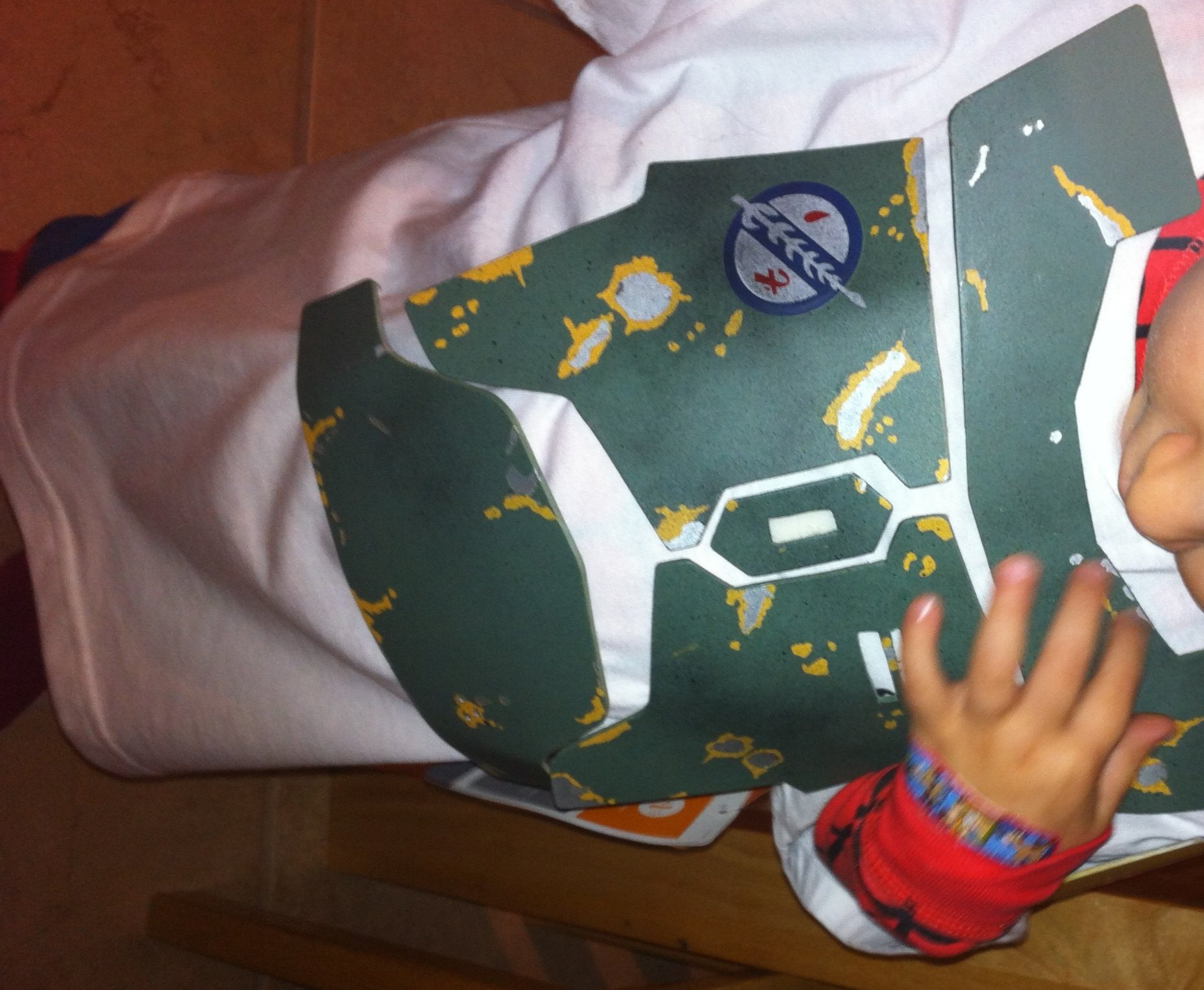

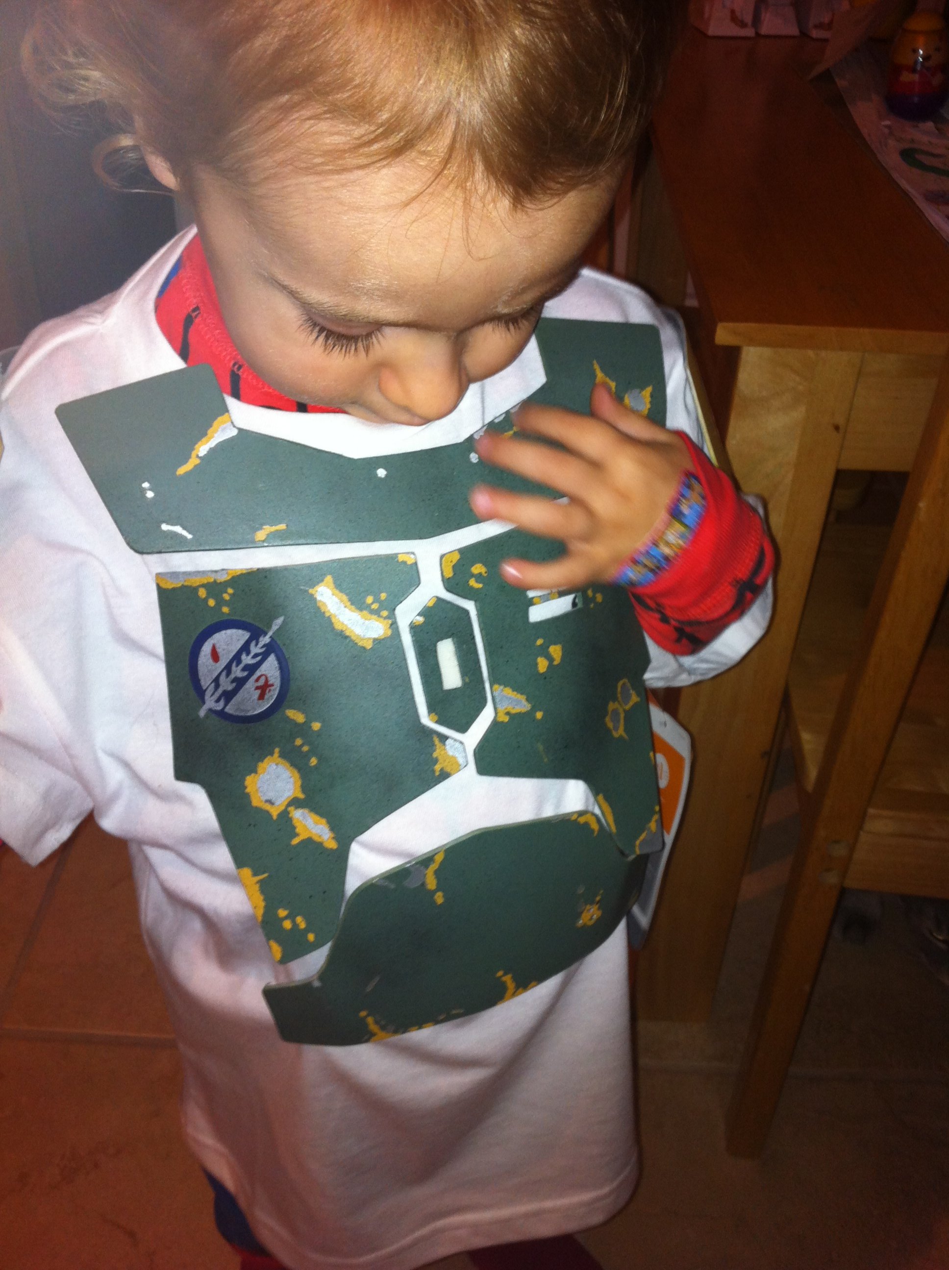

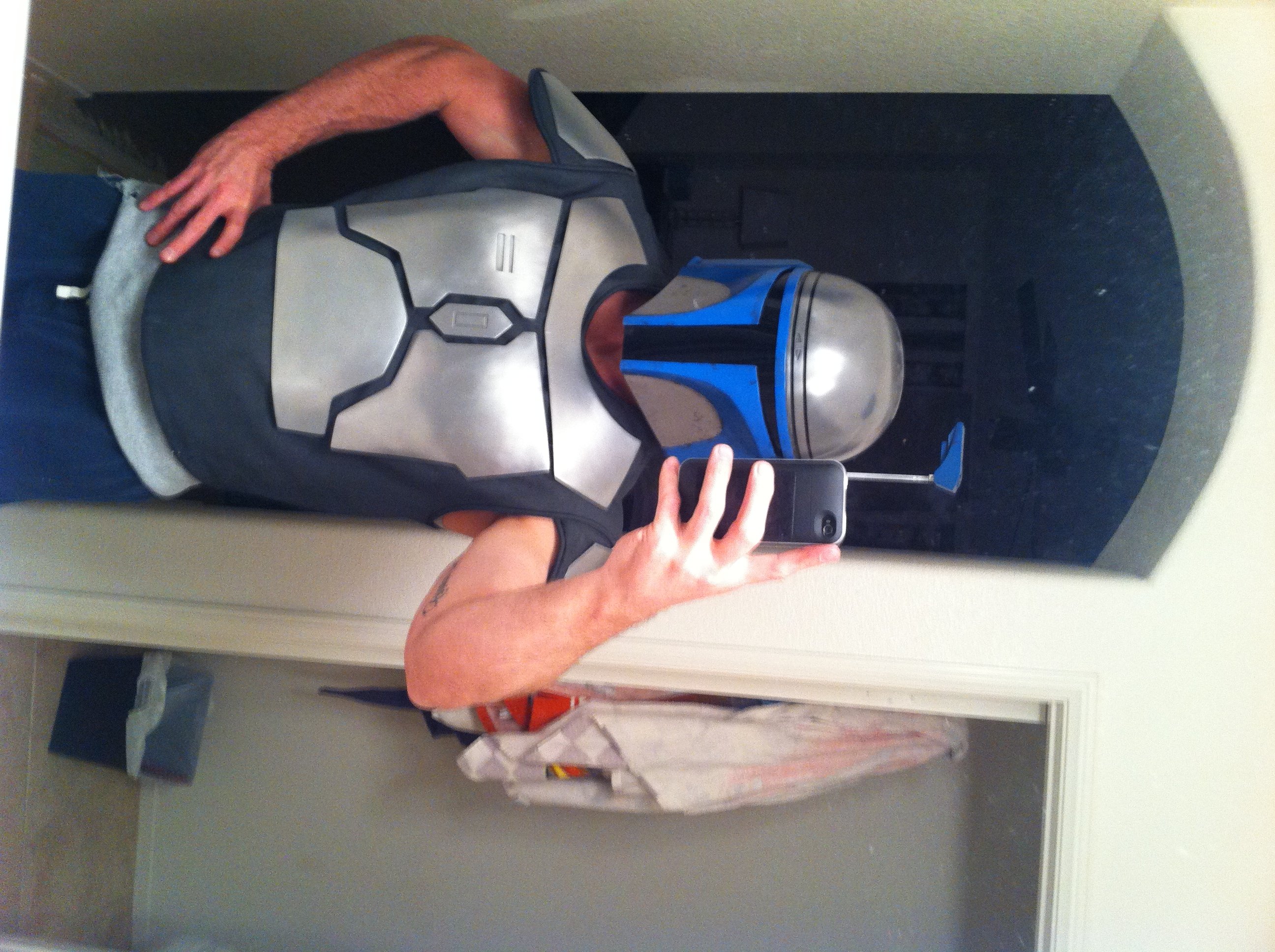

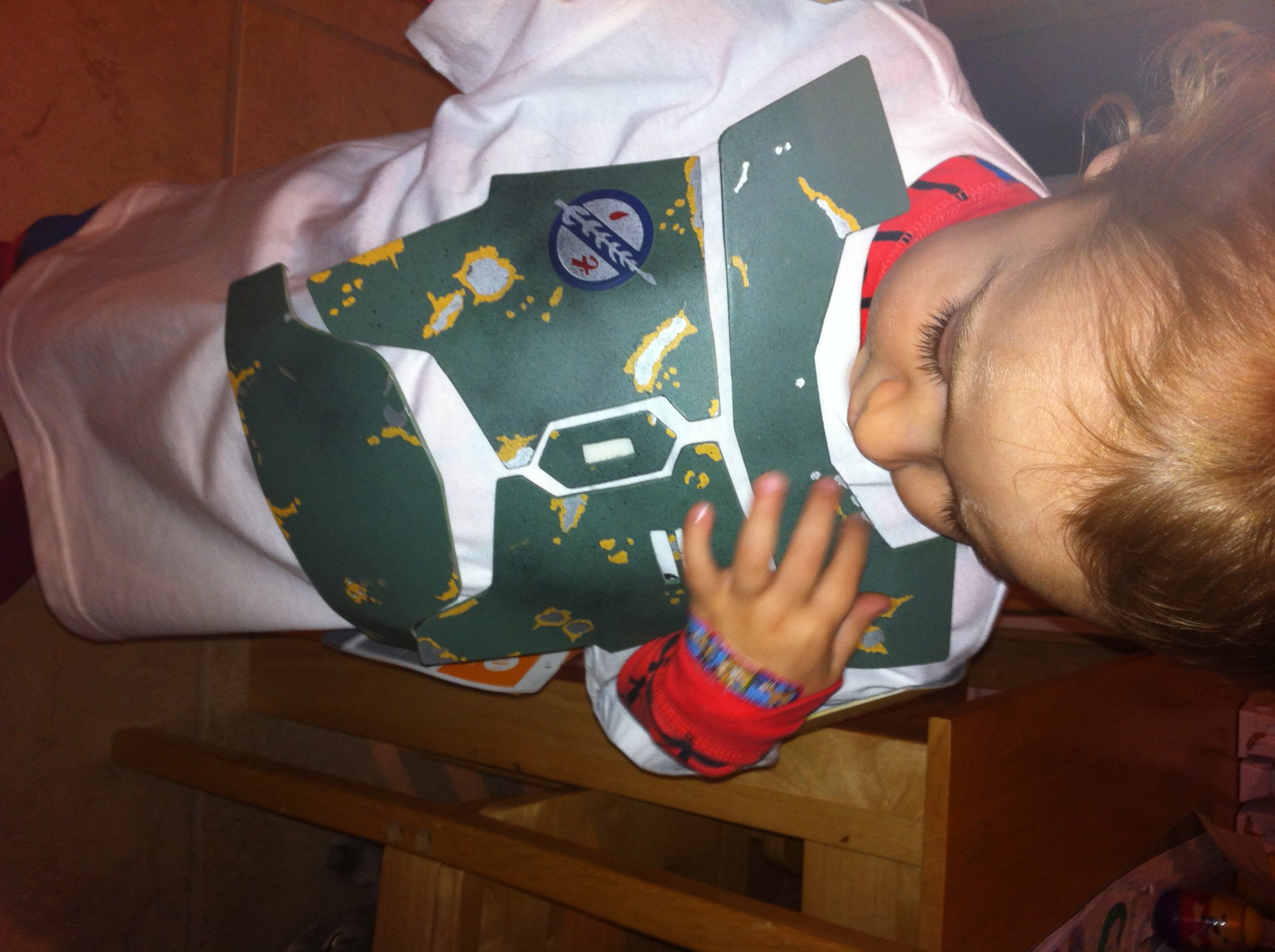

Thanks to everyone for the excellent input, experience and acute insite as it was all extremely helpful. I ended up using snaps along w/ one strip of velcro on each piece. When I do my BF I will most likely go the same route. After doing my sons set-up and my jango I feel fairly comfortable w/ this method. Let me know what you guys think.
Thanks again

Hey verbal- What I did w/ the jango was (with the help from obro) glued the female end of the snaps onto the armor. Once dried, I chalked the snaps and (with the vest on and in front of a mirror) lined up the collar onto the vest first, pressed firmly and vuallah there are your markers. Definatley begin w/ the collar as its easy to line everything up from there. Hope this helps.
