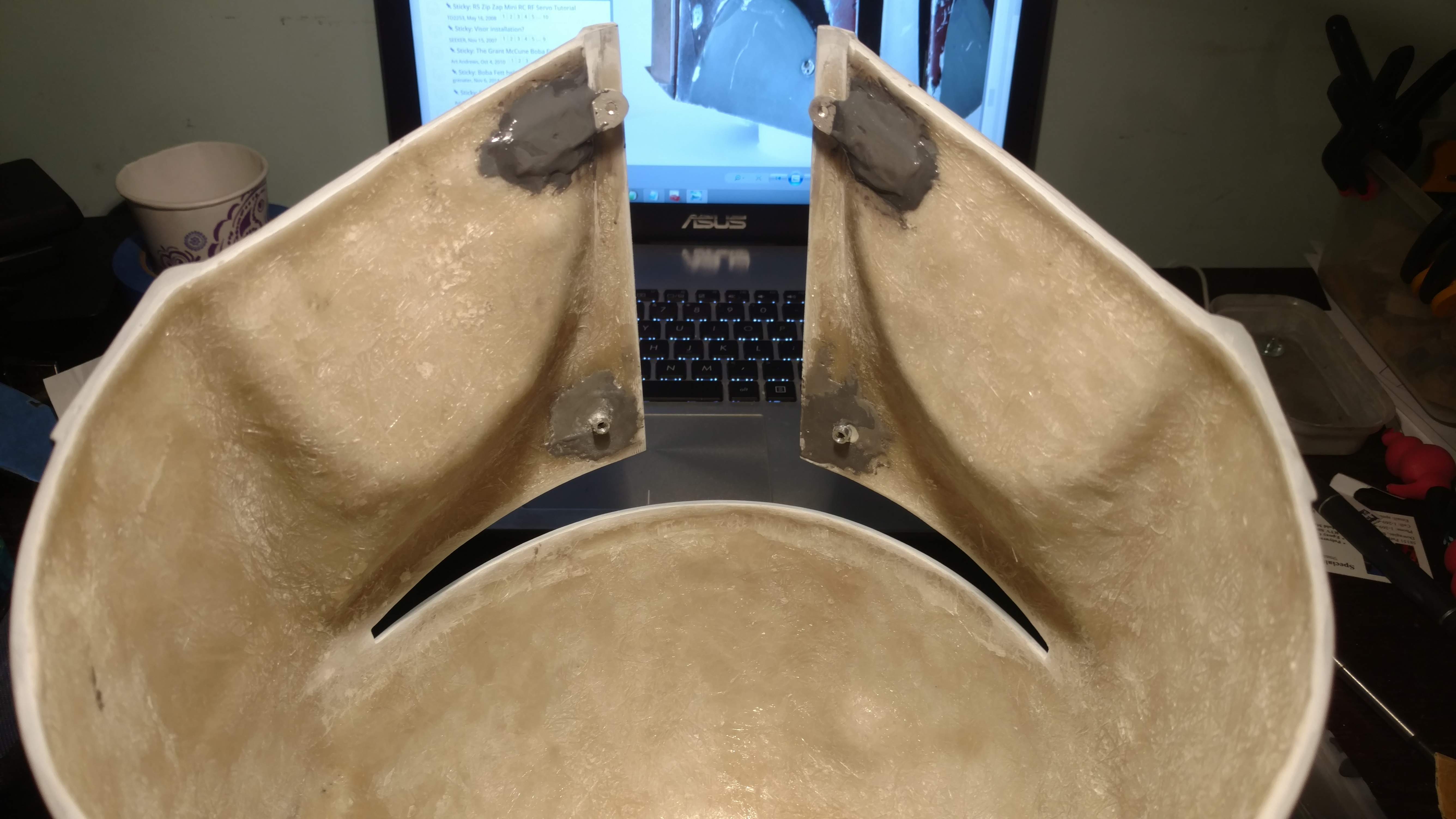

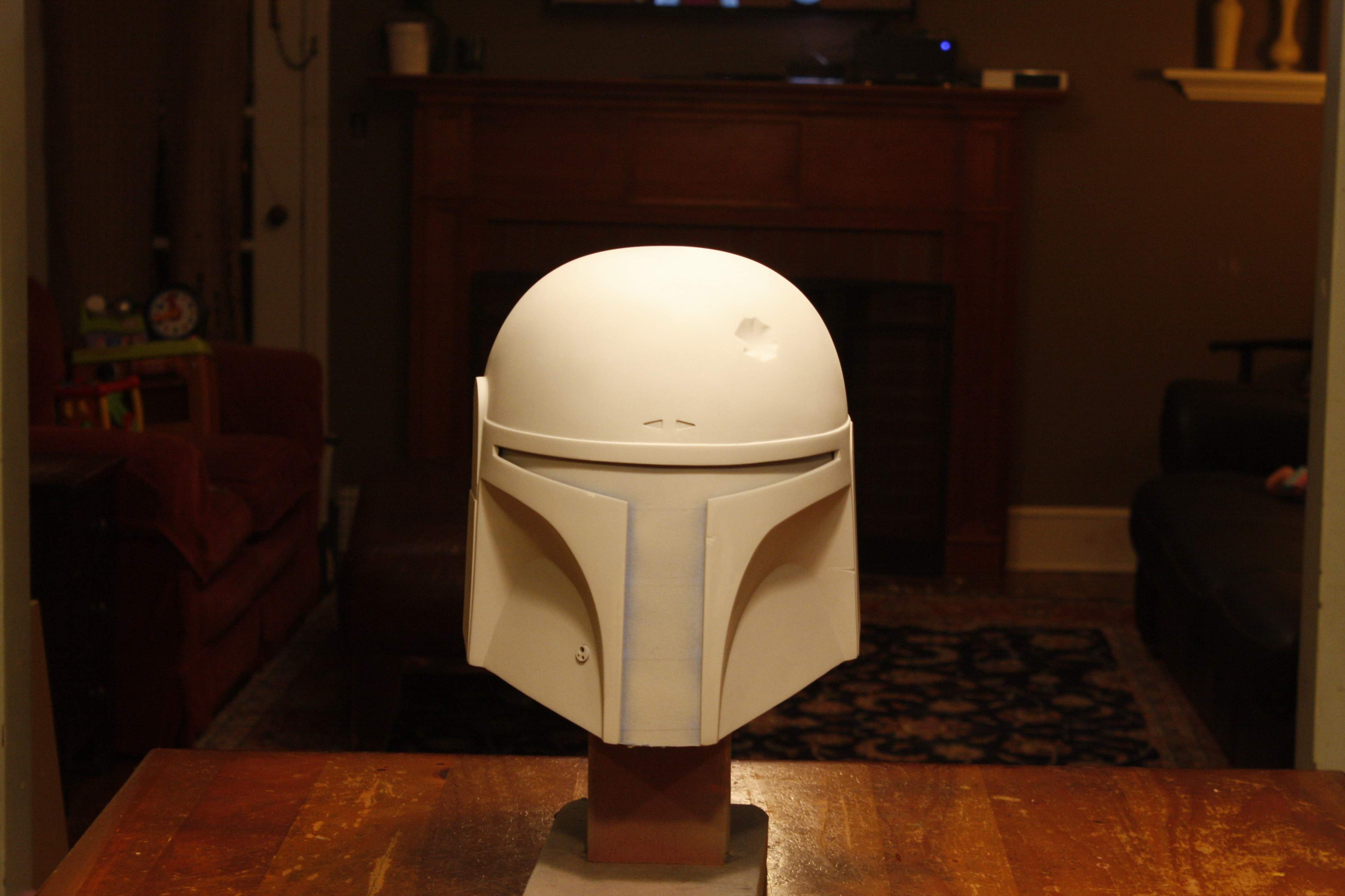

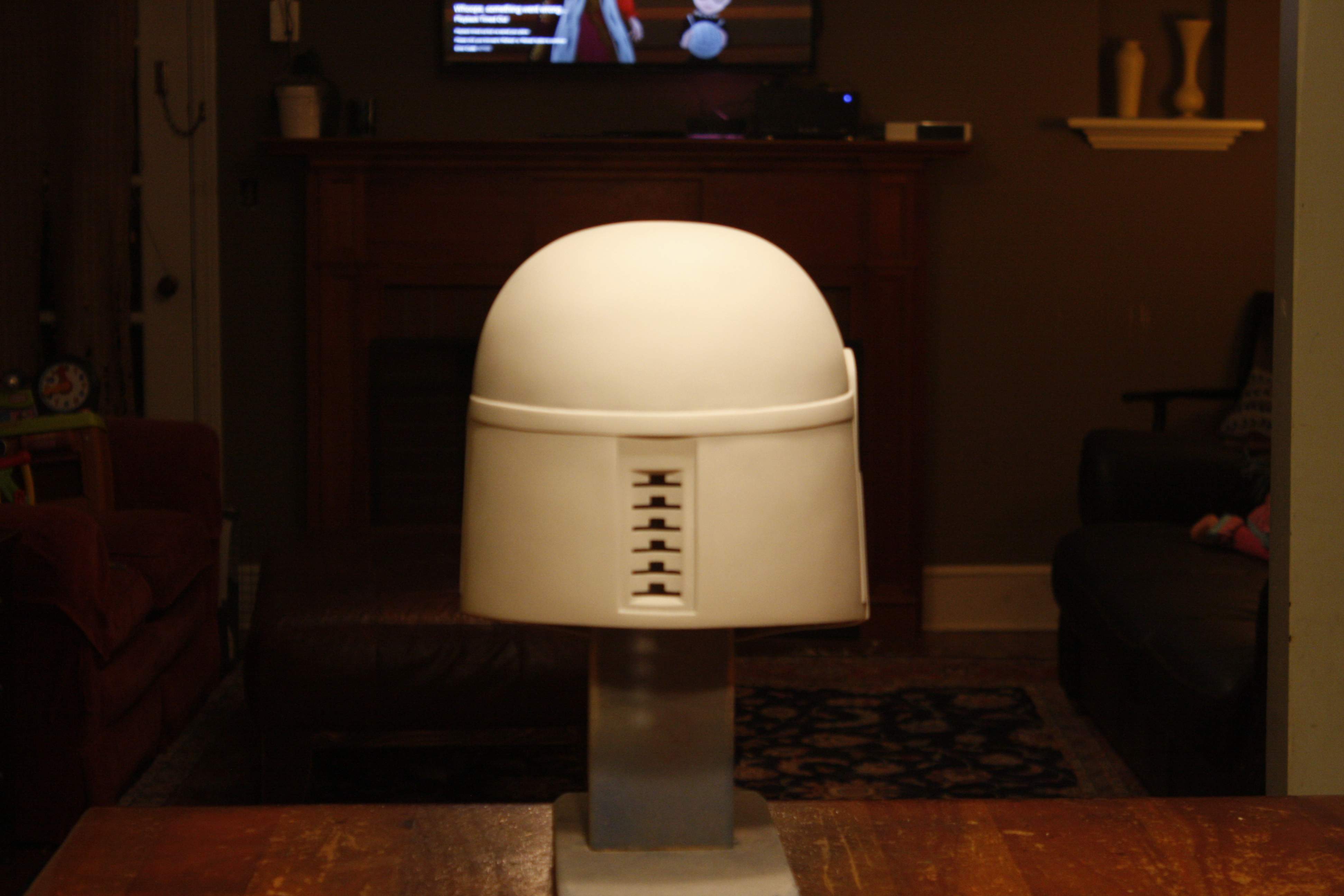

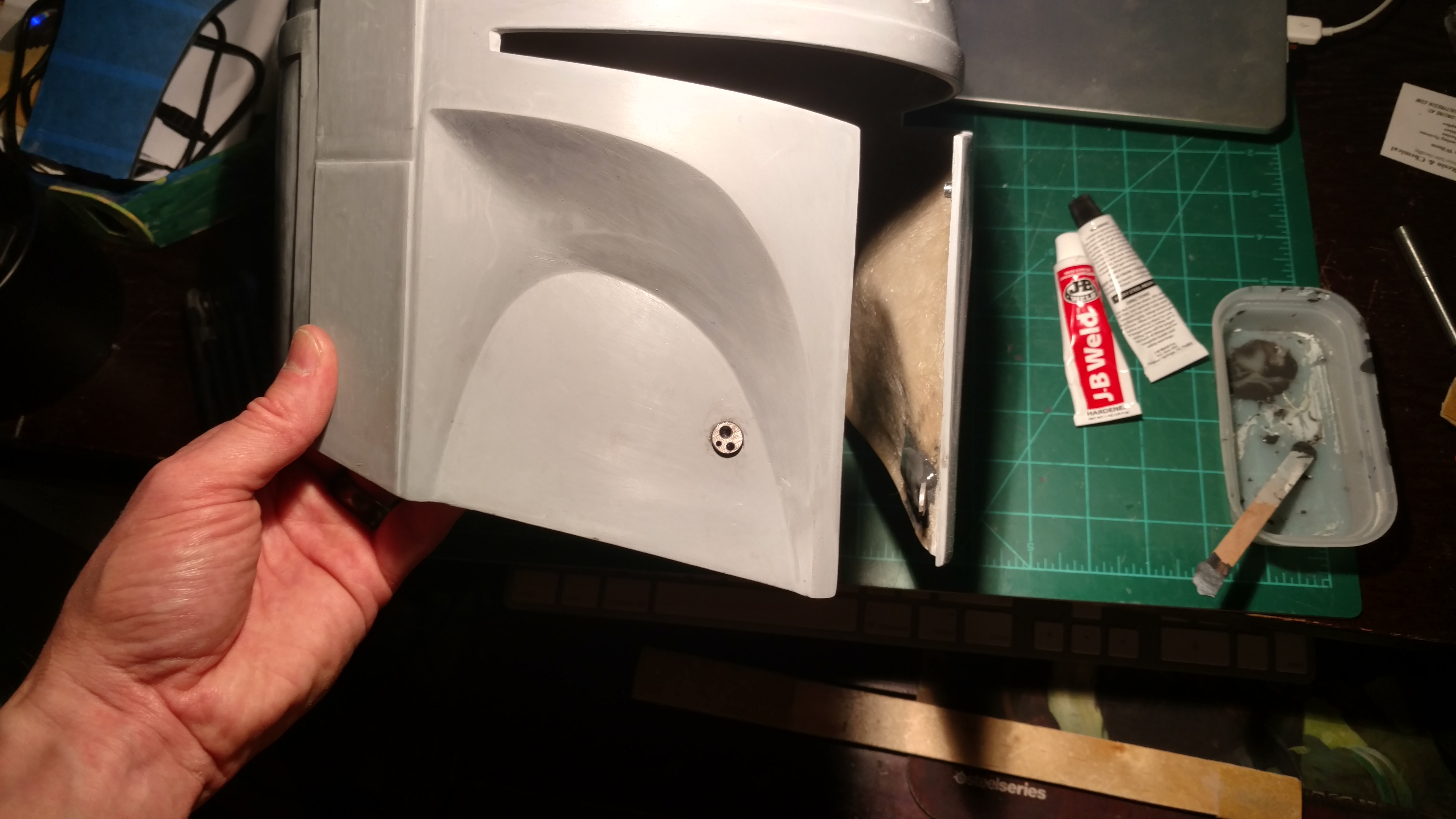

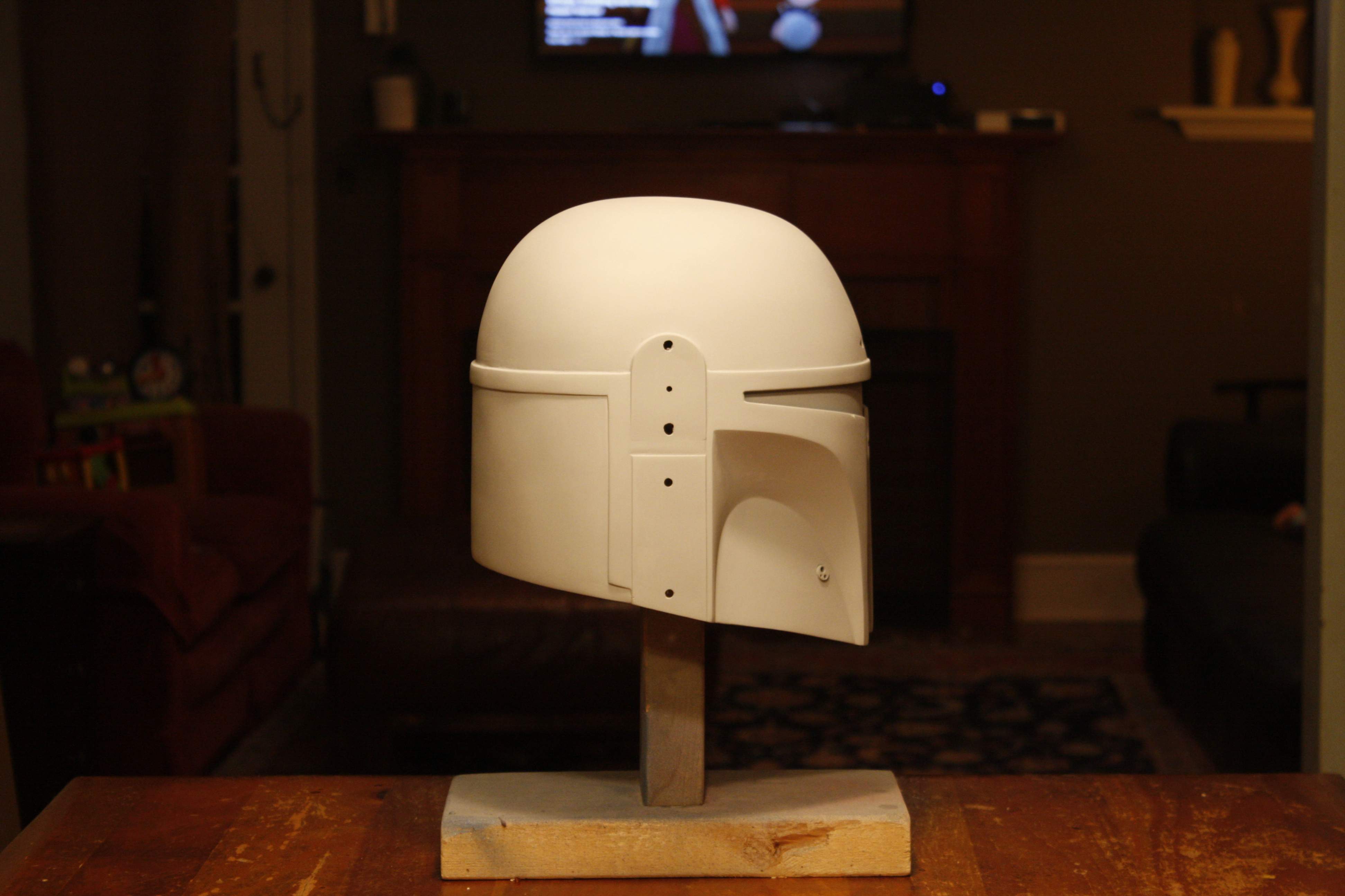

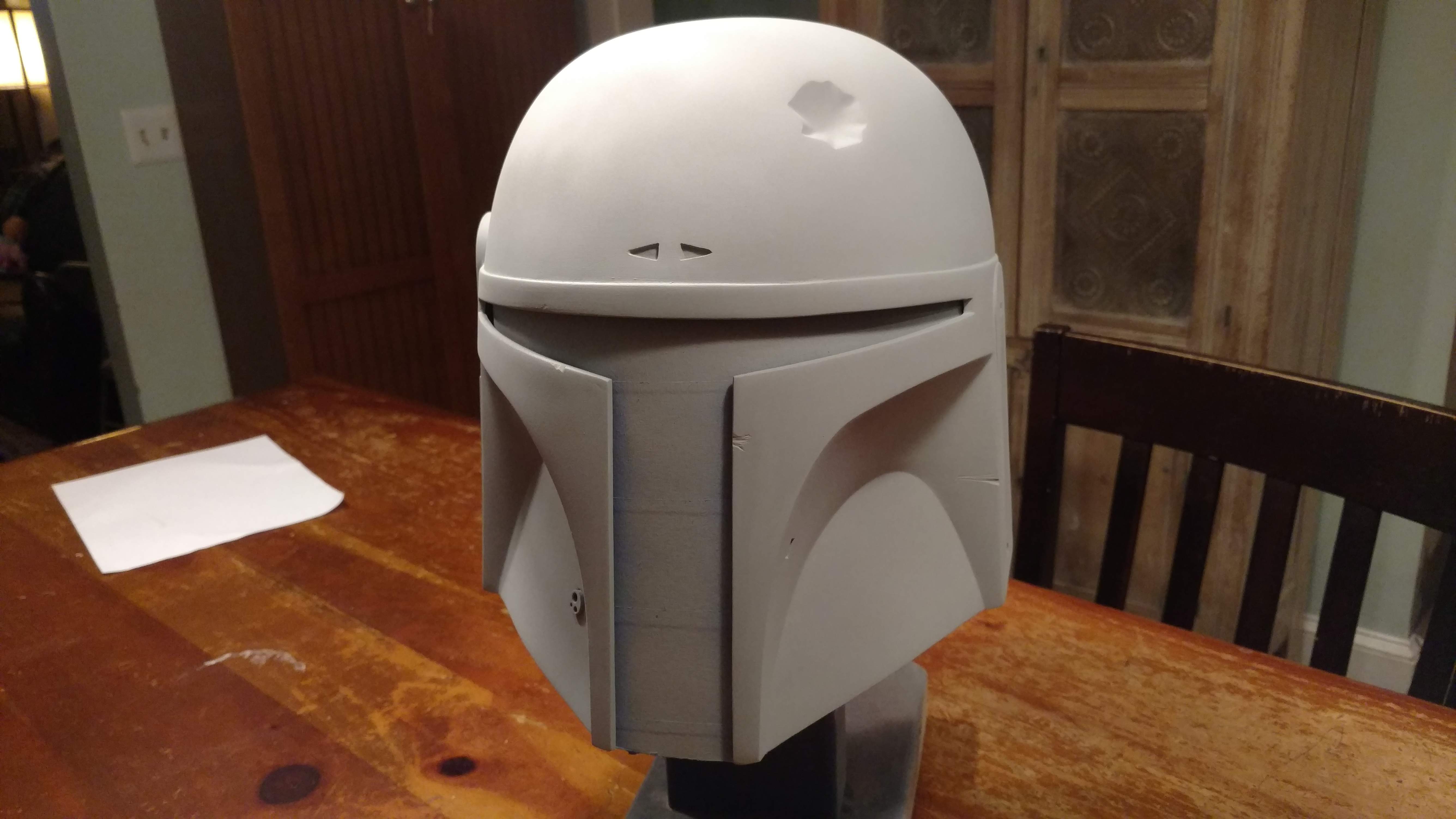

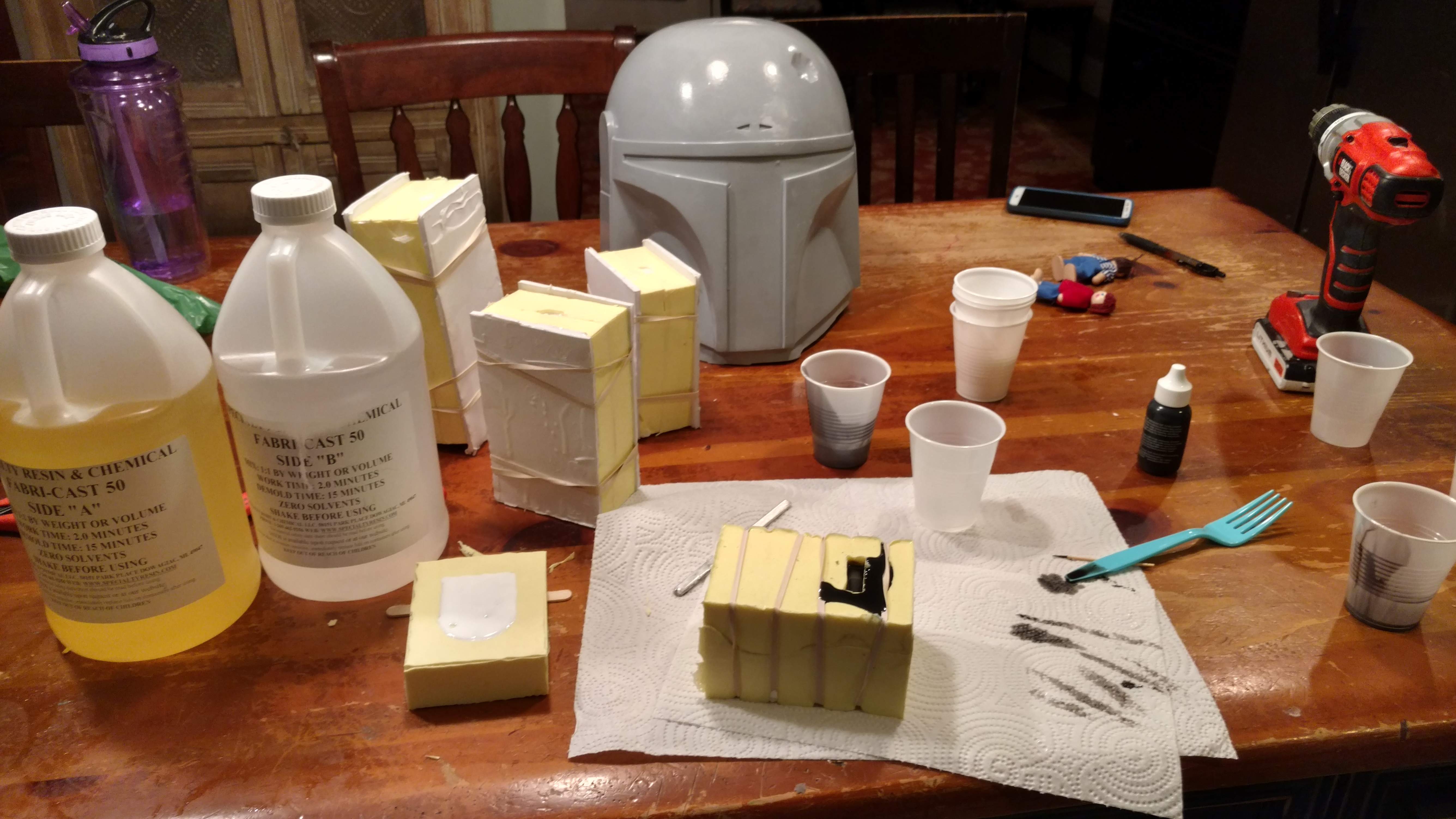

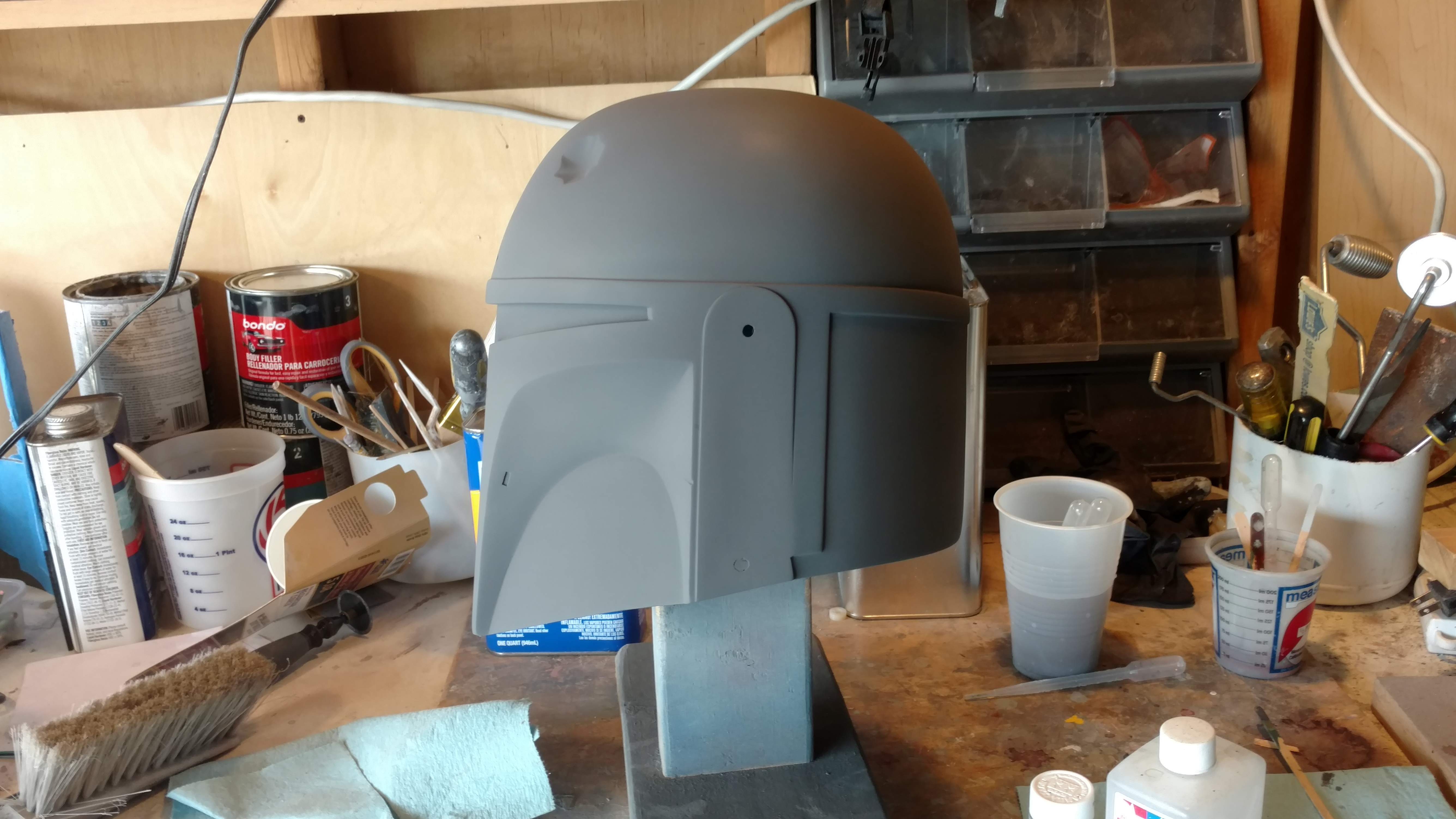

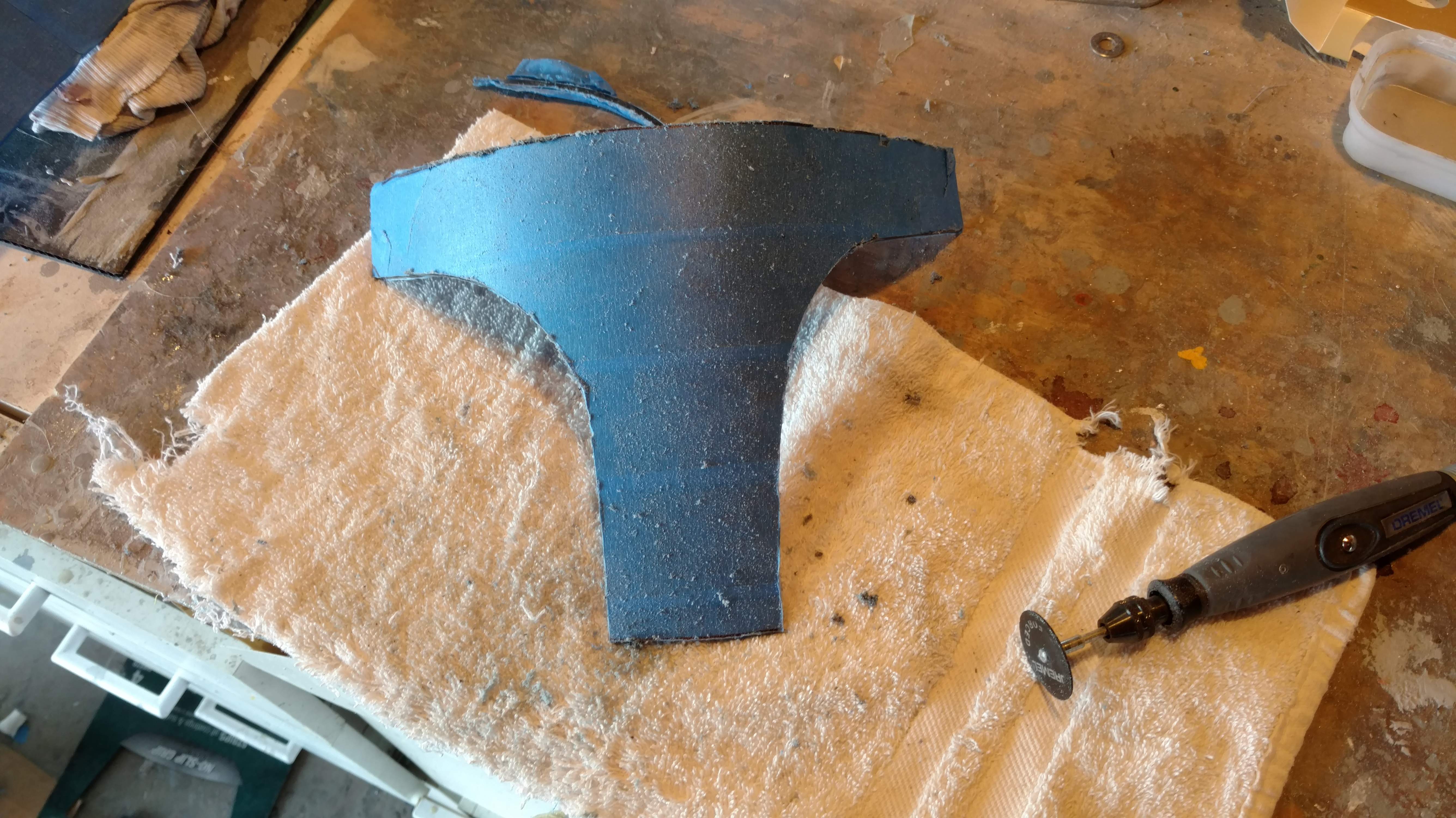

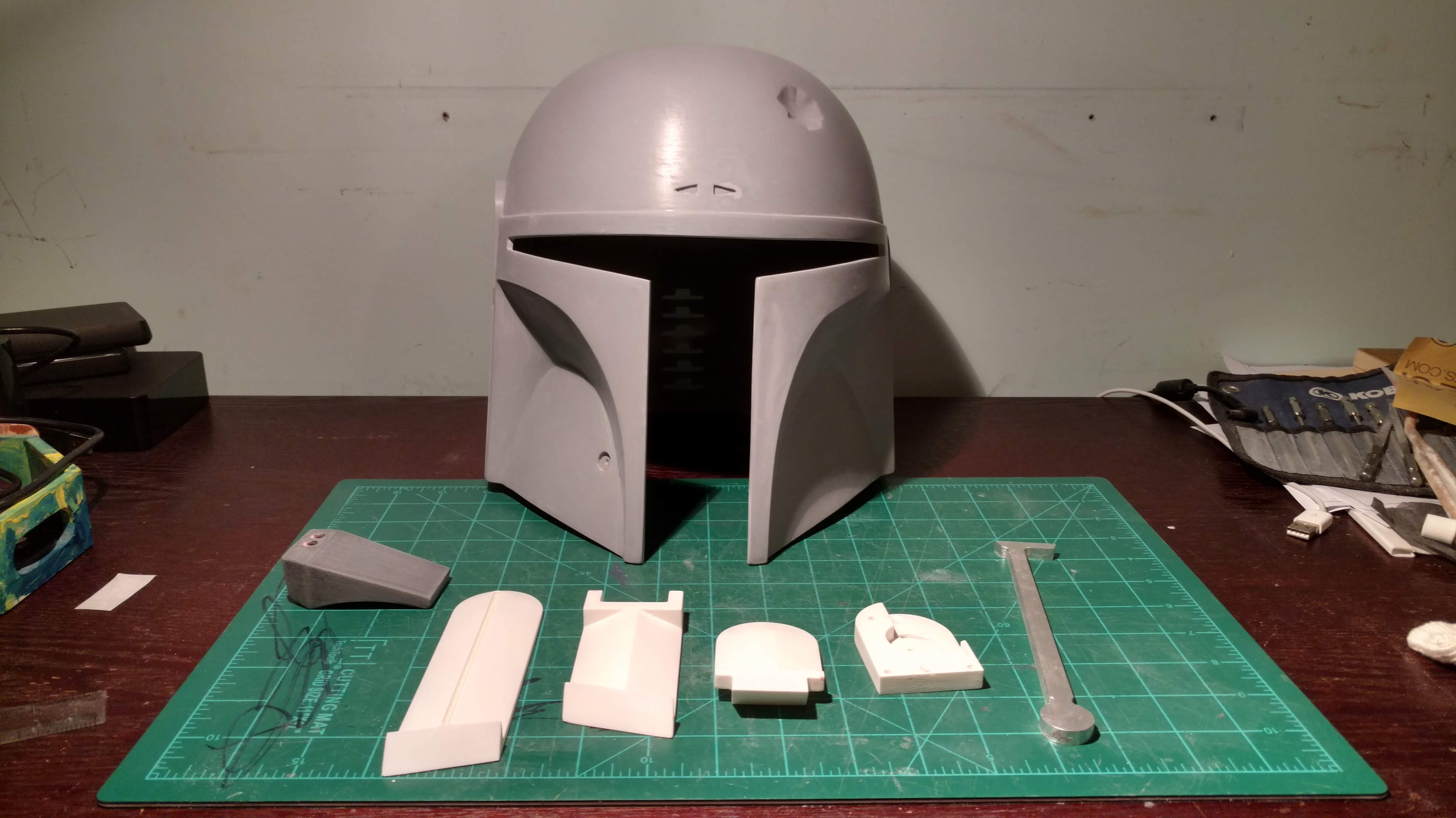

Here I'll be posting updates for a complete ESB paintup using one of my casts.

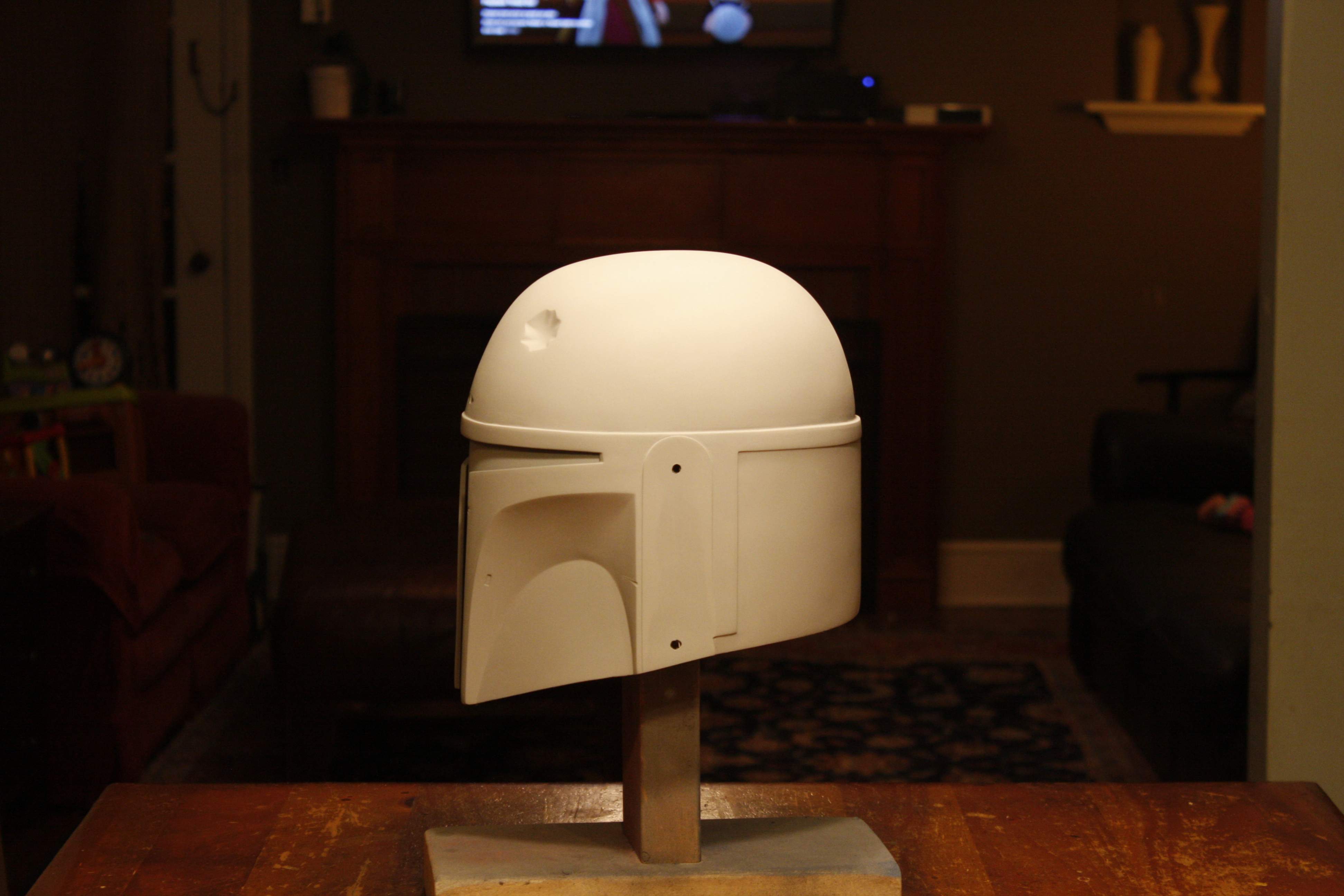

I've got almost everything ready to paint. I still need to drill the ear connections and glue the borden connector in place.
IMG_20160423_142200461_HDR.jpgIMG_20160421_230211551_HDR.jpgIMG_20160424_153246699.jpgIMG_20160424_161613822.jpg

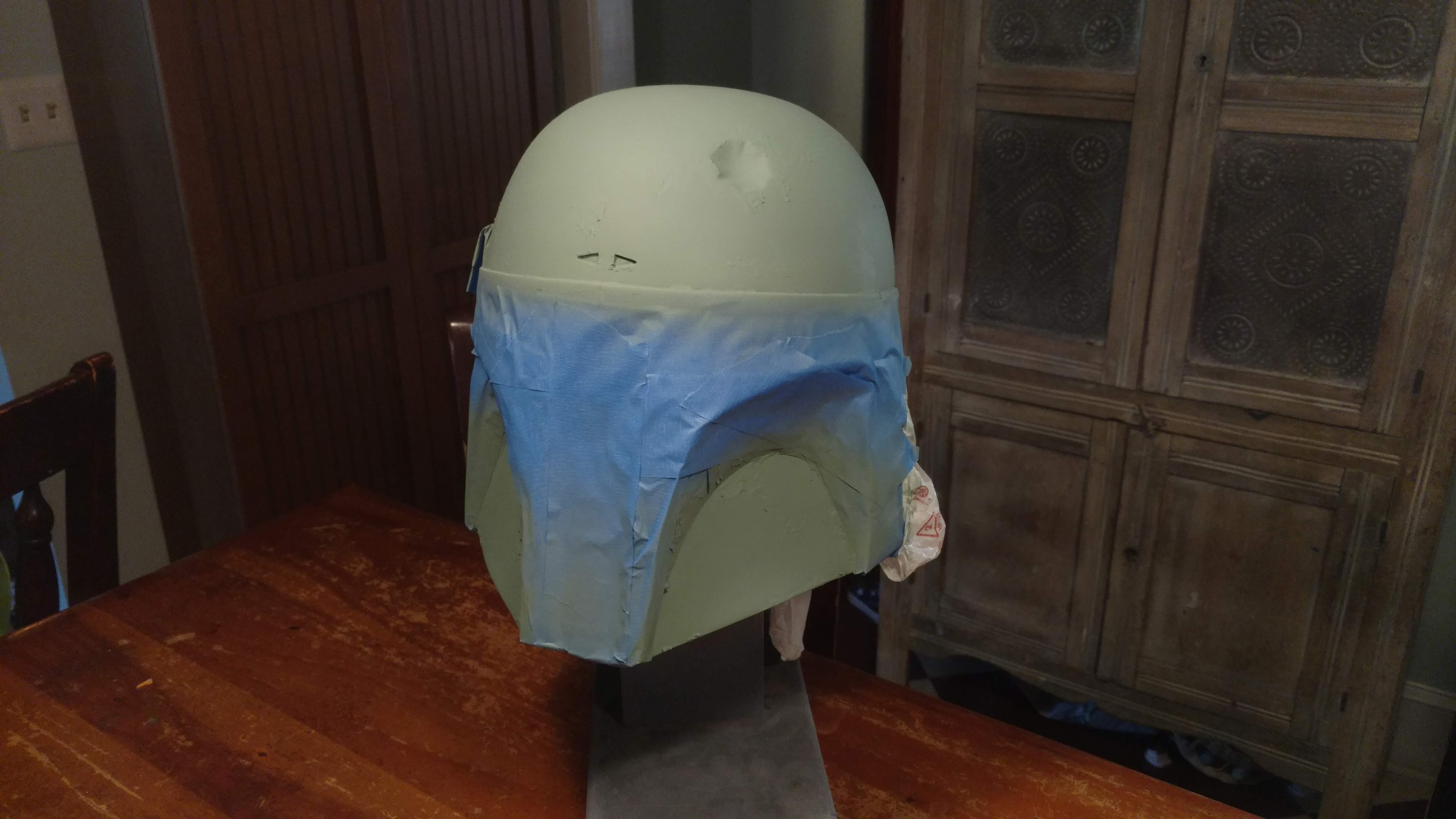

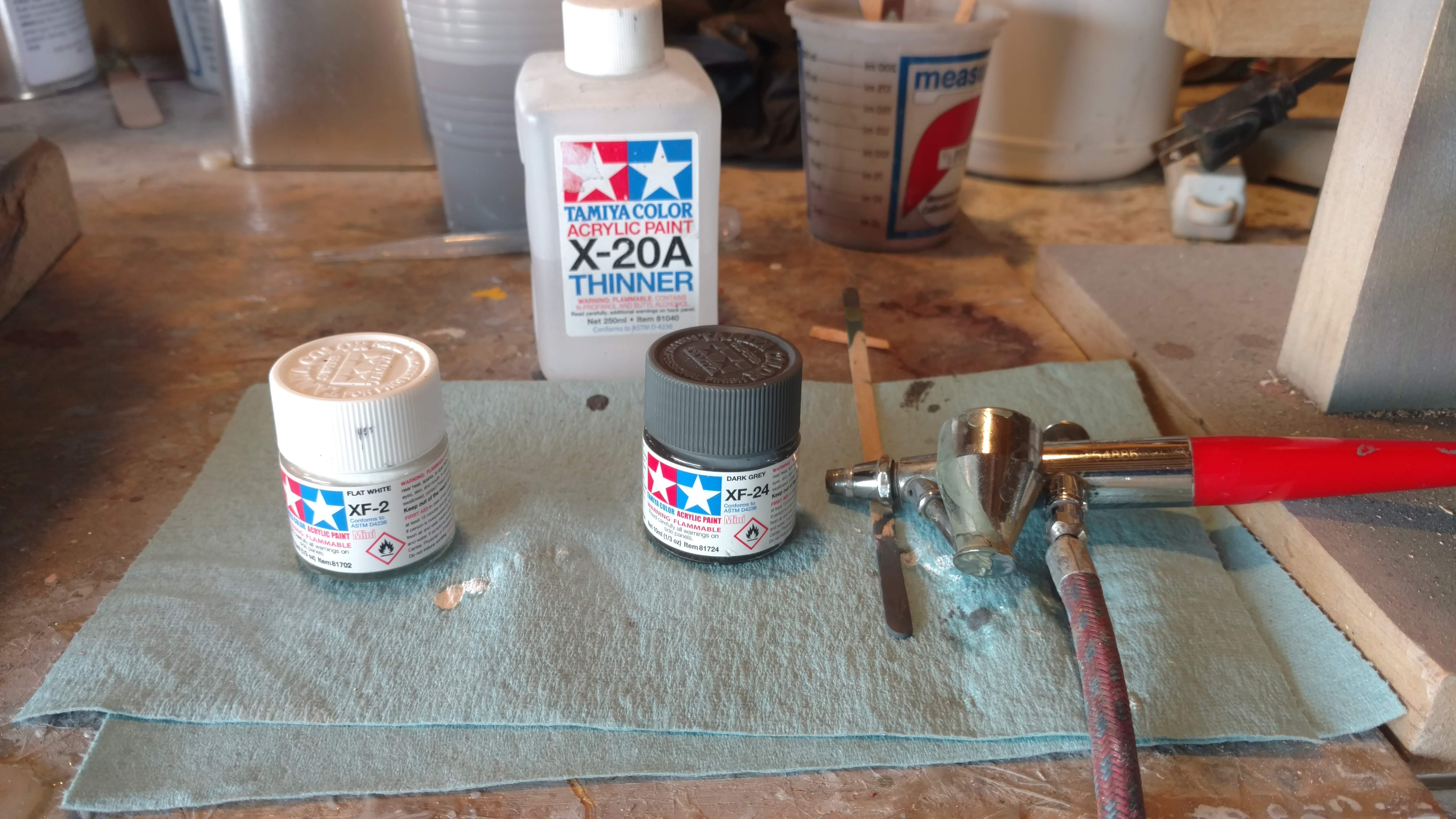

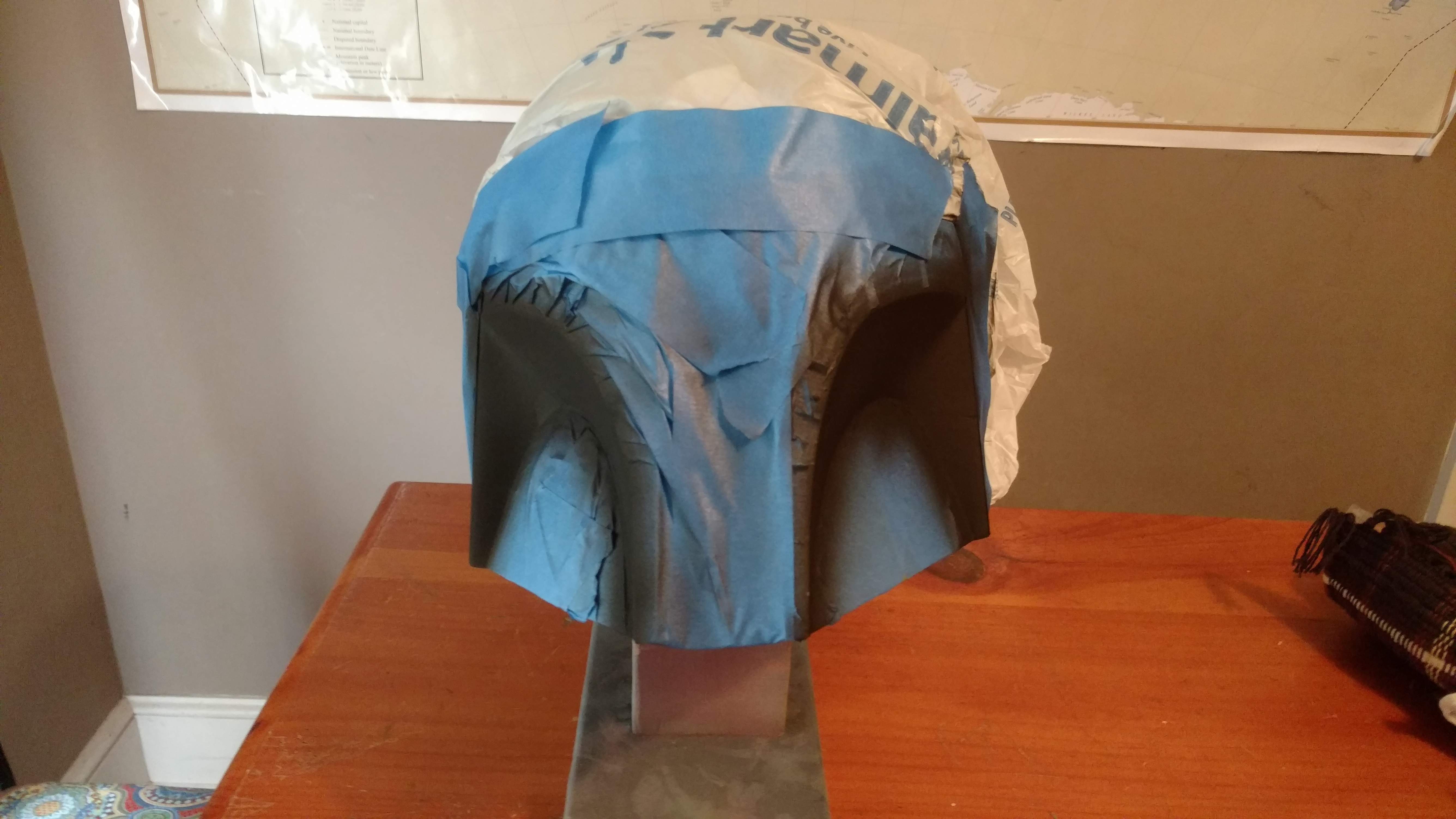

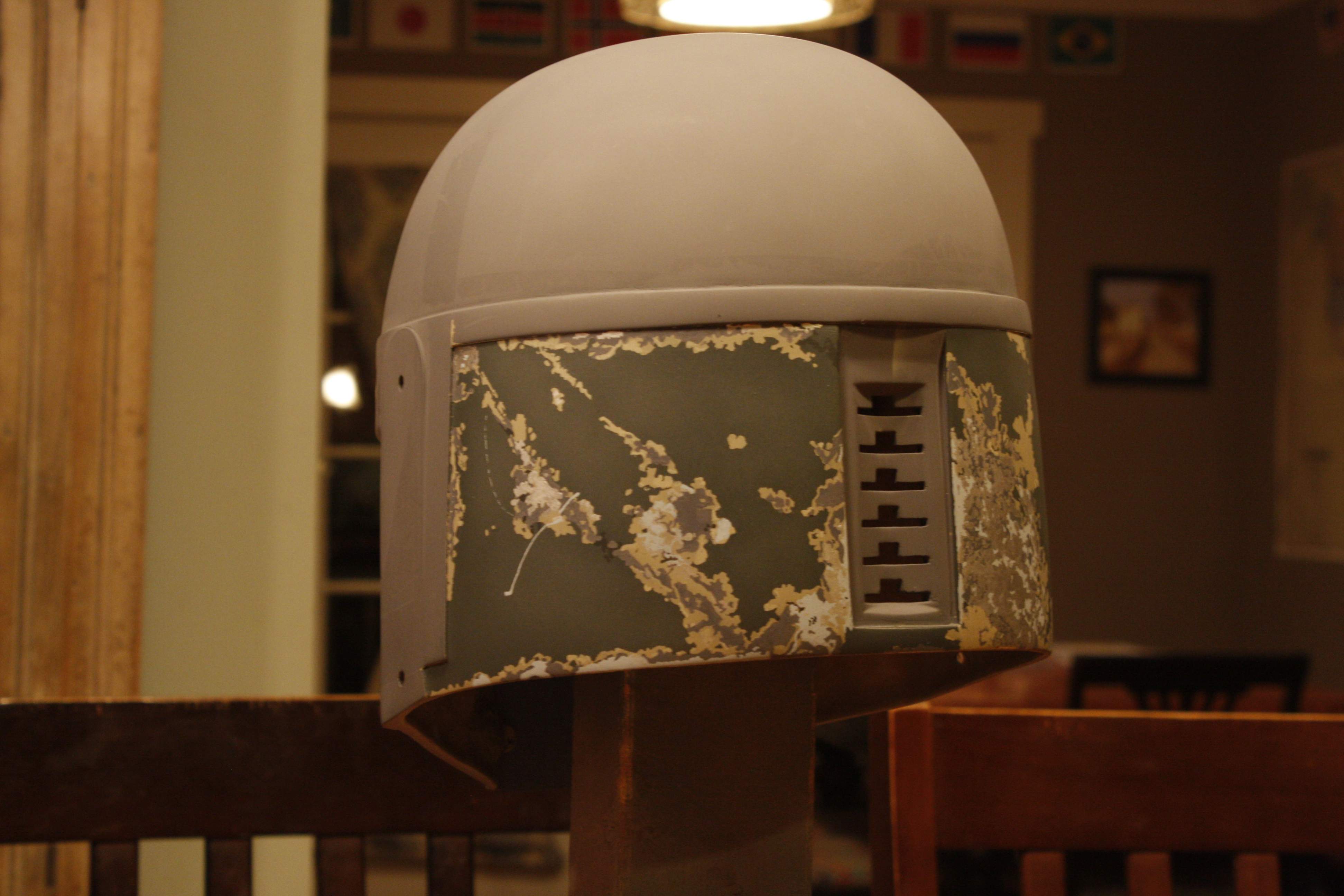

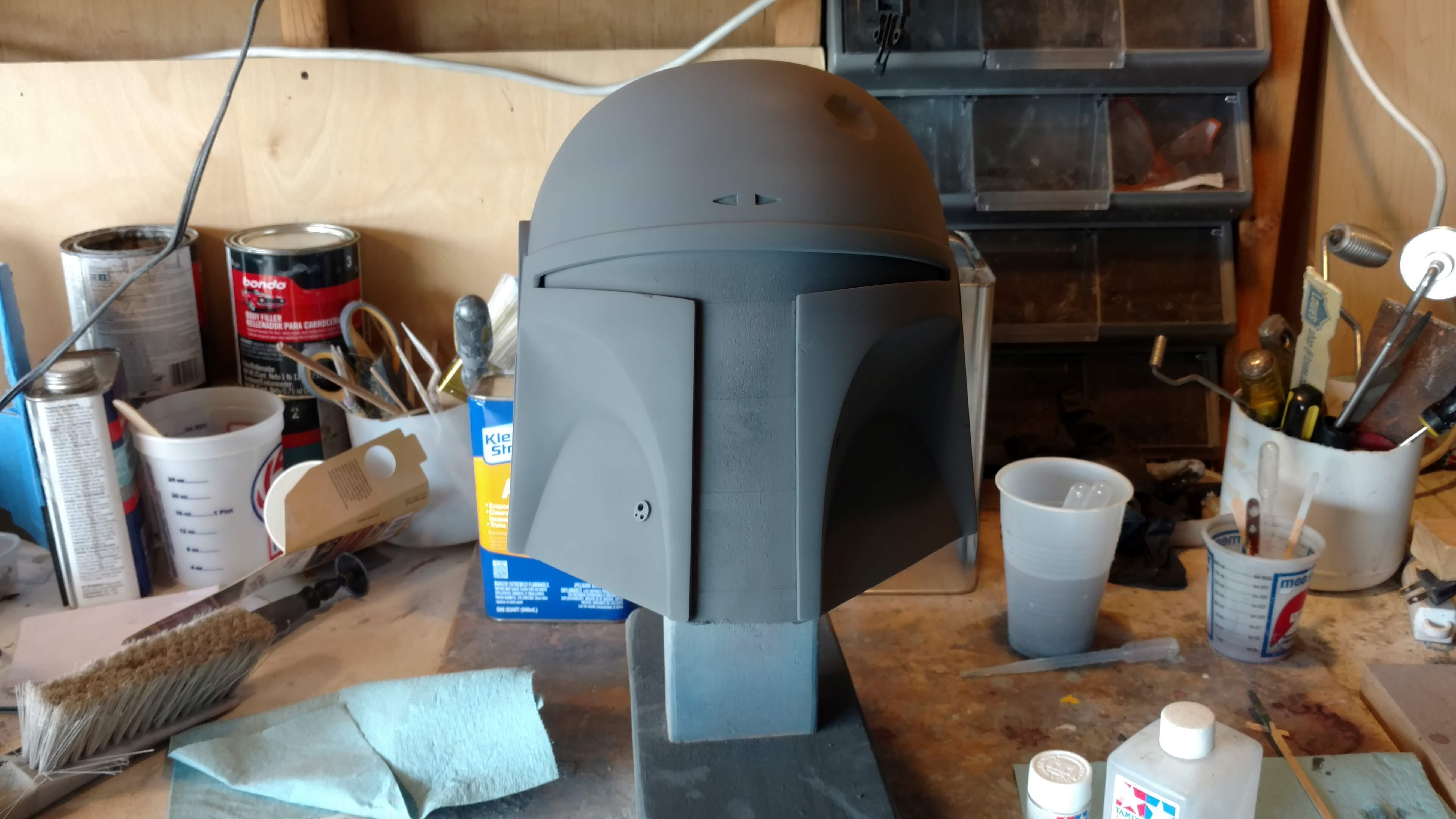

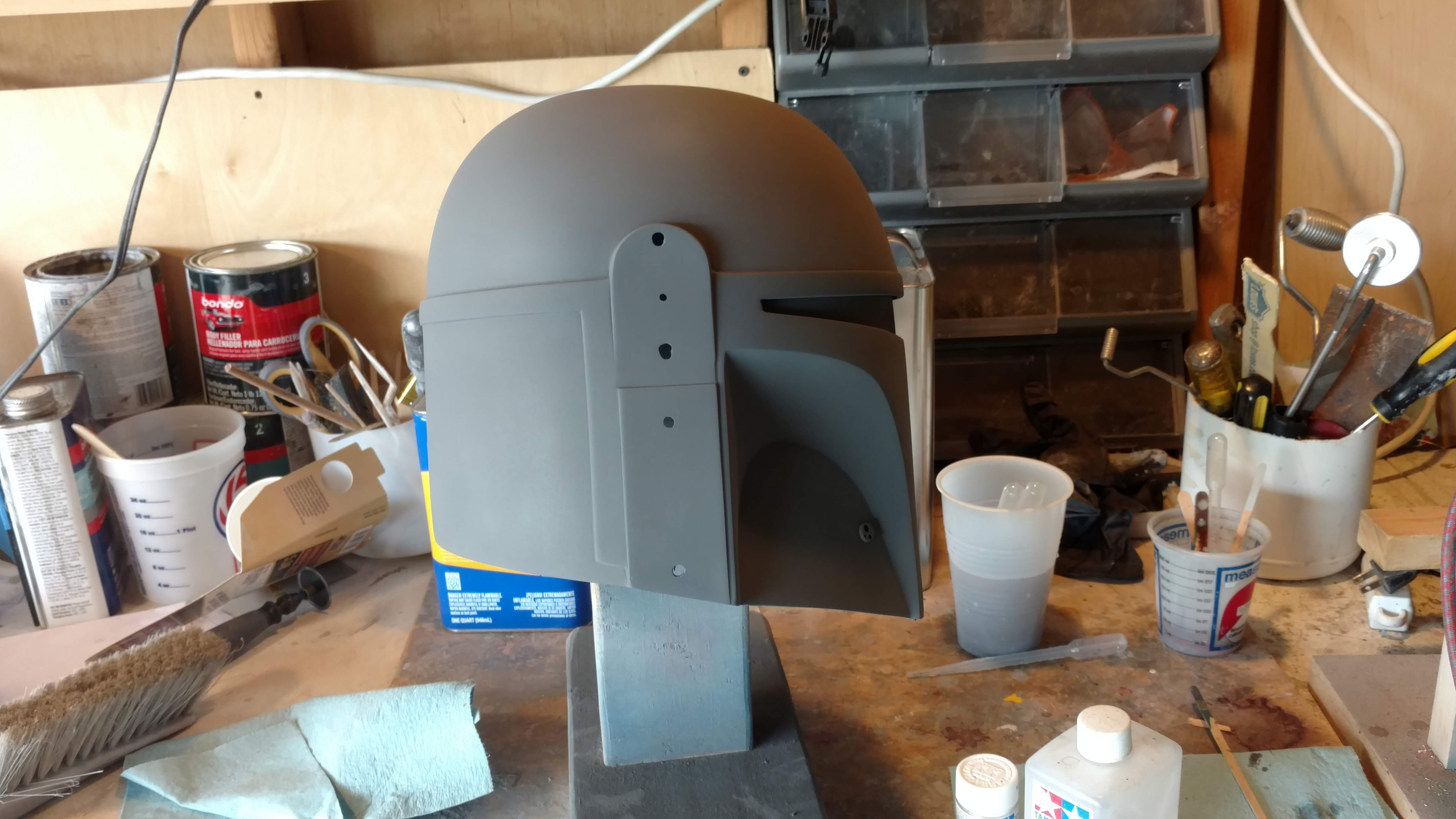

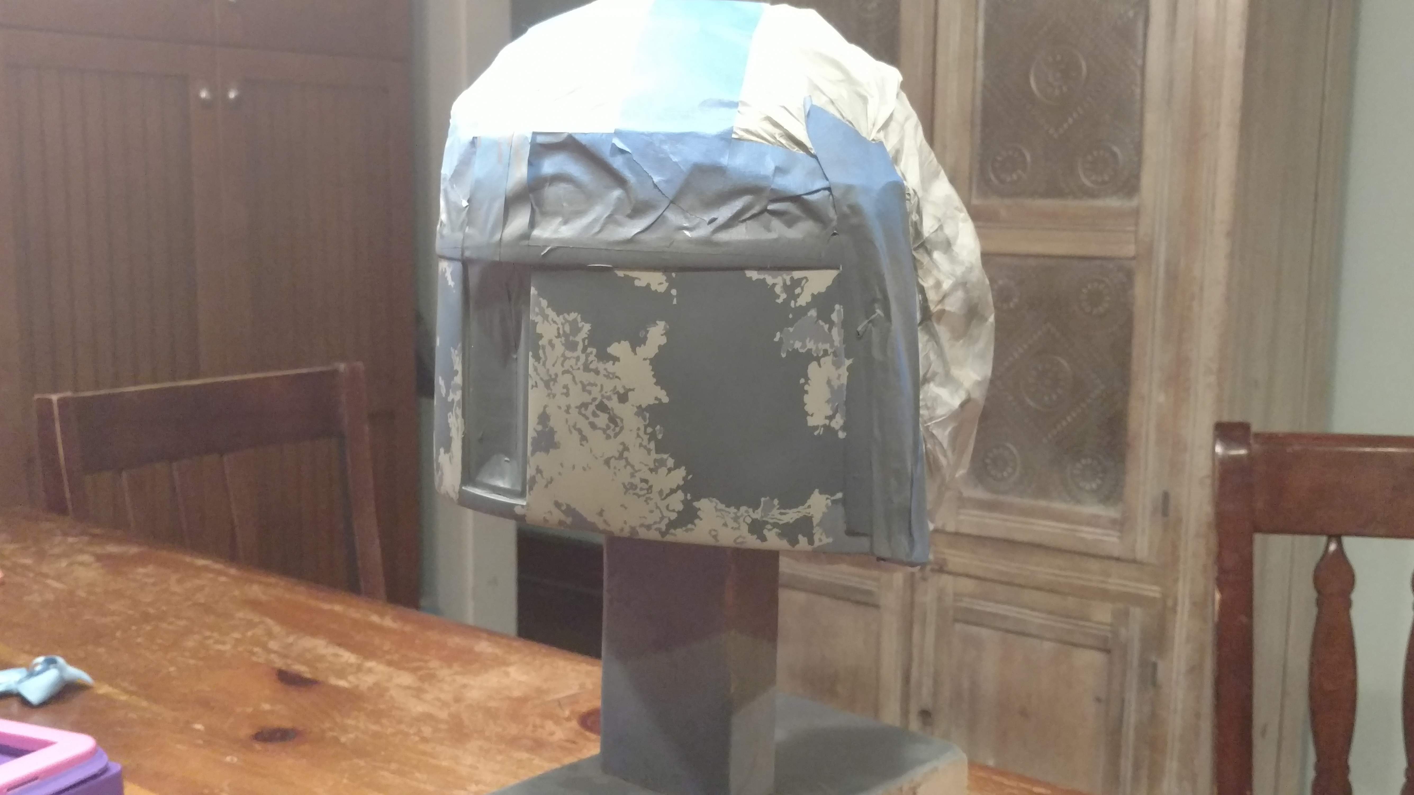

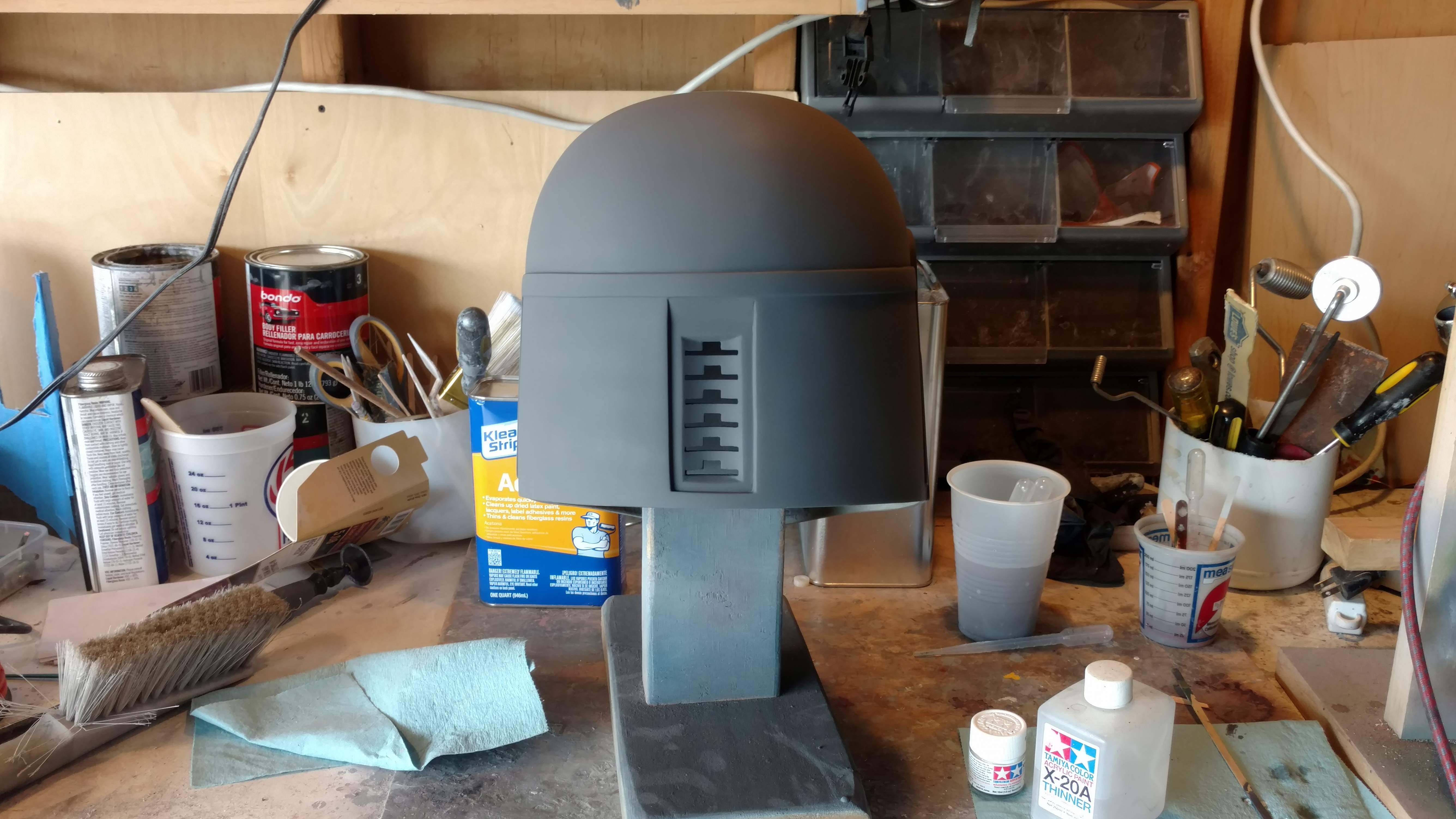

After a few passes of Krylon primer and wet sanding, I airbrushed the dark gray layer over the entire helmet. For the dark gray I used Tamiya XF-24 dark gray with a few drops of XF-2 white, about 20:1. It's all pretty subjective. This happened to look good to me.
IMG_20160430_124918021.jpgIMG_20160430_124910020.jpgIMG_20160430_124856571.jpgIMG_20160430_124927426.jpgIMG_20160430_125005520.jpg

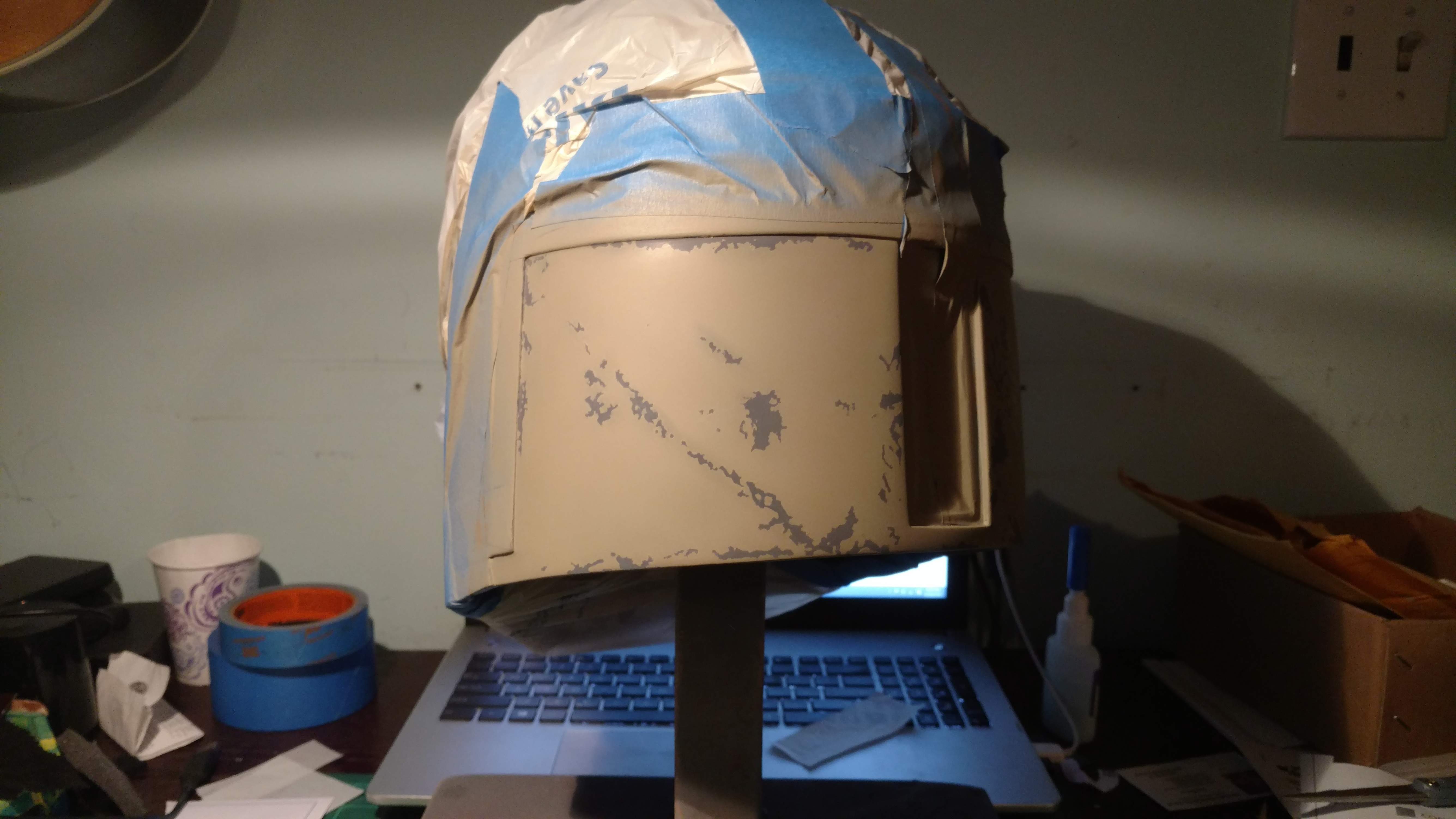

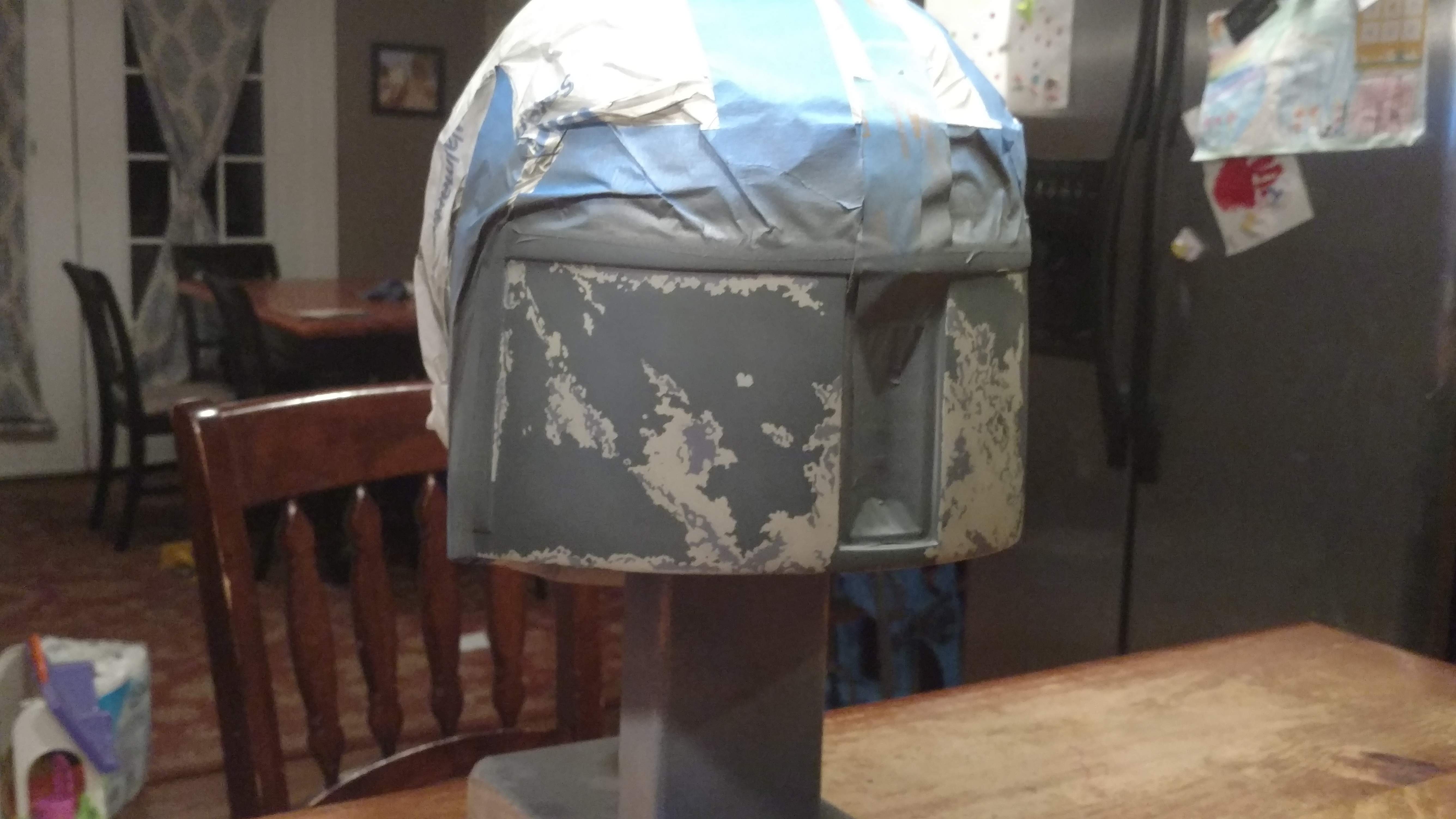

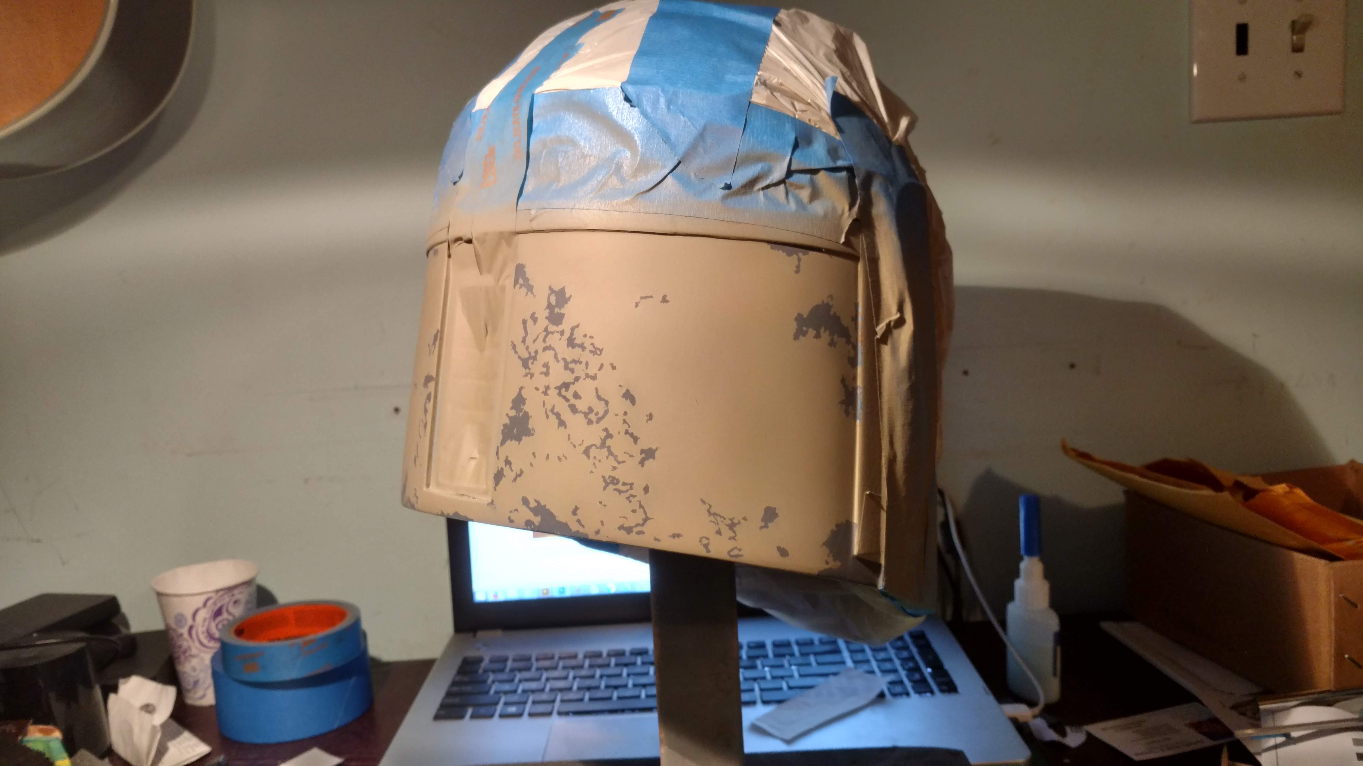

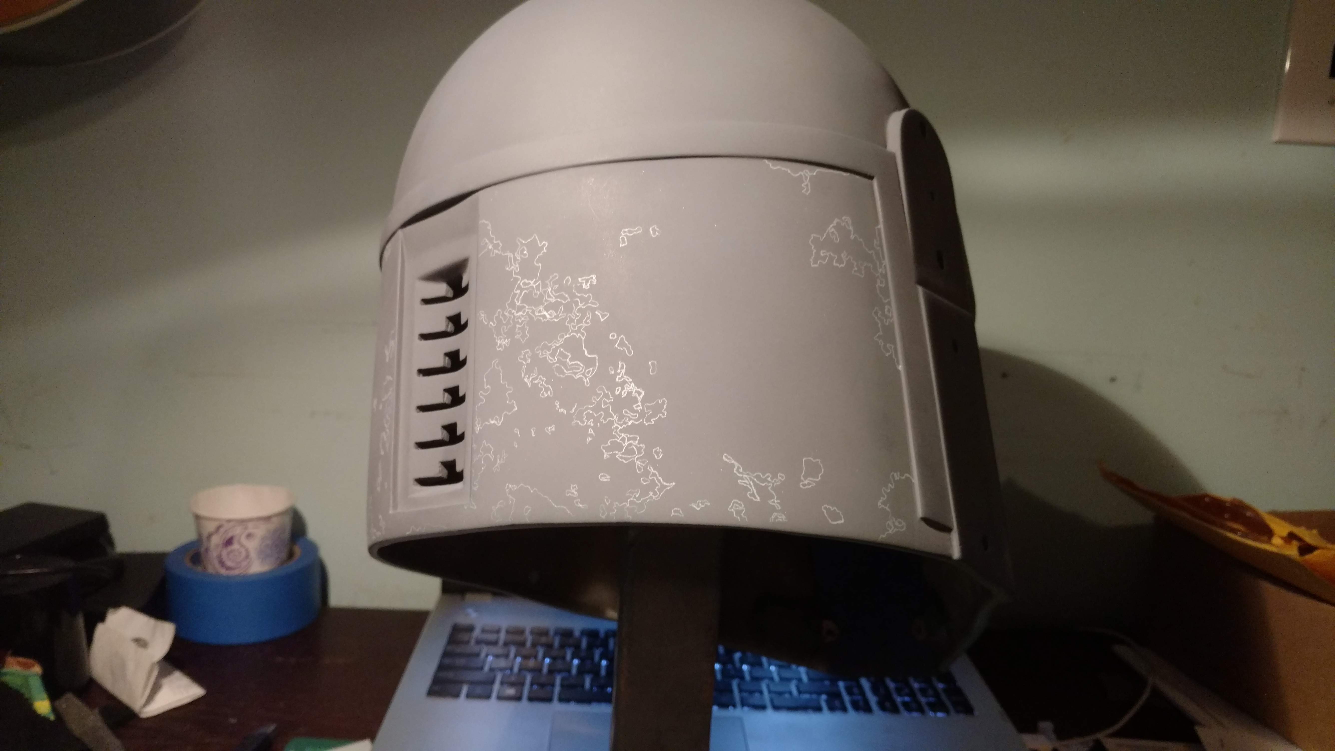

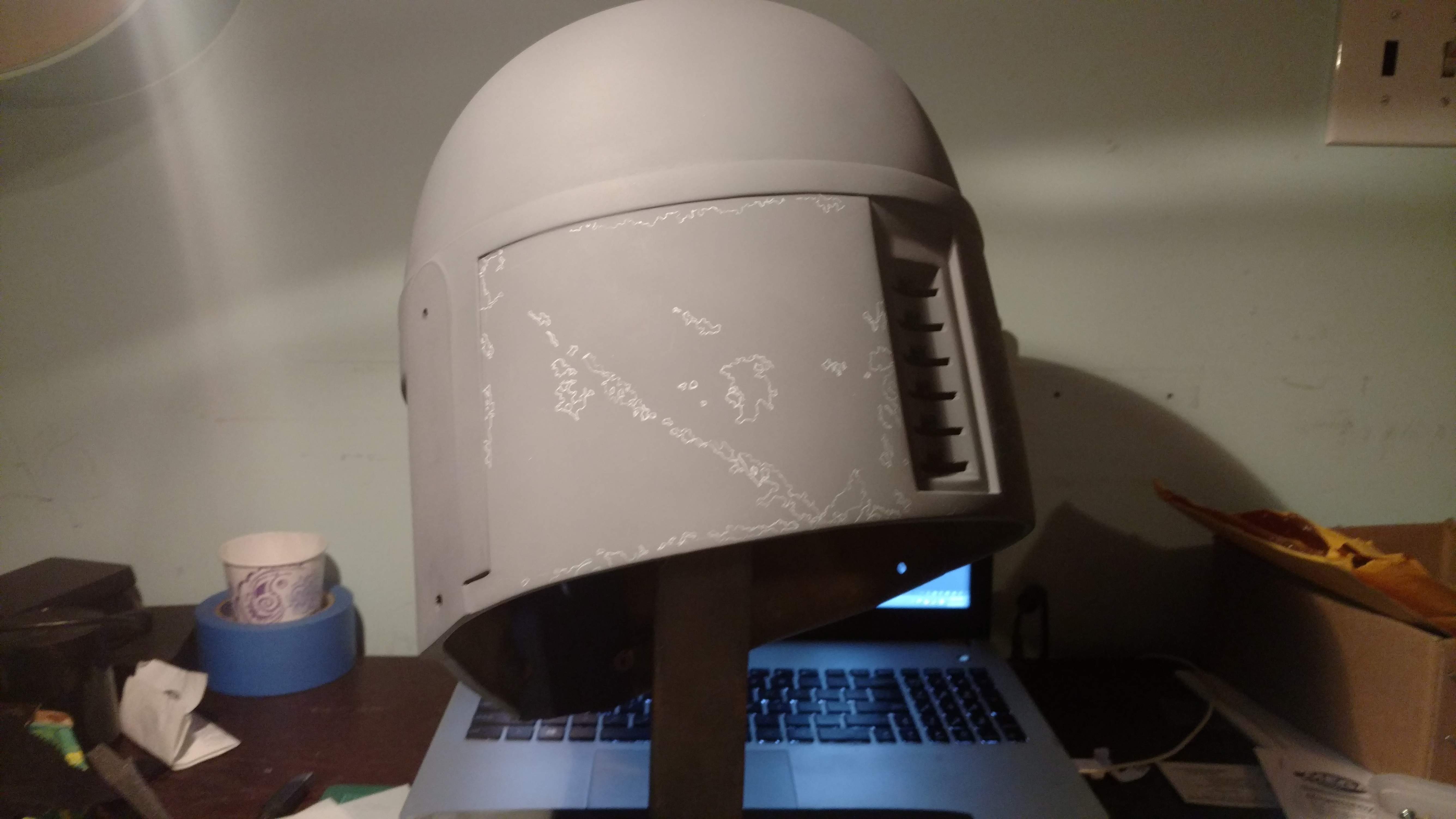

White graphite transfer paper to get the gray sections. I left some gray areas to fill around later with the topical silver and light gray.

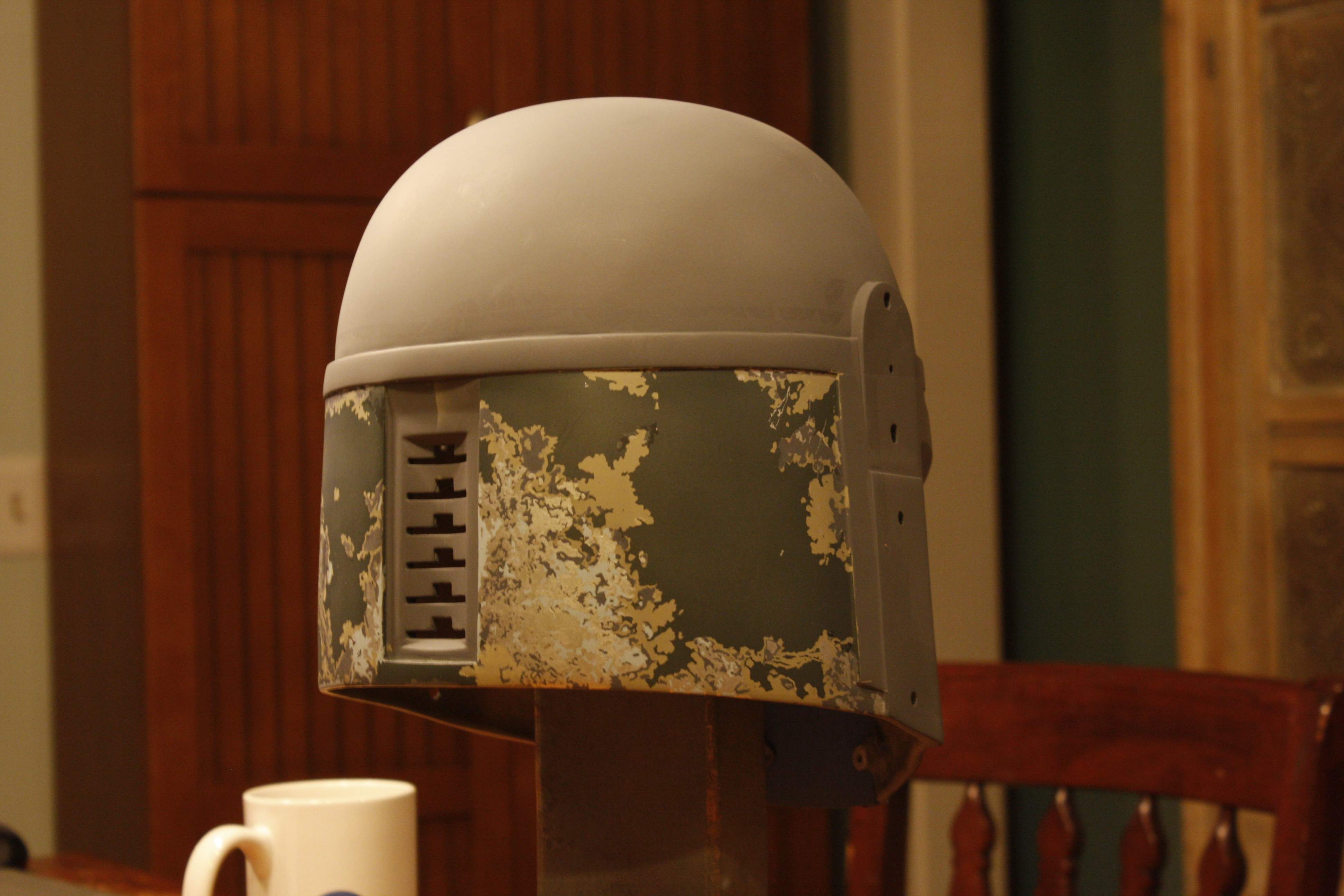

Finally I apply masking fluid and airbrush Testors Model Master Concrete Flat.
Thank you sir!

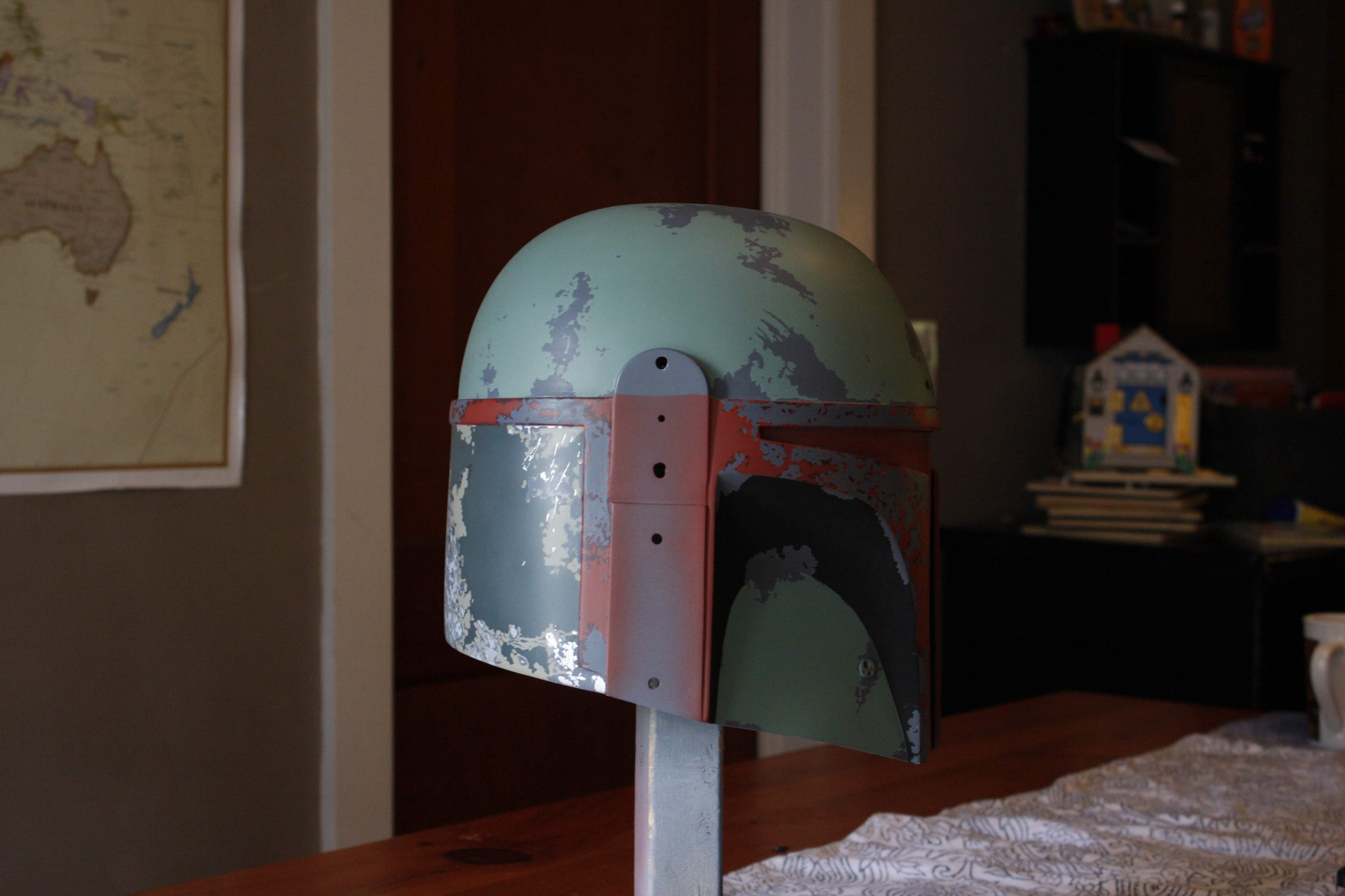

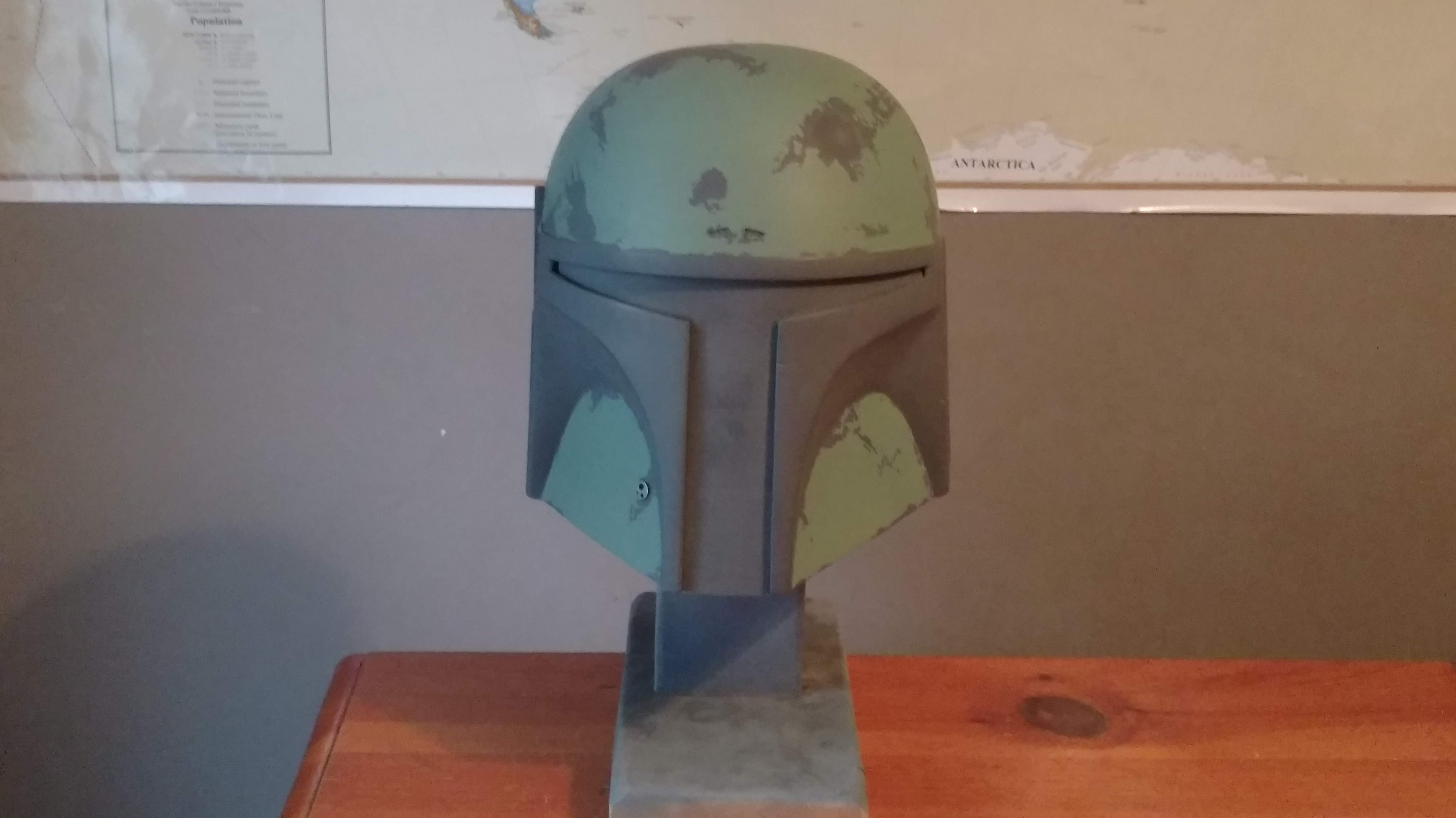

Here is me giving RLM73 a try. It's the Testors Model Master iteration of the color, it looks pretty legit to me. So much grittier than the bright-blue green color I'm used to. Kinda badass.

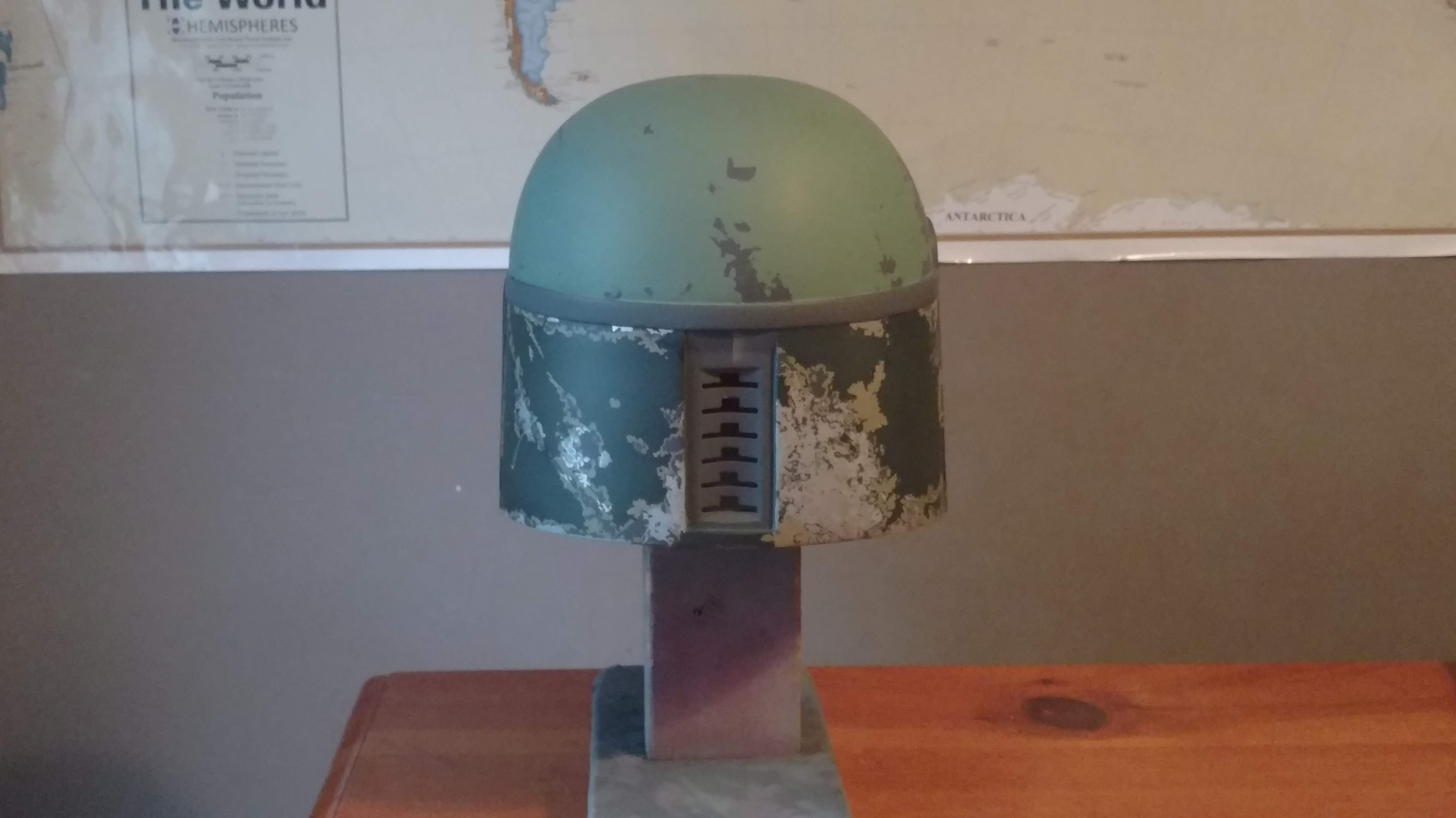

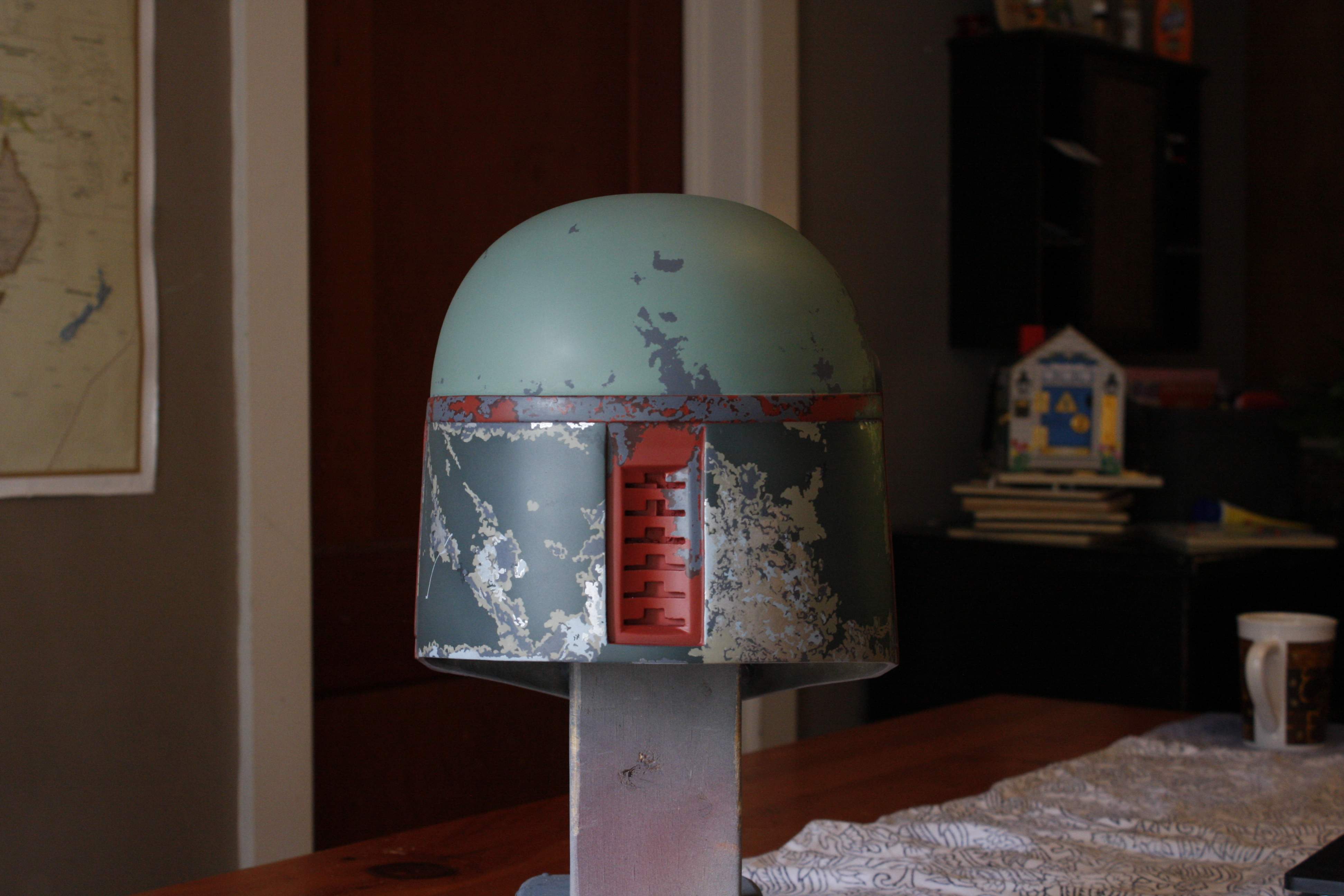

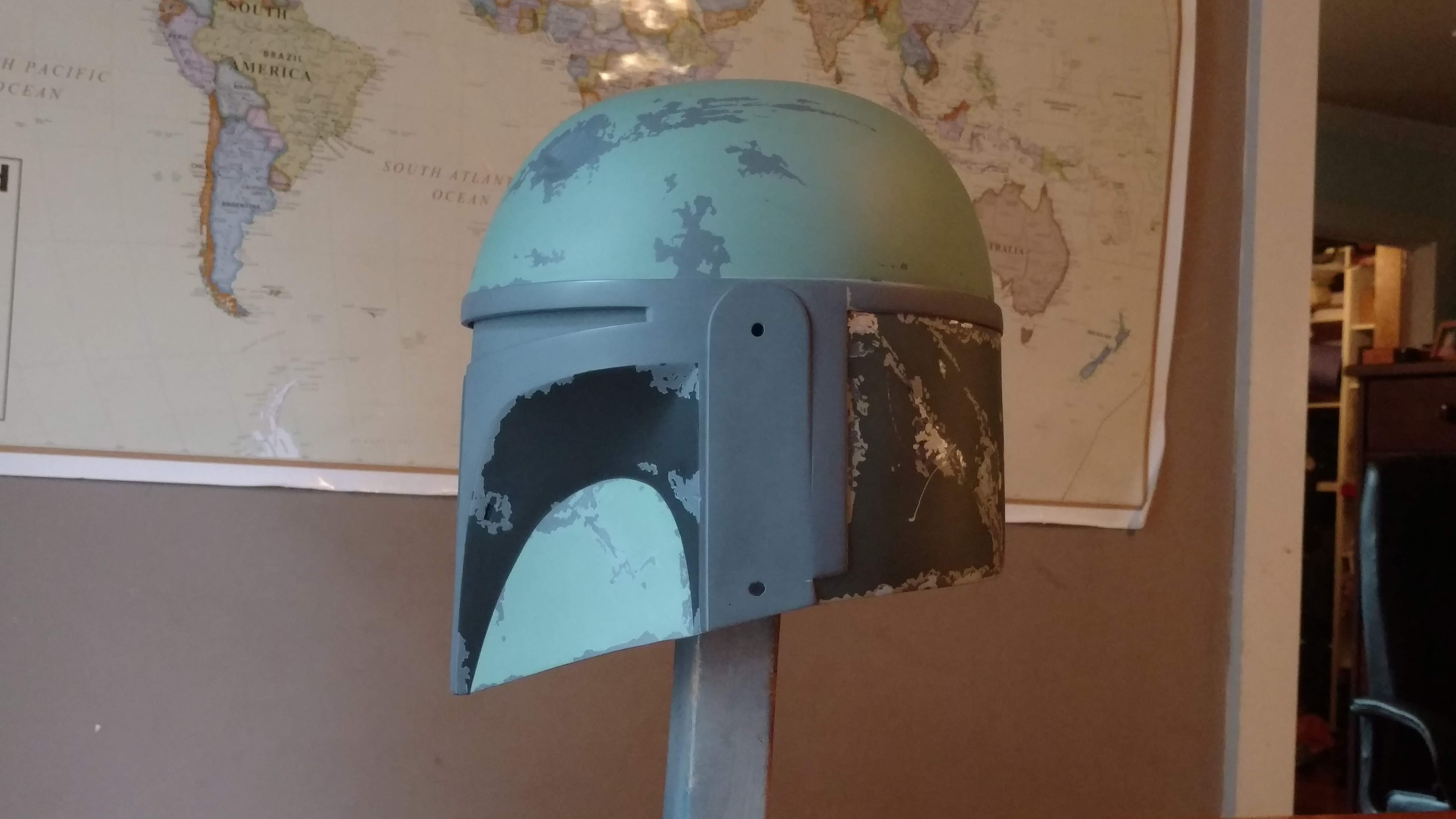

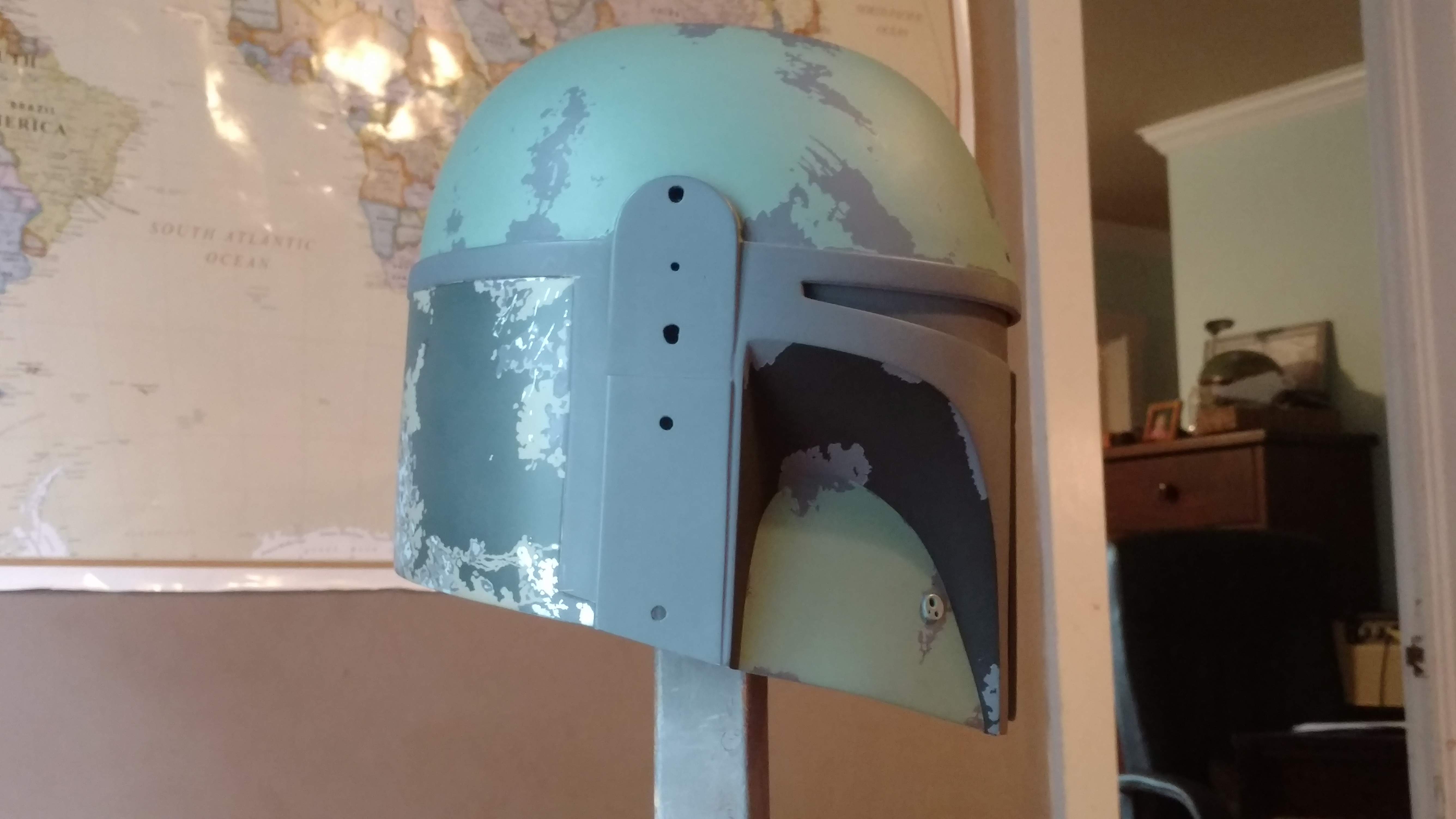

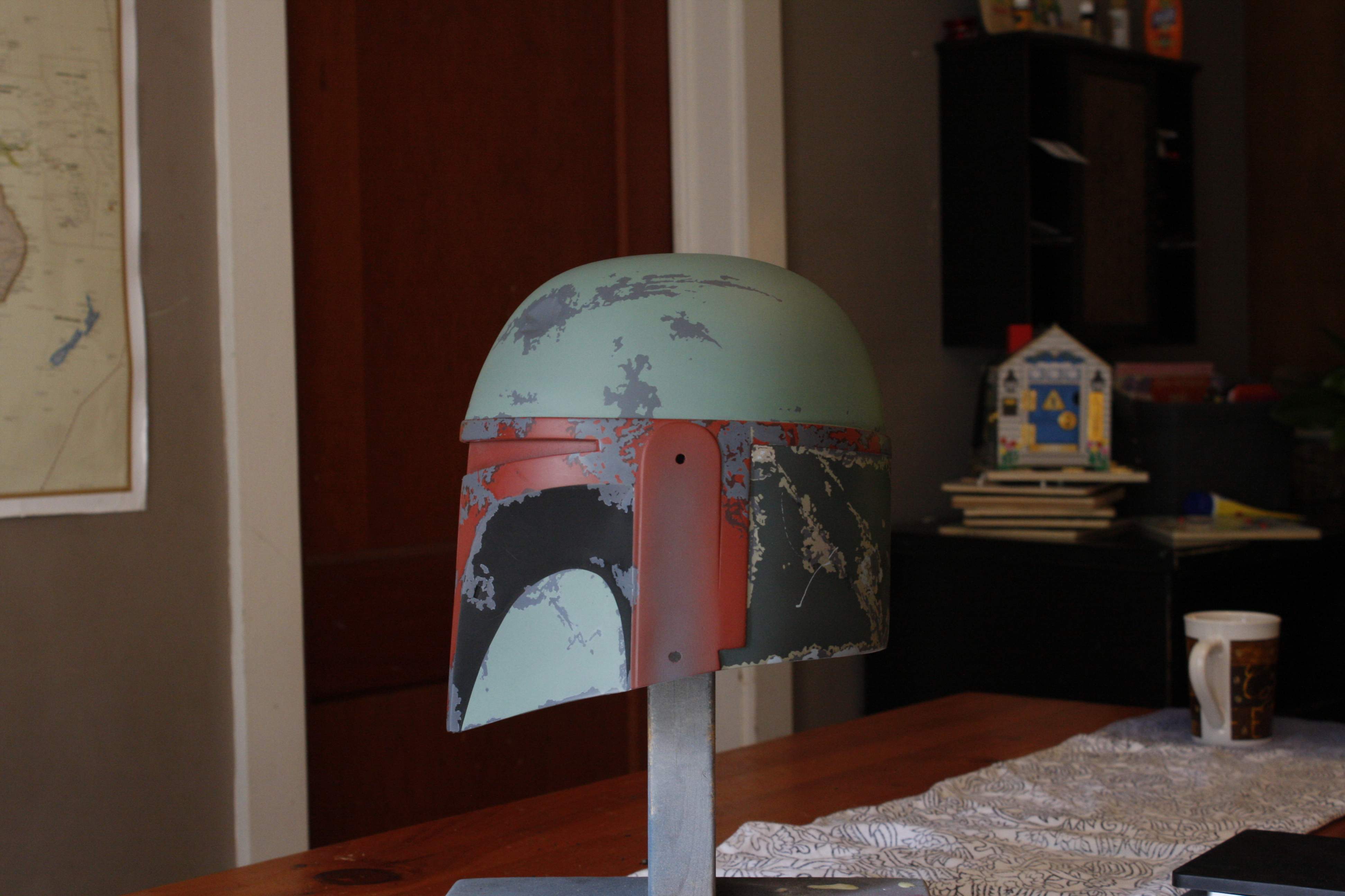

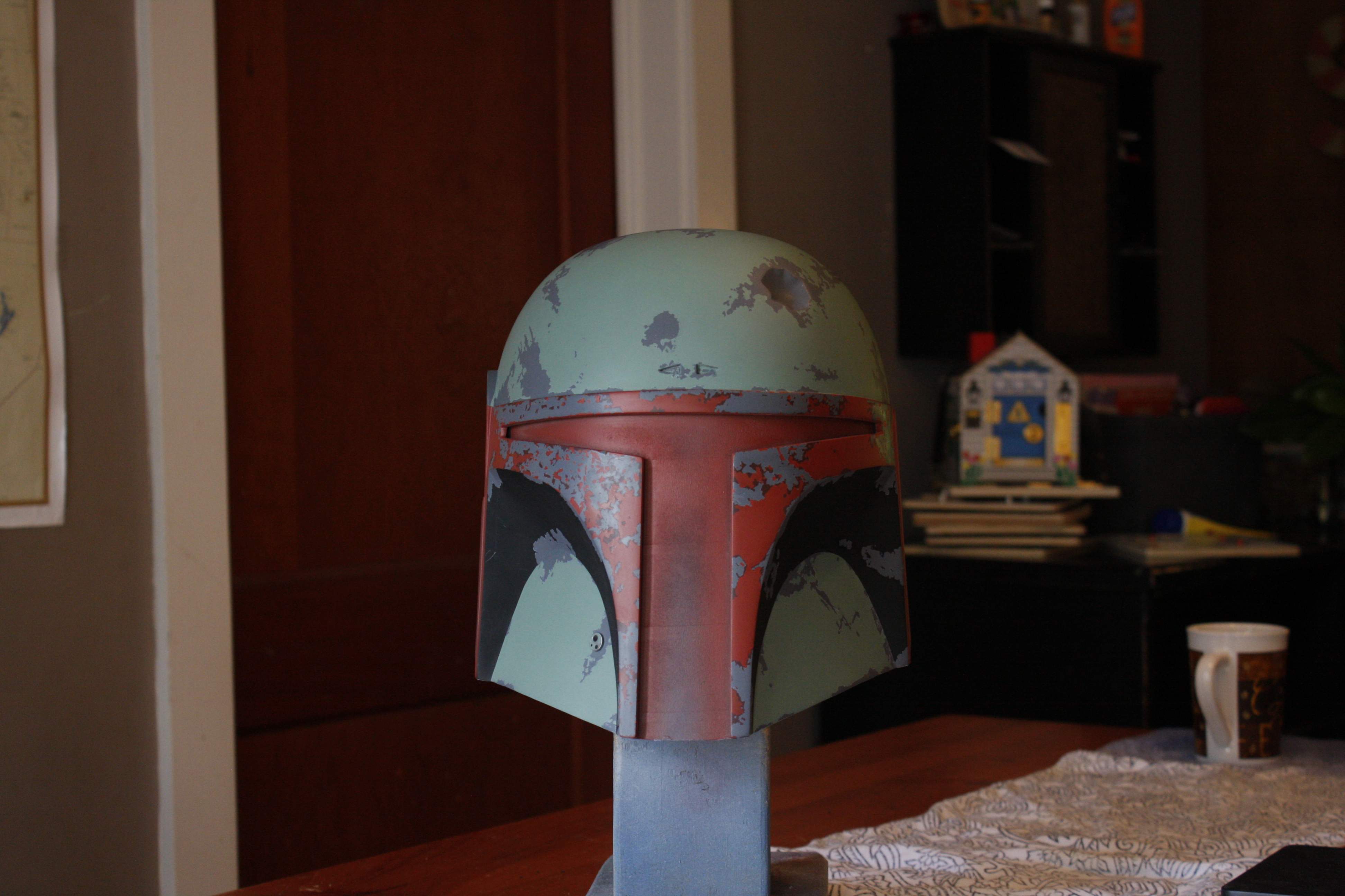

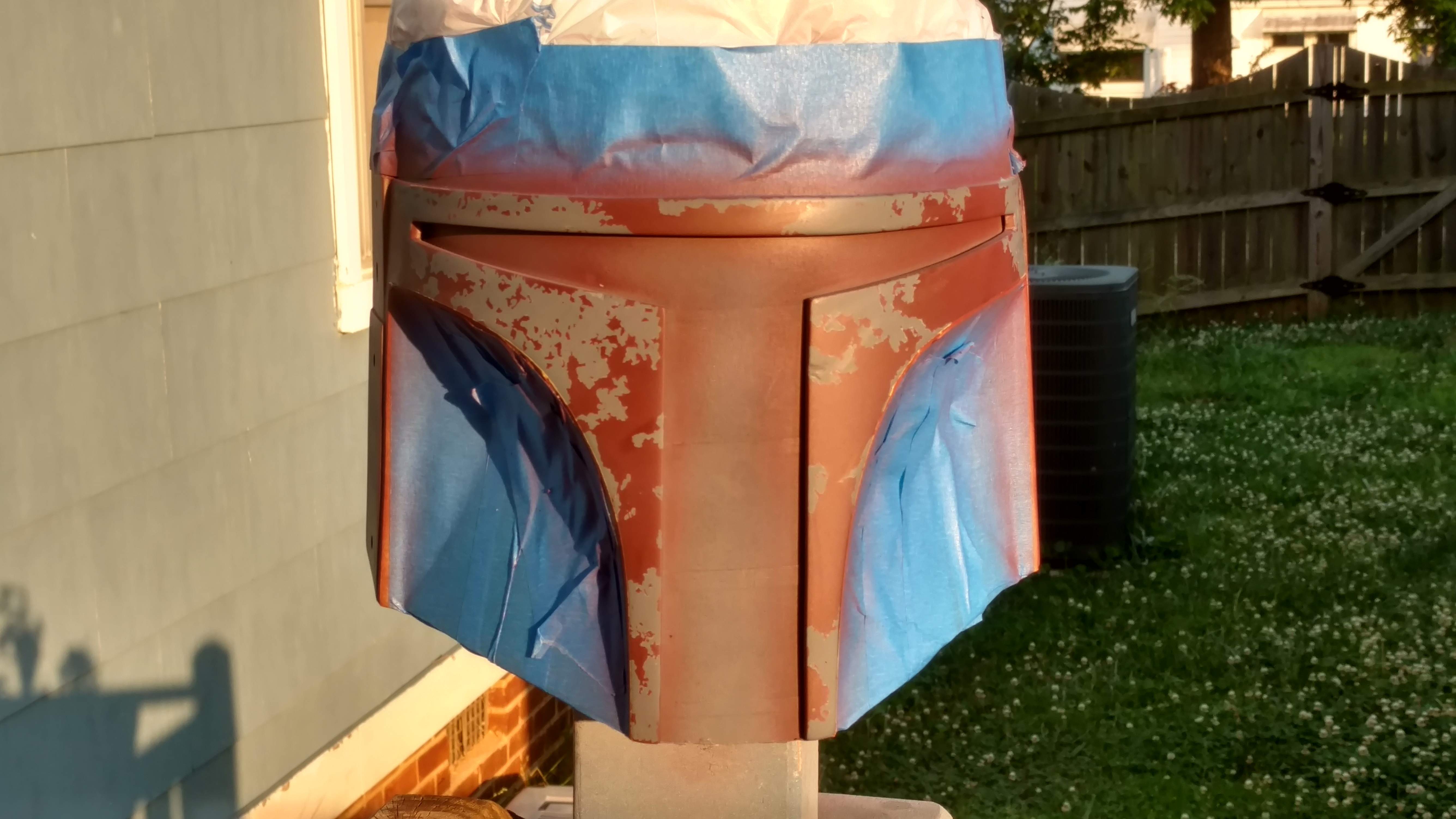

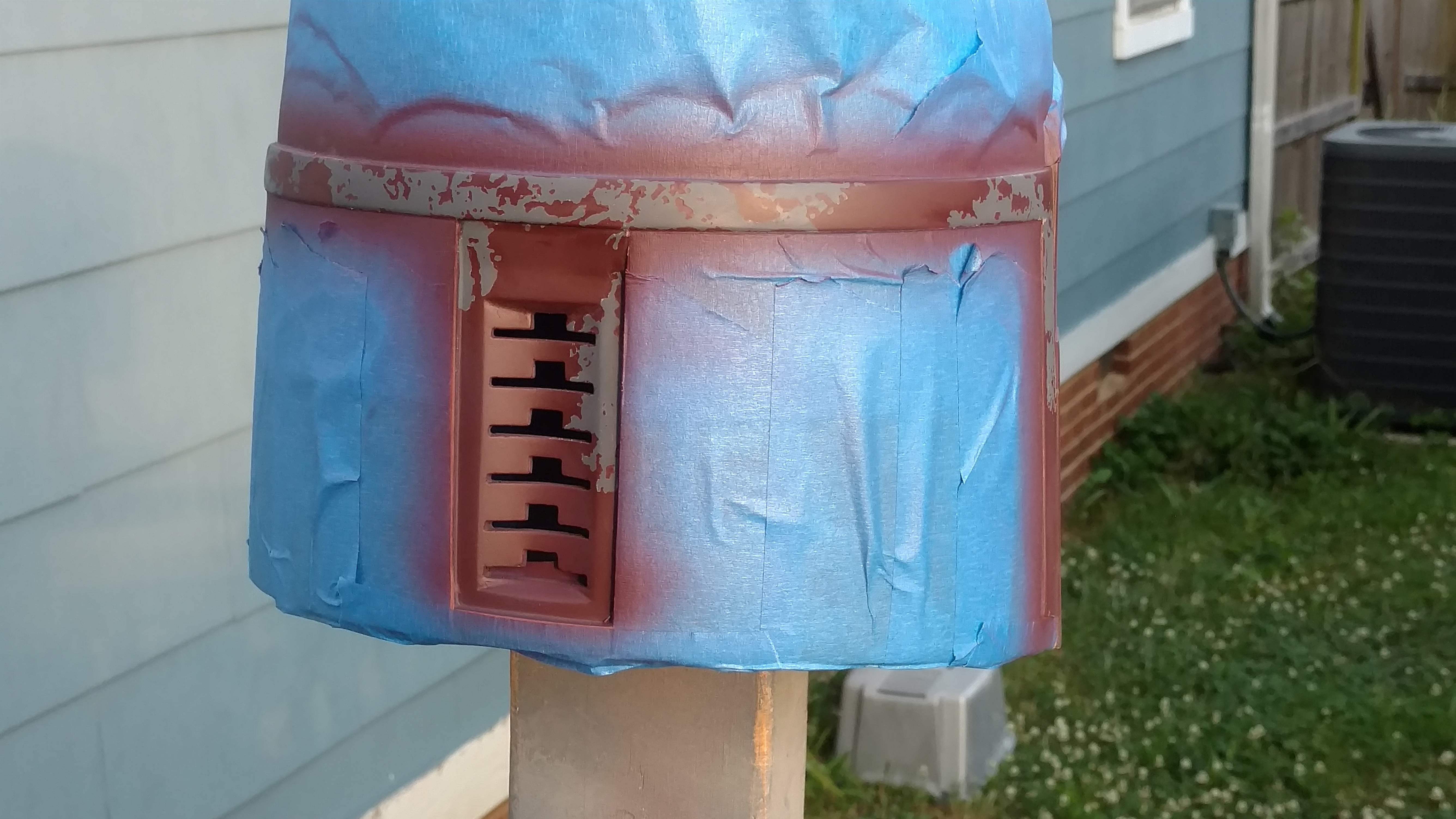

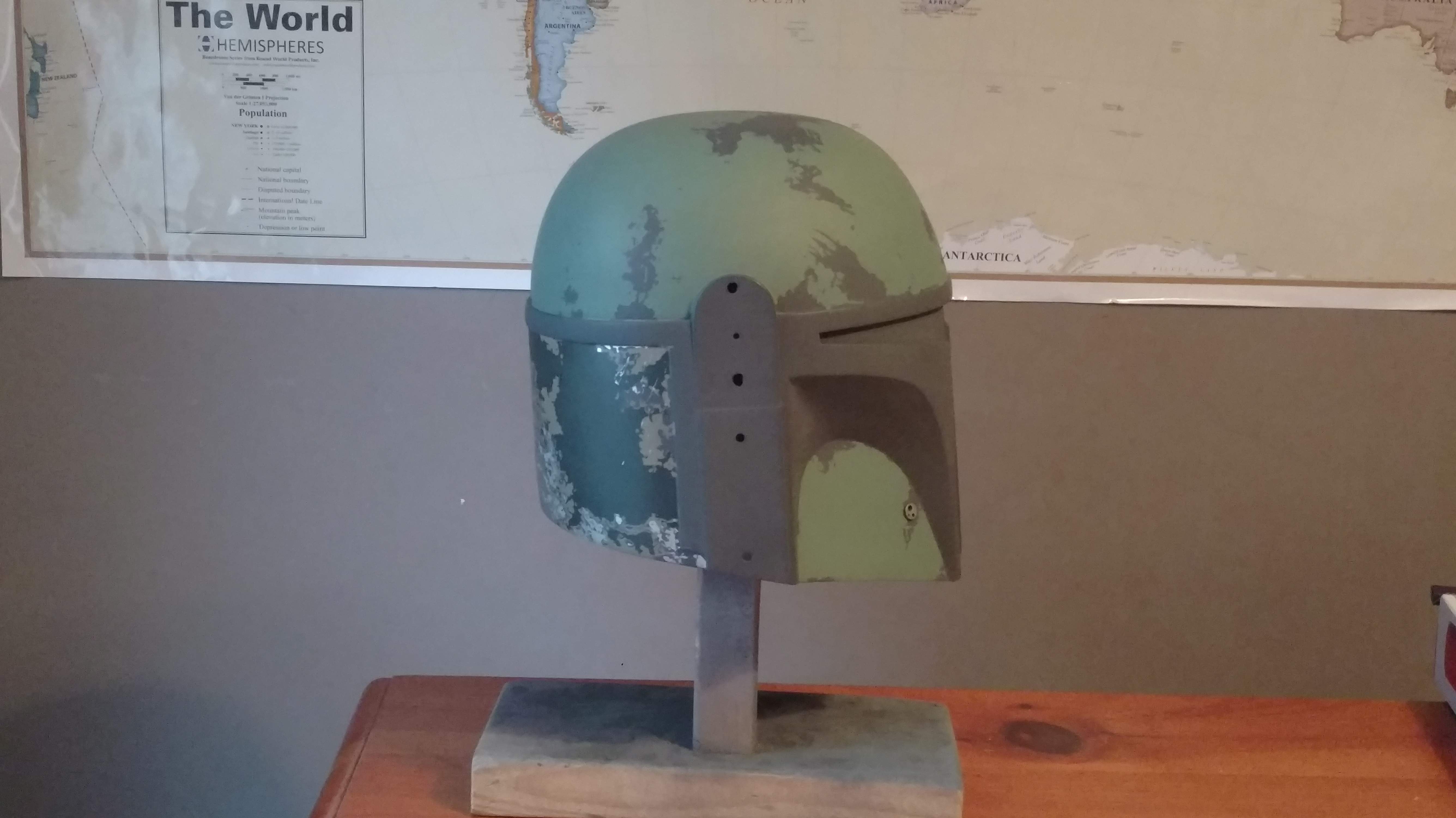

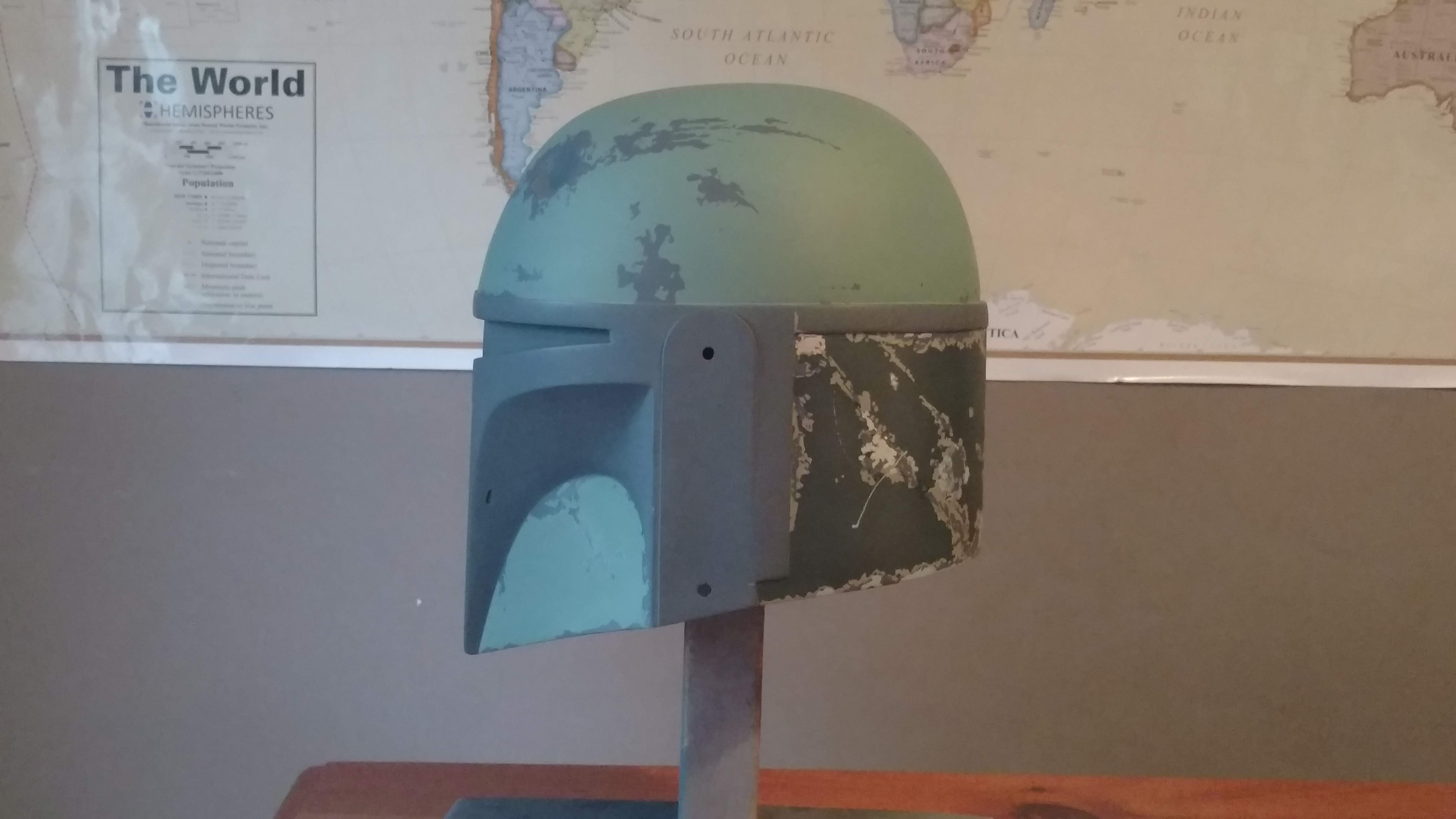

Progress...I used Model Masters Panzer Olive Grun and Tamiya Flat white with a ratio of about 4:3 to give me a minty fresh dome and cheeks. The POG has a nice mix of blue and green, but straight from the bottle was too dark for the look I'm going for with this bucket. I'm thinking a 2:1 mix would probably have worked just as well.
IMG_20160508_171025404.jpgIMG_20160508_200402287.jpgIMG_20160508_200417622.jpgIMG_20160508_200440948.jpgIMG_20160508_200534192.jpg
...and Tamiya Flat Black for the upper cheeks.

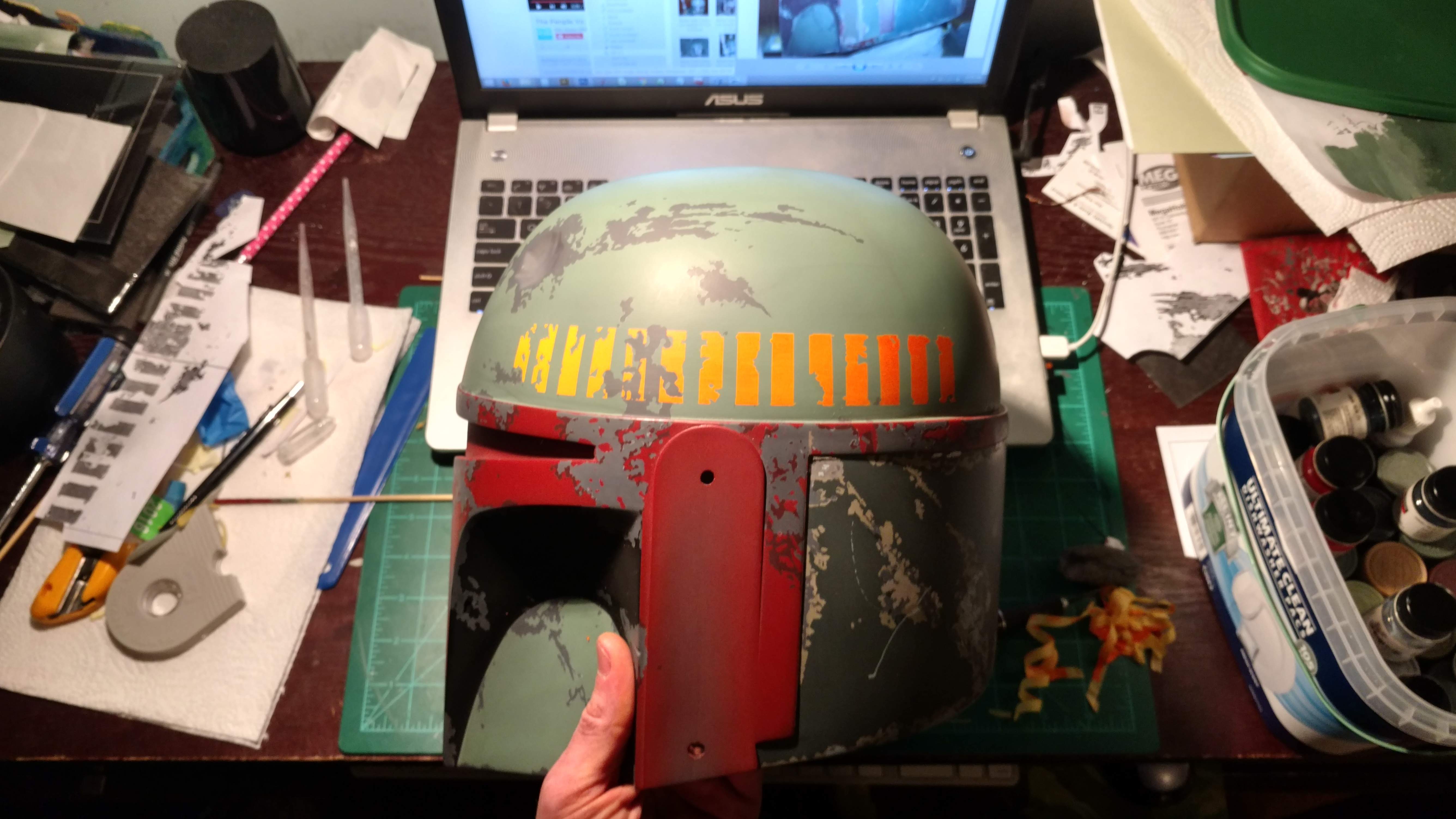

Maroon layer consists of Model Master Caboose Red with a few drops of MM Dark Blue. I really don't make a big fuss over this...it's basically some type of red with a little of a deepish blue.
Finally Model Master Insignia Red.
