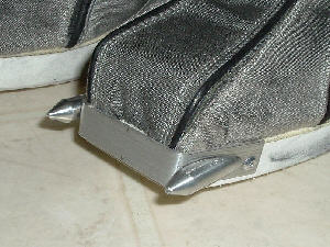

I made mine with a drill press, I cut a piece of aluminum rod and put it in the press. Then while its running I used a large flat file to grind it. Use some wd-40 or equivelent to keep the file from clogging up with aluminum. When you get the point you want stop:) I think I also use some sandpaper or something to get any rogh spots off to.
Then when you are done with the tip, what I did was cut the other end on an angle to mount to my toe plate. I then pop riveted them on from the inside so you wouldn't see how they are attached. They feel like they are welded on.
Hope that helps some

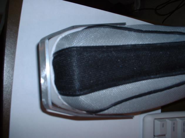

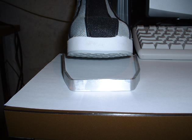

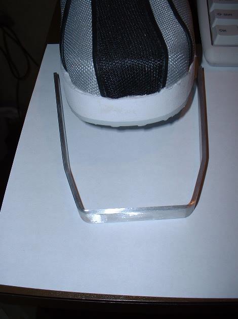

how did you do the plate ? Did you just cut it and bend as needed ? Then screw it in right ? Can you post more pics of your boots ?

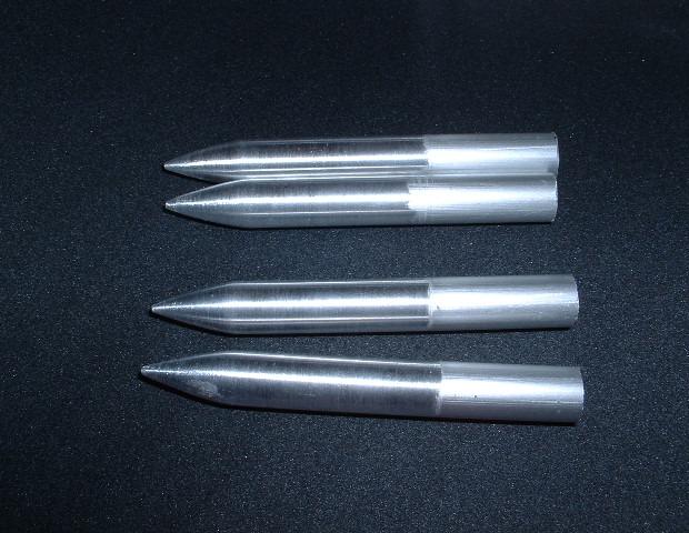

1st I cut a piece of 3/8" aluminum rod off in 3" increments to give you enough room to chuck it tight in the drill.
2nd I mark a line on the piece about 1/2" for the bottom on each piece so you know where to stop "maching" the tip off.
I start with a reall rough crosscut file in the beginning to get the most material off first.
Next, I move to a finer cutting file to smooth it up.
Lastly, I use a piece of steel wool to really clean up the edge.
I used JB Weld to attach my tips to the toe plate. The pop rivet idea sounds good too. If you have the tools, I would suggest taping a hole in the tips for a bolt and attaching them that way.

O K progress report . I have the darts ( how do I cut them on an angle ? ) I have the bracket/bar . How to attach the darts? I could drill a hole down the center of the dart and thread/tap it . I have small machine screws and LocTite to secure them . Problem ...screw head wont sit flush .... unless ( just thinking out loud ) i grind off the offending screw head at the back to make it flush . What do you guys think ? Oh ... and how to drill the hole through the bracket/bar ? It also has to be on an angle . What is the best way to attach this bracket once it is done ? Oh just in case you're wondering the bar isnt finished and it needs to be cut off at the sides .HELP !!!
