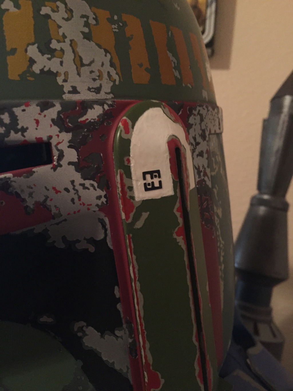

Greetings All. Currently I'm still awaiting the armor to arrive (Stuck in NY) ((again!!)), so I tried to move on with the bucket some more.
I am slowly repairing the back panel paint job, but it is still not to my liking. May have to call in one of the pros after all!
I did finally manage to get the decals on the ear pieces. The little dots on the left ear were a pain, but got them on! (Just hope they stay there!!)

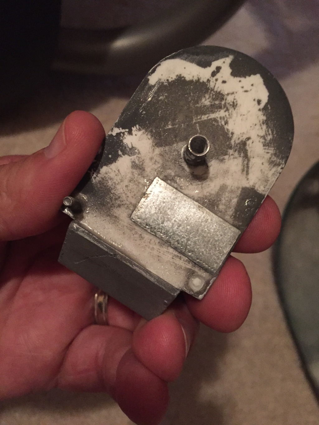

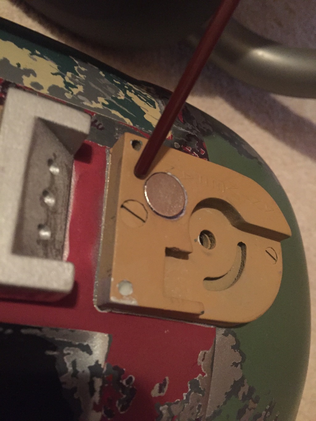

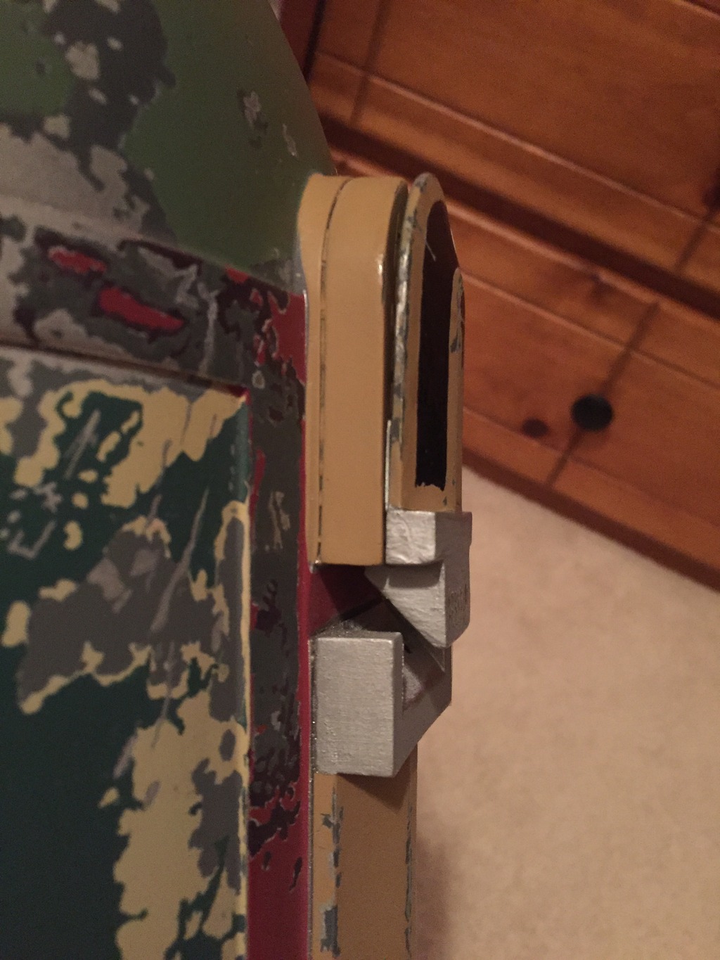

back to my old tricks with magnets once again. I wanted to attach the right ear cap, but nothing permanent. So...magnets! :)
i started by tracing the area where the magnet would fit the best, then got out my handy, dandy dremel and (VERY) carefully drilled out the area to where it eventually fit nice & snug. After that it was just a matter of getting it flush and then used some CA glue and bam.
The next bit was to snip another bit of the same metal I used for the rangefinder top (a few pages ago) and got it glued on the back of the ear cap.
test fit...aaaaaaaand.....works great!! :) Just a minor, teeny, tiny bit of a gap, but otherwise like a glove! So I can now remove the ear cap, adjust the rangefinder, etc without worrying!
Here are a few pics:
