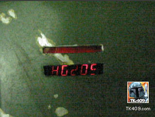

Here's a close up of the display from the Magic of Myth tour suit:
Once again TDH comes through. :-)
Thanks guys! :D
ONE MORE QUESTION, I have the green tint, but will red LED's show through as red or will they be green?
Don't red and green make blue? Dunno. I'd check first before you mount the tint. You want it dark enough so you can't see the display when it's turned off, but light enough that you can actually see it when it's turned on. I'm using smoked tint on mine.
I just shined my red laser pointer through my dark green tinted face shield. I expected it to look white, but guess what, it showed through as red. Maybe that's because of the high-intensity of the laser beam, don't know for sure. But I think you're in the clear :)
I used an extra peice of the dark green visor I had from my helmet and it looks perfect. Just ignore the fact the holes aren't big enough.
I used the the green visor plastic as well and the red lights shine thru great without any green tint at all.
This is an old display and I've since reprinted the letters to be spaced wider...
