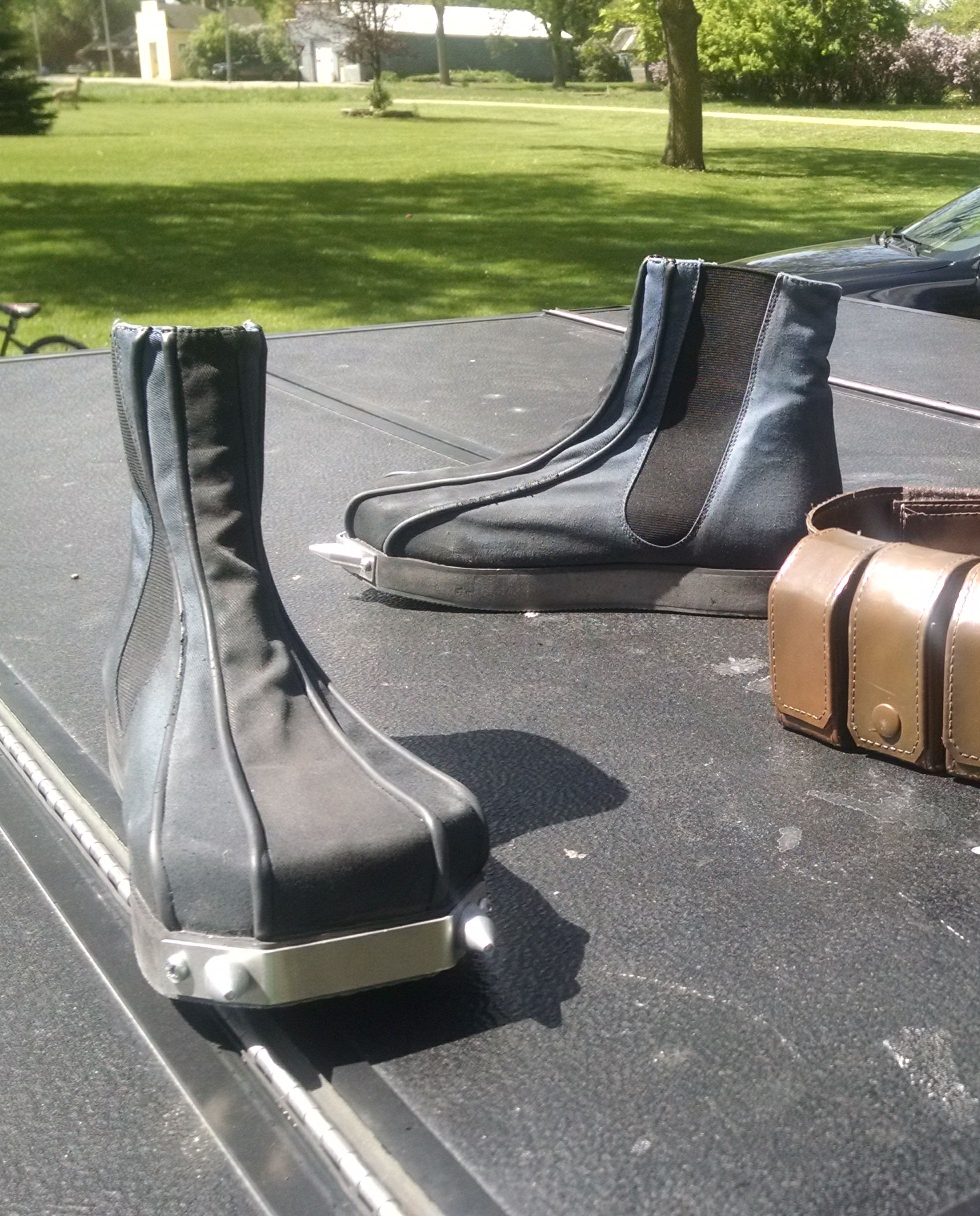

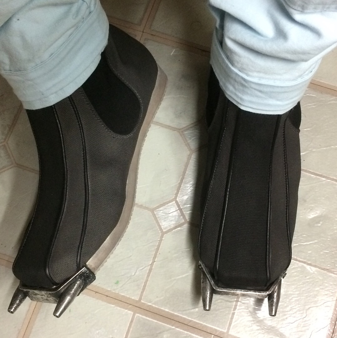

These started out as Mow white boots. I dyed them but they were too blue, so used some dye remover to fade them out, then airbrushed blacks, grays, browns. Wasn't very difficult. They didn't turn out perfectly, but not to bad...

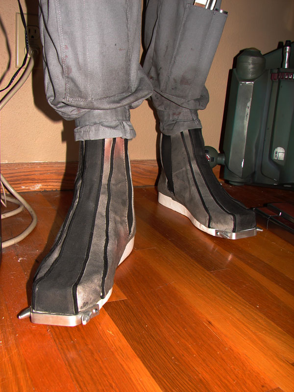

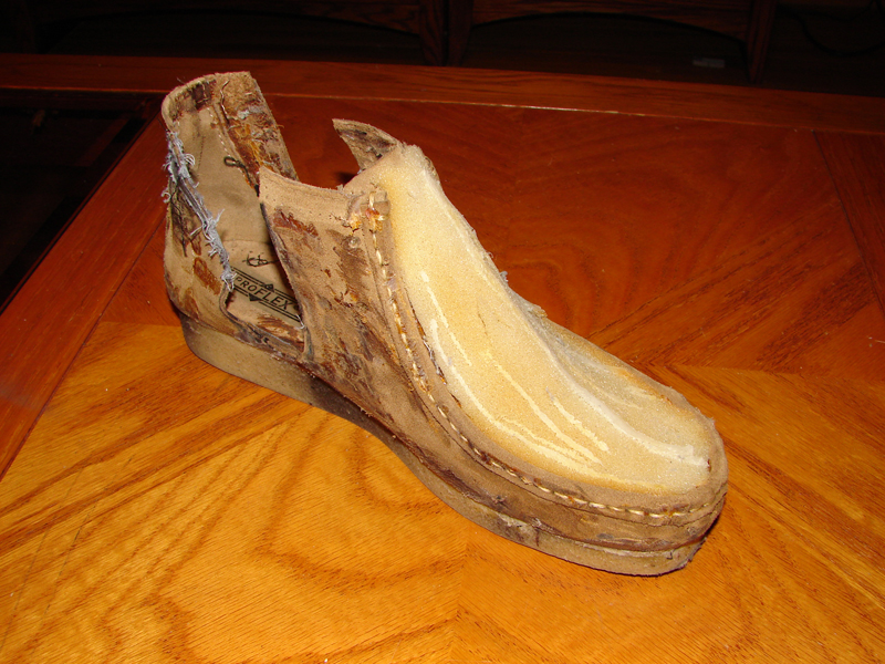

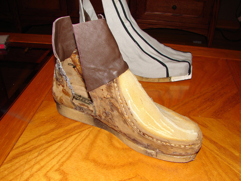

ShortFuse. I did a post on the build, but it looks like it's gone. I angled the toes w/ craft foam. Made the boots taller w/ scrap leather. I then cut and glued two pieces of canvas to each boot. I folded the dark middle strip and hemmed black piping to it, then glued it over the front edges of the two strips. I then folded and sewed piping to the front side pieces and glued those on. Then I glued on the section that covers the heel and back. I found wide elastic on ebay, glue tacked it in and had a shoe repair place sew it in. They also added the rear straps. White vinyl glued around the sides of the soles. Used a lot of contact cement. did the toe spikes on lathe. I don't have any more build photos.
ShortFuse. I did a post on the build, but it looks like it's gone. I angled the toes w/ craft foam. Made the boots taller w/ scrap leather. I then cut and glued two pieces of canvas to each boot. I folded and hemmed black piping the dark middle strip, then glued it over the front edges of the two strips. I then folded sewed piping to the front side pieces and glues those on. Then I glued on the section that covers the heel and back. I found wide elastic on ebay, glue tacked it in and hade a shoe repair place sew it in. They also added the rear straps. White vinyl glued around the sides of the soles. Used a lot of contact cement. did the toe spikes on lathe. I don't have any more build photos.

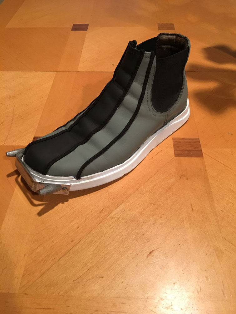

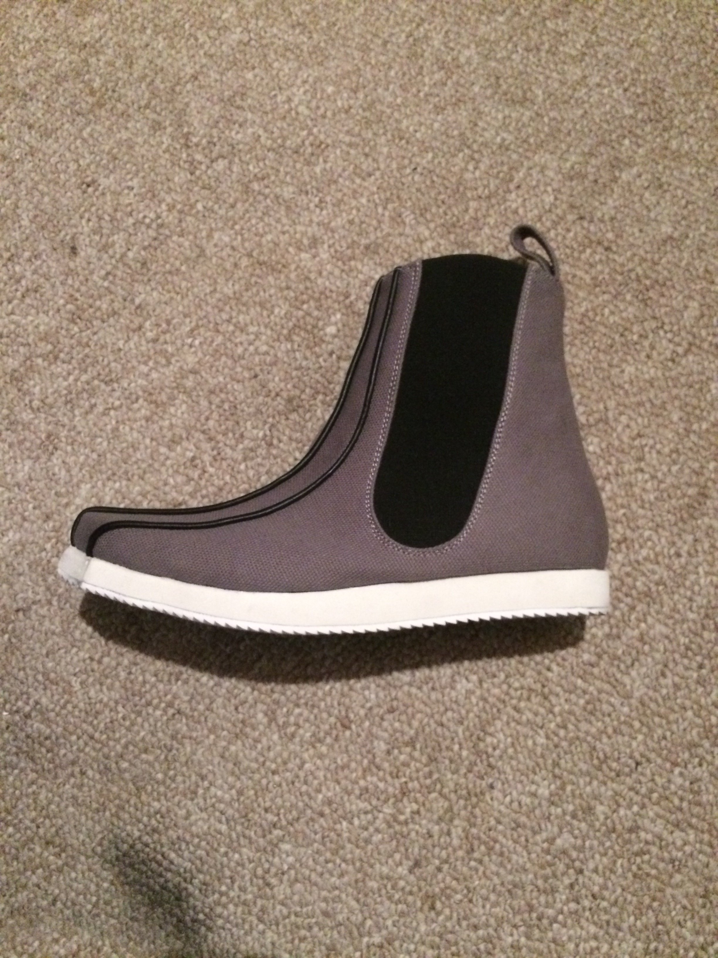

Well, you did an awesome job on them. I scratch built a pair as well but wasn’t able to pull off the squared off toe. Here is a pic prior to weathering.
