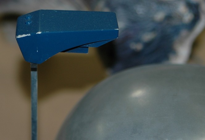

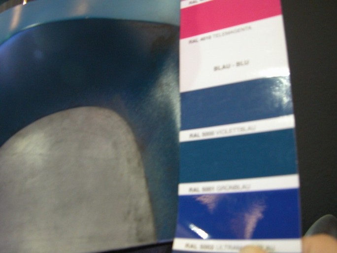

I have many images of the original Jango Fett, ( arena version ) measured, molds, ecc…from the “Star Wars : the show” in Milan. I have been able to see and TOUCH the Jango helmet, and the rest of the armor. The density of the embossed paint is very very small…
..... one example of pictures from the original Jango Helmet.
In this case the quality of the pictures is not perfect ( ... litte light, sorry ) but you can note the opacity and maybe the small embossed on the dark blue.
To me it looks liket the blue swatch in the middle. I've always thought it leaned more towards the blue-green (aqua) instead of the blue-purple (royal).
Thanks goldenrod.... as I said to FP, I'll try to help you !
This pictures is not perfect and the colors are very "green"... :(
by the real vision the first color is very similar on the Jango Helmet, you have my insurance : this color is RAL5000 ( violet blue ). The european RAL colors are used as reference standard colors.
Also, as you can notice, the "violet blue" paint have a surface like a "orange peel"... a typical effect of the "embossed paint" ( goffrato ).
See the pictures of the Range finder : the color is more similar of the real.
