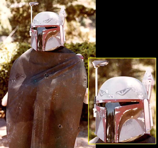

We have the same problems with the Pictures from the PP1 and ESB, colours changes with every picture...
Here´re some PP1 Pics, every one has a different light spot but I think the armour colour turns into a blue/green...
Sven
