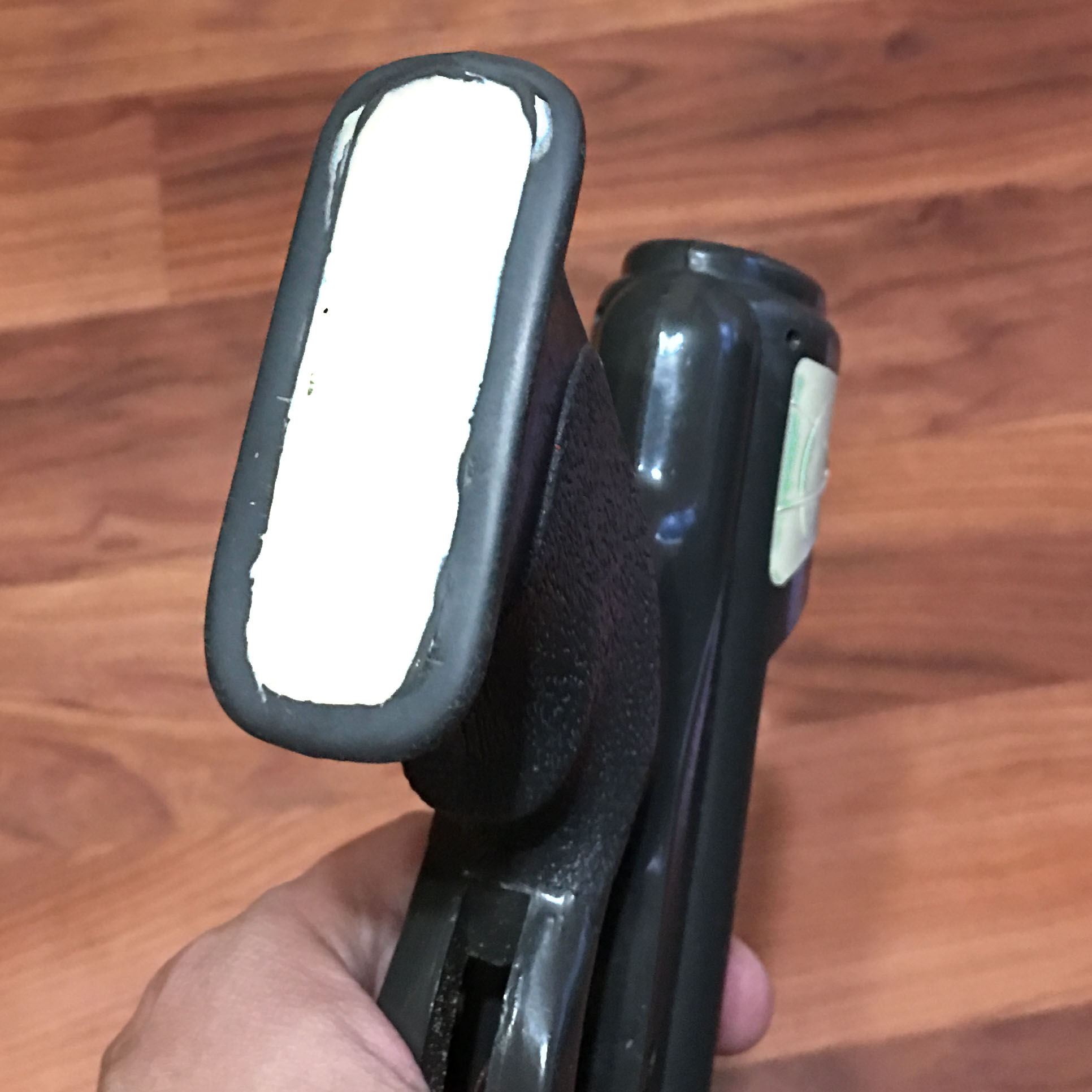

Cut a piece of .125" thick ABS to the rough shape of the hole in the bottom of the pistol grip and then epoxied it in place. Next, I used a relatively think layer (about 1/2" thick) of KwikWood to putty in the remainder of the hole to just above the surface. Sanded it down, leaving the edges, just a bit uneven and bam... we are ready for paint!
Great progress Art.
