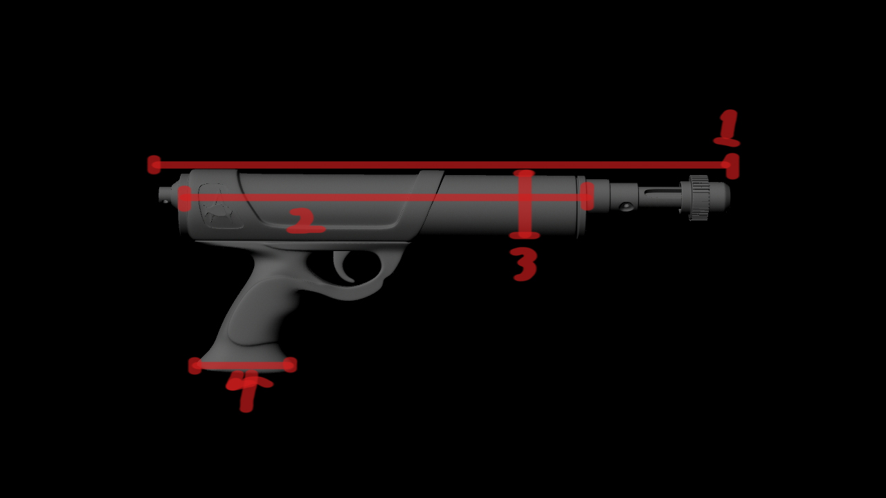

Also, here is a chart of measurements I'm trying to gather. I figure the best way is to average any and all sizes of actual pluce 40's that people have so Here are the sections I would need measured.
1.) Overall Longest measurement of the body as a whole.
2.) Length of the main cylinder.
3.) Circumference of the main cylinder.
4.) Length of the butt of the handle.
So far here are measurements so far:
1.) 393mm (Wes7)
2.) 310mm (RafalFett), 294 (actual pluce by Intwenothor)
3.) 50mm (RafalFett),
4.)N/A
1.) 393mm (Wes7)
4.)N/A
Number 1. is wrong! Wes7 said that he measured the Nemrod holster's (not the sidearm) longest part and the result was 393mm, but mostly because of this:
Arch, measurement number one could vary quite abit dependent on how loosely or tightly the tip is screwed on.
I used an image with both the holster and the sidearm to confirm intwenothor's measurement (294mm) to be correct. So my length of 310mm posted in that image is actually 294mm and the diameter is not 50mm, but 48mm. The handle base length gived me 70-72mm:
