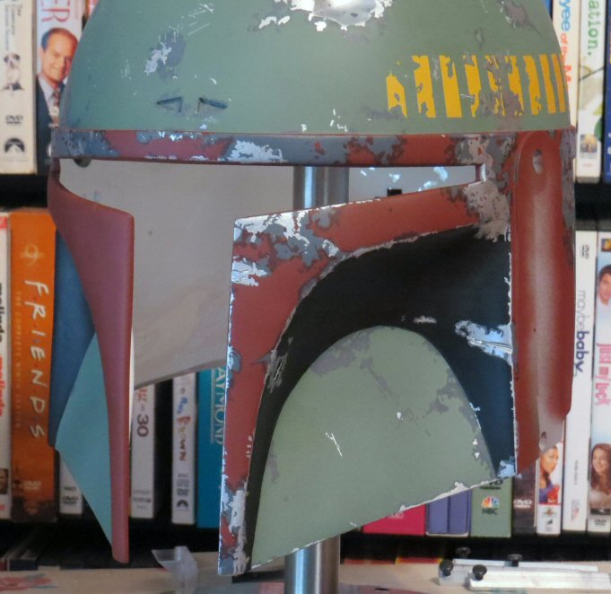

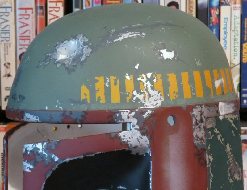

Putting my time to good use today. I got the contrasting gray on. This is an odd
detail of the ESB helmet. The color is hidden really well within the silver in
certain light, but if you change the lighting or rotate the helmet, it shows up.
The color is found scattered all over the helmet, and here are a couple of highlights.
First, the dent.
From another angle.

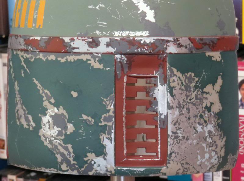

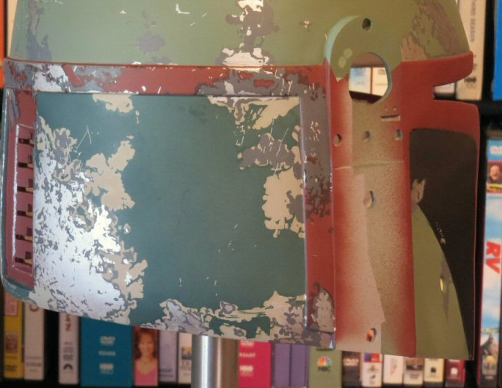

Next, the rear panels.
Again, rotated so the light hits at a different angle.
I really like this detail! It's very subtle.
