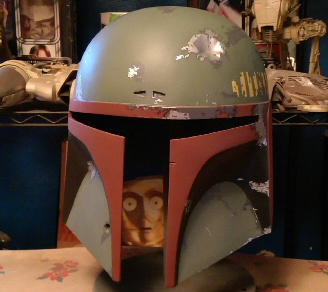

Lots of real life stuff going on this weekend so didn't have a lot of Fett time. But I finished a portion of the brow area.
I'll start working on the right section during the week. Getting psyched for the mandibles! :lol:

LOL! Yes, Threepio has decided to get in on the action. He makes another appearance in the next pics too . . .
The left mandible is finished now. :) This was done over several sessions. Here are a couple of angles.
