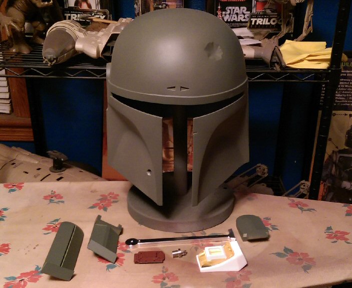

Well, I'm starting a new commission for Refugee and this will be my ESB #24! This is a Wasteland FPH2 kit. It's a great kit, and Refugee has included some upgraded accessories.
In the shot below, all the trimming and prep has been done, and the primer has been applied. In addition to the included resin ears and RF, I'll be adding a Machinecraft aluminum
stalk (which is beautiful), a real (modern) Borden connector, and a real MQ-1 circuit board. There's also a wired RF light kit which isn't shown. I've already cut down and base
coated the MQ-1 board.

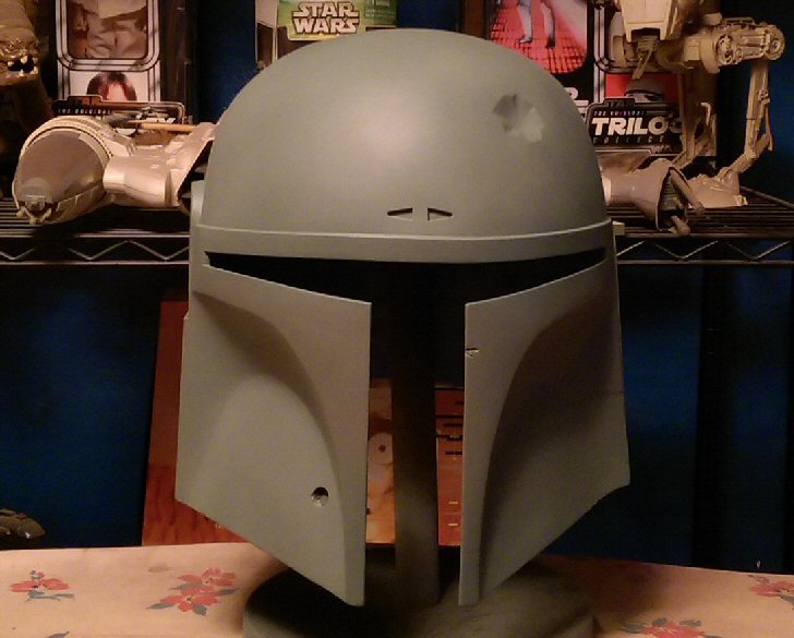

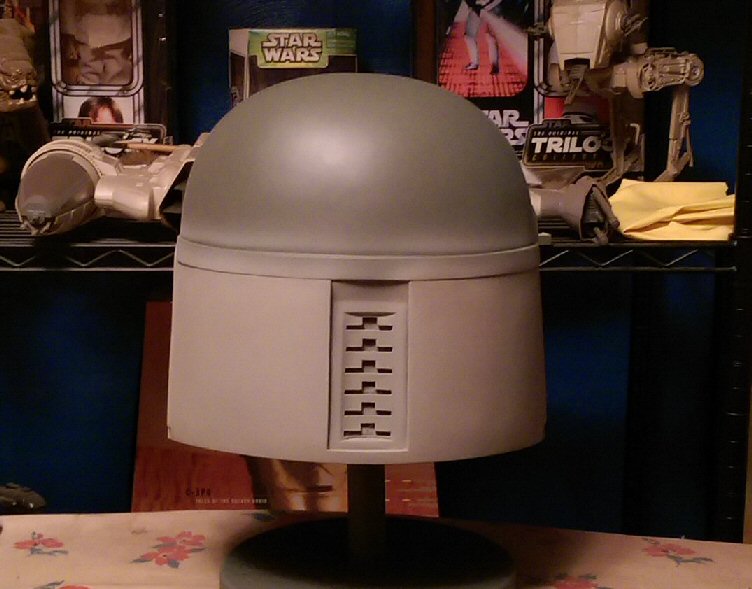

But Fett must not be ignored! So the project will go on. I got the base coat of Concrete on the rear panels just a little while ago.
So this weekend I'll be able to do the stenciling and masking and apply the dark green.

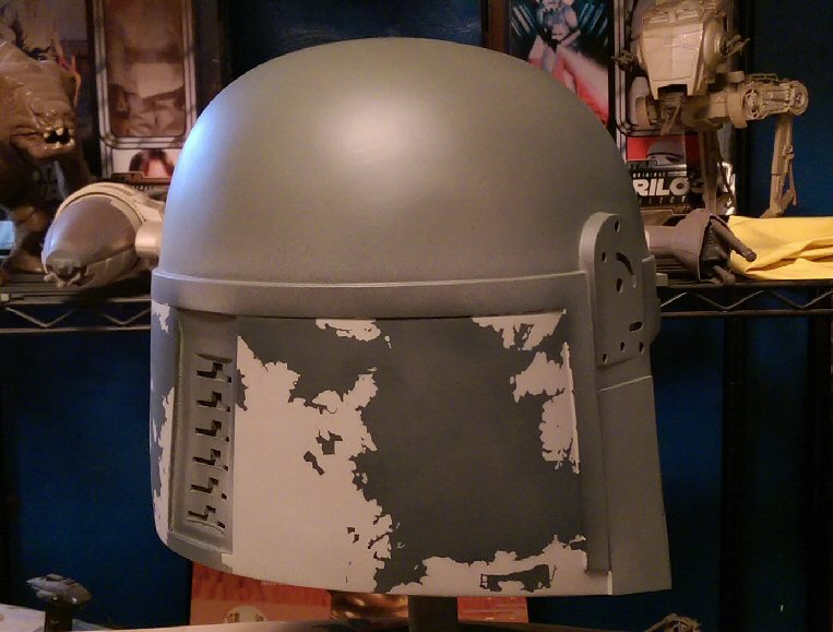

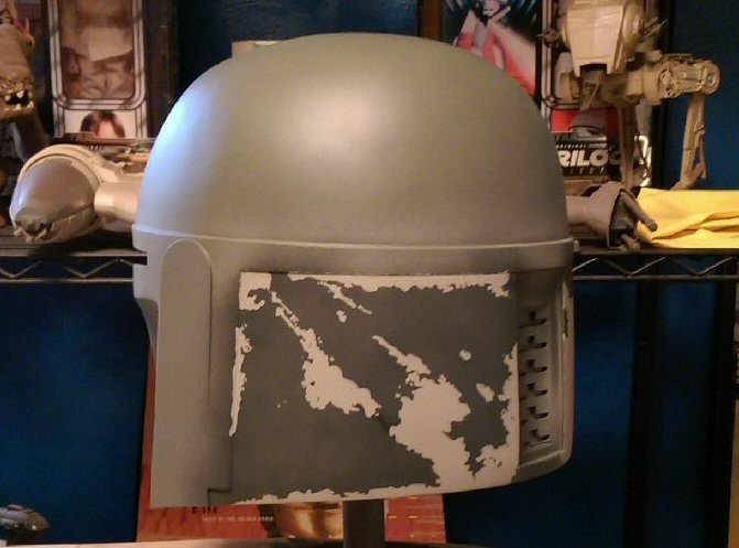

Got some good momentum going on the back panels. Everything was stenciled, masked, and airbrushed for the main color breaks.
Then I went back as I always do with a fine brush and tweaked the edges of the shapes and added some small chips, as well as some
variation in the appearance of the green. This is always subjective, but it helps to create the illusion of depth in the finished product.
Since I took these pics, I've already gotten the silver done on the left panel. Gray is coming up next.

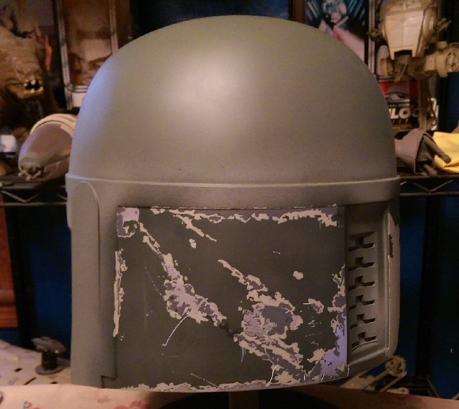

Got the left panel finished up. Using my standard palette of SP Lark Dk Gray and Bright Silver. There are also some areas where
I add physical scratches with a metal tool, and just a touch of drybrushing.

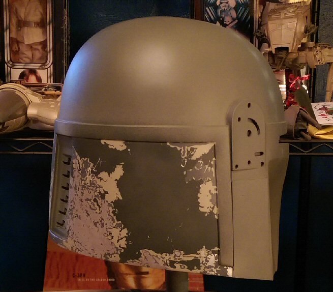

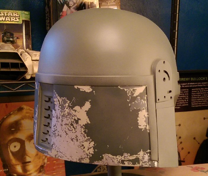

Bringing the weekend to a close with the big giant scrape! I'm giving my eyeballs a rest now, LOL.
So many chips. . . I paint on some of the larger gray chips first to use as landmarks, then I do the silver, then I make another
pass with the gray to do the remaining detail. Here's a shot at a different angle to show how the silver looks brighter in certain light.
I'll work on the remainder of the right panel during the week.

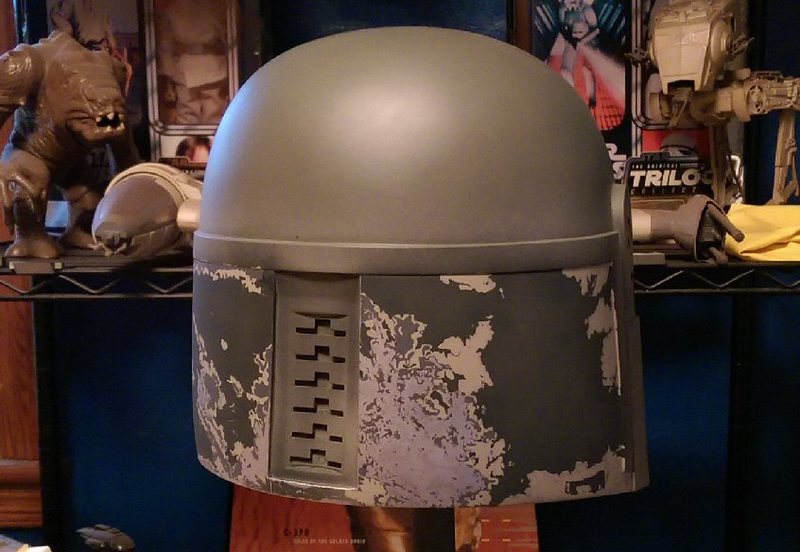

I finished the rest of the right panel. There's some decent detail in the lower right section, too. Here are a couple of shots in
slightly different lighting conditions.
Now that the panels are done I can mask them off and lay down the base green for the dome and cheeks. :)

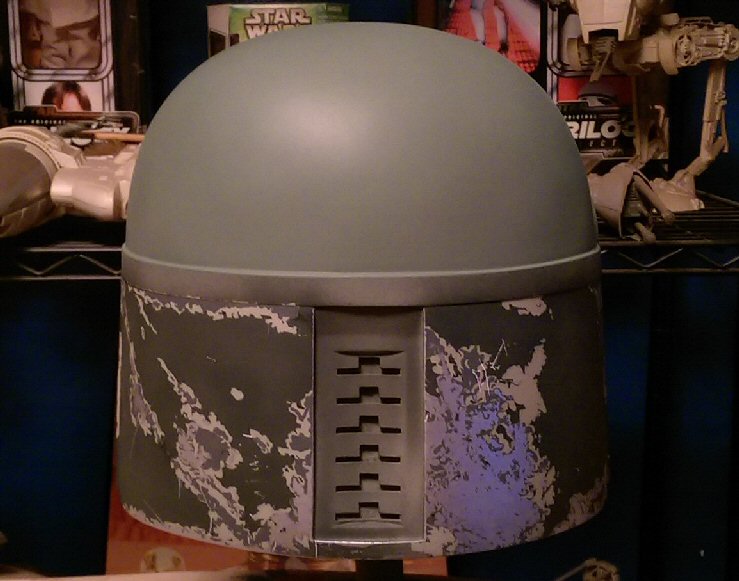

Got the dome and cheek color on. :) I sprayed the base coat and did the first weathering pass.
I really wish I still had my good camera. . . my cell phone isn't quite capturing the tone the way it looks by eye.
Now that this stage is done, I can begin the dome damage. I'll start on the back and work my way around.

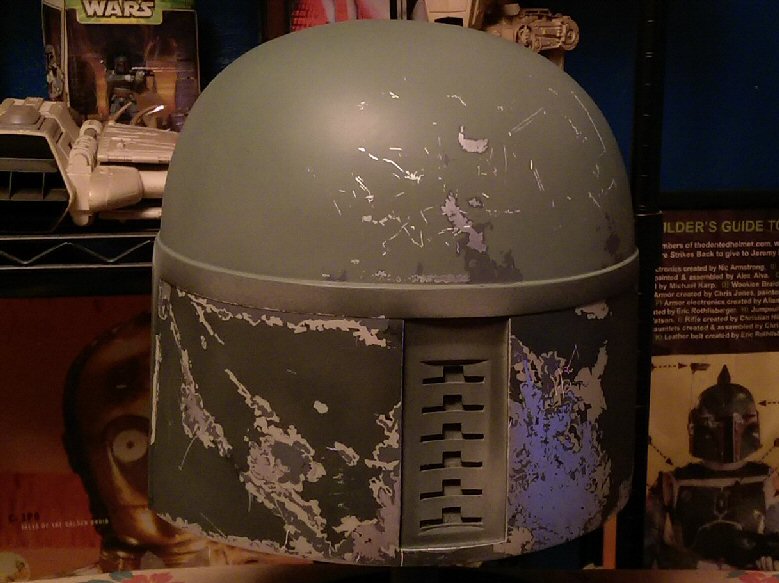

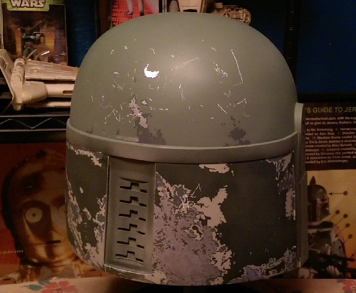

Dome is in work. :)
I got the back portion done a little while ago. Still working with my gray and silver and my scratcher upper tool.
Some of the fine details are silver, and some are physically scratched into the paint.
There are a few physical scratches elsewhere on the helmet, but the back of the dome has the most by far.
Once I get to the killstripes, there are a few more that I'll add using the stripes as landmarks.
From here I'll continue counterclockwise around the dome. The area just behind the RF ear is up next.
