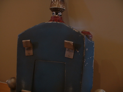

bobamatt Active Hunter Mar 26, 2008 #2 I cut a piece of sintra and drilled a hole in it big enough to stick my finger in for easy removal. Then I put a few very small strips of Velcro around the lip of the opening. Seems to work fine so far. Last edited by a moderator: Jul 24, 2017
terminal fettler Well-Known Hunter Mar 27, 2008 #3 On my MOW pack i cut a piece of 5mm plastic card slightly over size then sanded to a precise fit, bottom edge in first then tight to the top so no fixing required, just requires a penny to pop it out... Last edited by a moderator: Jul 24, 2017

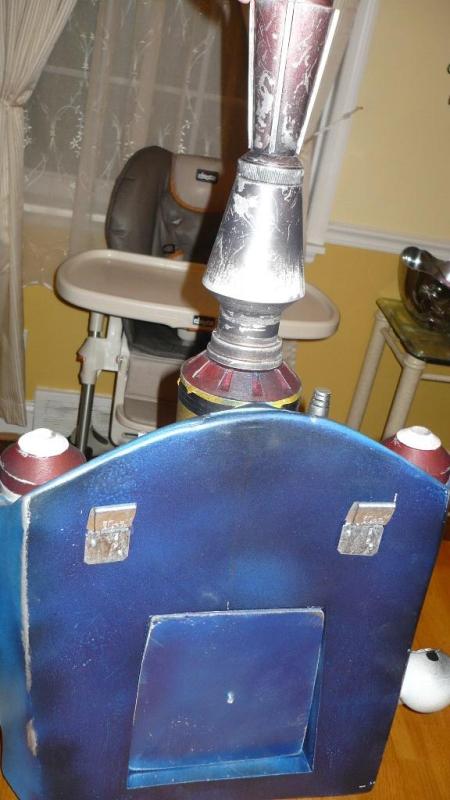

Lucksy31 Well-Known Hunter Preferred Vendor Mar 27, 2008 #4 I have a peice of sheet metal cut to size, with magnets at each corner holding it in. Last edited by a moderator: Jul 24, 2017
S Spacescopie Jr Hunter Mar 27, 2008 #5 I've just done my Geonosis Jango JP Pannel. 0.8mm mild steel, held in place by 1mm (STRONG) earth magnets, then covered in Rub N Buff. Last edited by a moderator: Jul 24, 2017
