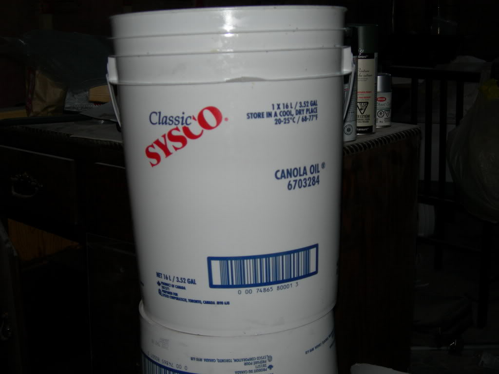

or do like i did go to a local restaurant and ask then for any empty buckets like this:
and that what i used for alot of my project no cost cept the fiberglass and hot glue.
