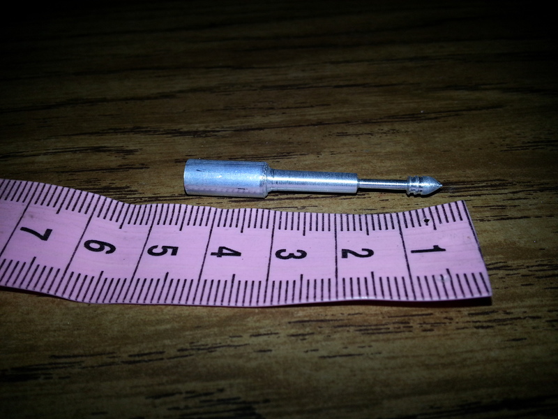

I put in the wooden darts today when I put the gauntlets together and I thought "Man I like them" but the other day I picked up some aluminum rod.I made a video detailing the wooden darts, but I decided to try my hand at an aluminum dart. I will be attempting to turn quite a few of these aluminum darts out in the future, but I made one in my "home made" lathe AKA Cordless Drill in a vise. I think it turned out well and I figured people might want to know how I did it. Since this was a prototype I did not document it with video/timelapse like I normally do. This can all be done with tools that most people have readily available

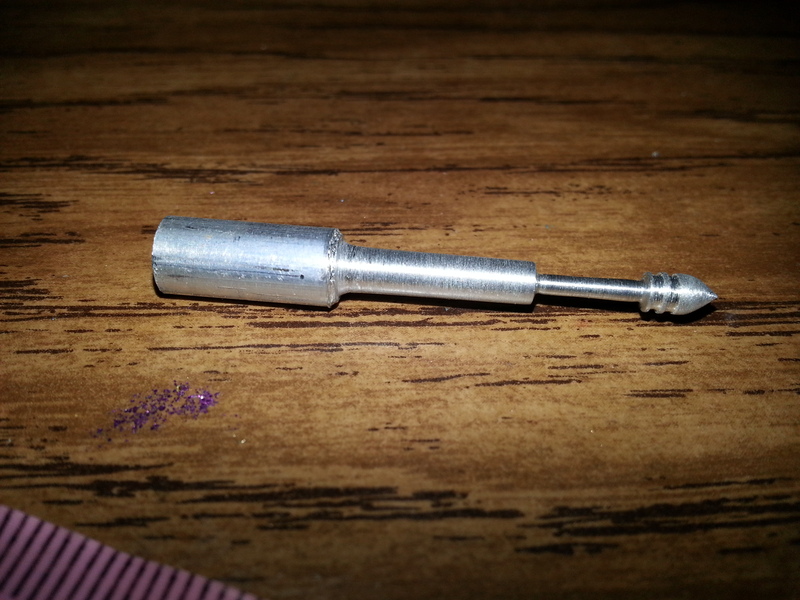

Step 2: Size rod to correct diameter
-- I took the entire length to 3mm diameter
Step 3: Add point
-- File ~45 degrees, press it to the end, let it file as the lathe spins
Step 4: Make marks and cuts for the tip pieces
-- The tip is 5mm total from point to beginning of the 1.2mm wide recess
-- I made it with 2 valleys so if the point is 5mm overall that means ~.5mm from the back edge and another 1mm in front of that you want the detail valleys
-- Marking the 5mm back mark with a sharpie I went about a hacksaw blades width towards the tip and cut in the first recess
-- The hacksaw blade is very good for doing this as you hold it steady and let the drill do the cutting
-- Once the lathe gets the groove started you can move the hacksaw blade back and forth in a sawing motion to cut faster (be careful not to cut too deep)
Step 5: Cut out the valley that is 1.2mm in diameter (mine is probably closer to 1.5mm)
-- Again using the sharpie mark back from the 5mm dart tip another 7mm (it should be 12mm from the tip)
-- While the lathe is spinning use the Hacksaw blade to cut a valley at the 12mm back and the 5mm back from the tip these keep you from going to far with your file
-- I turned my flat file on its side to make it smaller and just worked it back and forth between the two initial cuts to create the valley
-- This took a little while and I measured often
Step 6: Sanding
-- I started with 120 then stepped through going 220, 400, to 500
Step 7: Admire your work.

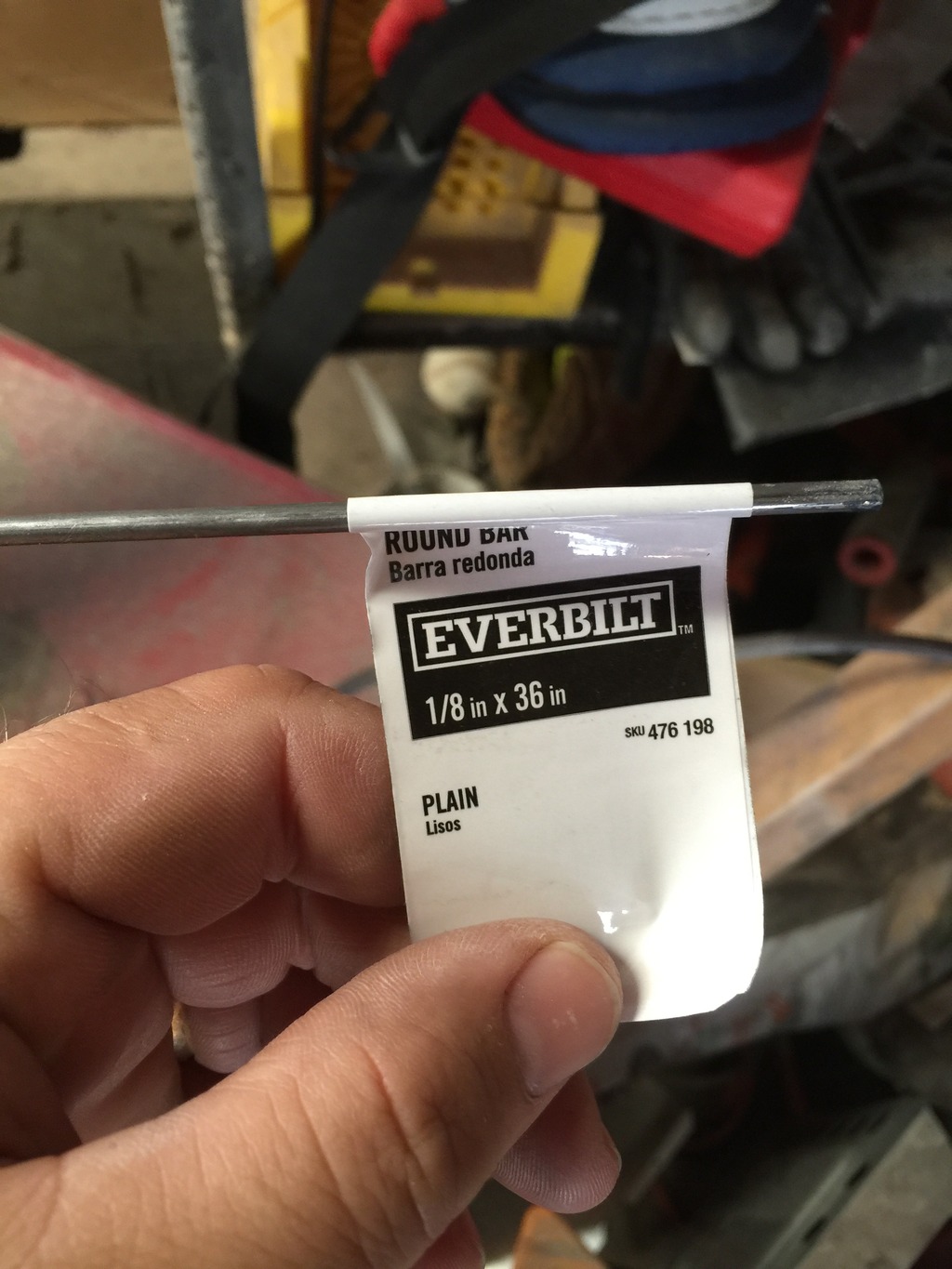

I used the 1/8" bar from Home Depot. The aluminum doesn't go down that small, so they are steel. Nothing my files and hacksaw couldn't handle though.

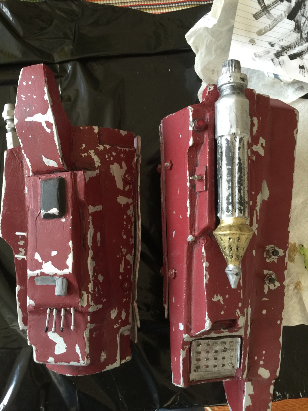

Here they are installed in my gauntlet. Thank you Stormcrow. Now I'm going to use my new "lathe" to turn out my pointy knee dart.
