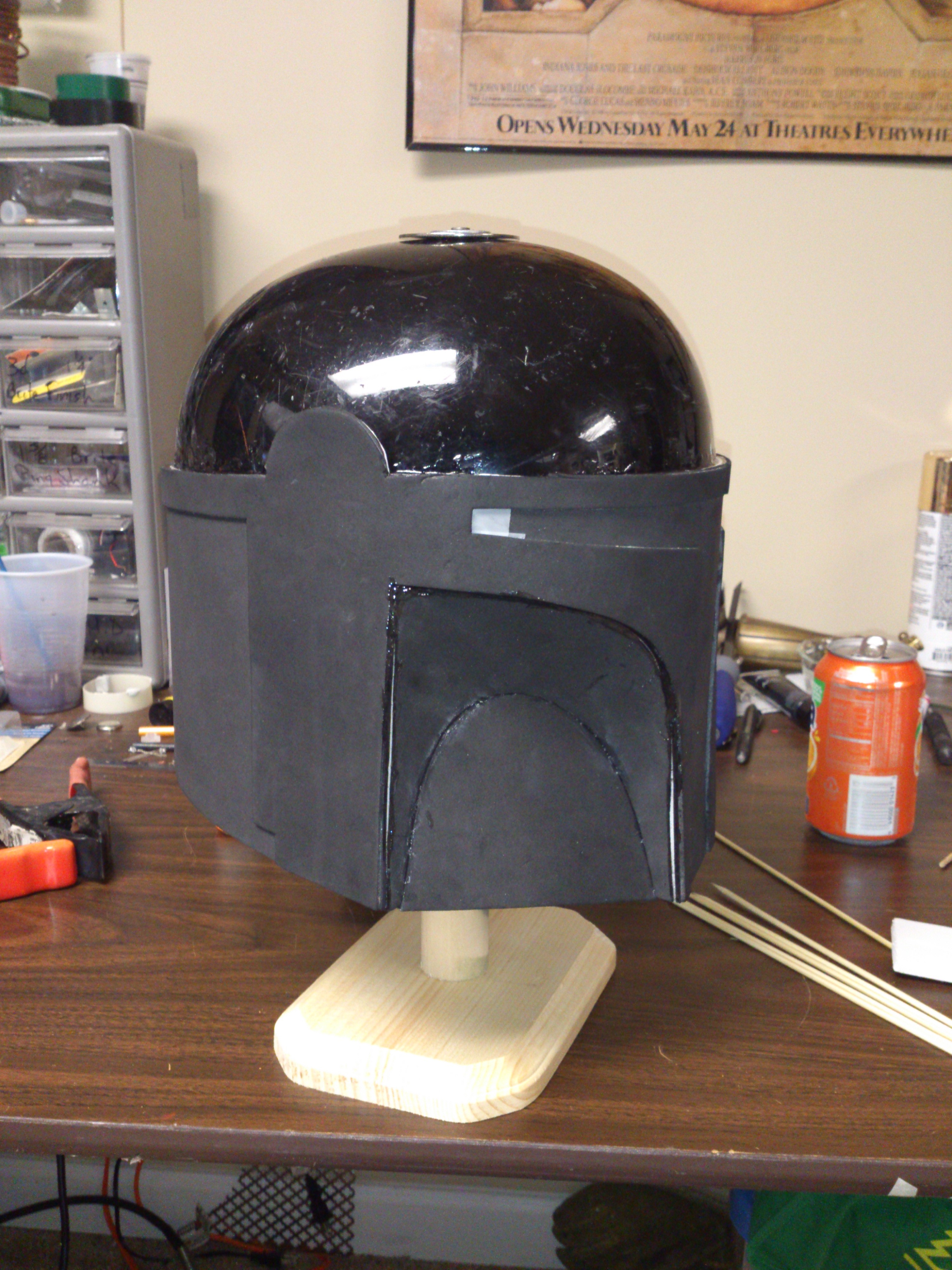

I thought that I could modify a ready-made helmet. The Ruby’s and voice changer helmets were very disappointing, so I chose to scratch build my own.
This is where the fun began. Many thanks to Wizardoflight for the amazing templates

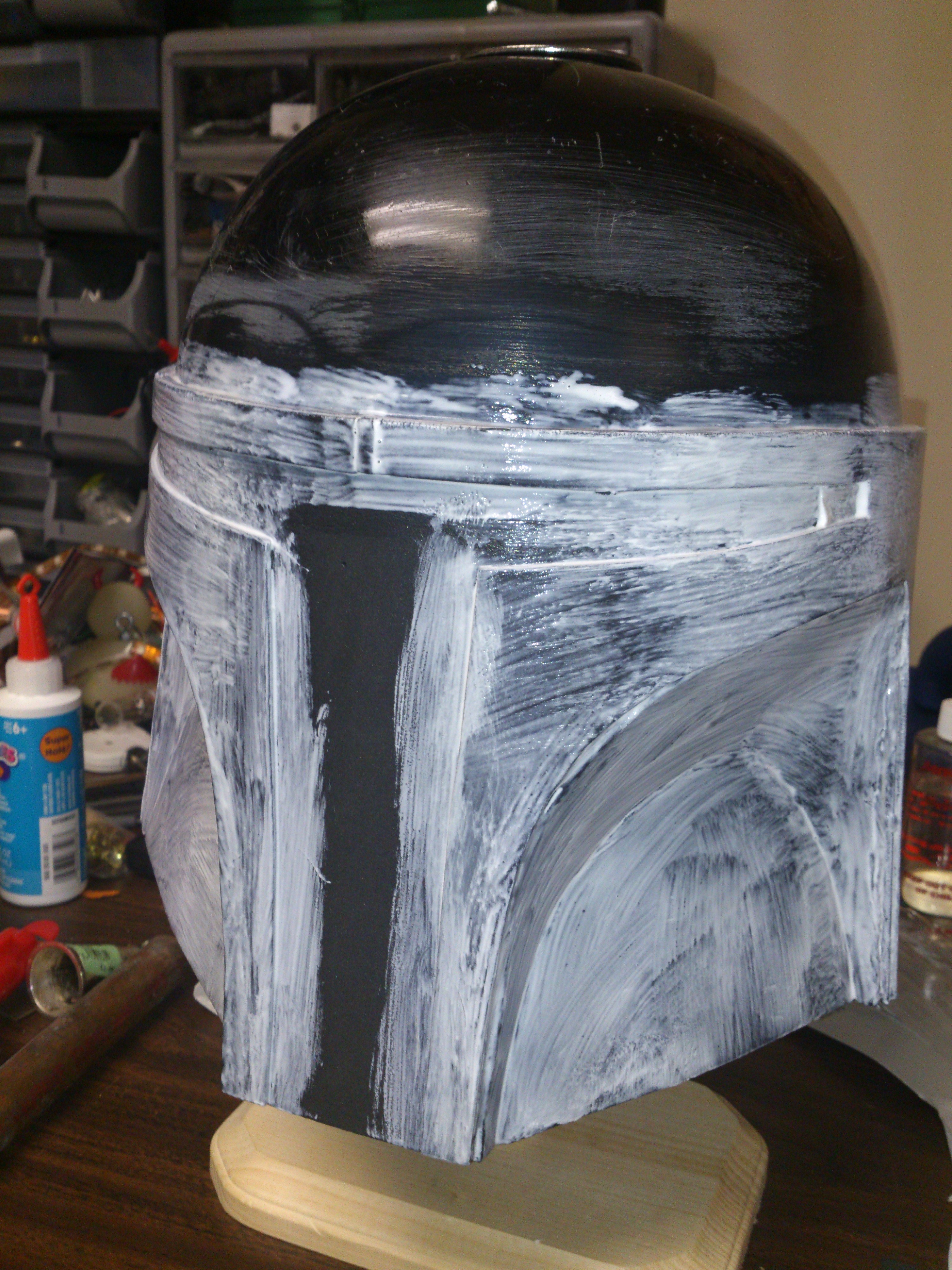

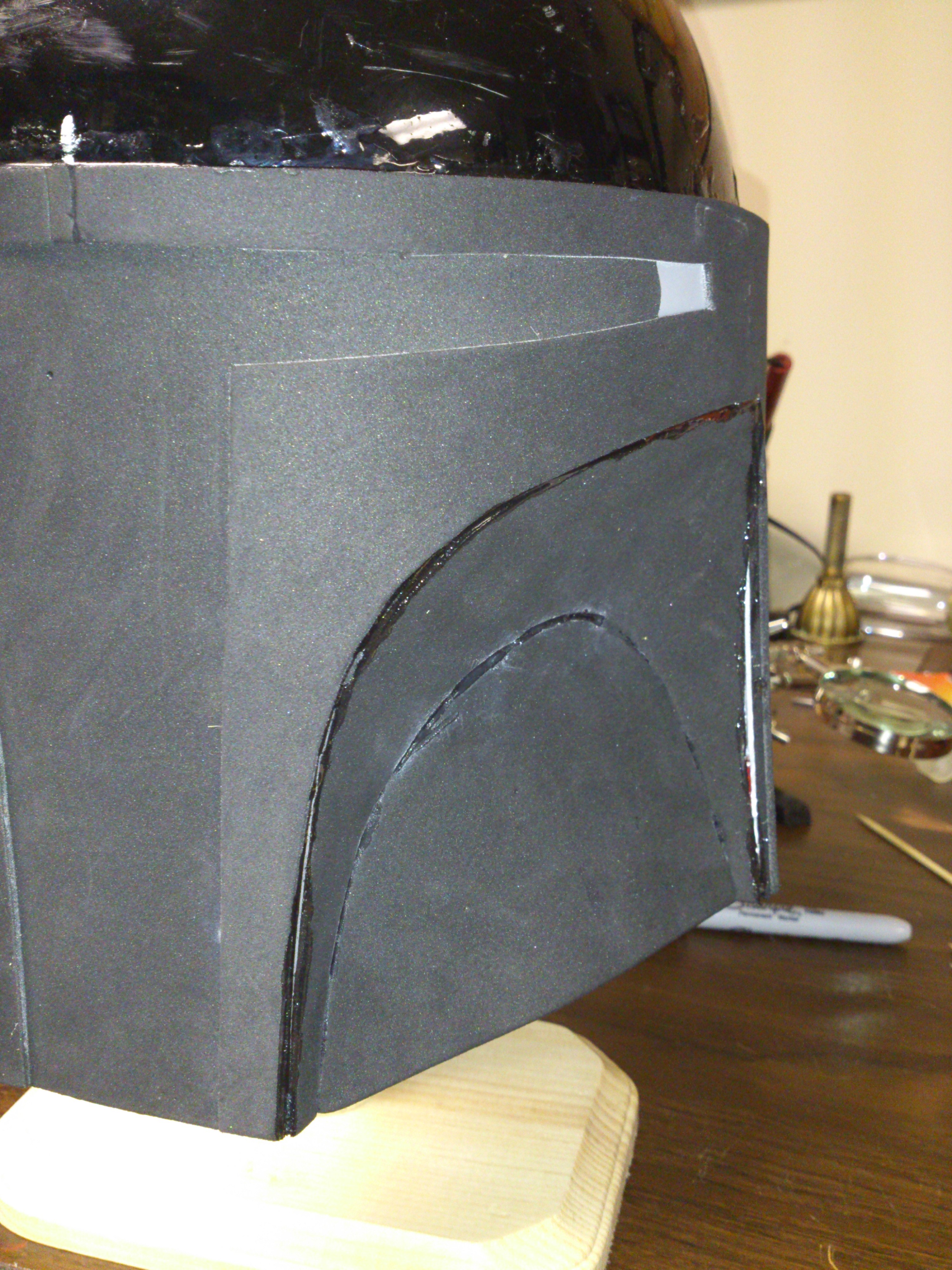

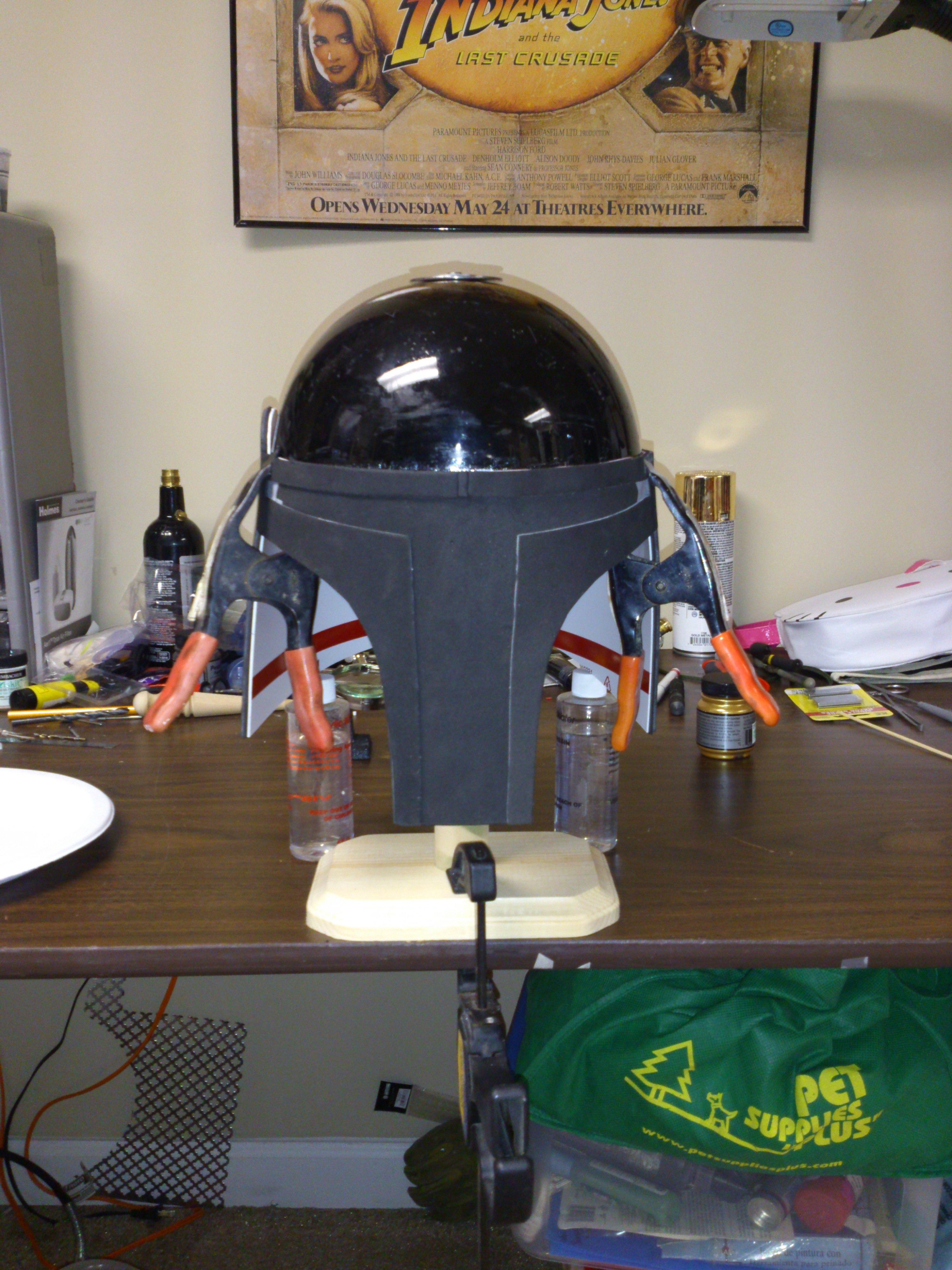

I used a batting helmet for the dome. The sides were built utilizing a different technique than the standard bondo and fiberglass. They were constructed with plastic “For Sale” signs and craft foam sheets. I then coated the foam with several thin coats of craft glue and covered it with Smooth-On Smooth-Cast 65D. The glue provided adhesion of the “rotocast”, without damaging the foam.

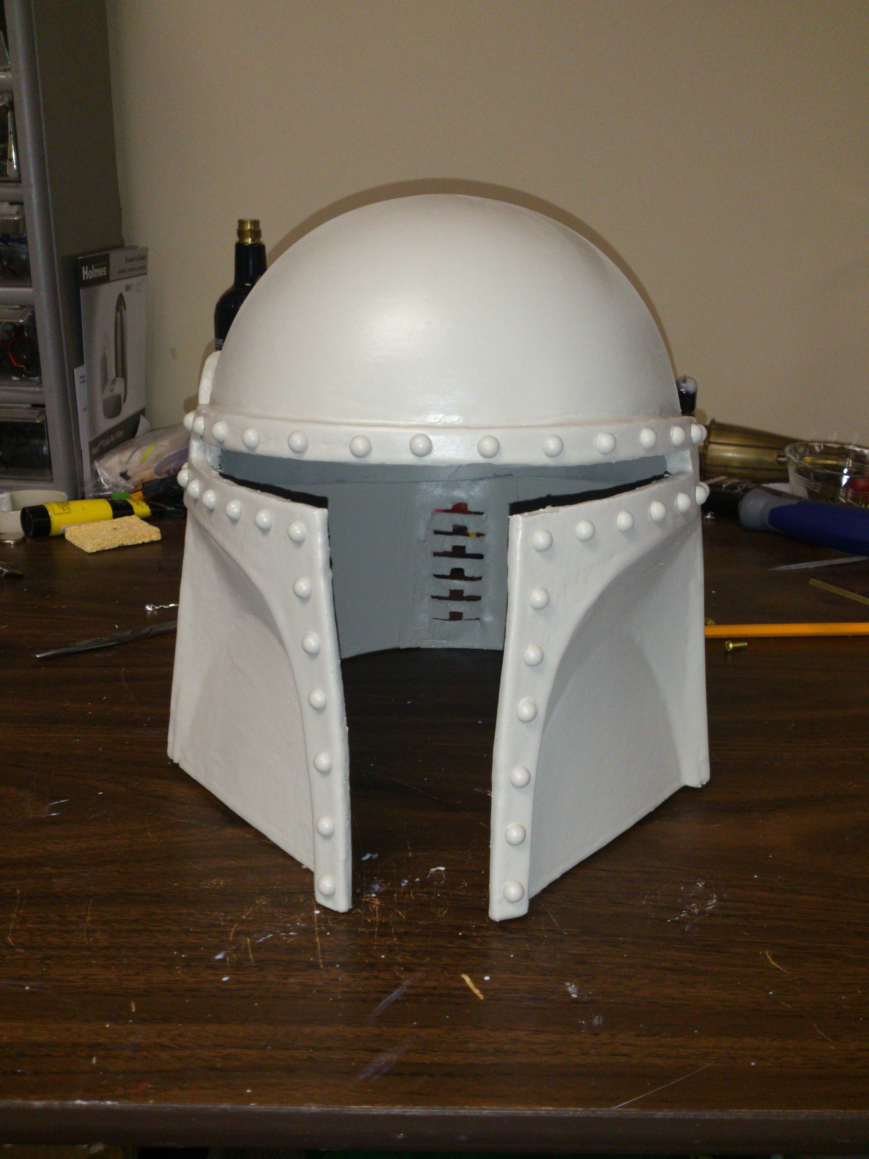

It can be sanded and painted like plastic. Plastic primer is a must.
I will post more photos soon.

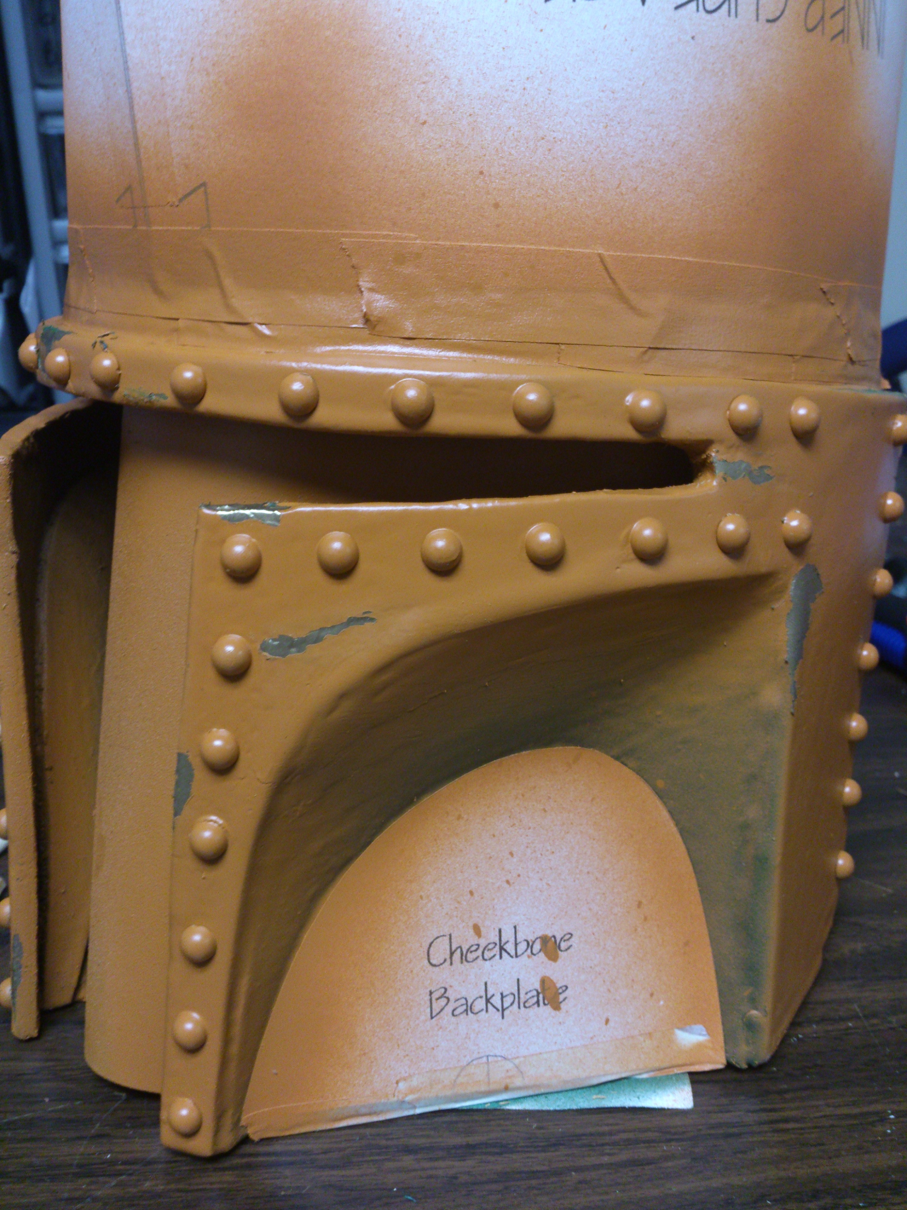

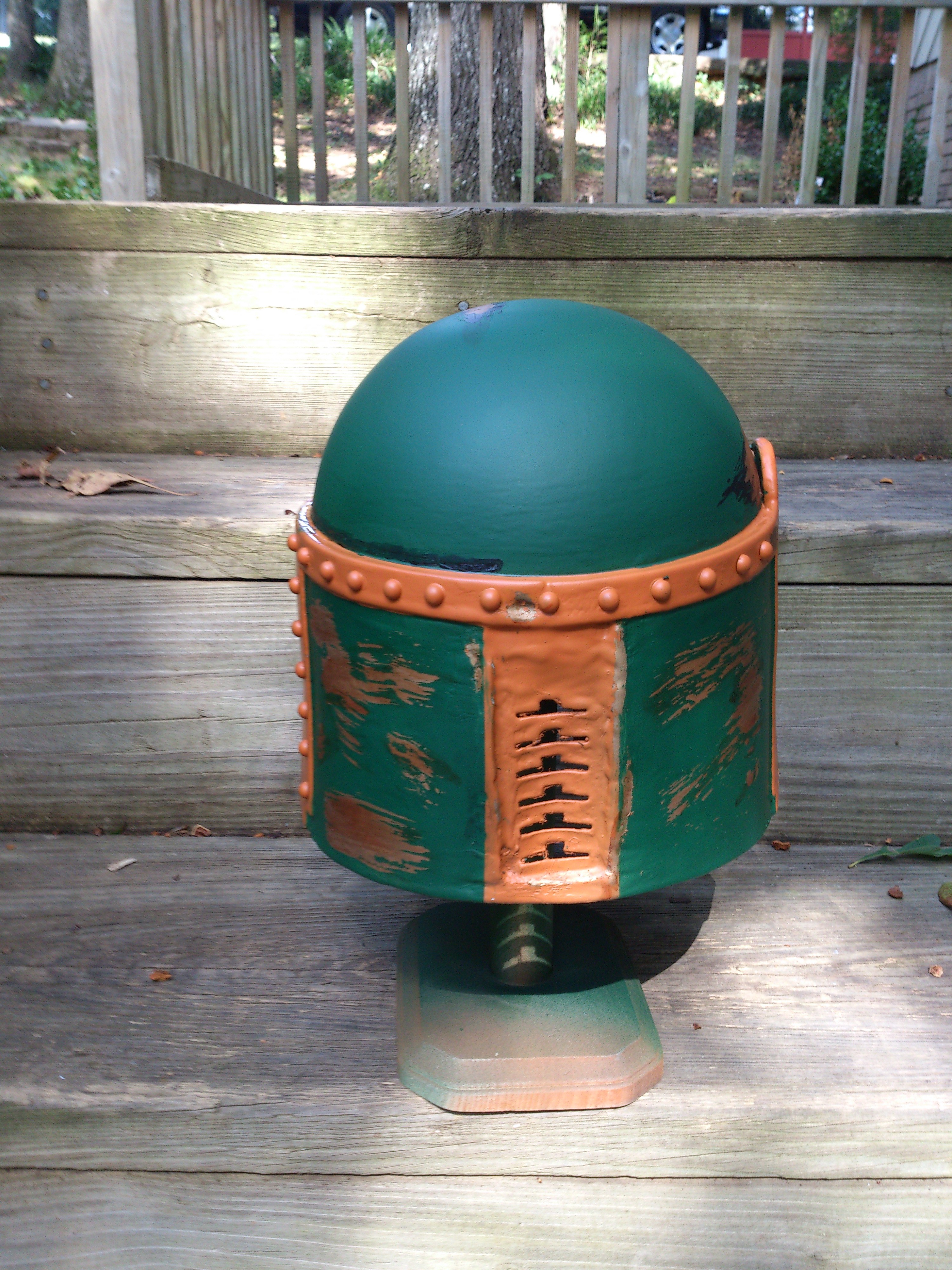

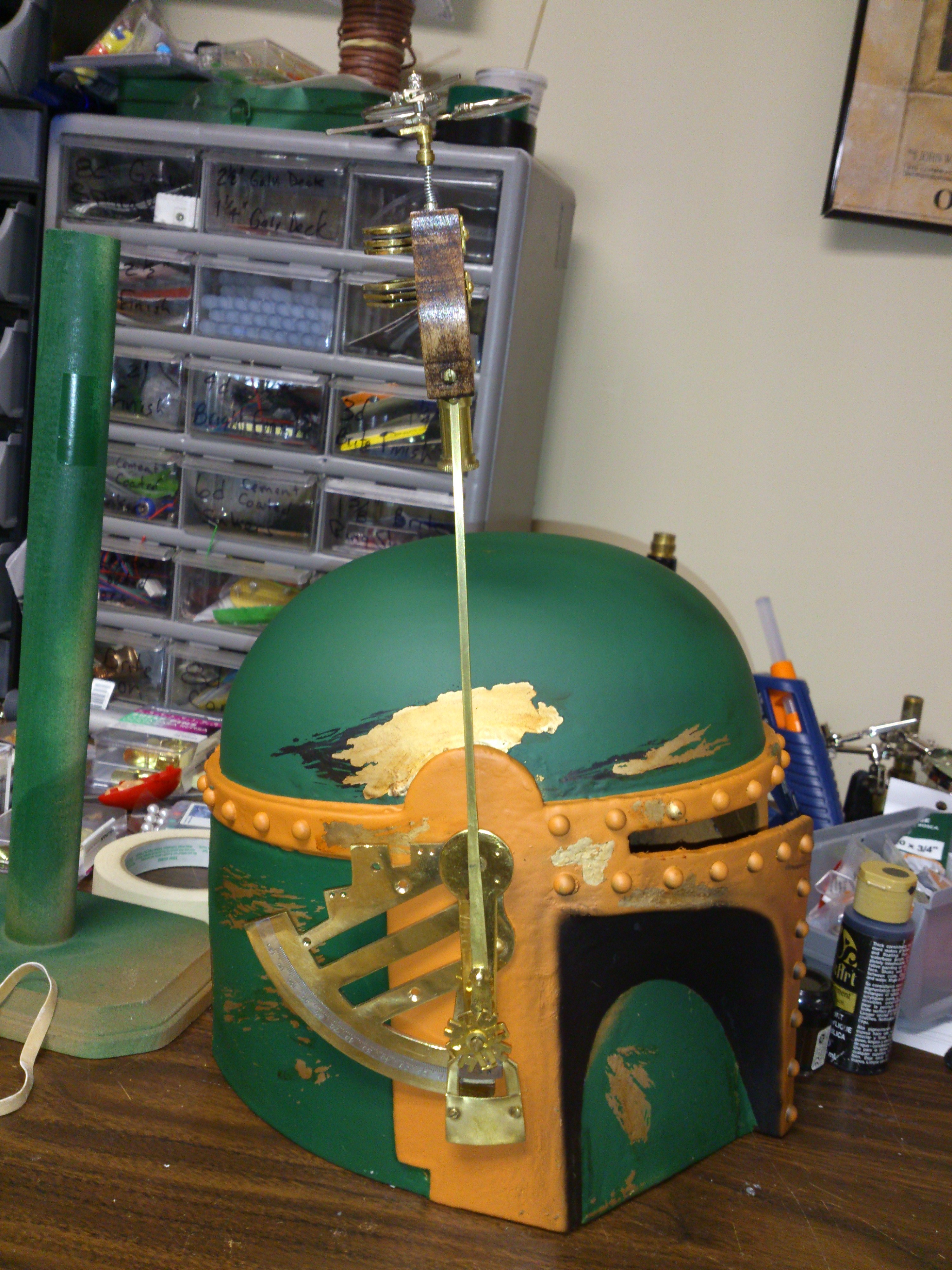

I chose a gold base coat to give the appearance of being made out of brass. I used self adhesive scrapbook beads to recreate the rivets
The right earpiece is made from a reclaimed brass sextant and the left is carved out of oak.
I used the base plate and swing arm for the earpiece and the RF has the lenses and eyepiece from the sextant. The stalk was a piece of square brass bar that was hammered flat on one end and bolted to the swing arm. I can manipulate the RF and stalk by hand.
