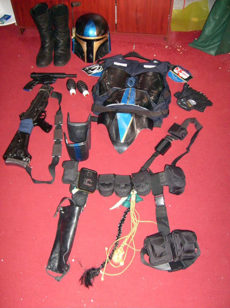

here is some of my other stuff some wip's some finished
hope you like and please comment

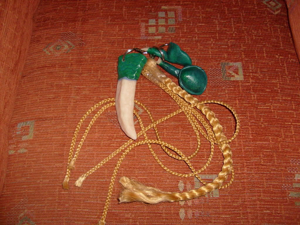

some trophies
:lovehow much time didyou put into this?
depends on which part youre talking about , i had the armour done for a hole year before i found a vest that would work , didn't want a Jango or Boba one (and as i have asthma my weight fluctuates abit , so needed one that could be altered at the sides )so got a British Army issue flak jacket cover got the neck line alterd so i could wear it backwards it already had adjustable sides then i had to find someone with a sewing machine to sew on the velcro , then i had o find the right colour boiler suit , the get the belt kit to work the way i wanted it , my bucket was too small and the back wasn't cast properly so i cut it in 2 from left to right seperated it about 2cm and applied mesh and bondo then rebuilt the back with sintra , then if yu count all the side projects like the blasters and binoculars (farmboy glasses , different area of the board),trophies, the drop leg pouches and the over the shoulder strap (will have a houlster eventually) all in all about 3 years.

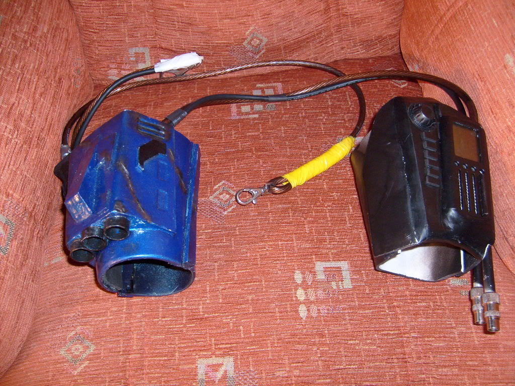

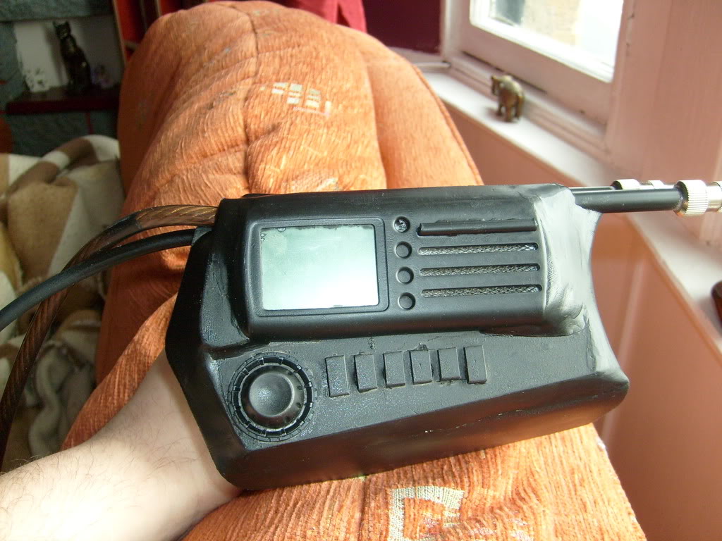

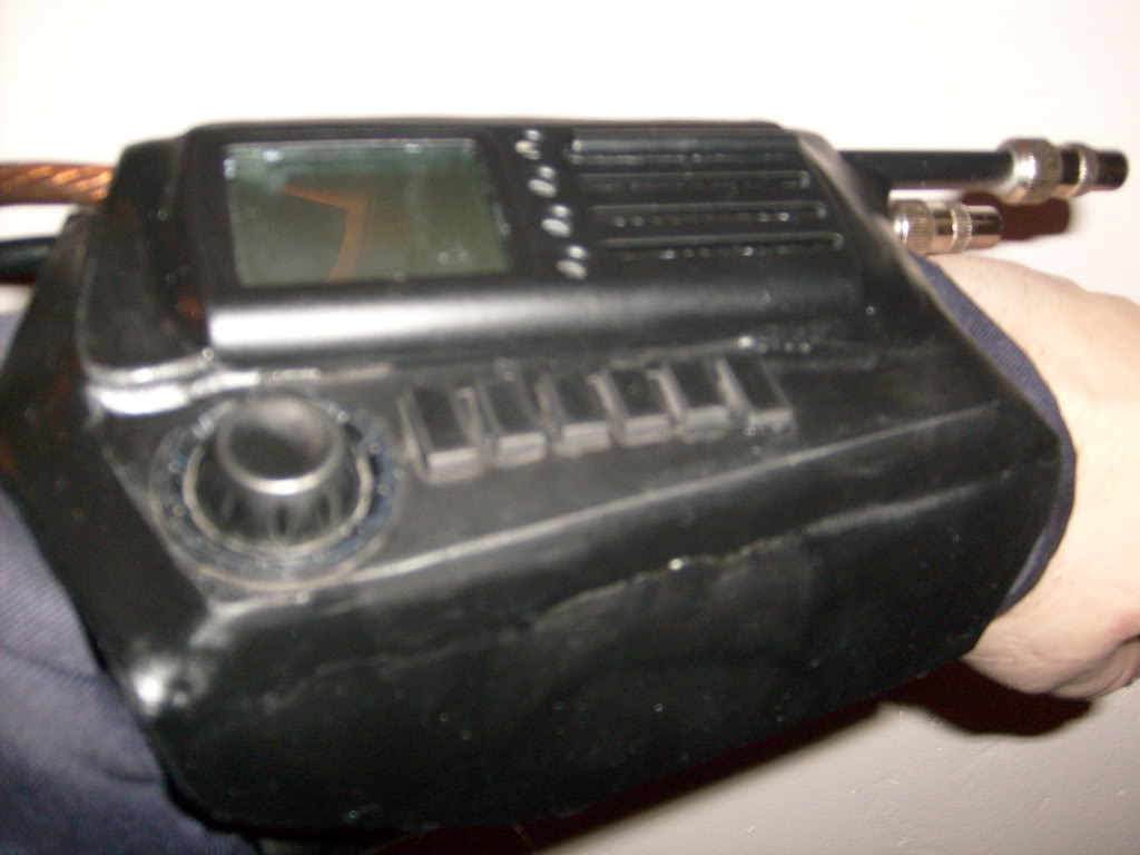

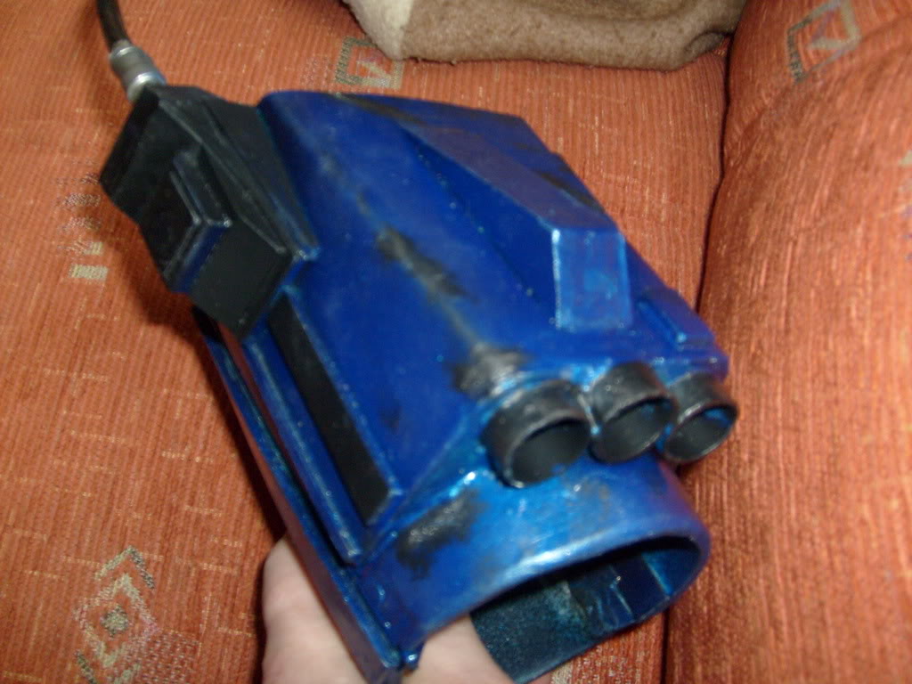

what did you make your gauntlets shell from? i wanna go scratchbuilt like the rest of my armor but its notoriously difficult to get the top and bottom shell to match up. any pointers?
it's a bit of trial and error really . i started by forming sintra round my arm a piece on the bottom (forming a u shape with my arm sitting in it ) then another from the top ( forming an upside down u shape from the top of my arm) it'll be trial and error to find the right size so make sure both pieces are a bit big so you can trim back . trim them so one fits inside the other ( you may need to heat the pieces for this )once they fit try it on you're arm , and continue till it fits , top over bottom ( remember to make allowance for your flight suit so form with it round you're arm while wearing youre suit or long sleved jumper (remember it will be hot )) , once it does and you're happy with it , while it's on draw a line on the bottom where the top neets it (just run a pen or pencil along the top edge)
from there it should be plain sailing , just add what you want . i added more sintra to box out the top .
when sintra is heated you can push shapes onto it and it will when cold retain the shape as if recessed in it , just a tip

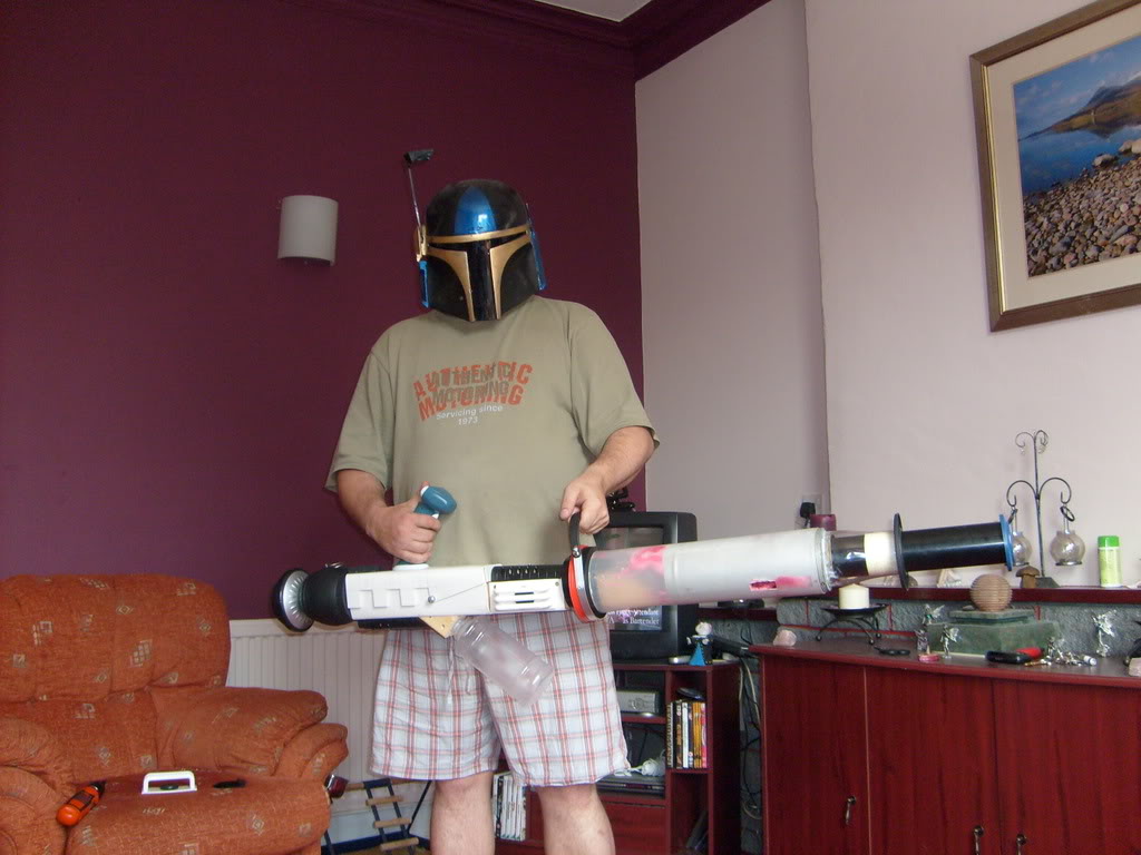

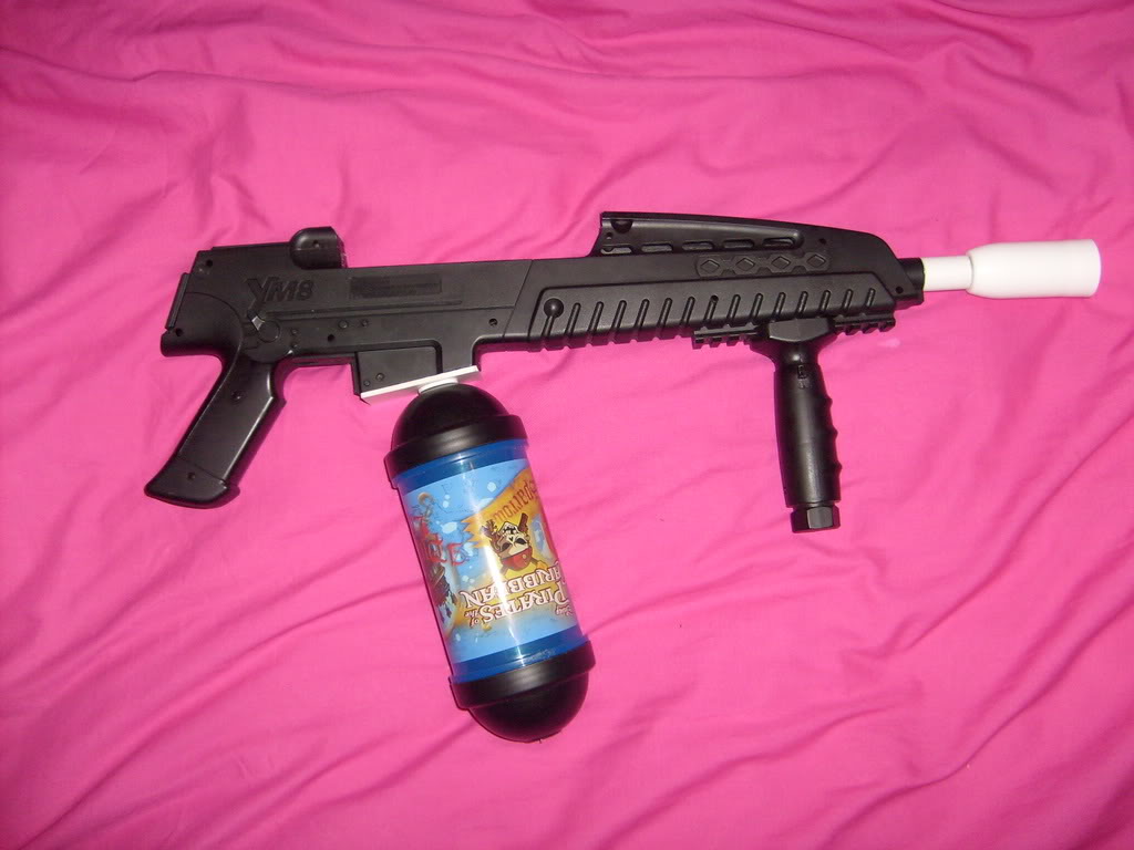

the BFG and the flamer still arn't finished yet

YOU ARE INSPIRING! :D Do you have a template for your arm guantlets? IF not, could you take some pictures of them and give me some dimensions of the total length, width, ect. They are really really really cool looking. I'm in love with your right arm 3 hole blaster thing.
