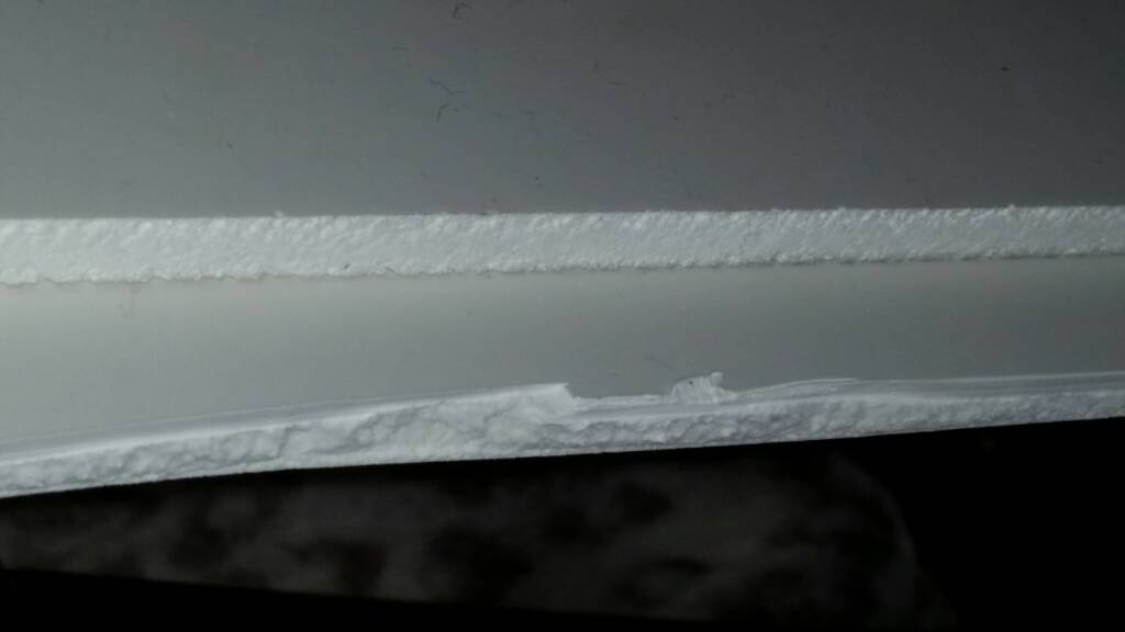

Sorry, I've been away from home for much of the week. Thanks for the info. I attached a photo of the cut pvc sheet.
The sheet is 6mm thick, it's not super flexible but could be bent slightly when i hold it. From the attached picture, you can see the factory cut side which is rather smooth and the jagged cut I made (rushed the cut outside to get the piece to fit in my car). There is clearly a pvc coating on both sides of the sheet with, what I think is, closed cell pvc in the middle(it has a spongy appearance but it is not soft).
I think it'll work, but if anyone has any doubts please let me know. I won't be able to test it with a heat gun for quite a while.
