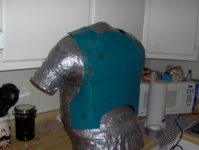

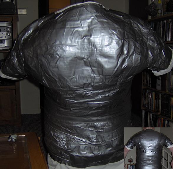

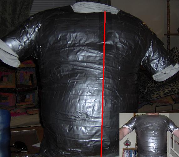

I started with an old t-shirt and a couple rolls of duct tape and had my wife start wrapping me like a mummy. We did 3 layers up to my neck, about 200 feet of tape, to make it more rigid. (I'm a big boy so it probably wouldn't take as much tape for an average sized person). It took about an hour and a half to two hours, so make sure you pee before you start

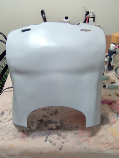

. After all the wrapping was done we cut a single seam to peel it off and then put it back together. I then sealed off all the openings with cardboard, except the neck, and filled it with expanding foam over the next few days, about 12 cans worth. And after that dried I had a model of myself. The key with the foam is to fill it slowly or you will get air pockets and soft spots. I found this out first hand, so just have a little patience and don't rush the filling. Someone tole me you could use newspapers to stuff it too but I wanted it to be a little more sturdy. See attached images.

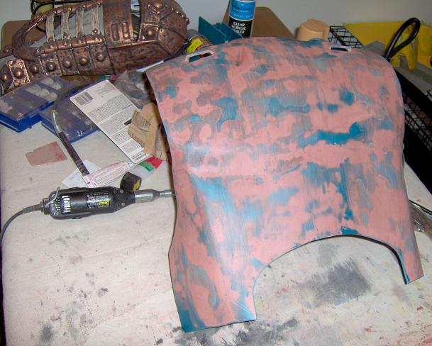

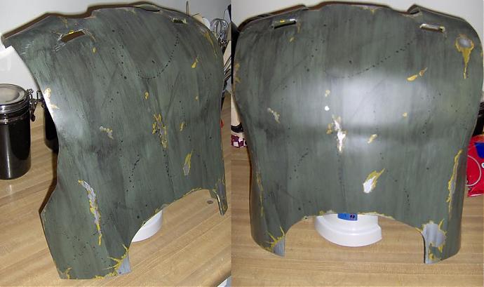

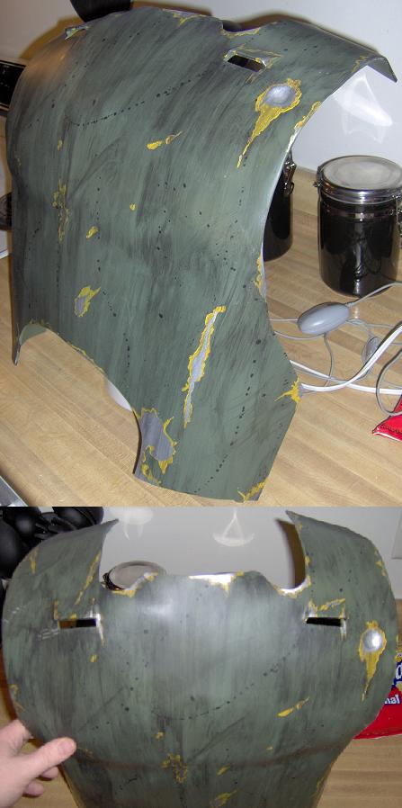

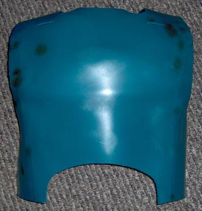

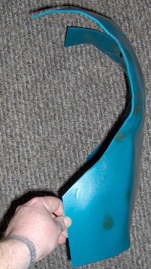

Looking good. You may need bigger slots for the jet pack straps, depending on what system you will be using. I like it. Good job
Thats one of the things I plan on working on. I think I'm gonna cut an inch or so up from the slots and heat and bend the flaps up a little bit. That should make the slots a little bigger and make the overall appearance better.
