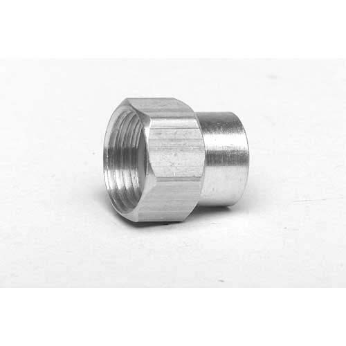

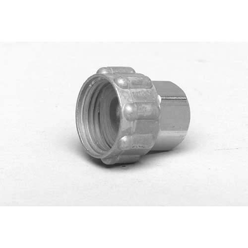

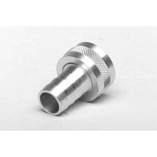

ok, here are some pics of some items i am throwing around for the tip of the barrel...let me know what you guys think...and as usual, if anyone has any better ideas, keep 'em comin'....:D
i like the 3rd one the best, cause it is round...but depending on how well they will attatch to the barrel is what will determine which one i use....:thumbsup:
yep, went to Lowes, and that is what i got...once i get the barrel and the connectors figured out, ill post some pics of what i got...
ok, i need to figure out how to get the tip connected to the barrel...i have used some coaxial connectors, and need a threaded rod that is M 7 X 1 , that is what the thread on the inside of the connector is...female part, into to the tip...i would like to find the 1/2 in barrel, whatever metal i find, and get an insert that same size, so the other end of the rod would go into the insert and then into the barrel...or should i try to find the 1/2 in pipe with the INNER part threaded to match the threaded bolt i am wanting to use to connect the tip to the barrel...am i making any sense guys, or am i clear as mud? :lol: any help or suggestions would be great...maybe i should post a pic of the tip i have put together...
