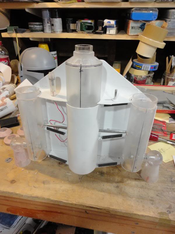

The proportions on the jet pack went a little better although I missed one fundamental measurement by about 3/4 inches. Otherwise, I think they're pretty good. I basically looked at the size of the pack in relation to the shoulder width and measured what I thought would be the equivalent size then measured that width in my boy's shoulders and came up with an 11" wide pack. Then from there, I made a printout of the back and printed a little scaled down ruler I could use to size up everything on the pack. Things worked out really well because the main tubes were landing right around the sizes that were available.
Bending and forming plastic was a new thing for me and I used a heat gun to do it. Had a few tricky compound curves and cuts that intersected with rounds like the top of the pack where the center tube comes out. I already have a band saw, dremel and belt/disk sander and those things were absolutely necessary to do it this way. I may make a small vacuum for table at some point just for fun. Been researching it. Don't have a lot of room in my shop though.

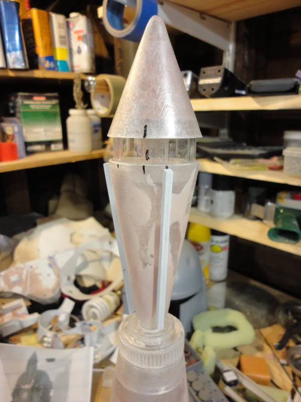

One thing that was new for me which I worked out myself was a method of making cone shapes. I didn't have any kind of lathe or anything so what I did was make a form with a tube and round pieces on each. Then sand the bevel on each piece spinning it against the disc sander. The tube shape was achieved by rolling a sheet of this plastic into 3 layers glued to each other. I found that just rolling onc piece into three layers was better than trying to single layers. Too many seams with single layers. The final seam wasn't too hard to deal with since the laminated plastic could be filed and sanded. I did get a fair amount of warping though so I had to really bondo up a few of them. Although, a little of the still visible warping kind of adds a little character.

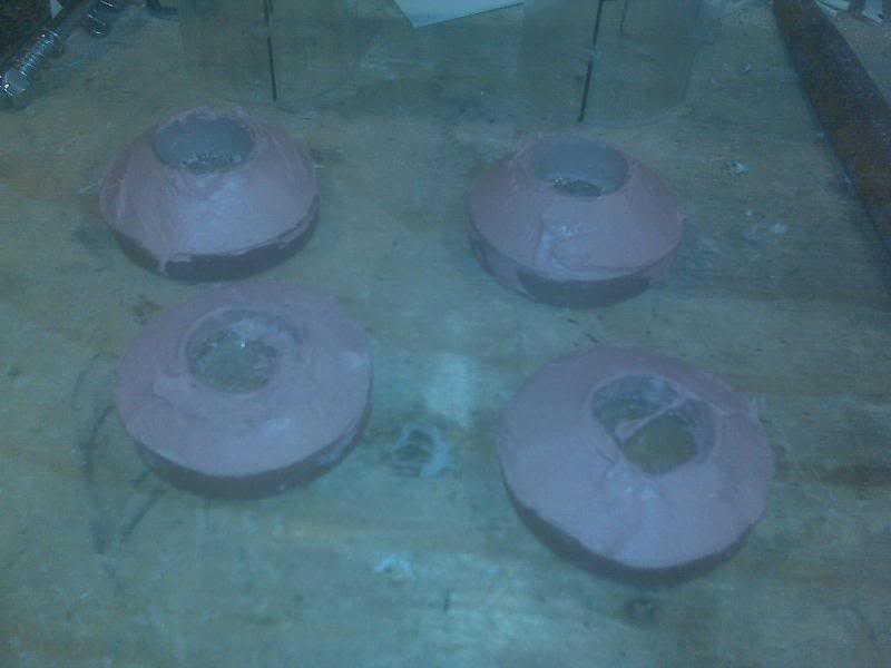

For the really shallow cones like the 4 side caps I made a lower circle out of plastic, glued a tube to the middle then built the cone out of bondo. Piece of cake there. Worked great since the plastic was hard enough to serve as a guide.

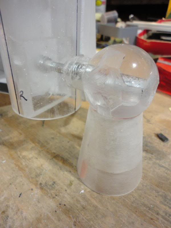

Doing the balls on the jet pack were a little tricky. I used Tap's acrylic balls. Made a centering jig out of wood and used my circle template to mark of the 90 degree marks. To make them movable, I used a tension spring with a 1/4 20 lag bolt and a lock nut on the other end. Works well and shouldn't ever wear out tension-wise. Used to do this with pen springs on the guns on my spaceship models and I still have one built in 1983 that's still nice and tight. I used the Dremel and some hand files to cut out the cross pattern but went a little too big on that and found out when the cones went on. Next time I'd get the cones sized up before doing the carving.

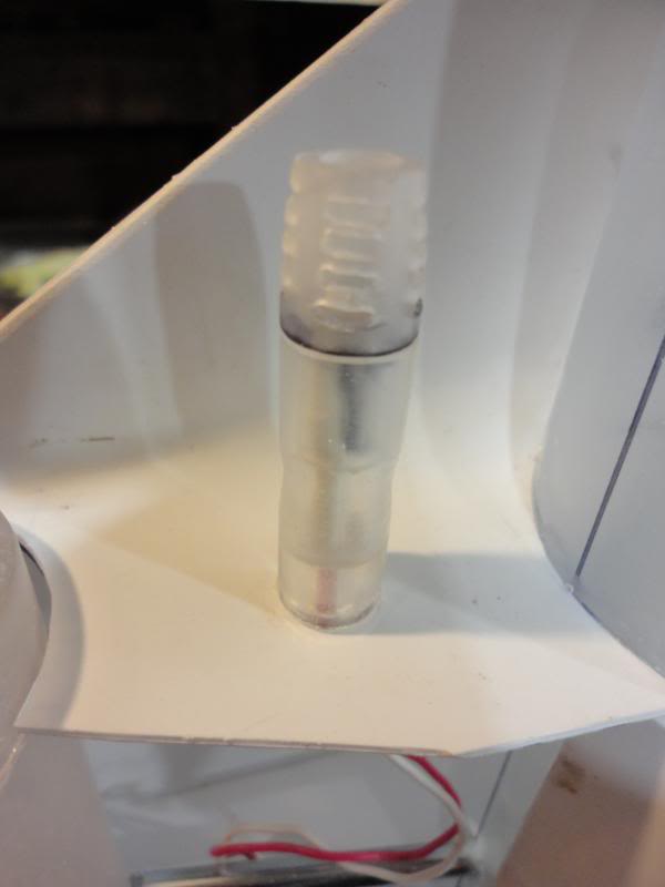

The stabilizer was made with a cut off sex bolt for strength and the beacon was made from pieces of acrylic tube. The cap just press fits into the stalk. Slight lathe work done on the drill and belt sander.
