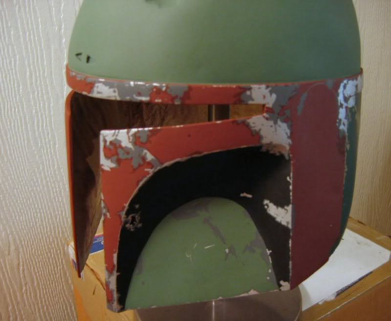

UPDATE: Sep 3rd (DAY 8 )
OK, got the left side of the face done! :)
Now I'm starting to work the right mandible. Well, the part above the visor anyway.
Next will be the mandible itself. . . lots of detail in this area!

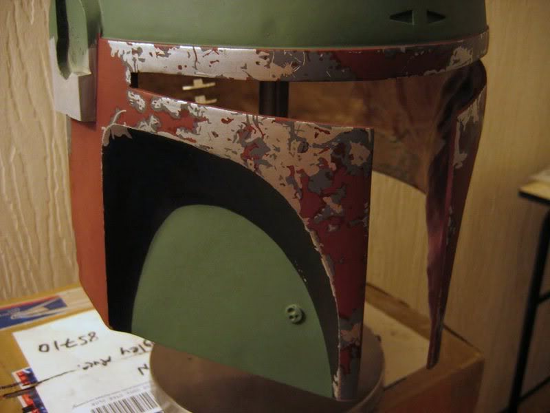

UPDATE #2: Sep 3rd (DAY 8 )
OK, got the mandible done! :) Wow. . . this section is one of my favorite areas, even though it's got a lot of tiny detail.
Next I'll finish the right cheek area, and then everything below the dome will be done!

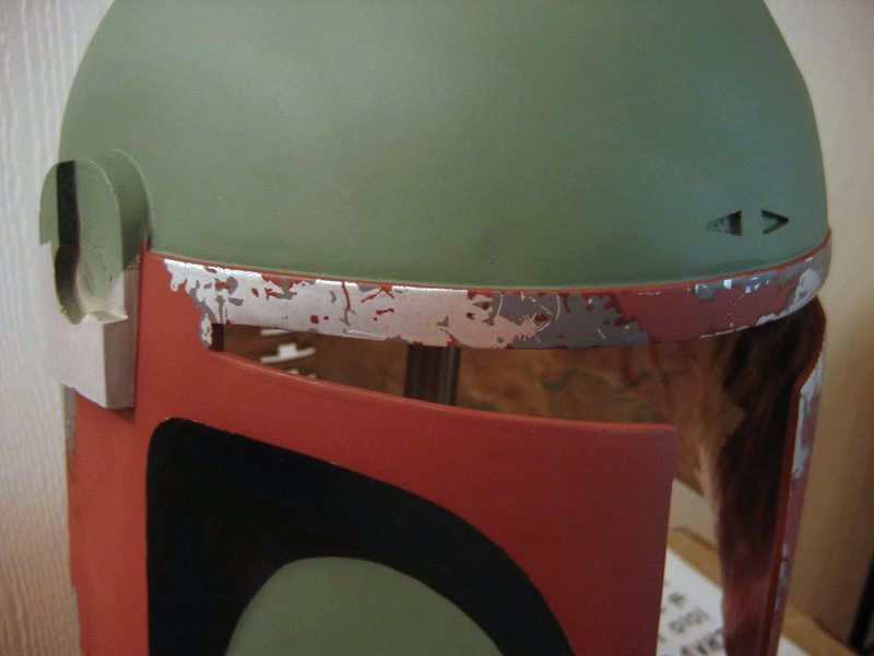

UPDATE: Sep 4th (DAY 9)

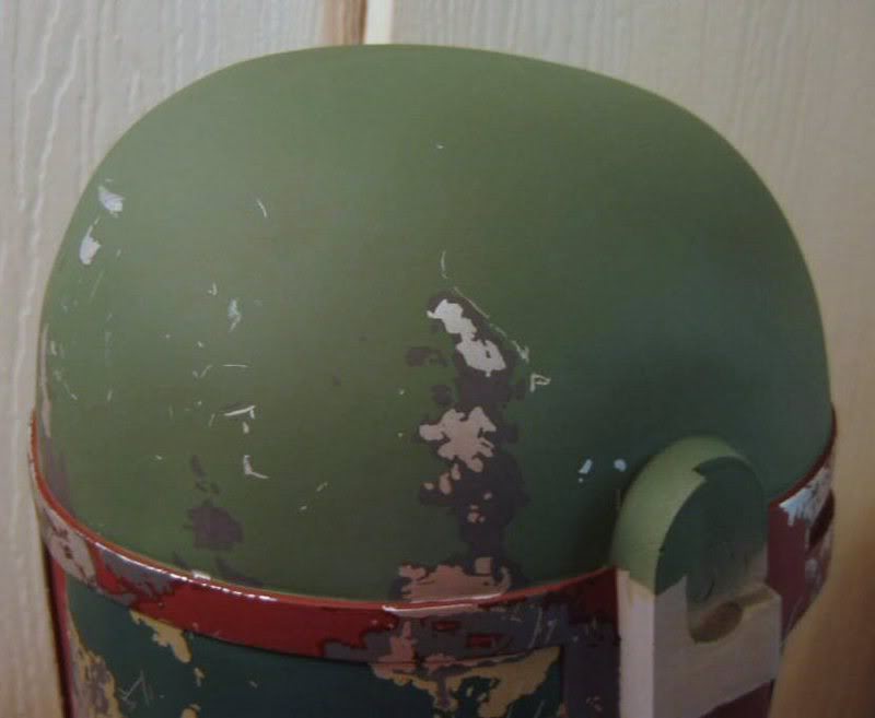

Began working on the dome. I started at the back and I'm working my way around the right side. I'm still using my trace/stencil technique to place the "larger" damage areas, then after the silver and gray are painted on, I go back with a compass point and do the really thin scratches.
Here's the area behind the right ear.

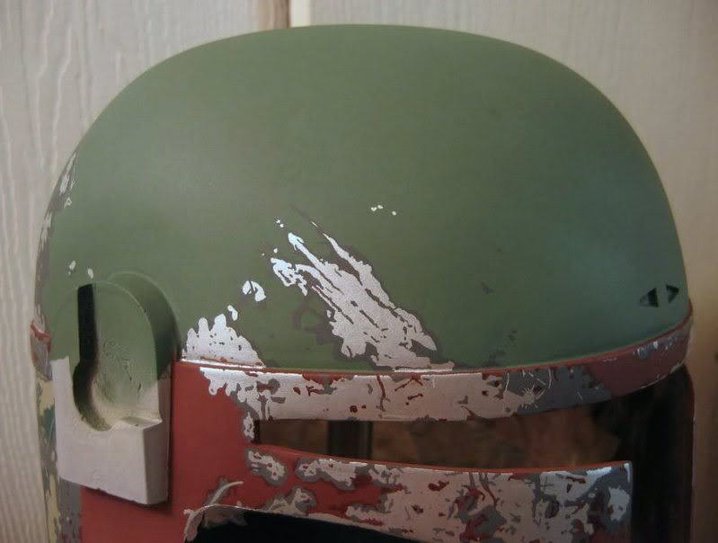

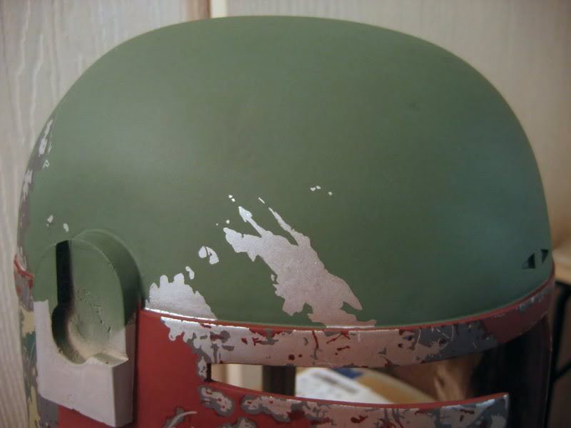

And I wanted to show a pic of the cat scratch in a couple of stages. First I stencil the silver area. I don't worry about most of the small details. I just try to get the overall outline as close as possible to my reference pics.
Once the silver is laid on, I go back with my tiny size 0 brush and do the gray. You can see as I work around the silver, I add the little dips and divots, changing the overall shape of the outline, as well as putting in the internal scratches. This is done freehand.
So next will be working around the front of the dome toward the dent! Still have the killstripes to do as well. :)

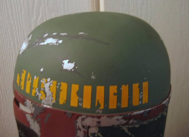

UPDATE: Sep 5th (DAY 10)
Well, I decided to forego the "Hello Kitty" Boba Fett and stick with the original ESB scheme. :lol:

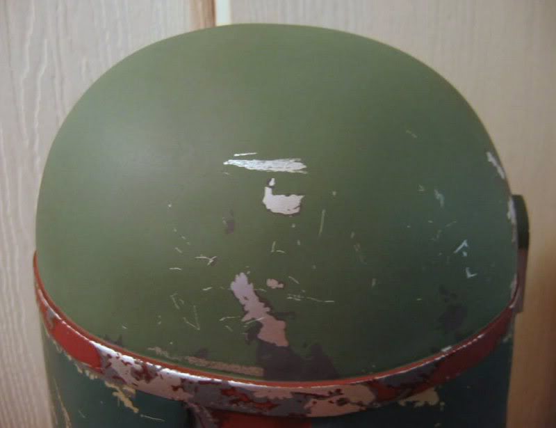

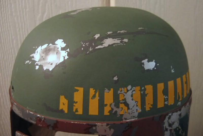

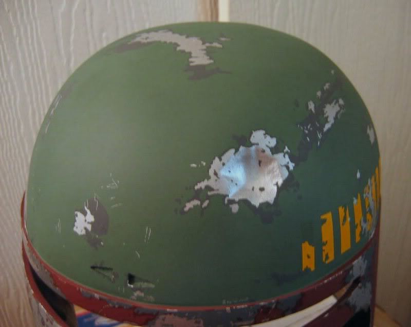

So now, all major painting on the helmet it done. I actually began this final stage last night with the kill stripes. I masked them off and added the chips with masking fluid, painted them, then let them dry overnight.
This morning I unmaksed the stripes, then worked on the damage around that area. I moved on to the dent, and the long scrape behind it.
The final area I worked on is the big weird scrape across the top of the dome.
Still to do: weather the entire helmet, add the 2 white "thumbprints," and spray on a final dull coat.
