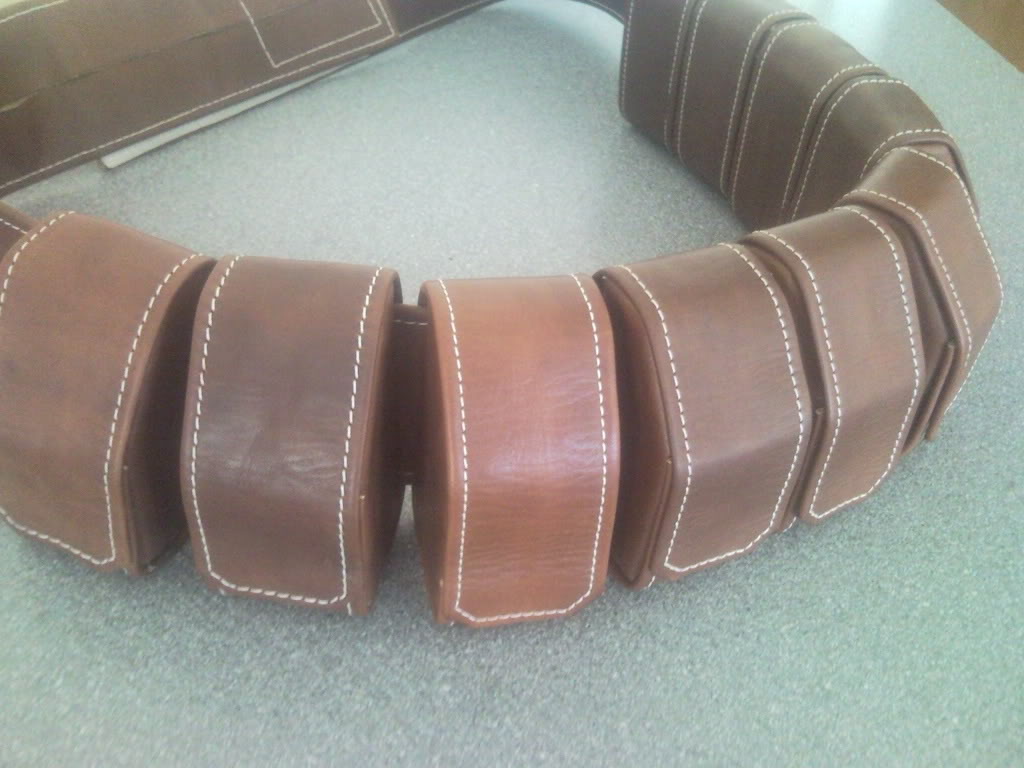

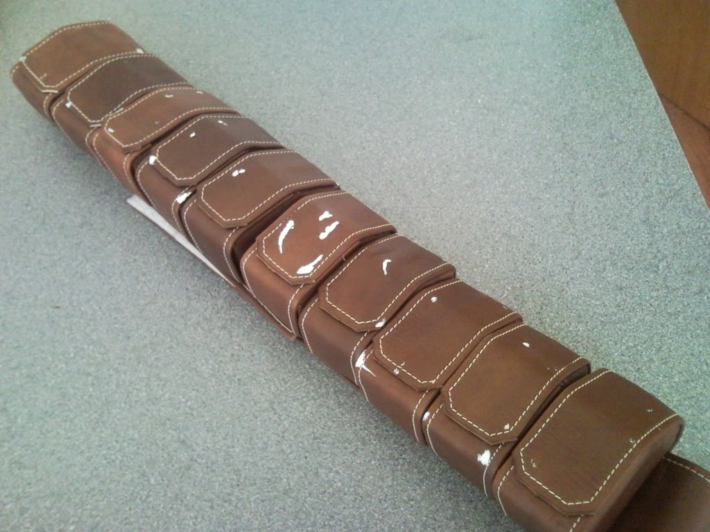

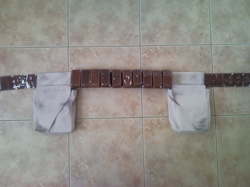

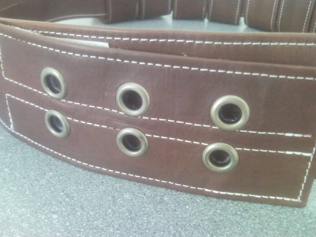

Well i kept saying my belt would be here next week, and then next week. But I woke up this morning to find a letter from the royal mail saying I wasnt at home grrrr :evil: So a very quick drive to the local depot, and I came back with this work of art,

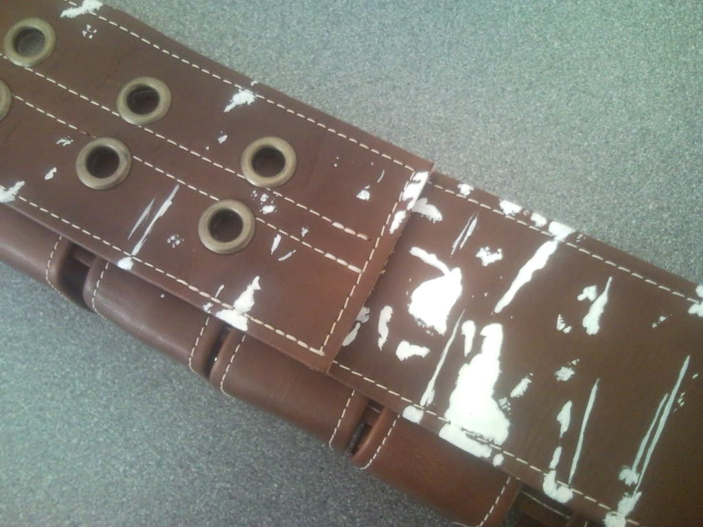

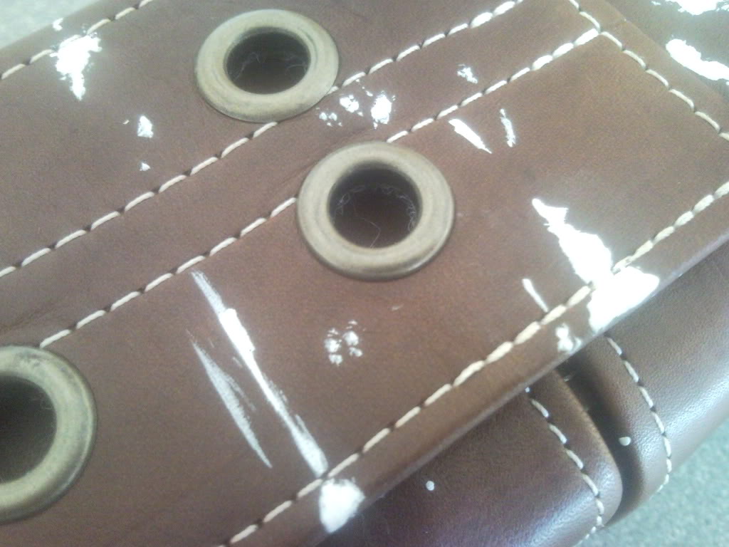

The belt is absolutley stunning, and its real leather so smells great lol. If anyone needs a boba belt, taco is the man to go to, thank you so much brother :thumbsup: So then came the hardest part, ruining this belt with weathering. So I decided to paint the damage and wear on. It not perfect and I took some artistic licence in certain places were I couldnt find any referance of. Some of the white needs another coat as some brown is showing through, but i'll touch that up tommorow.

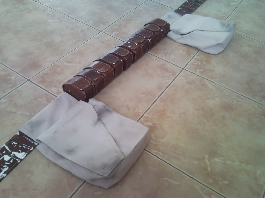

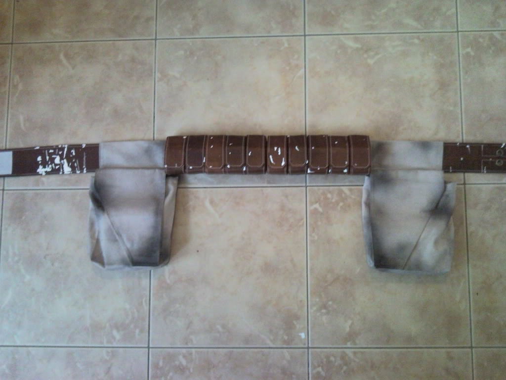

And finally I got out the pouches and threaded them on. The pouches are still not finished as im gonna hit them with an airbrush to get them a little more dirty.
Overall im really happy with how it turned out, up close you can see its painted on, and I mean if your about 3 inches away :D But from about a foot it looks really good. Ive also had confirmation that my flight suit is being built this month, and im also ordering my helmet along with all the armour next week. So I think im about half way through, and hopefully I can get it finished by the end of the year.

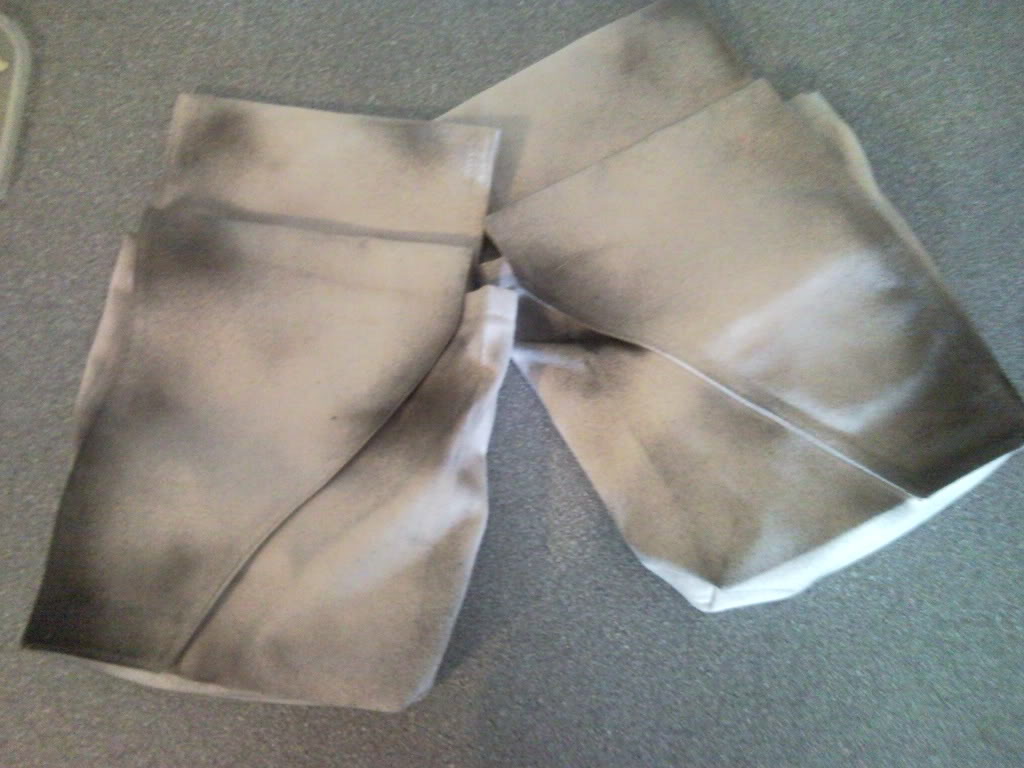

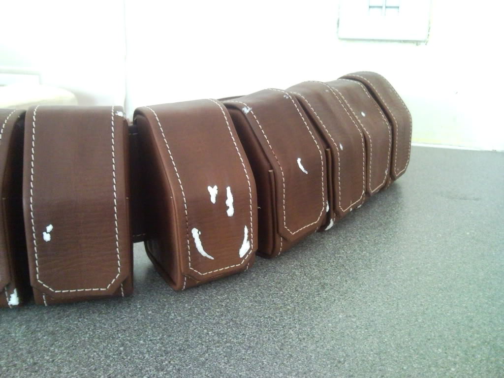

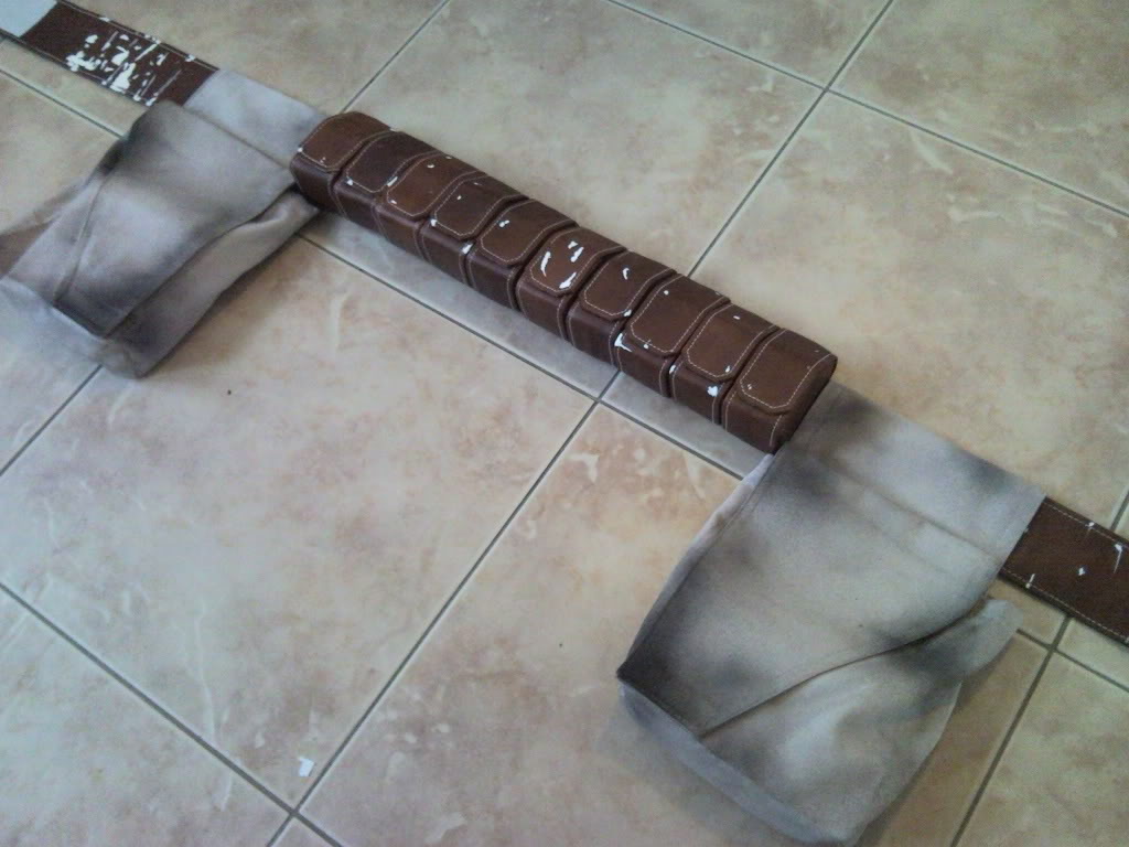

Right guys I need some advise as I think I messed up. I wasnt goin to post any pics of this but means i may have ruined it I need some help. Ive been told be a few peeps that my pouches were way to clean, and now my belt has come I wanted to get them finished to finish the belt setup. So I got my airbrush out and sprayed away. Problem is I think i may have overdid it.
So what do you think, to much? I hope I havant over done it, I think it may be because I had them with so little weathering on I got used to them lol. If I have ive got a long wait before I can get a new set :(

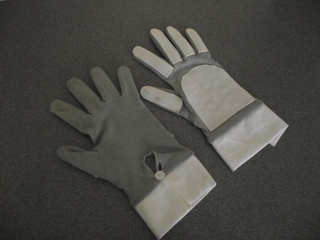

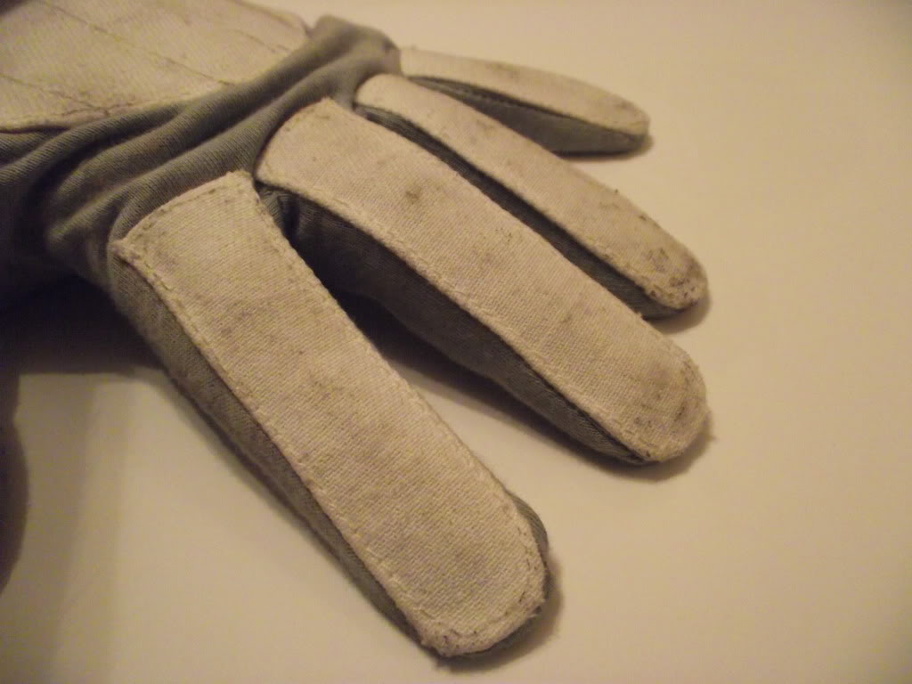

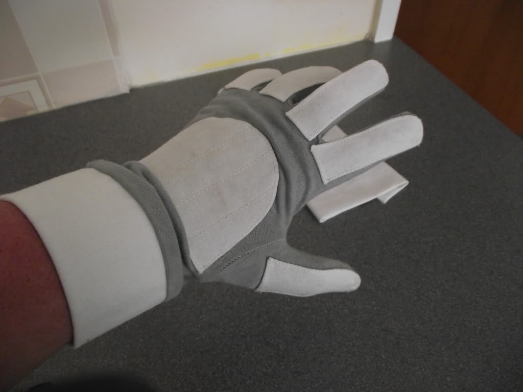

Well guys update time. Turned out I did over weather the pouches, so new ones have been ordered. And thanks to the excellent service yet again from Shiv (james007bond), I have a pair of boba gloves. Thanks shiv, posted yesterday an arrived today, an just like the boots im in awe at them :D
The gloves are perfect, and fit like a.........well glove lol.

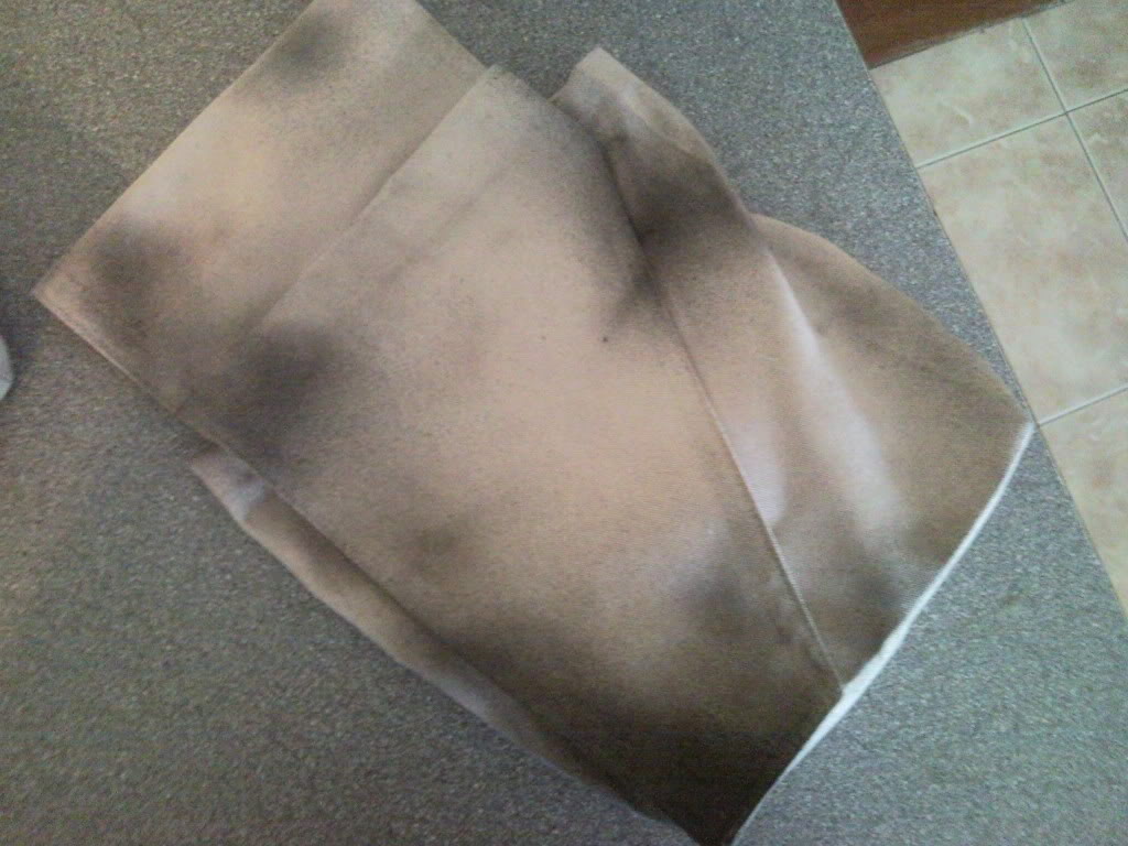

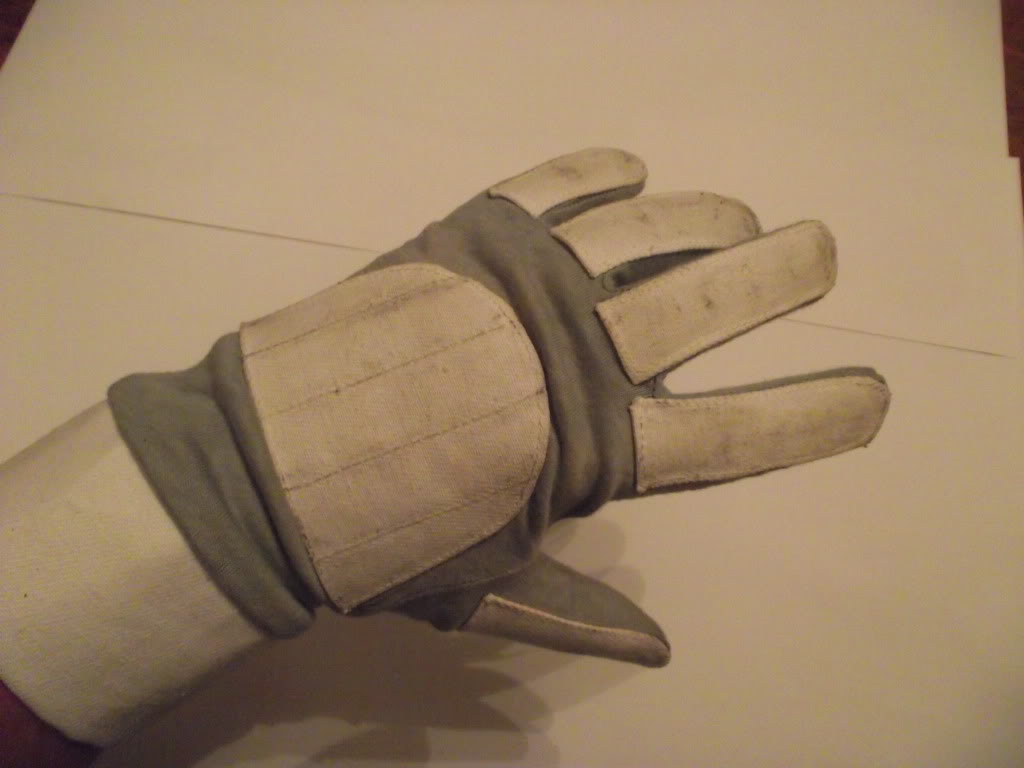

Lovely and clean, untill I did my usual weathering process. I first applied browns and yellows to the grey areas and around all the seams, using my finger to the blend them in. I then applied blacks an grey to the white area's, followed by then playing with a black pastel with the gloves on, making the inside and finger tips dirty :wink:
I will try an get some better photos of the gloves tommorow, these were taken tonight so arnt the best and dont really show the weathering. I'll also get one with the gauntlets on :D

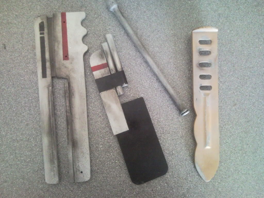

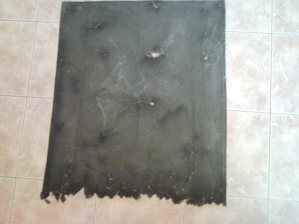

Firstly tho, with the incredably rubbish weather were having over here at the moment, theres not really much you can do. So ive basically been weathering the bits that I have. Firstly was my woodman cape, already weathered by the owner before me or possibly by woodman himself. I decided to add some darker areas so that they show up on photos and what not. Not to much, but enough to be noticable.
And then I decided to dirty up the shin tools, simply slapping paint on then rubbing off with a paper towel.

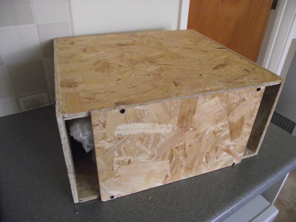

Well, had a knock on my door today. Opened it to find a struggling parcel force man carrying a huge crate.......yes crate.

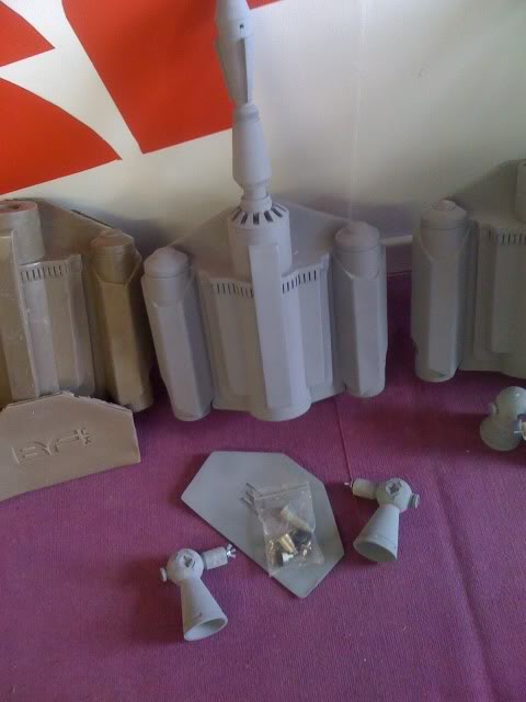

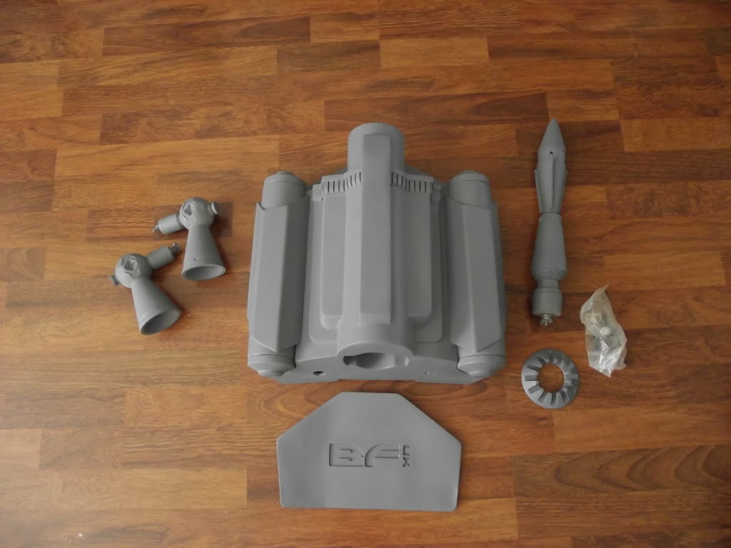

Wow boy, this thing was well packed, took me almost half hour to get the thing out of its box. And wow, I cannot describe how awesome the pack is, its also dawned on me the mammoth task it will take to paint this thing. All parts out of the box and laid out.

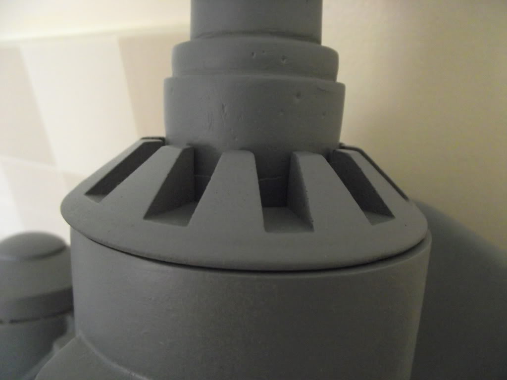

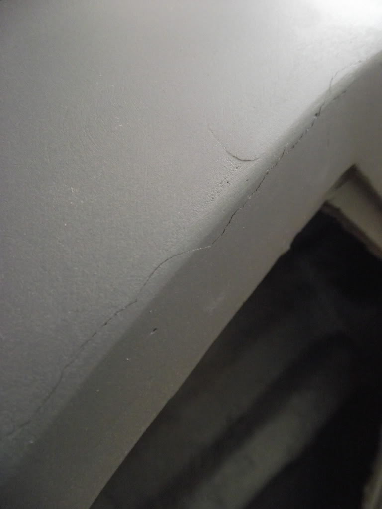

Upon further inspection, my heart dropped a little as I turned the pack over. A long crack ran down the back of the pack, actually two cracks, one on either side of the door. But ive been through this before with my gauntlets, so have enough experience with fiberglass to be able to fix this small problem.

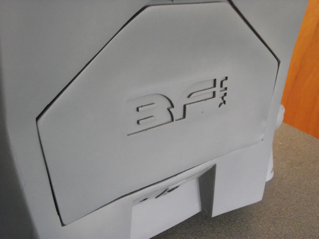

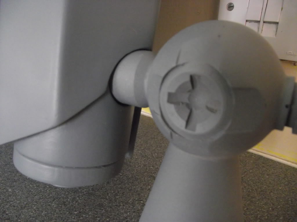

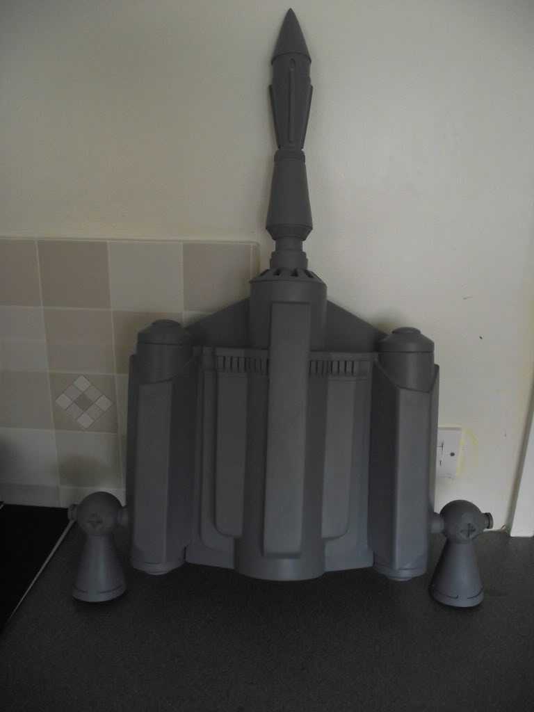

Anywhoo, what I then really wanted to see is what the assemble pack looked like. Now simple dosent describe how easy this pack is to put together, a couple of screws and nuts and.............

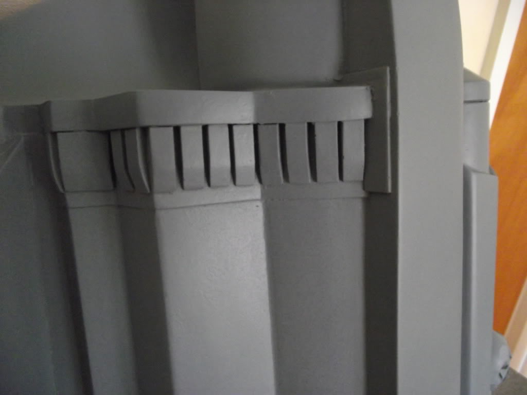

Now the pack is primered up and ready for paint, but me being so anal, wants to fill and sand some imperfections. The pack is an excellent cast, yet does have some small airbubbles and rough parts that I would like to see to.
But just take a look at the detail that this pack has :D
So, I will probs start prepping the pack now ready for paint, also goin to fiberglass the inside where those cracks are. But hopefully should start painting by the end of the week :D

Ah man, am gutted to see that damage on the JP. That looks like transit damage, almost as if something heavy pressed against the top of the JP... I wouldn't be surprised if they dropped the crate whilst delivering it.. Have you spoken to Rob about it yet?

No worries though Shiv, the gauntlets were ten times worse than the pack, hopefully goin out tommorow now to get some resin and matt. I sent Rob a messgae saying i got the pack and I mentioned the crack, but really there was nothing he could do about it anyway, stupid parcel force :angry

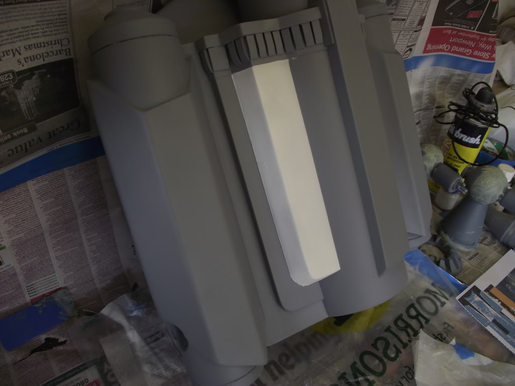

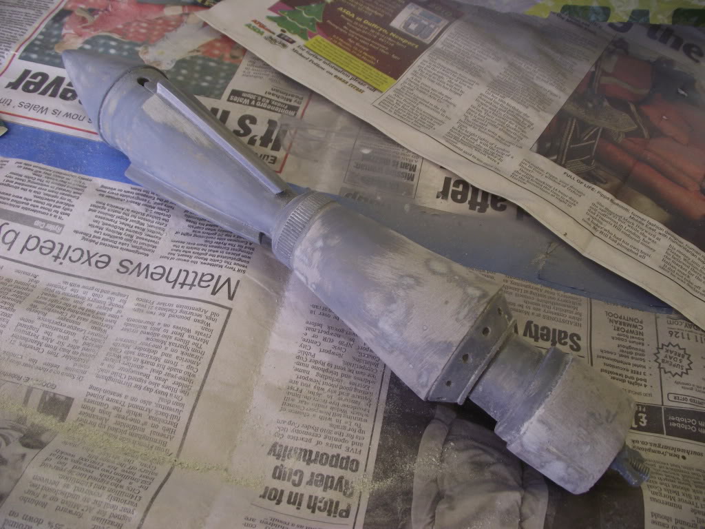

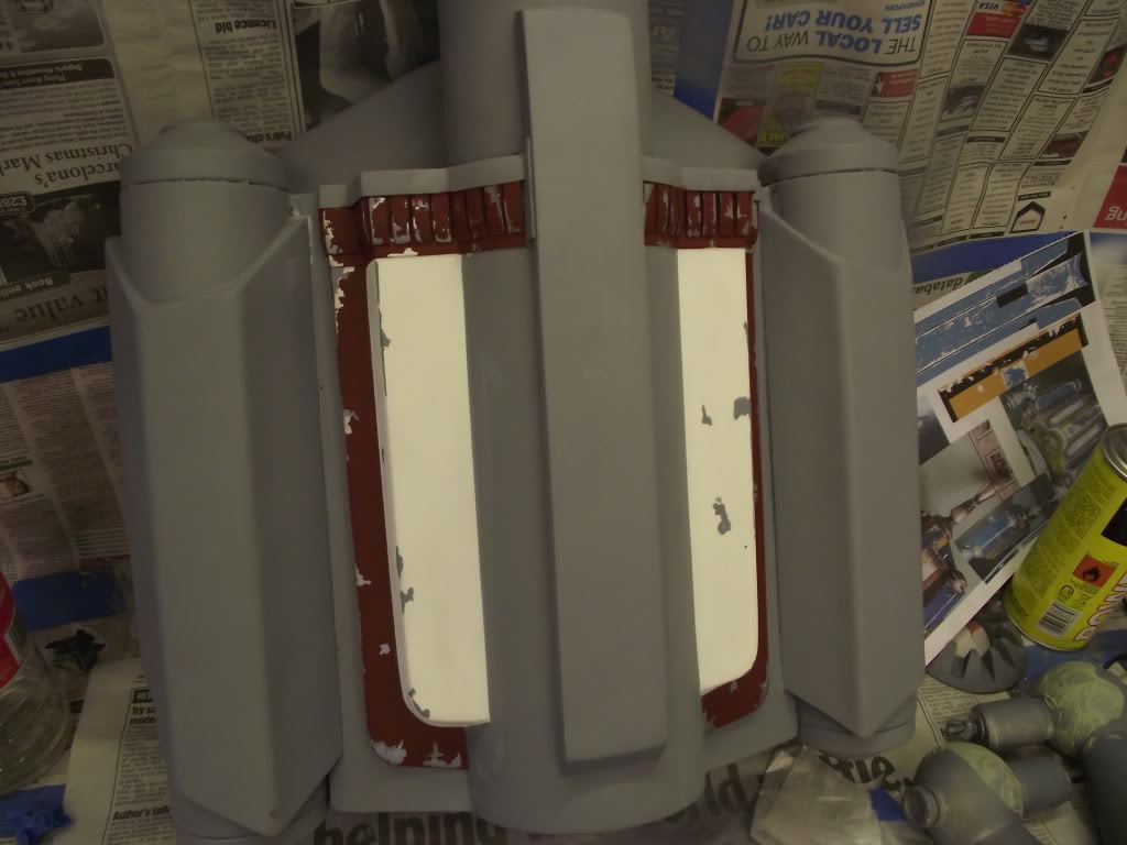

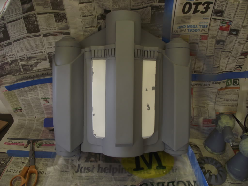

Now the betters stuff :) Right as I said I felt the jetpack needed some TLC, also it had 2 cracks, which later turned into about 8 after a good look. I didnt take no photos of me fiberglassing and filling all the cracks and holes, also it wasnt very nice to see the jetpack all sanded and scratched. I did get a picture of my cleaned up rocket. This is with all the holes and inperfections filled, just needs a wetsand, primer then ready for paint.

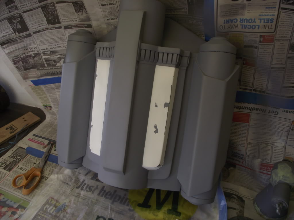

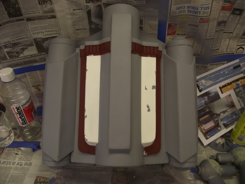

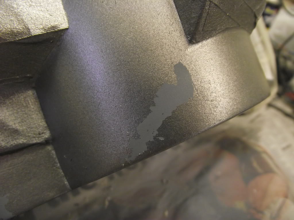

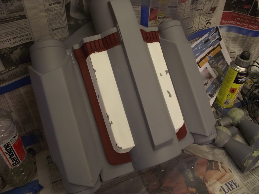

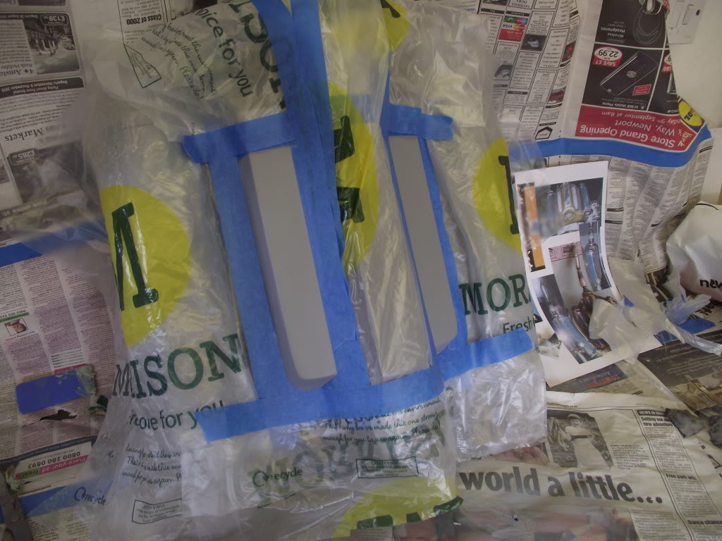

So i fixed all the cracks and holes in the pack, then hit it with some plastic primer. Then with some tape and plastic bags, masked around the area I wanted to paint.
Once painted, I waited an hour before carefully removing the tape and plastic bags. I had a little bit of paint bleed on both sections but nothing that a little paint and a brush cant fix.
I also applied masking fluid to parts, as looking at referance images, there seems to be some grey damage area on the white sections. I removed these with a rubber brush so as not to affect the finish of the white.
So theres my first steps into my jetpack paint up, im goin to mask it all off again though tommorow, hit it with some 1500 wet and dry paper then give it another spray of white as it dosent look as good as it does in the pictures. Hopefully then I can start on the red sections :D

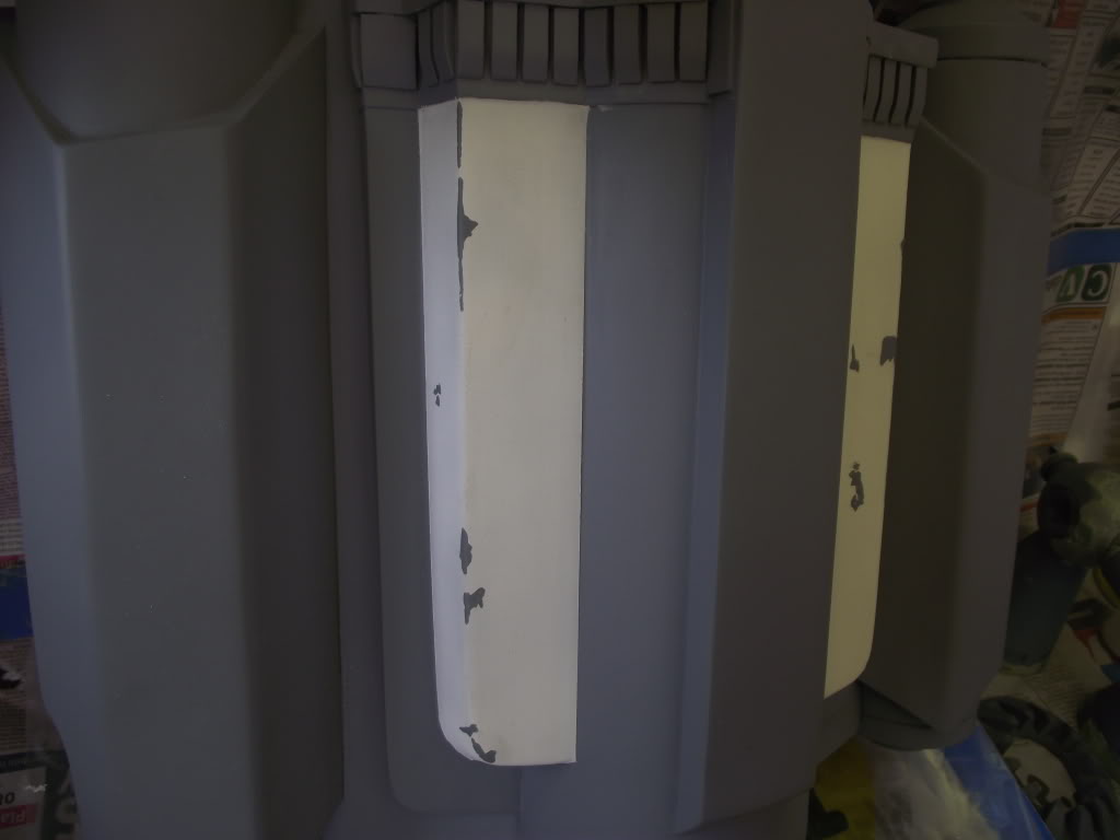

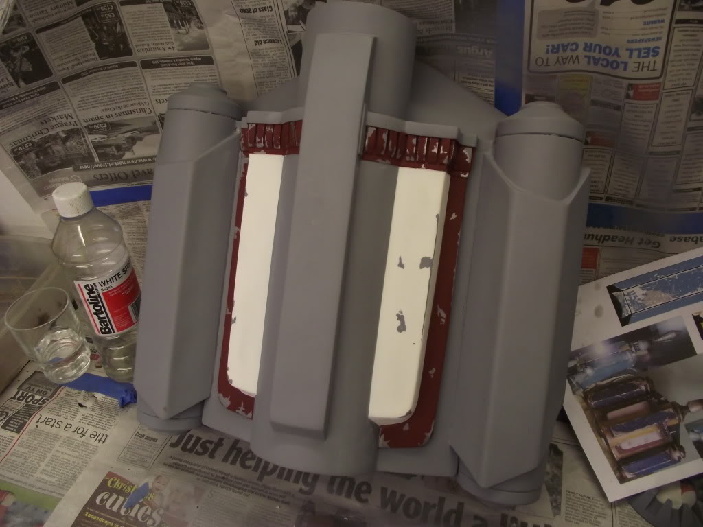

So, like I said I wasnt entirely happy with the finish of the white, I got some of the finest grade sandpaper I could, 1500, and give it a very light rub followed by another spray of white. I am now really happy with the finish of it now, no cracks or imperfections so sorted :D

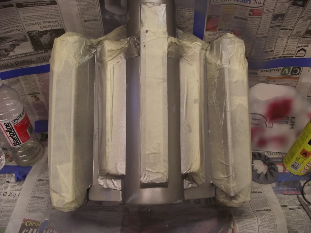

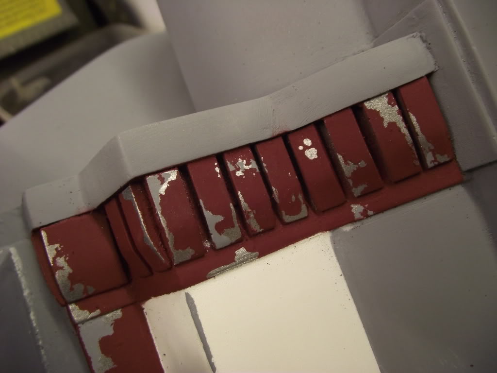

I then went on to the next layer the Red, I masked off the area I wanted, Sprayed grey, masked it off, sprayed silver, masked it off then I sprayed the red to get me this,
Then with a rubber brush, I gently removed the masking fluid to reveal the damage and scratches.

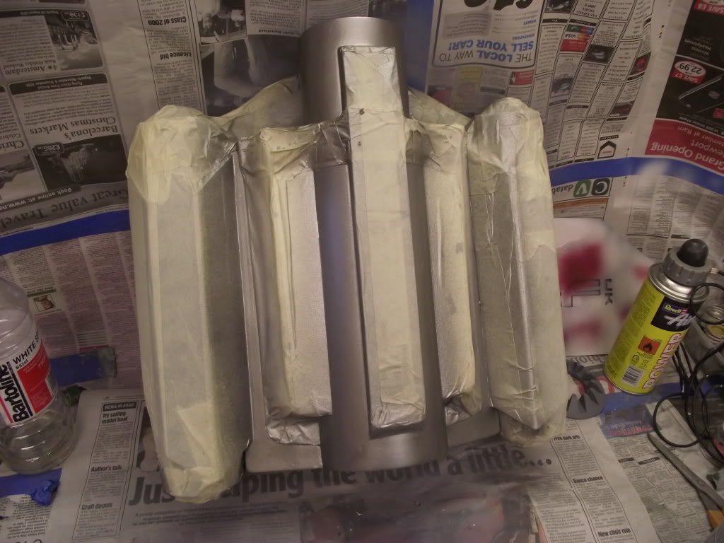

I then went onto the yellow sections, now this is the part when I started thinking to myself.....Why did I chose fett, I shoulda gone TK. Masking this took over an hour.
Once masked, I then sprayed grey and then masked the damage, followed by silver. I did spray a bit of the recommended yellow, but really couldnt get the finish right, so im out tomorrow to purchase a rattle can of the same yellow.
So hopefully I can get the yellow put down tomorrow and remove the tape to see if its all okay, the maybe hit it with the 1500 sand paper to dull it down a bit.
