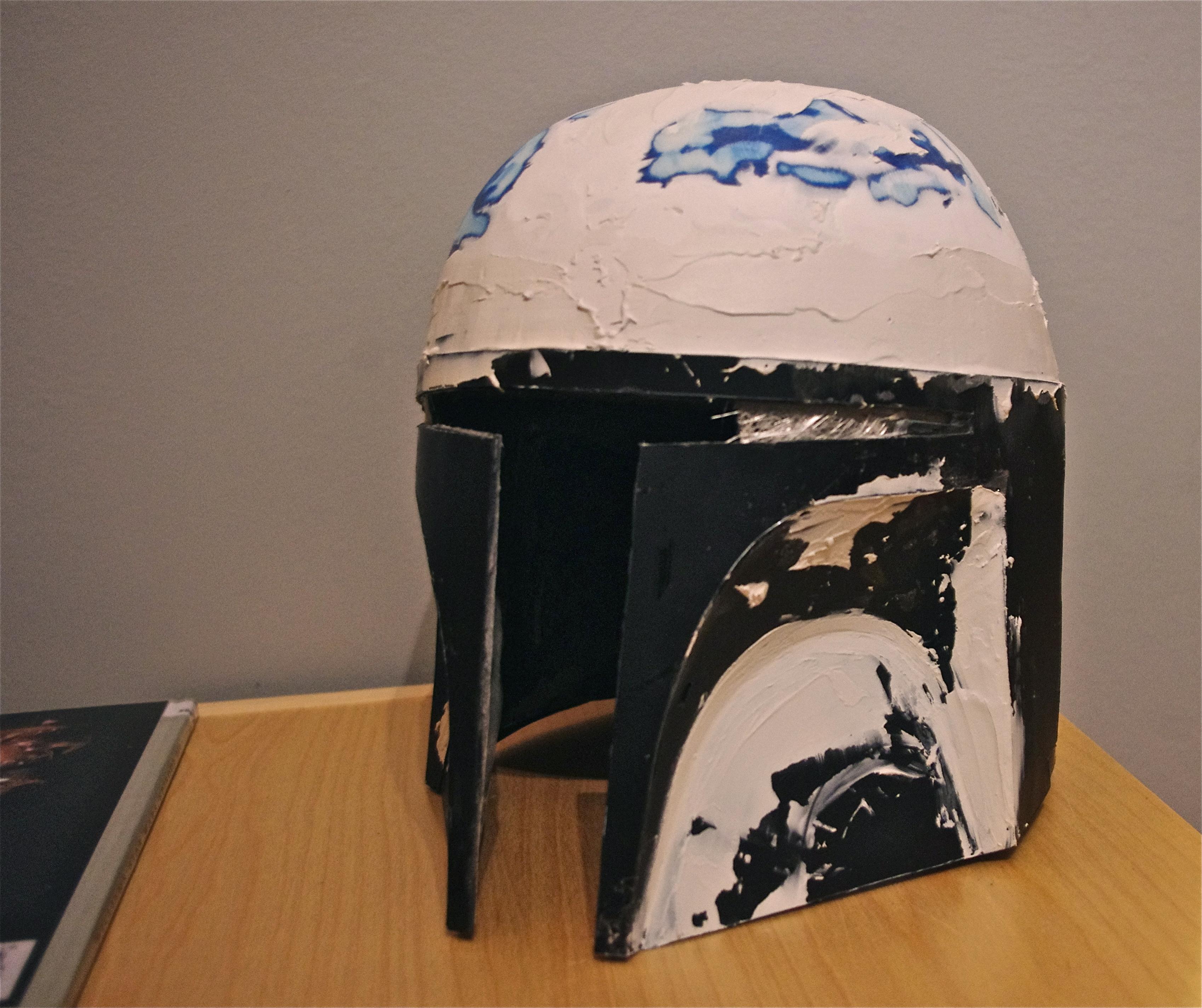

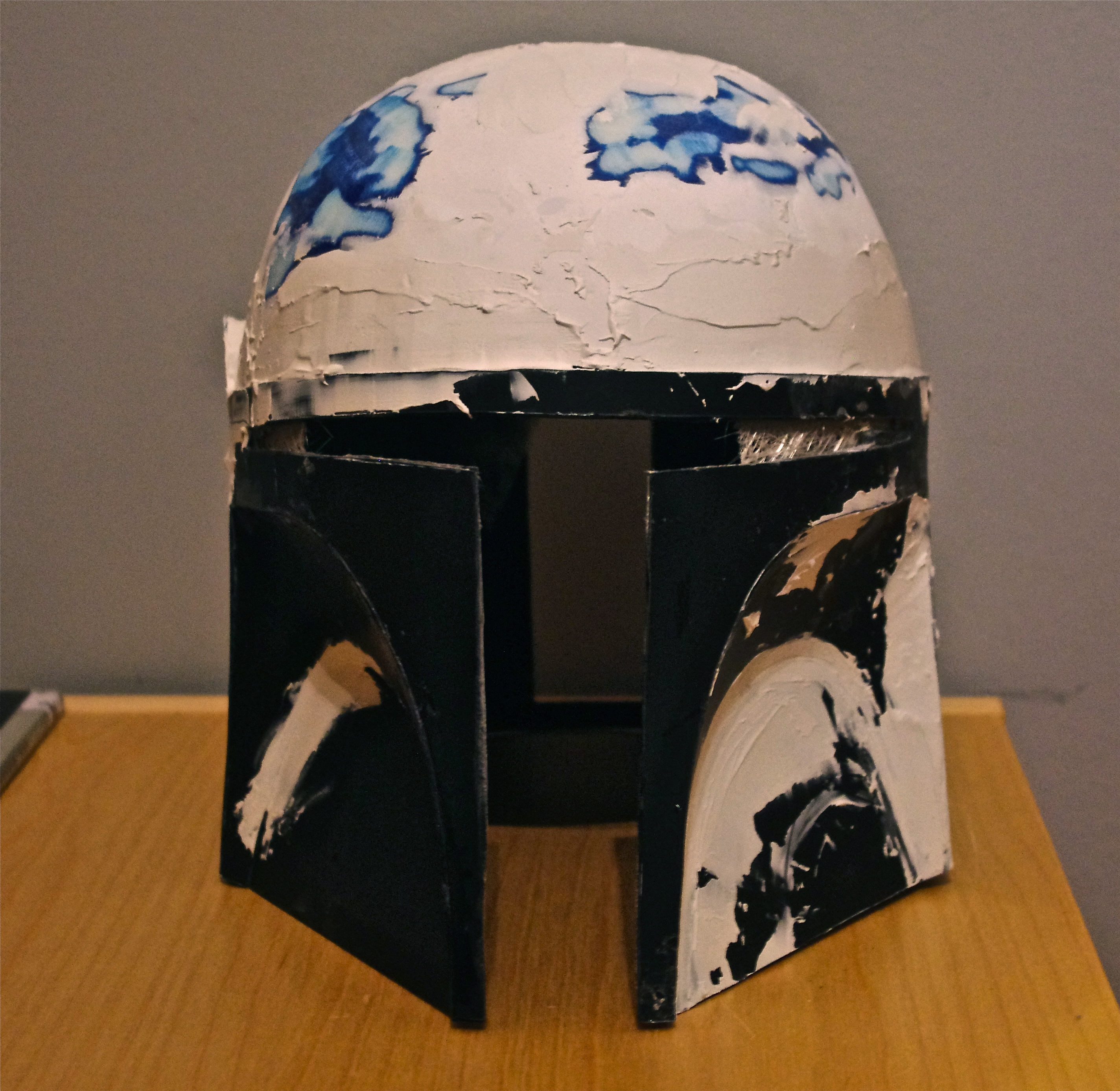

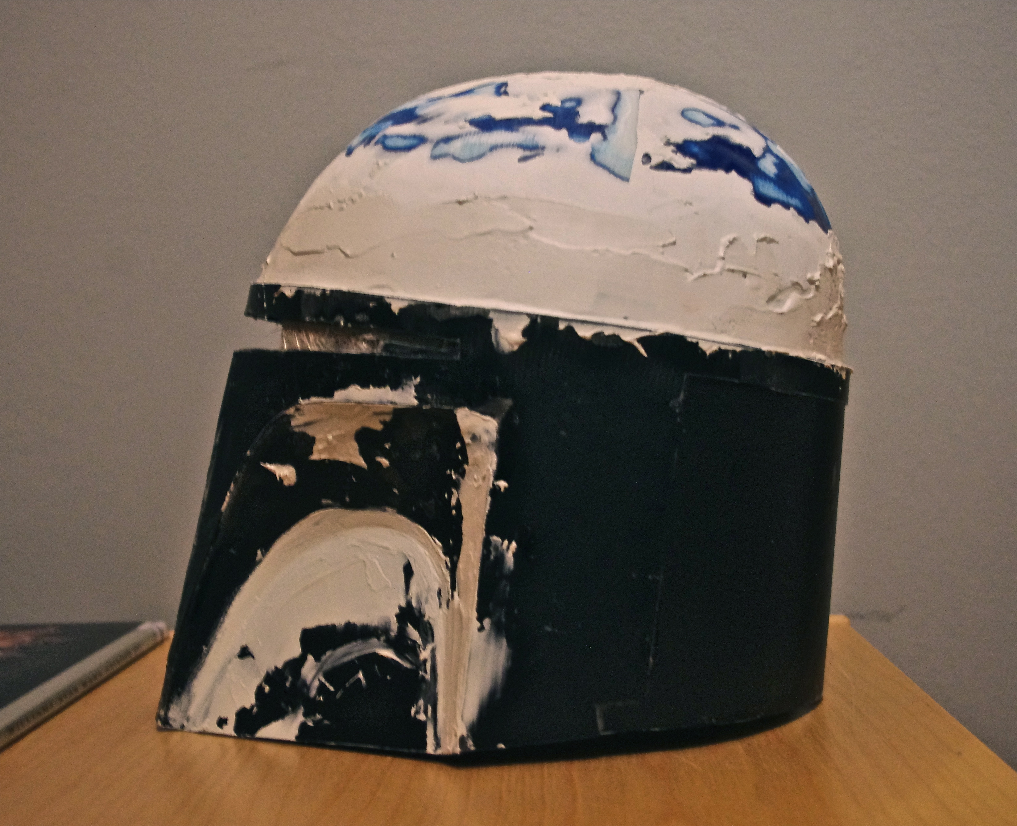

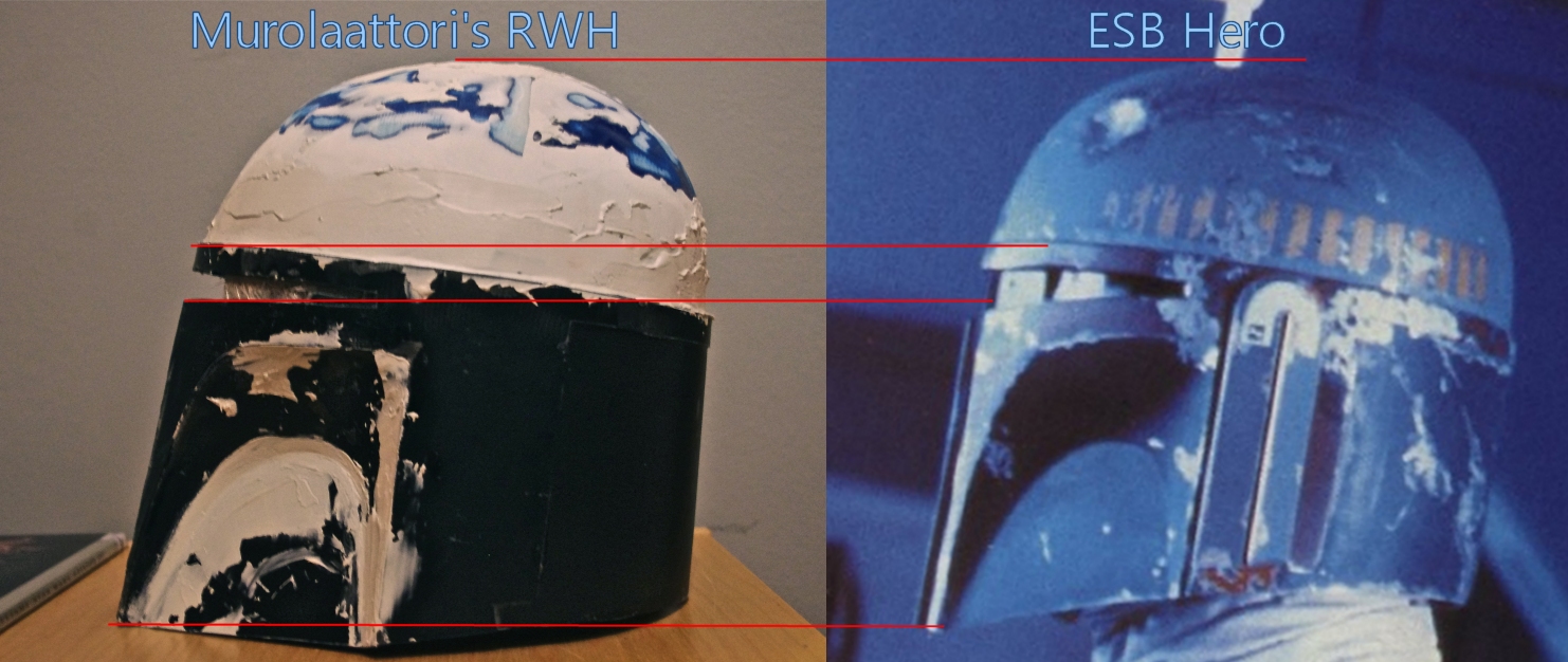

This is my third attempt at a bucket and I thought I needed some expert opinions on the helmets current state. I used a skating bucket as the base for the dome and the rest of the helmet is made from black polystyrene using Rafal Fett's incredible templates.
I noticed it was a big mistake to use black polystyrene because it is very hard to make any markings on it. But that is what I had to go with because that was all the local store had. But don't you make the same mistake!
So, anyhow, what do you think about the dome shape at the moment? It is not nearly finished shape yet. And also, do you think the helmet is wide enough or is the lower part of the helmet too long/tall compared to the dome? I know that it will seem whole lotta wider when I add the ears but it's hard to compare it with the pictures of boba with ears.
It seems that you have done an excellent job so far with my templates. Looking at the helmet I can say that the dome is OK and I did a quick compare with the ESB Hero helmet:
For the black polystyrene you can use a silver pen to draw all the marks you need. Keep up the good work!

Based on your pictures it seems pretty spot on, maybe I should add a little to the backside of the helmet and seems like the dome has a little semi-flat spot on the top.

The dome looks a little too sloped back at the forehead, you can see it best in raffs comparison pics, but other than that it looks good!

Thanks! You are right, it is a little bit too sloped! Man this thing is starting to get heavy with all the putty.

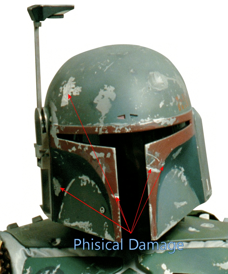

While I'm at it, is there any map for the various scratches and markings on boba's bucket? I mean the physical not the painted ones? Or should I just look at the GMH helmet for the physical damage?

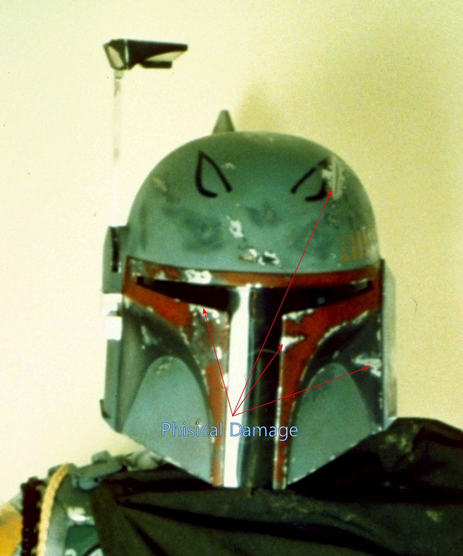

It depends which version you want. The Pre-Pro #1, Pre-Pro #3 and the ESB has similar phisical damage, except that the Pre-Pro #1 has no dent, but a big slash like scratch on the top left of the dome:

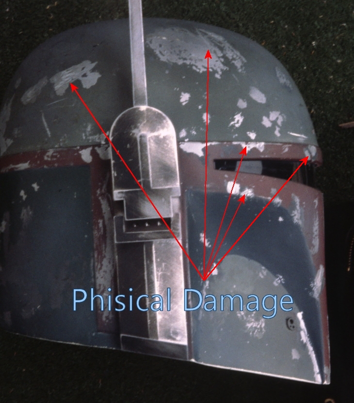

On the ROTJ helmet are more scratch like phisical damages:

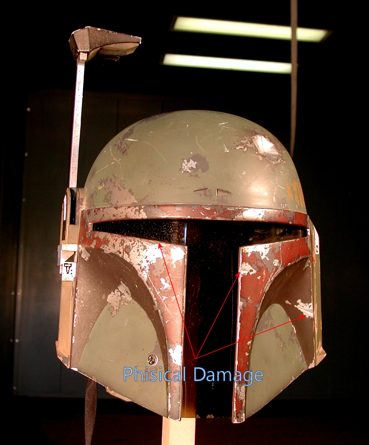

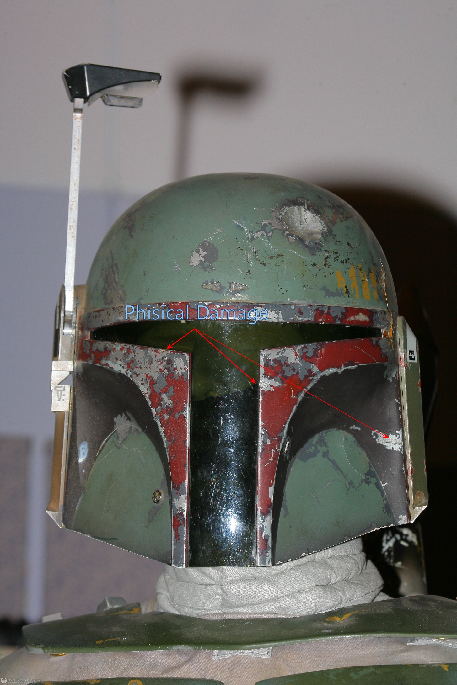

The Pre-Pro #2 (and the GMH, which is a casted PP2 helmet) had the same scratch like marks, but in different places:

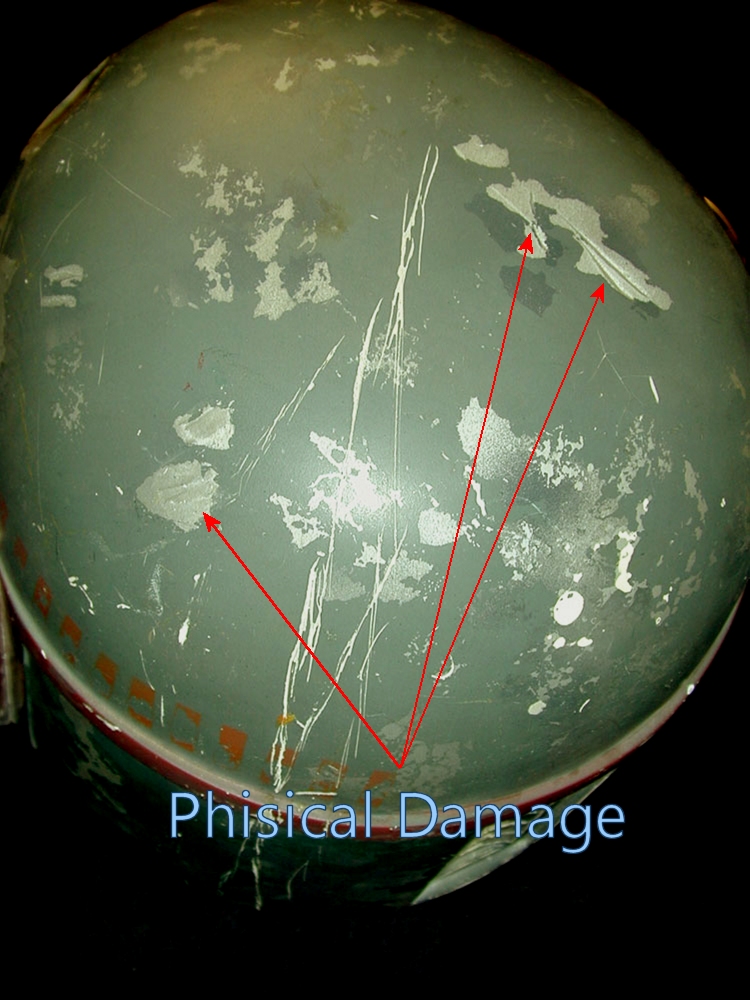

The Sandy too has multiple scratches:

Thank you! That is very useful info! My favourite color scheme is the ESB so I think I will go with that. It doesn't appear to have that much physical damage so that should be easy.
