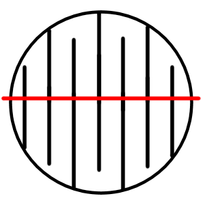

Hi SkylaFett,
Hmmm...looks like you might've short circuited the control pads. My advice is to follow what Pilot posted on post #52 and make a cut in the middle of the control pad to disconnect the contacts and avoid short circuiting the pad itself. Good luck and I hope this helps!:)

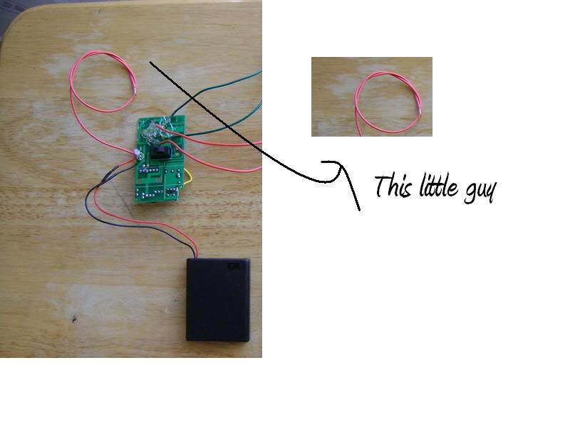

EDIT: Sorry, it seems I have another question. The picture in which the ensamble is completed: what is the red wire on the remote circuit board for, the one to the right of the wires leading to the AAA box?
A pic for additional explanation:

For the red wire that you pointed out, that is the antenna wire coming from the transmitter board. I had to solder a longer one so I can get more range with it.

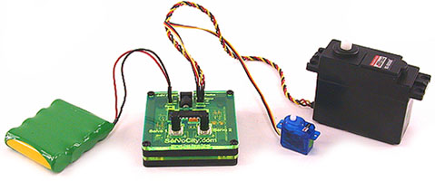

Thanks for the compliment! Yes, you can do something along the lines of hard wiring the entire system or connect the switch directly to your helmet. I actually have a dual servo driver that I was tinkering with and I believe that attaching your RF servo will work great with it. The best thing about it is that you don't have to modify the servo, all you have to do is connect it to the board and give it a power supply and your done! Here is a pic of it. It has two potentiometer knobs, one for each servo and the servo will actuate as fast or as slow as you can turn the knobs. This is available HERE. Hope this helps a bit!
Nice driver board indeed. If the pots can be replaced with a switch then it would be great!

Just been looking into it the board can be customised to take an external pot/switch, not something they sell but would have to be swapped out. meaning the driver could stay in the helmet and a small switch down on the guantlet, would just need a wire stitched in the suit and power from the helmet fan batteries. Down side is the wire comming out the helmet:facepalm
The board is showing the capability for a remote pot, so it will probably handle a remote switch also. Just run the switch to your gaunt and the wire to your helmet.
