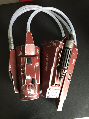

I cant really take any credit for the gauntlets, I bought them from Hames13. The only thing I did here was soak the hoses in coffee for a week and I added a functioning LED on the left gauntlet. I added some key ring rings to the end of the hoses so the can clip into the sleeve of my Arkady flight suit

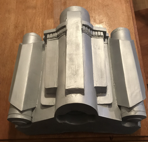

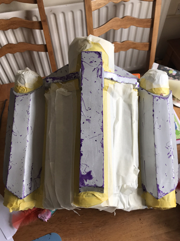

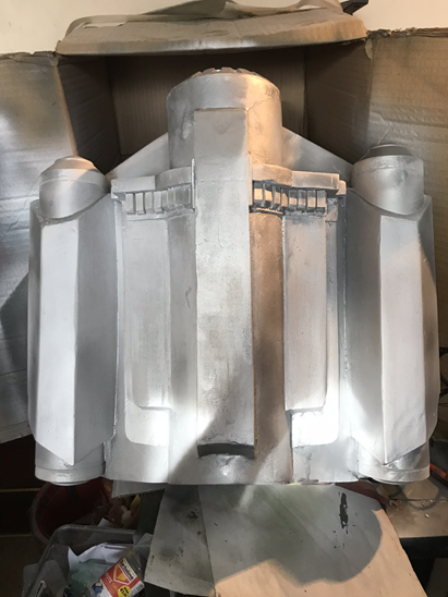

The jetpack was heavily influenced by the Terminal Fettler build. I primed the jetpack with a grey Halfords primer. After that I airbrushed the pack with Humbrol 11 Metallic Silver.

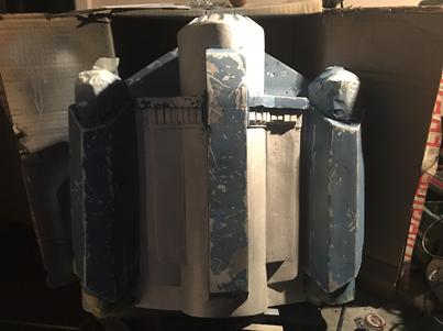

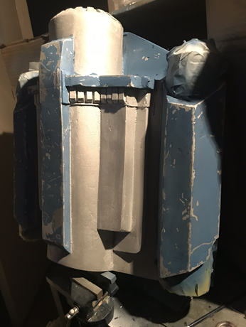

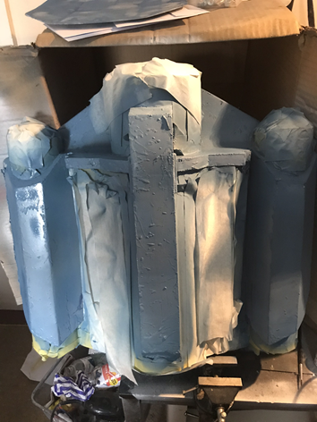

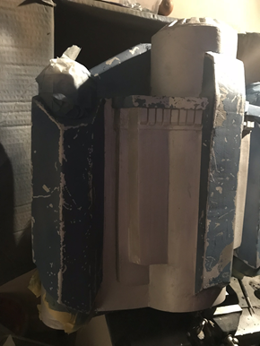

I masked everything up and used Maskol to cover the silver damage. I used Terminal Fettlers guide on this where it came to damage. After that I used Humbrol 109 for the blue areas
I added a little Humbrol 78 which is a grey colour as well to the pack. Forgot to take a picture of the grey areas but you will see it when the maskol and tape is off
Peeled off the masking tape and the maskol

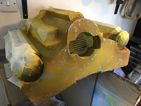

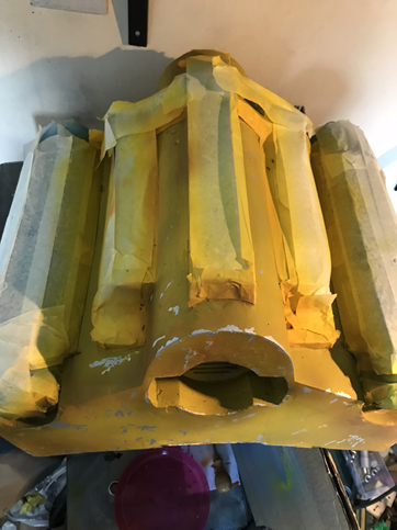

More masking tape and more maskol. This time on the yellow areas. I used Humbrol 154 for this part of the jetpack. When I peeled off the tape and maskol I used a little humbrol 62 which is a brown colour. I used this very lightly at the bottom of the pack

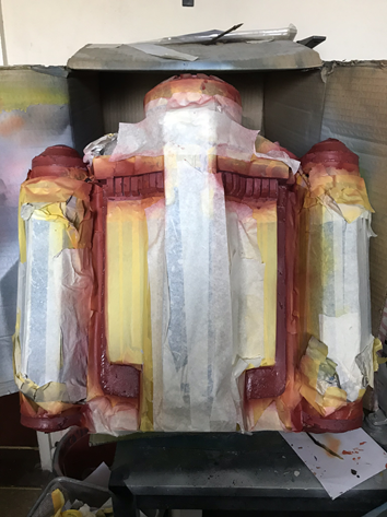

Masked up again and painted the parts near the tank white which was Humbrol 33 (forgot to take a photo). Once that was done, masked up again and painted the final colour which was red. I used Humbrol 73.

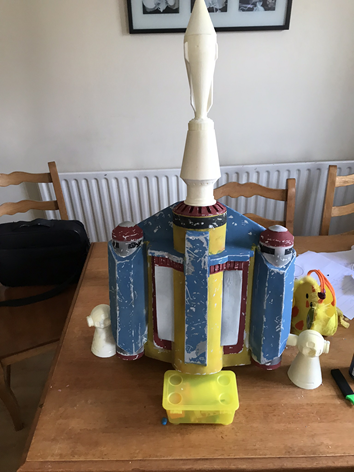

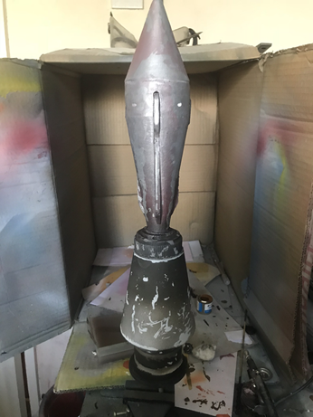

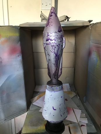

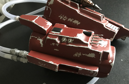

Time to sort out the rocket. Primed everything as usual. Painted the top part of the rocket Humbrol 11. Used maskol to highlight the damage. On the bottom half of the rocket I used Humbrol white 34. Again used the maskol to highlight the damage.
I could get my hands on a translucent red from Humbrol anywhere. Everywhere was out of stock. So I used a very thinned Humbrol 73 red for the tip of the rocket. Light at the top and darkened as I went down.
On the bottom part of the rocket I used Humbrol black 33. Heavy at the top and light at the bottom. I also used a light misting of brown 62

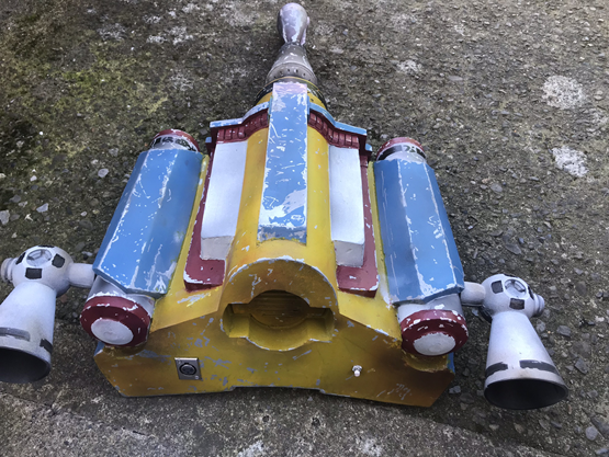

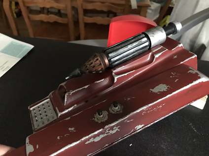

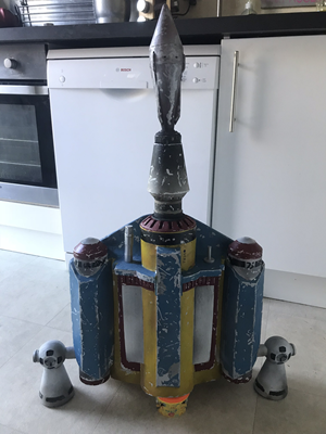

Almost finished. I added the greeblies to the bottom of the pack
The only thing Im unsure of is the thrusters. Any opinions Should the round centres be black or red?
Added to the greeblies at the top.
I still have some weathering to do but that the jetpack more or less finished
