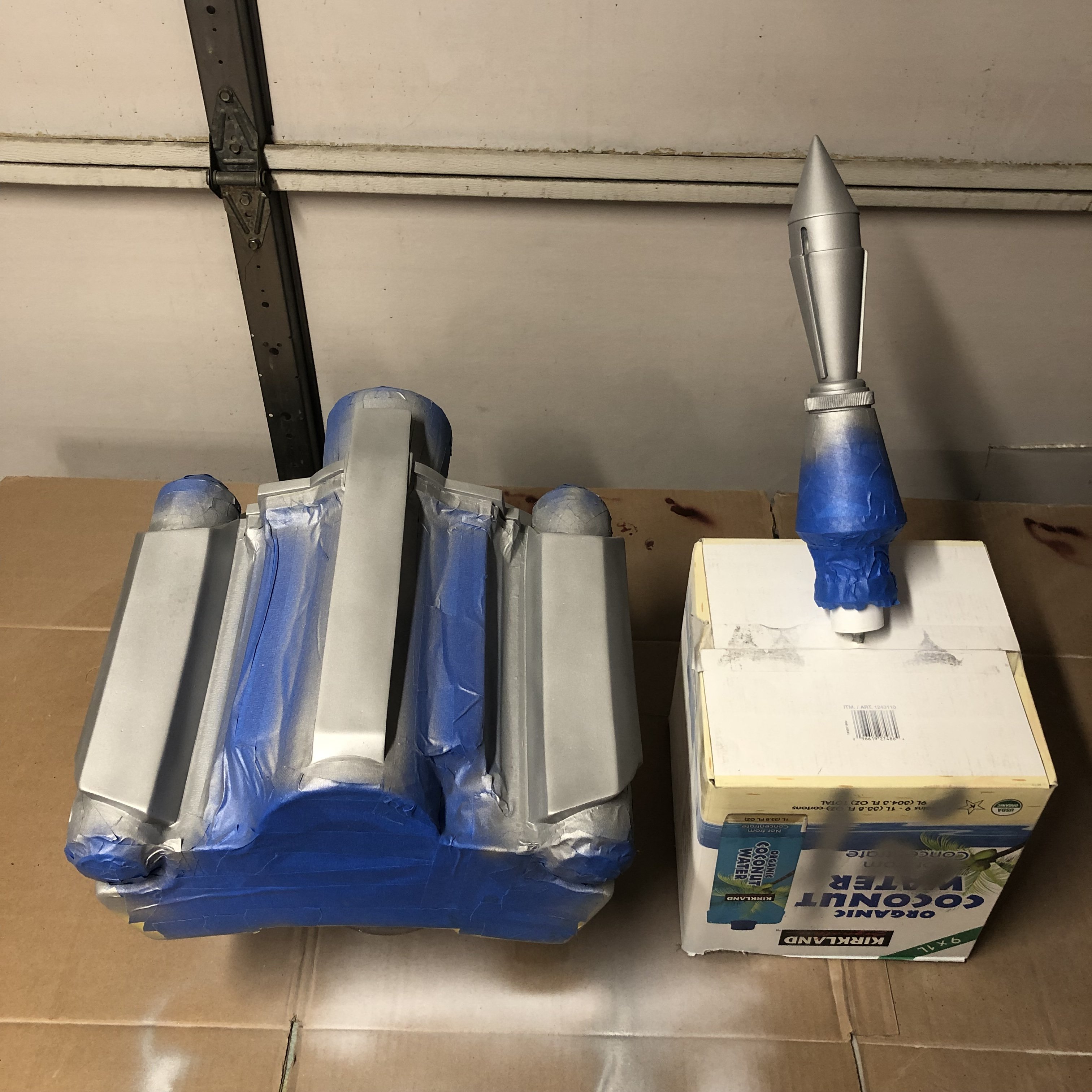

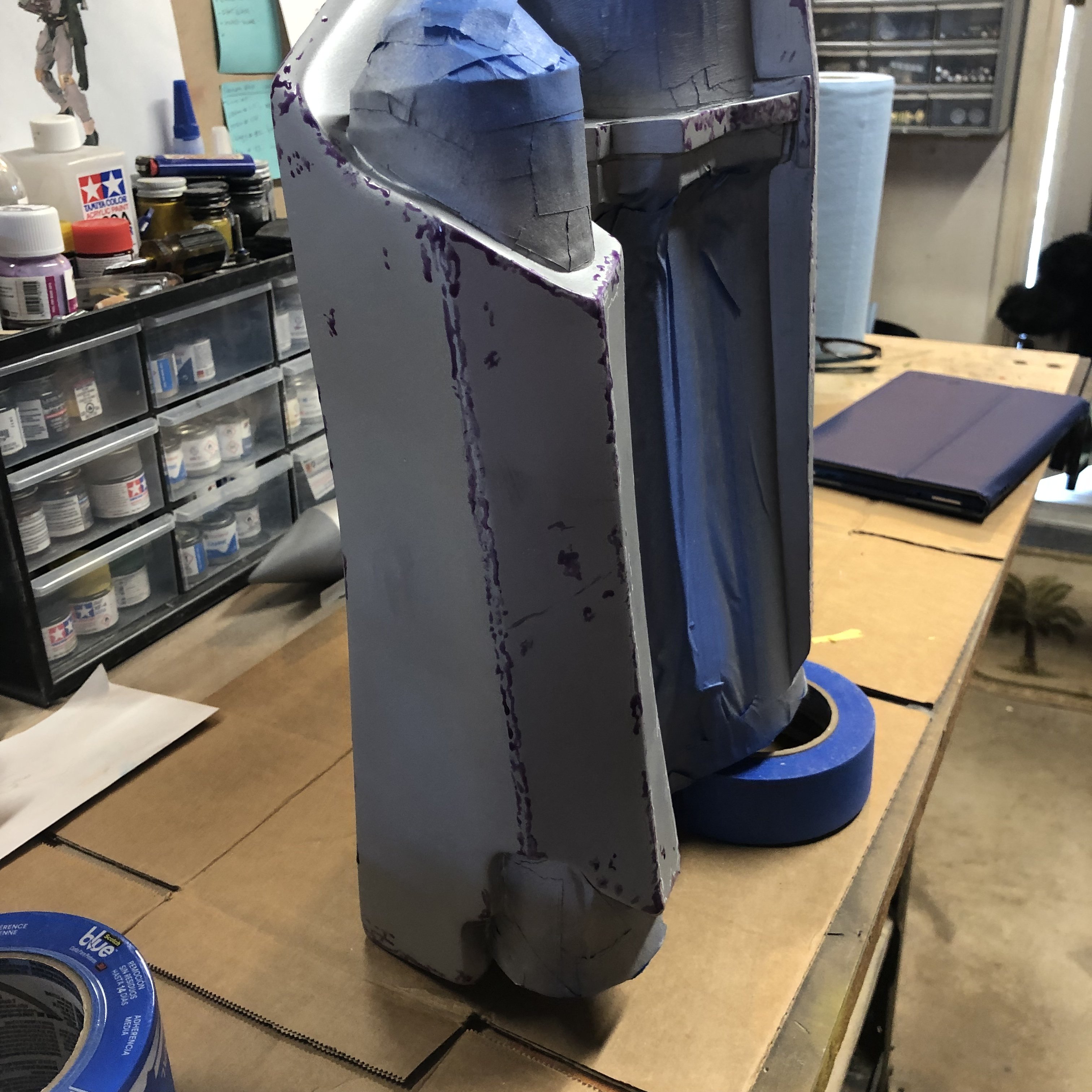

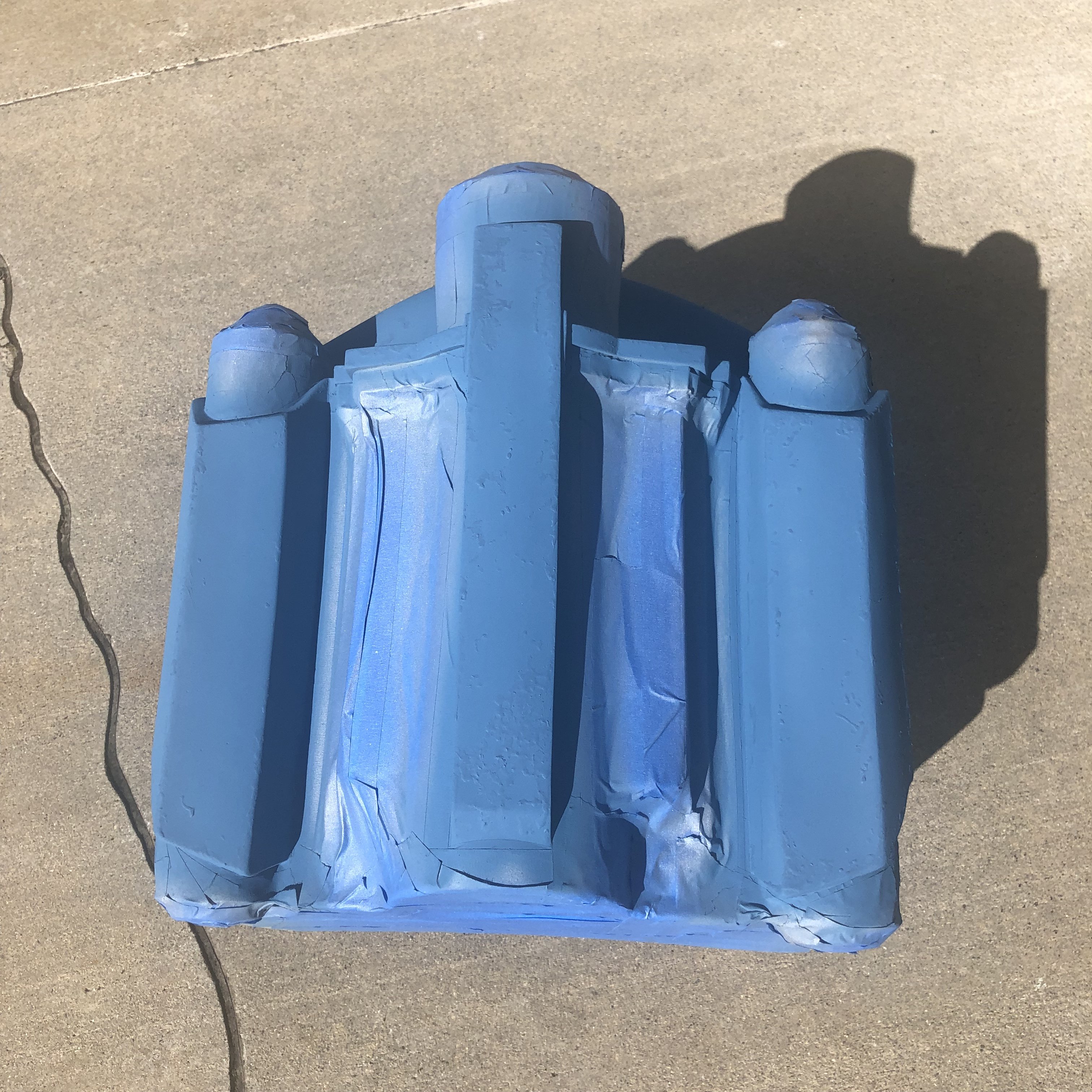

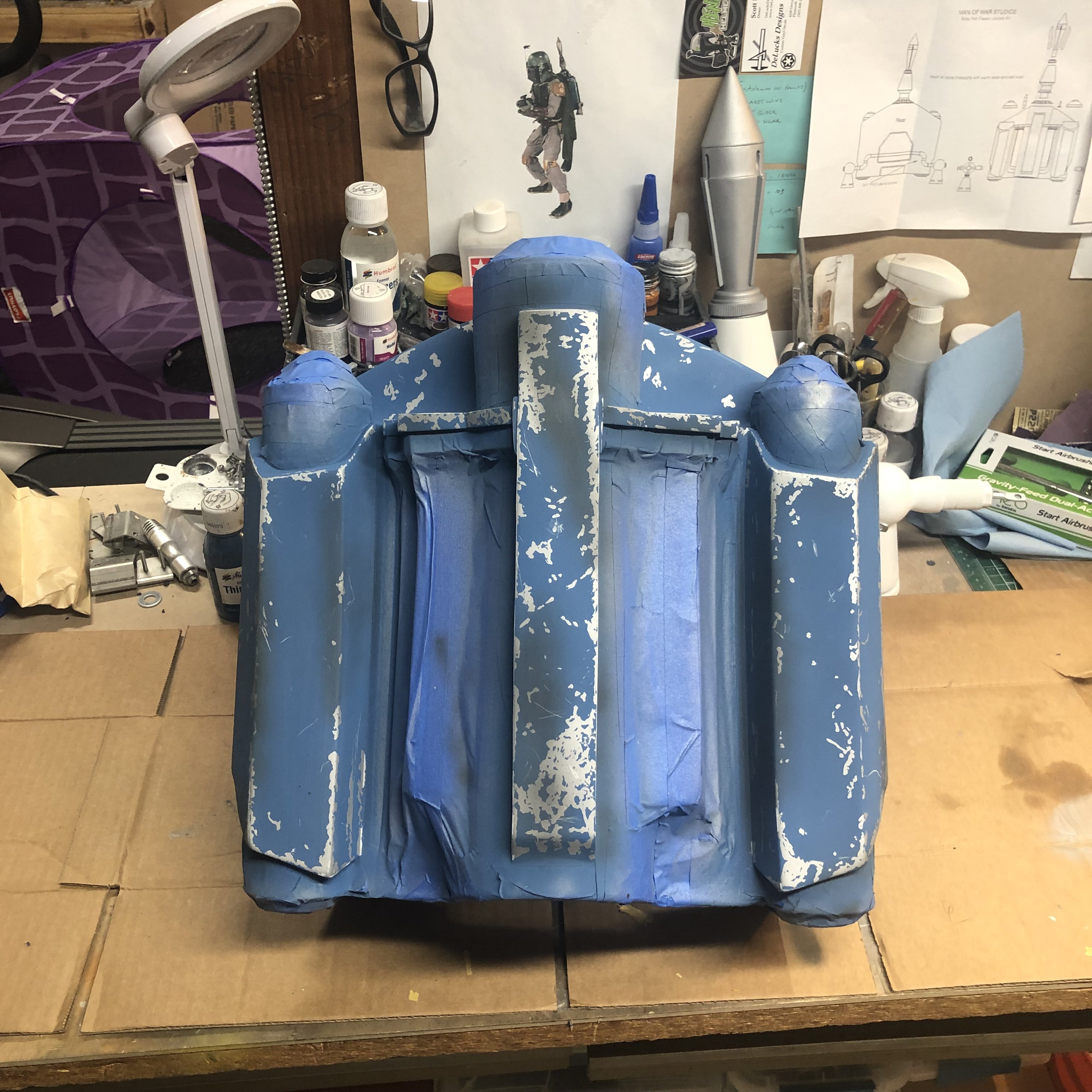

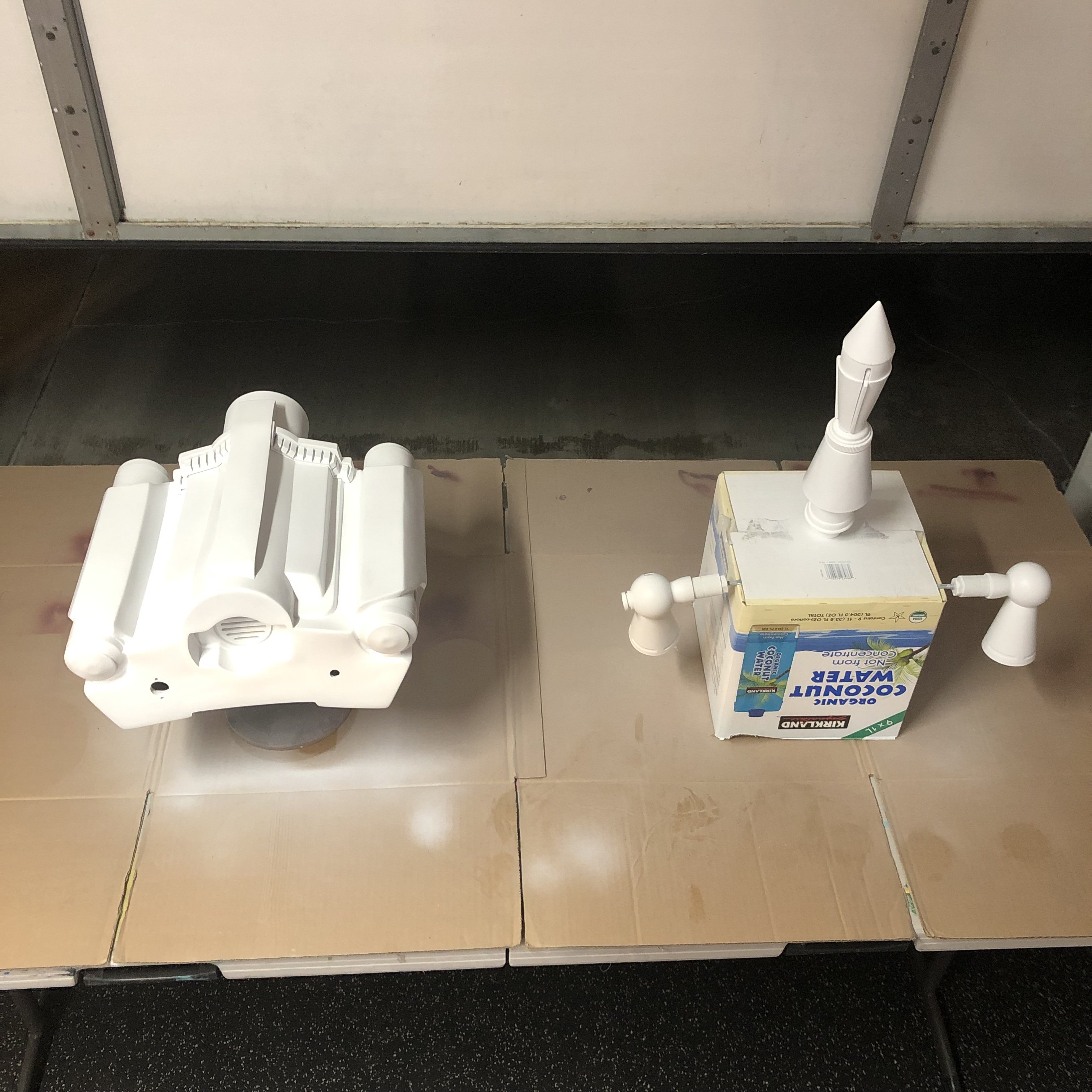

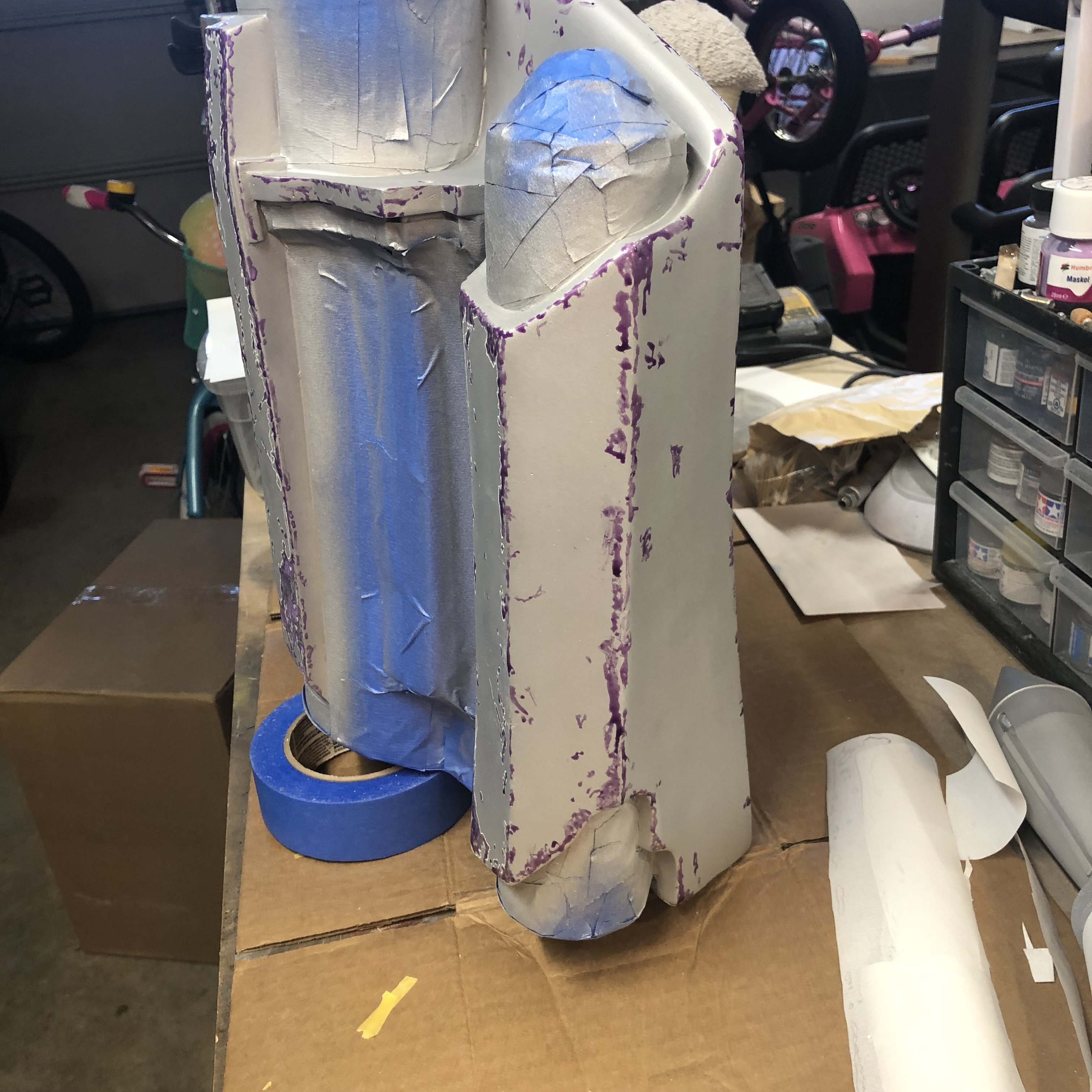

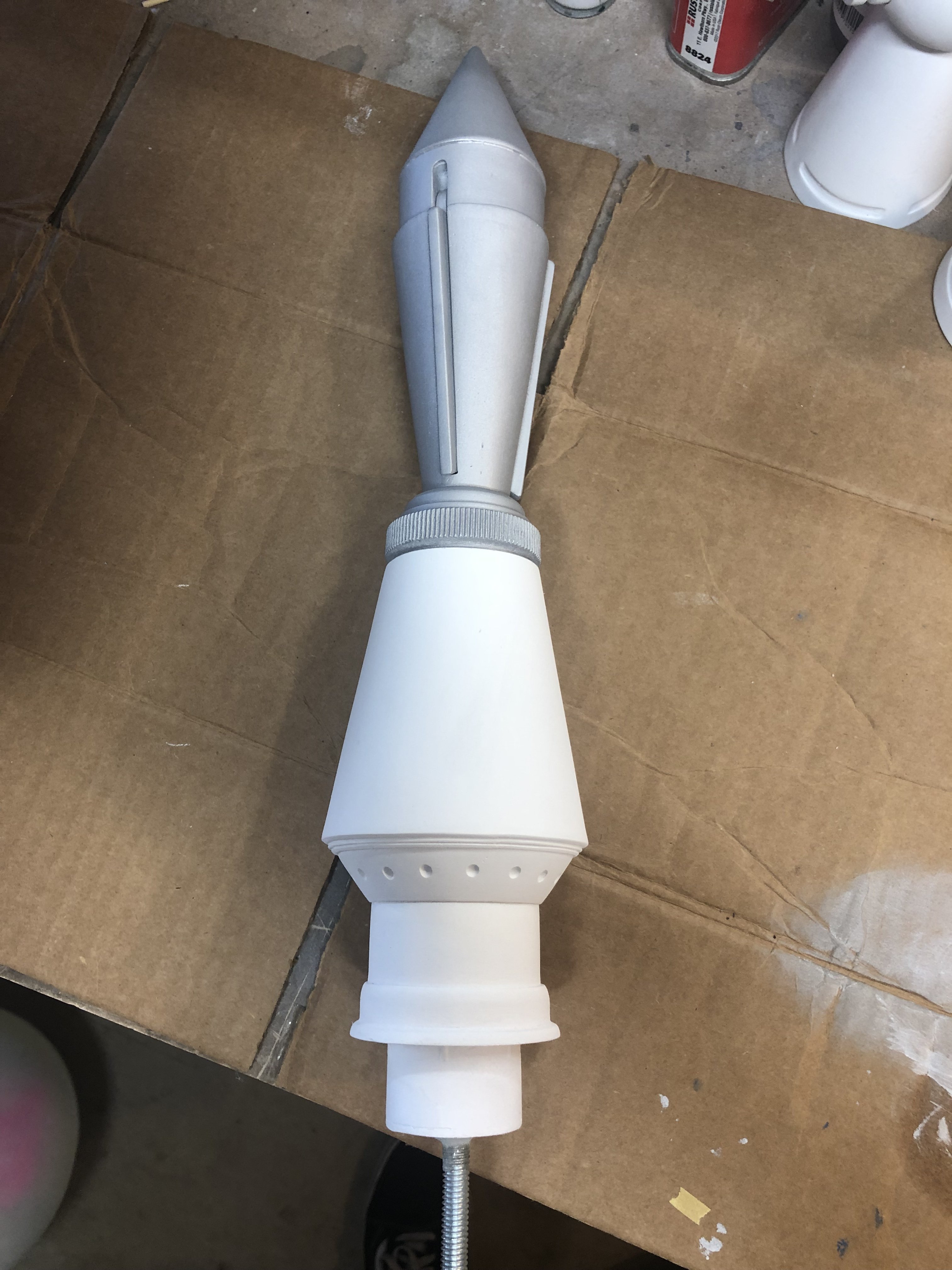

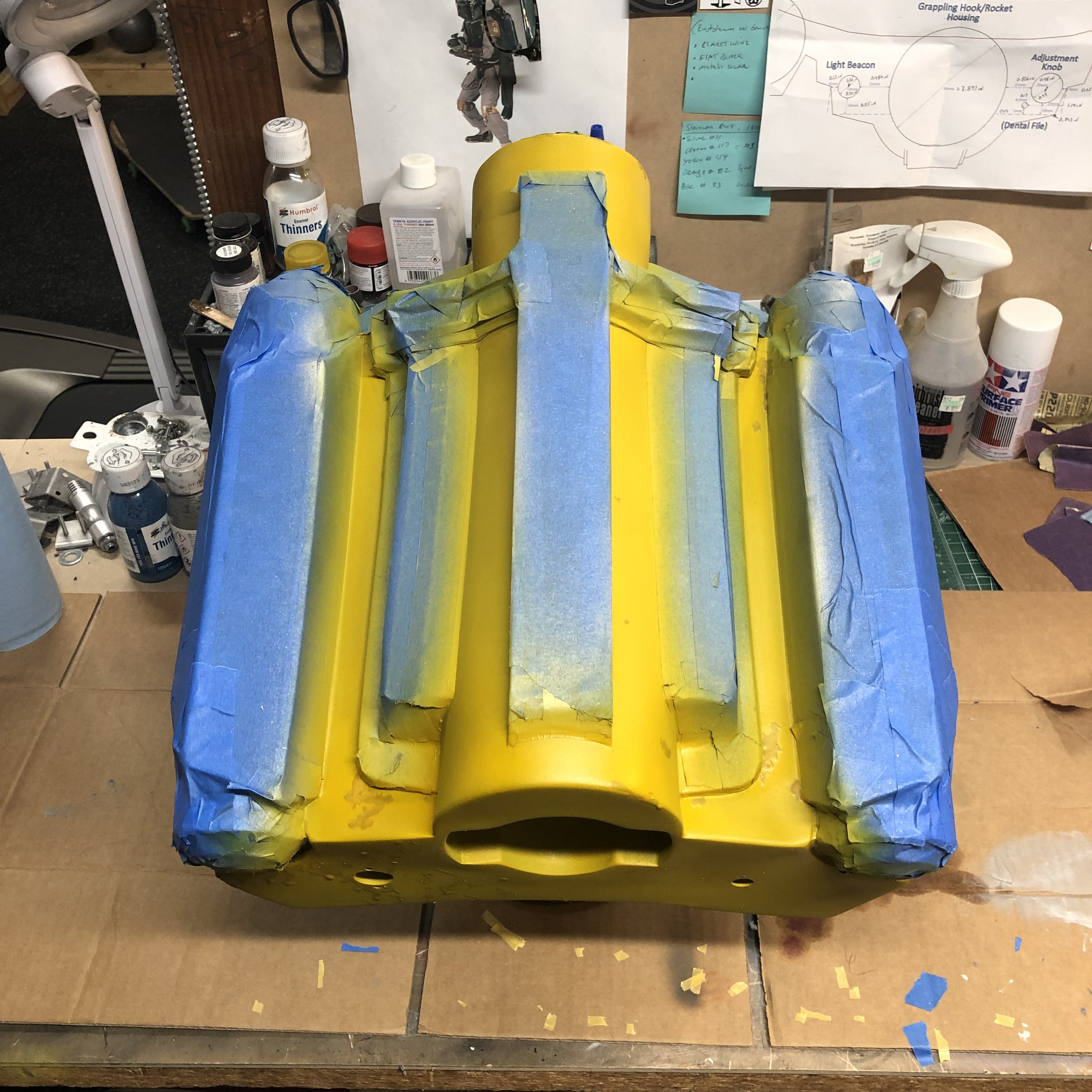

Update on my Jetpack. Got it primed in white. Masked off the first sections. Airbrushed the silver 11. Applied the silver damage to the pack. Airbrushed 3 coats of blue 109. Also painted silver 11 on the top section of the rocket and white 34 on the bottom. Let this dry and proceed to the next colors yellow and translucent red for the rocket.
I did both eyeball and DVH’s stencil. I am using Terminal Fettlers paint list from his Finished! Bobamaker Jet pack ROTJ se paint up WIP. He used white primer. There are elements of white in the damage that will show through after I put in some scratches.

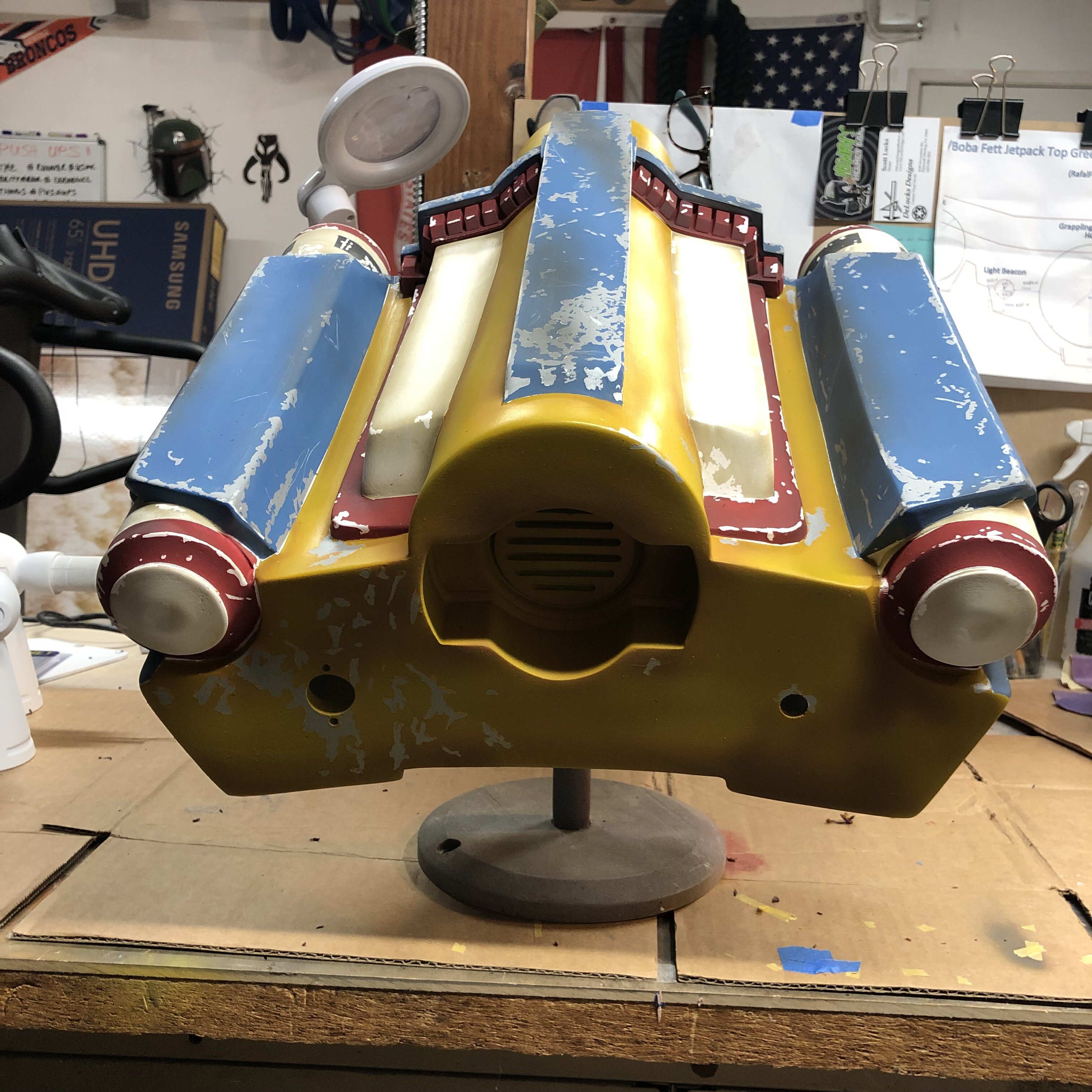

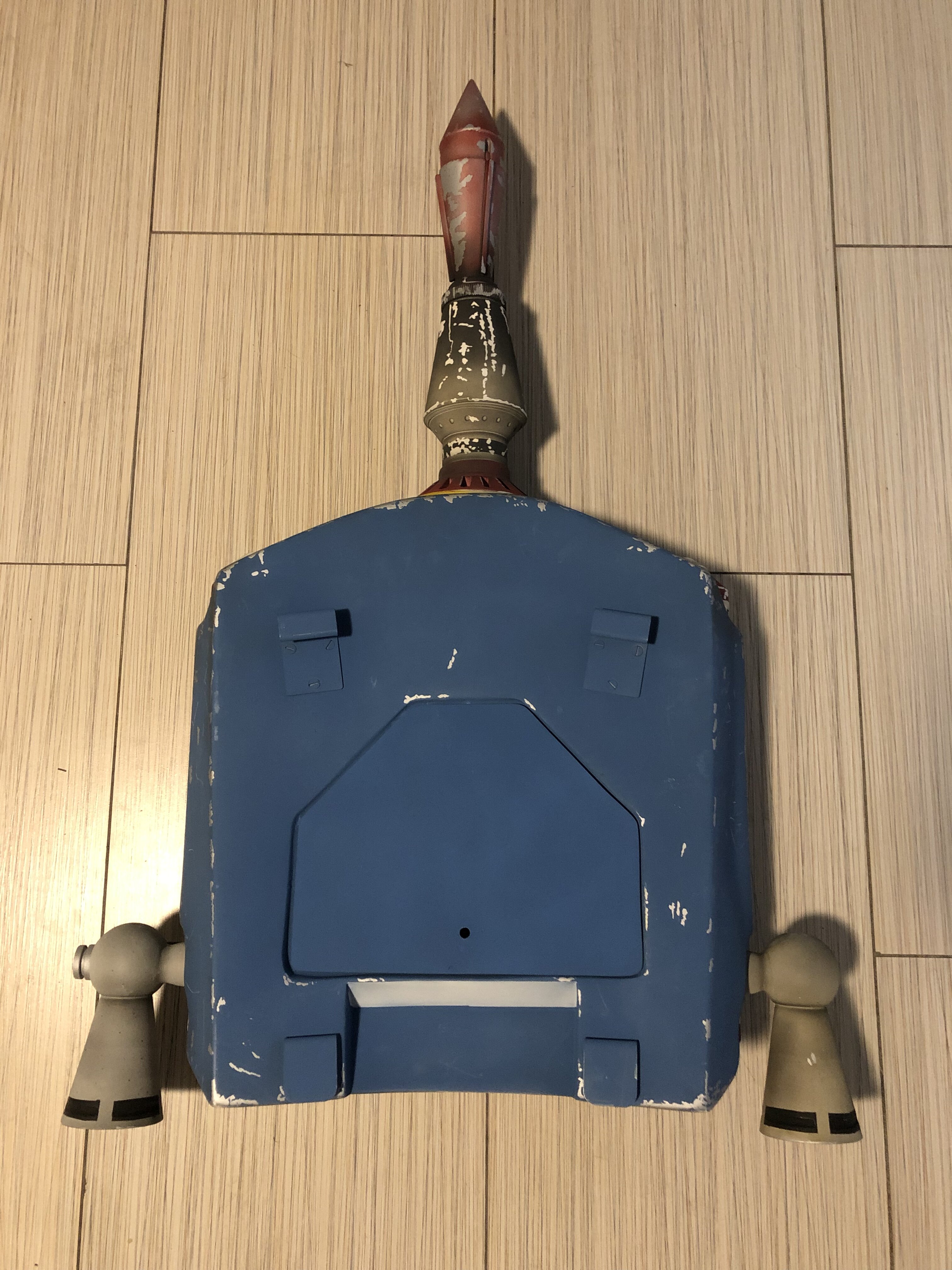

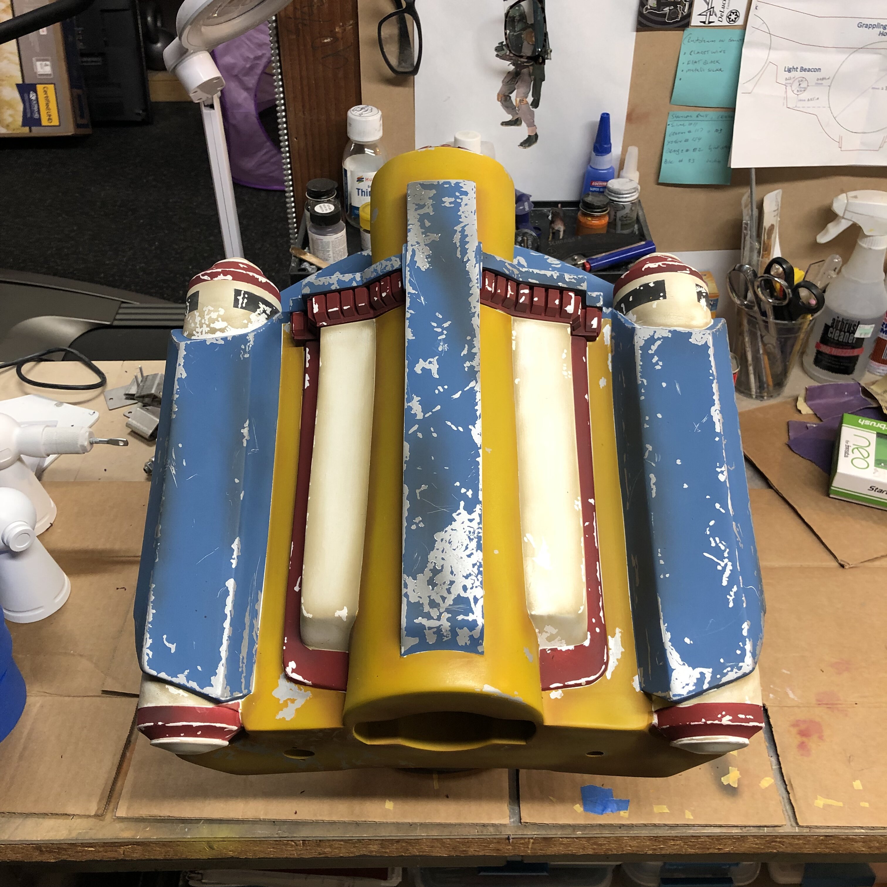

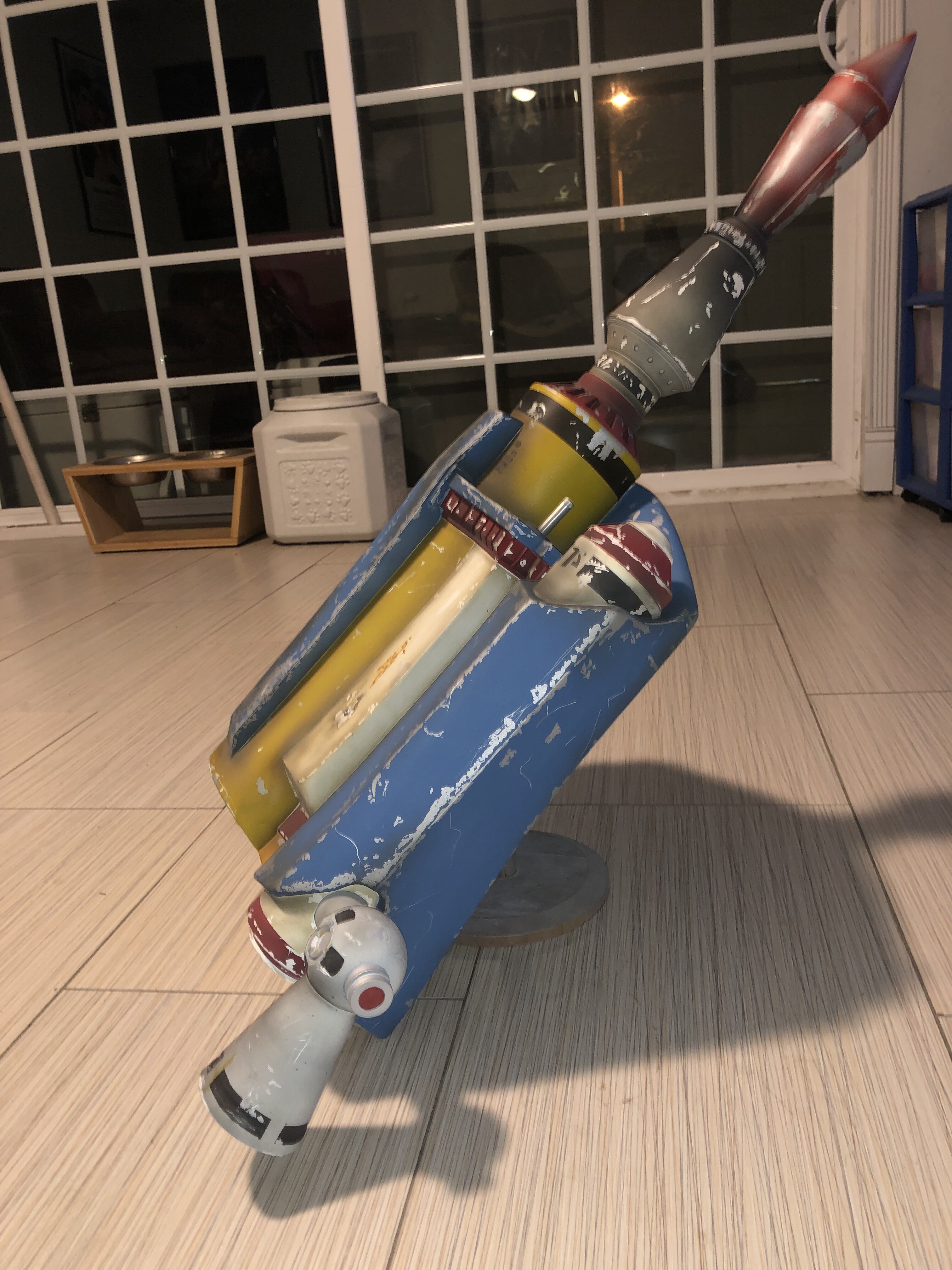

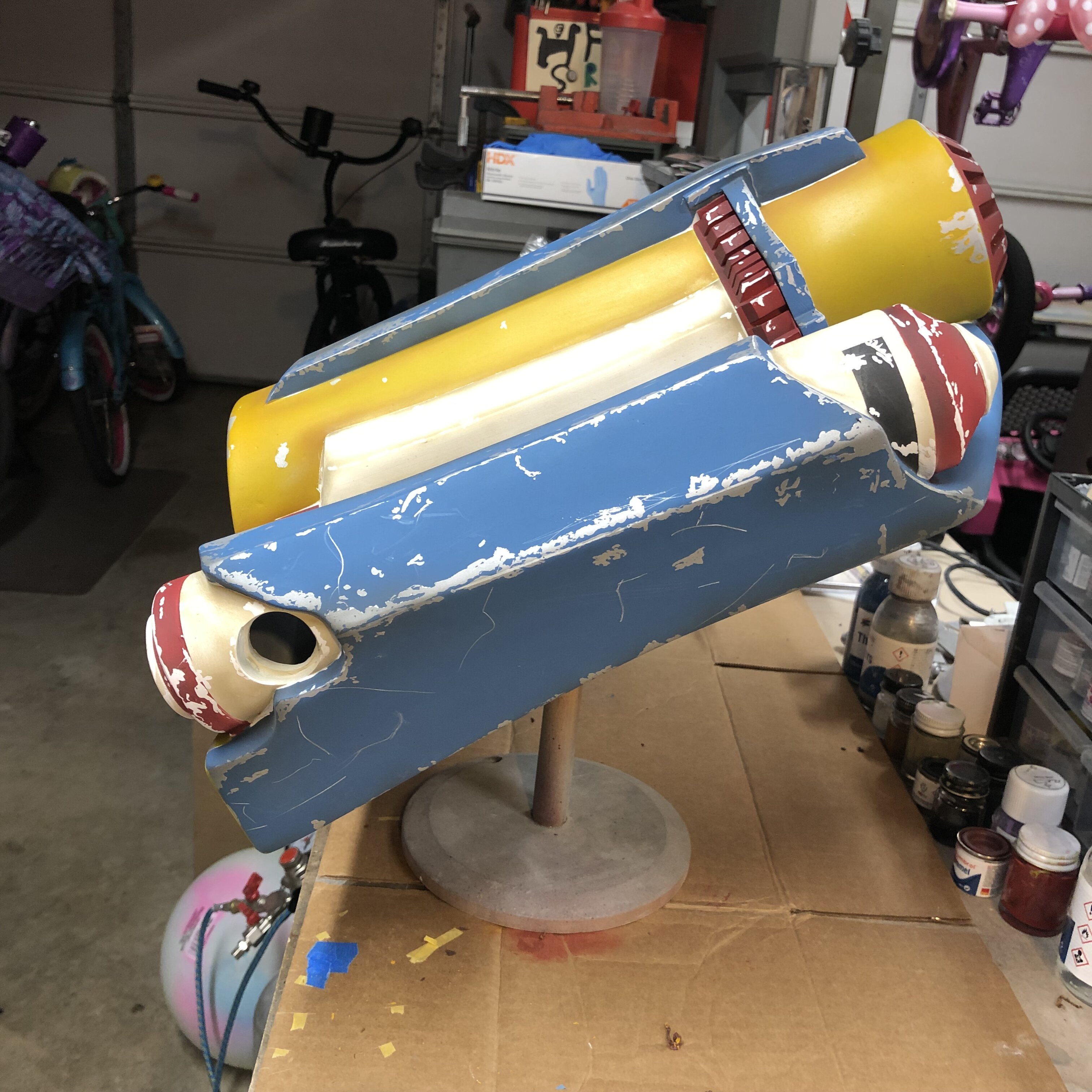

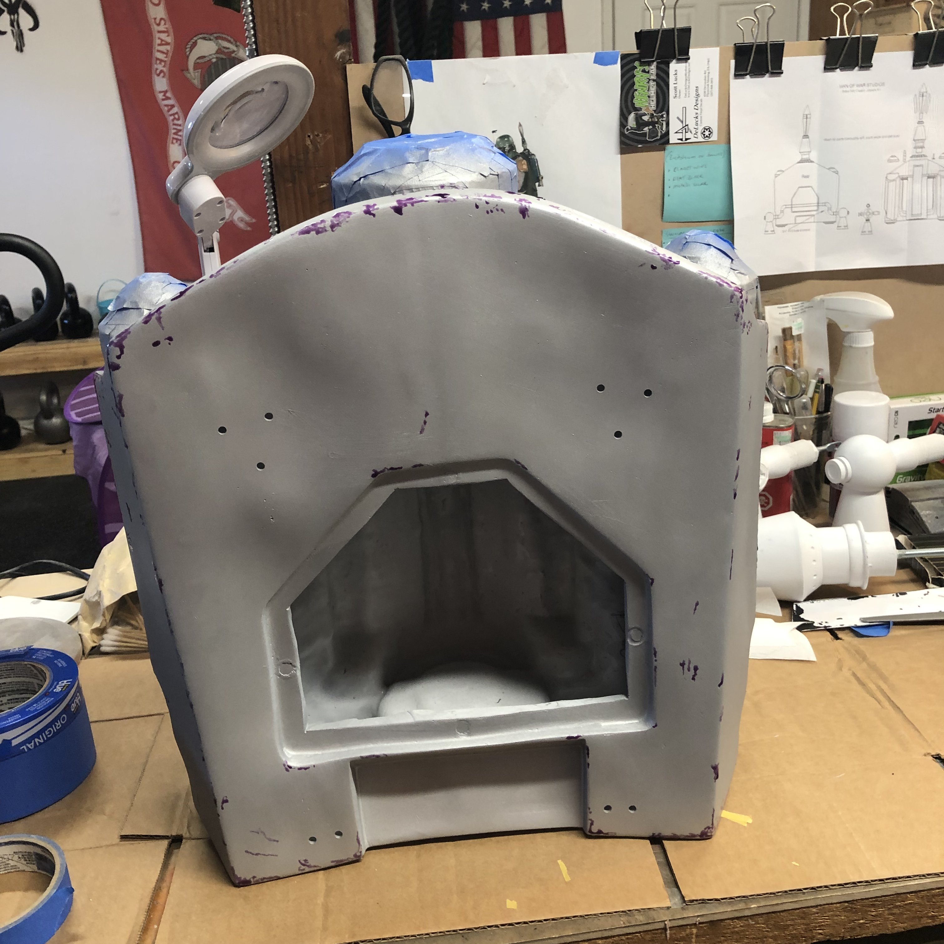

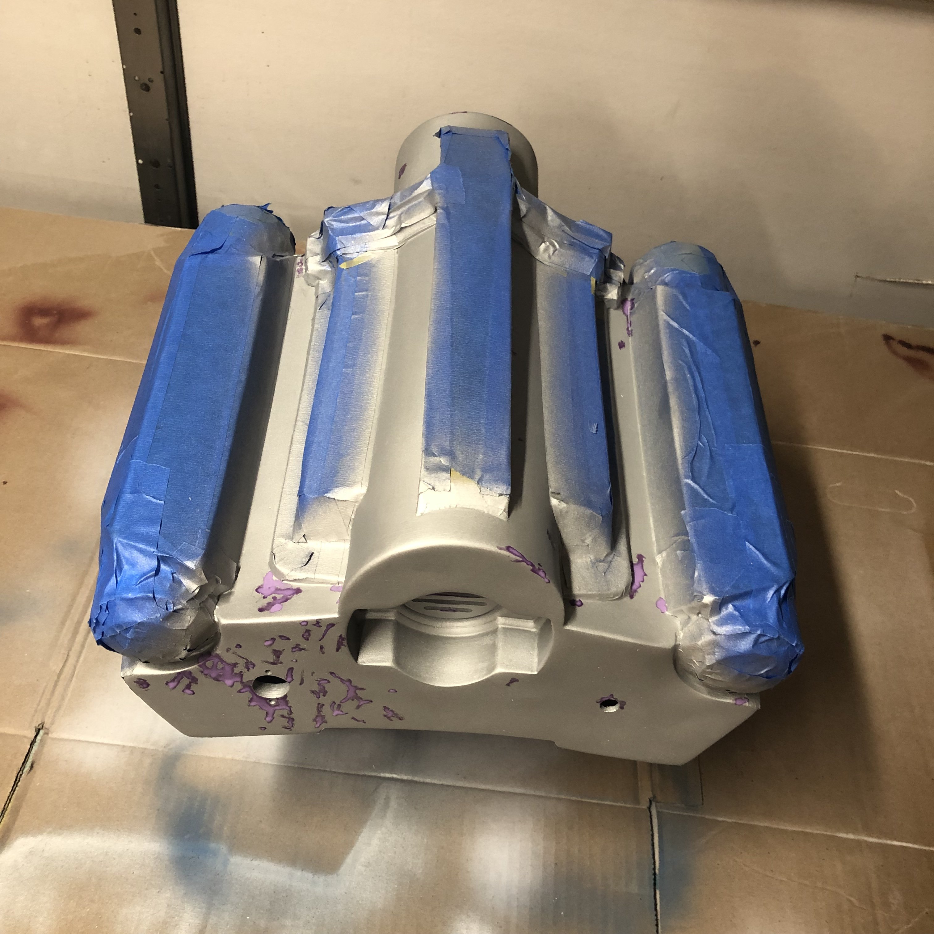

Made some major progress on my Jetpack. Got the White and Red done and some slight weathering. Need to spray in the black band on the main fuselage. Paint on the symbols. Scratches and some more shades of weathering. Need to finish the thrusters and rocket. But here is a couple pics of my progress.

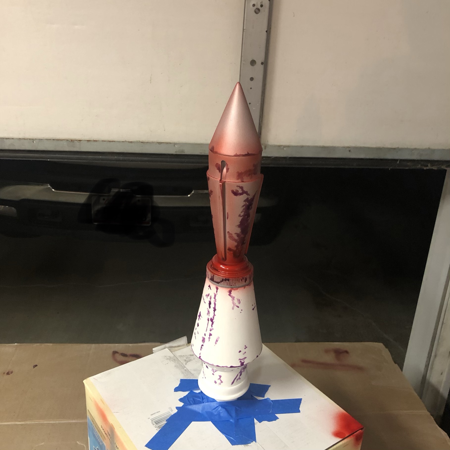

Sneak peak of the repaint. These are shots before weathering. The left is the repaint. I think I got it. I used Tru-Color Paint Rock Island Maroon.
When you did this repaint, did you leave the first color on and paint over it, or did you strip it first or prime back over it. The end result was good. Just curious of it would have looked different if you put the rock island maroon on with out this color there first, if it would look different.
Cool. I did start with a silver layer then a black layer to give the red depth. But I used the wrong red the first go around. I don’t know how much the first red effected the final red. The really effects the pictures from natural to led etc.
Ueah I'm doing the same I primed first, then silver then black. I'm going to try the Rock Island maroon on black, another with clarinet wine on black, I also have some british crimson i want to try maybe with the clarinet wine over it. Lots of paint testing this weekend. Want to finish it up so I can move on to the jetpacks

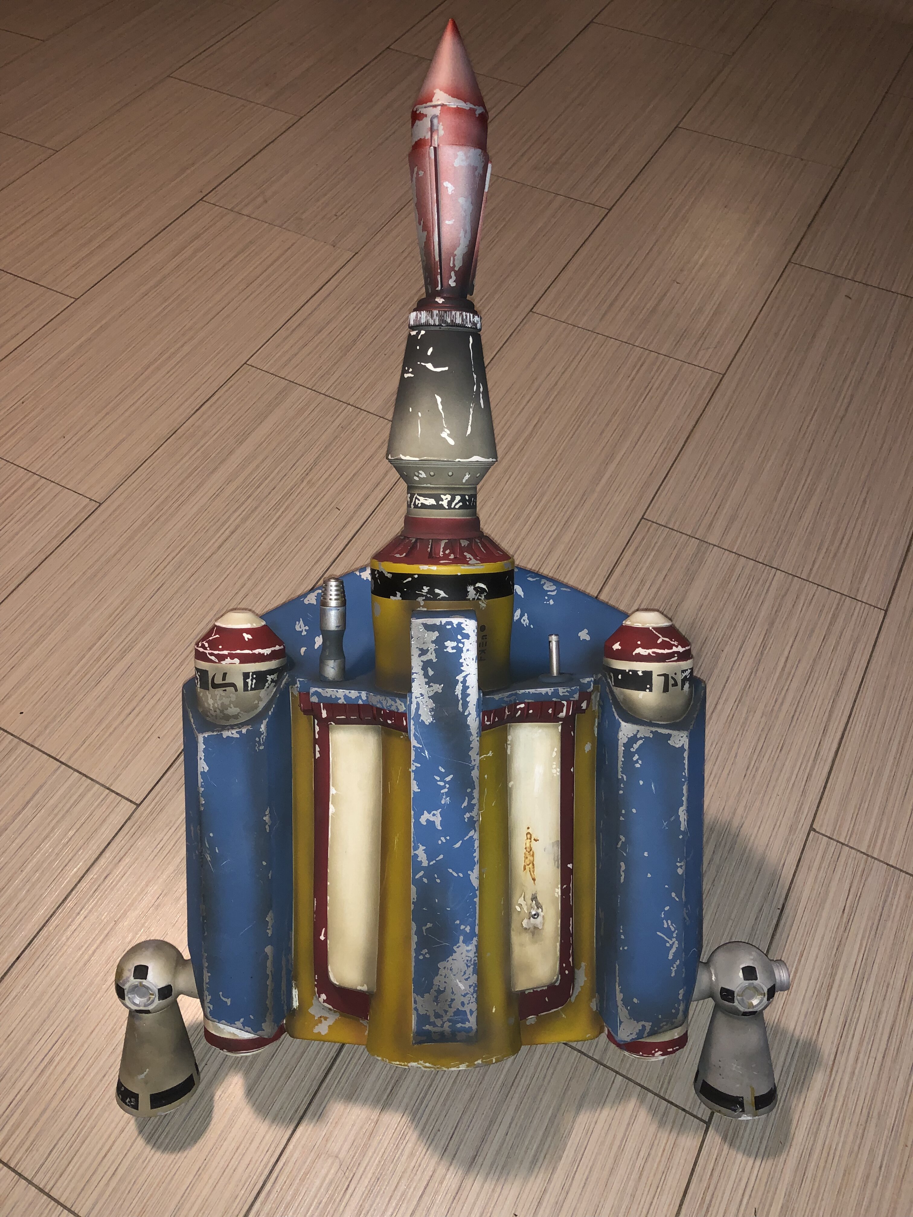

Cool I’m just finishing up my Jetpack. Just some final weathering and little details then I will post final pics.
